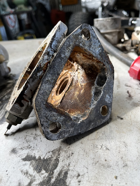

I think its a good runner, factory unopened engine, zero blowby, good compression. The only niggling concern I have is the oil cooler cover - I've had a look with a borescope and it looks OK from what I can see but the thermostat lower housing had some deep pitting - this engine has definitely been running just water - I'll be running a fine mesh coolant filter for a while and a second hand radiator until I'm happy its running nice and clean. In hindsight I'm regretting not pulling off the cooler cover when I had the inlet manifold off - lazy.
not too late, much easier out of the bay. I have pulled 4 x 2h's apart now, 3 had bad pitting in the coolant passages. real pain for the oil cooler to spring a leak then you have to pull the ip, the lines and the manifold in the bay then reinstall, re-spill etc...
the machine shop I used said a good phrase, 'you want a new engine or not?'

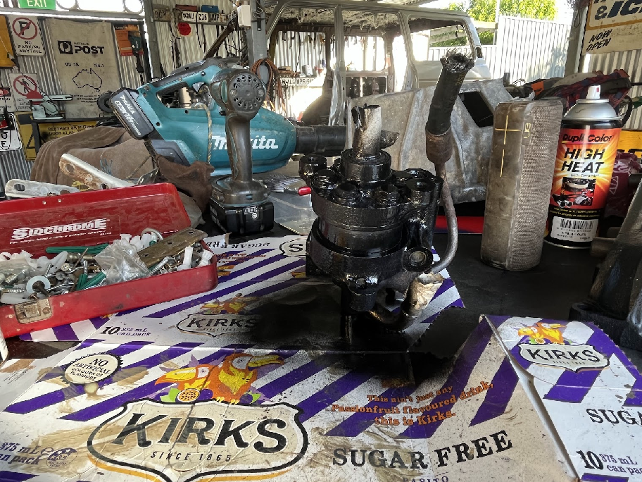

I've been meaning to do this with a 2H for a while.. this is a Mercedes, but its pretty much exactly the same pump..
