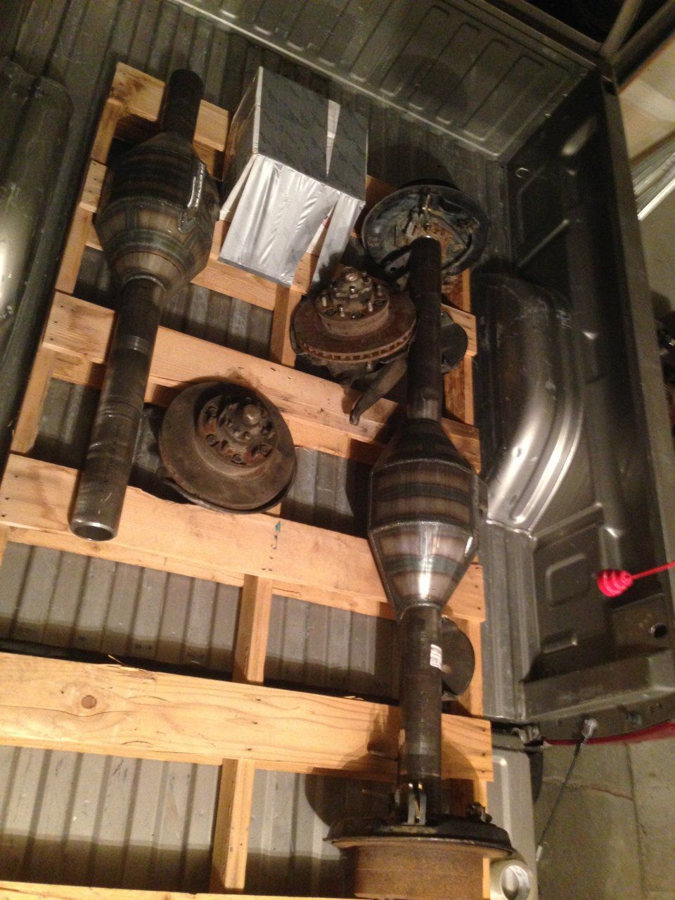

Went to great lengths and expense to lessen the tranny/TC combo ~18" for the sake of rear driveshaft, uncertain the implications to the front.
Have a double, double cardan shaft to cannibalize, so not a big deal for either to be set up for at the diff.
One purpose in considering is attempting to set up the front and rear axles, before the suspension, for the purpose of time.
Still have to determine axle width, which is proving more difficult that I expected.
Not a C&T scenario, but a press in and weld...
Picked up when planning to redo the 80, then rolled it. They're fu width do have to cut down....just not sure to what what yet.
I was hoping to set up the axles before incapacitating the vehicle, but don't see why possible for that to be done.
