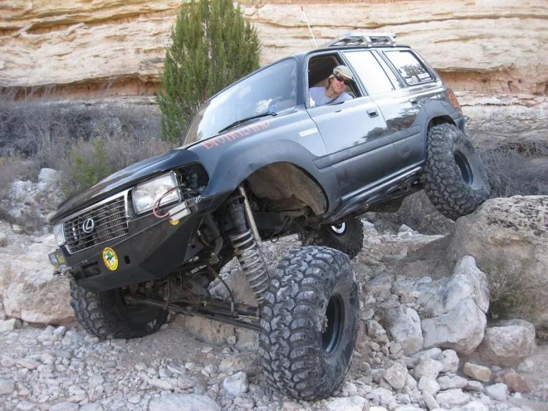

May as well just run 1-tons :D
https://forum.ih8mud.com/hardcore-corner/190922-help-1-ton-axle-choice-fzj80-build.html
attachment.php
