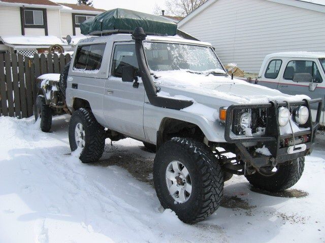

He's actually putting 80 series width axles on his BJ74.
Where?
Have canvassed earth finding only one example, being Carl's.
Is that one of the projects that died?
Axles are one of his favorite topics on our local list.

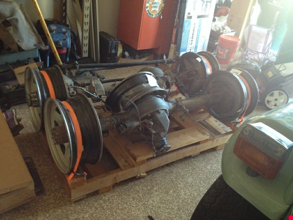

Rear:
factory FF 80 series housing.
Factory width?
What was the definitive width on any given setup you completed for a 74?
Rumors (see above) of 80 width, but thinking that died, too, eh?
