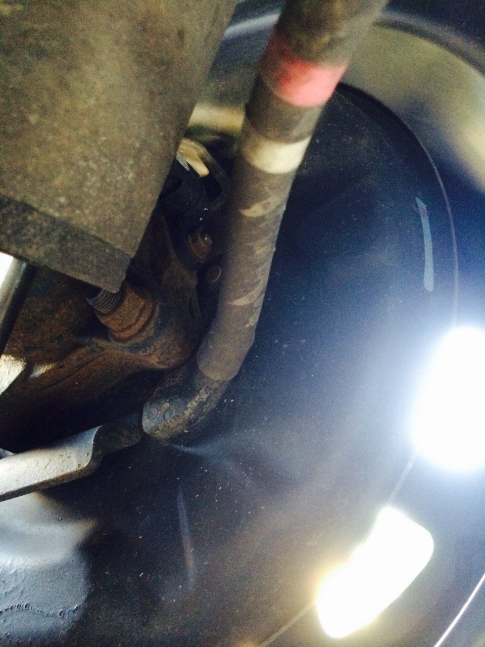

Gonna see if this'll work...
Runs down each lower, so worth pulling it apart and measuring.
