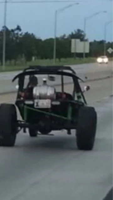

I'll eat these words, but trailers are for forklifts and equipment in my world.
That said, they'll allow almost anything to run down the road in OK. No inspections of any kind.
Thats what I love about Florida.... One of the only things though.
