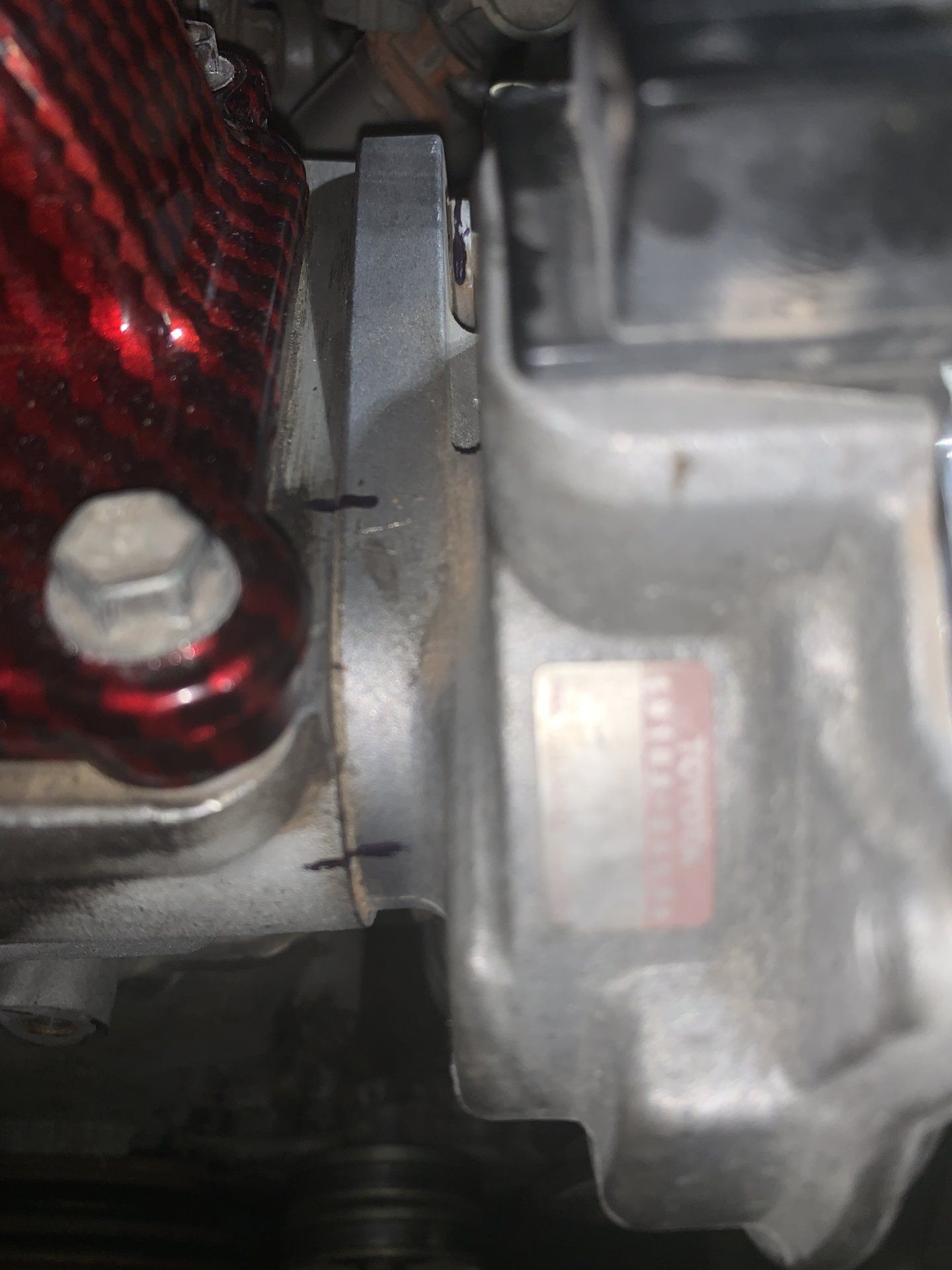

I had to pull the dizzy out in order to install a new bypass hard line that snakes up behind the distributor. Before removing I marked the housing against the head, set the motor to TDC and took a few pics of the rotor position at about 11 o’clock for reference later.
Whilst the dizzy was out of the way I pulled the alternator and mounting bracket off so I could get the coolant outlet off of the head. I replaced that peice with a new one pre-tapped by @NLXTACY for a coolant temp sensor. Also replaced the dizzy o-ring, which was still is very good shape. Hopefully I didn’t mess my timing up when putting it back together.

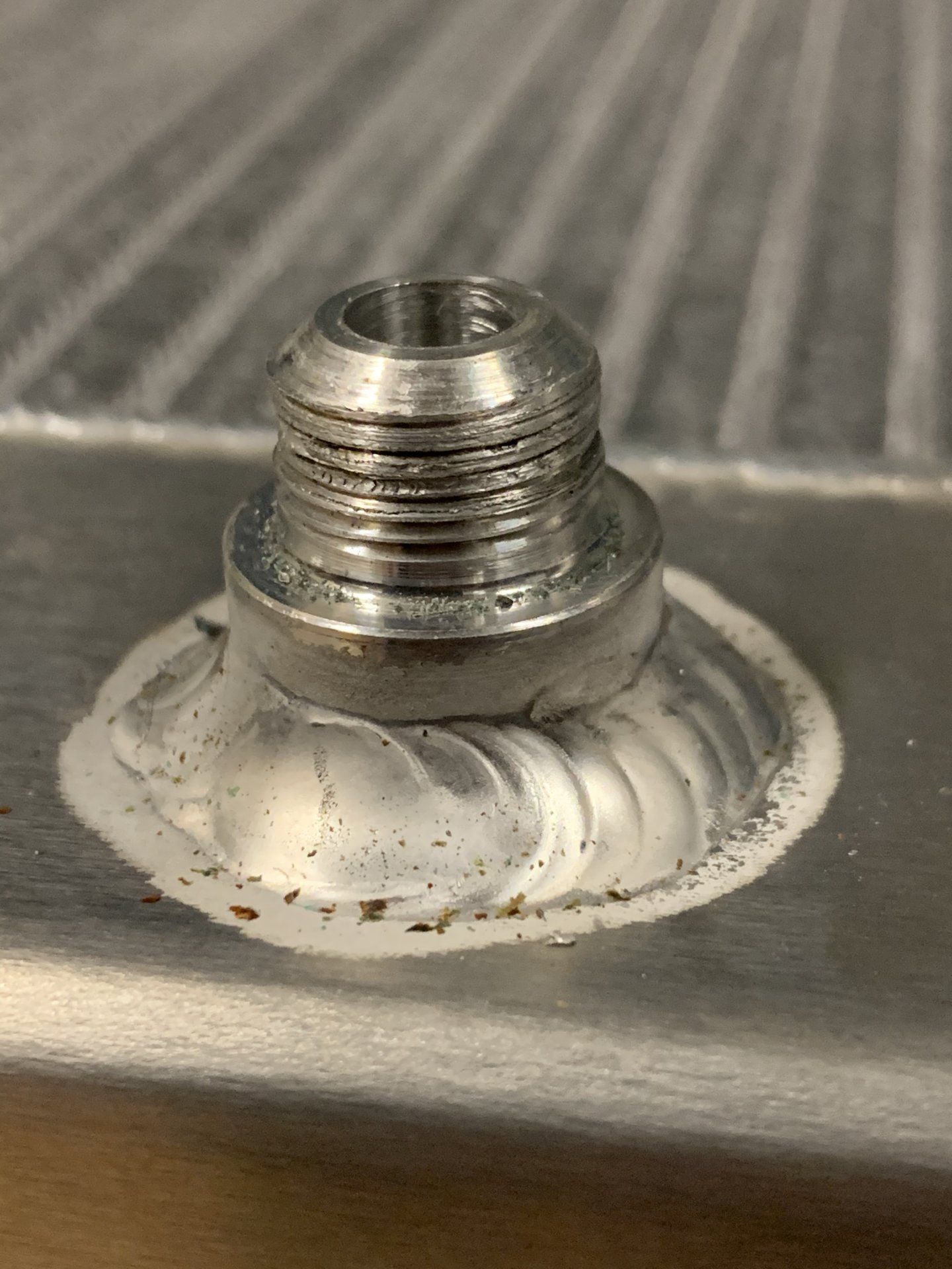

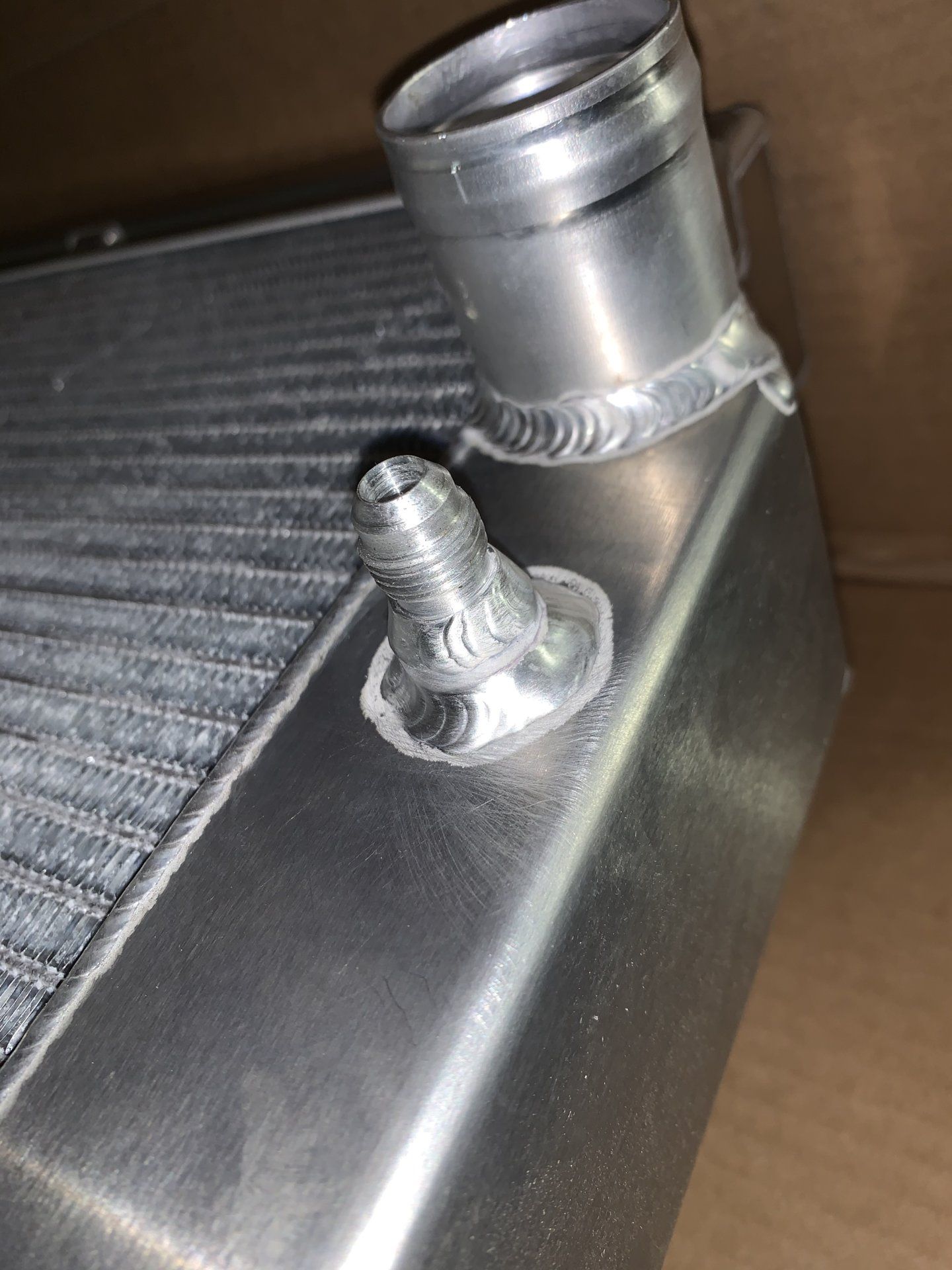

So had a bit of a set back the other night. When moving the OEM trans cooler hose barb fittings from the factory radiator over to the new Ron Davis one of the fittings got cross threaded :bang:
I am going to cut these off and weld on AN-6 fittings. For those looking to install a Ron Davis radiator, I would highly recommend not attempting to reuse the OEM barbs. @NLXTACY makes a nice M14x1.0 to AN-6 adapter, or if you screw the pooch like I did, just have AN-6 fittings welded in place.
Radiator is repaired with new russell AN-6 male fittings welded in place of the M14x1.0 fittings.

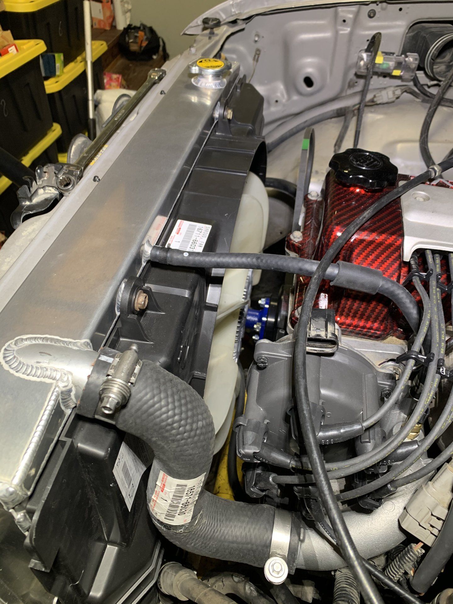

  • Dropped the new radiator in and replaced the bottom two hoses. Also hooked up the new trans cooler lines with nice black AN-6 fittings.
  • Tapped the York water pump pulley into place.
  • Installed a new heater pipe that runs about the exhaust manifolds.​

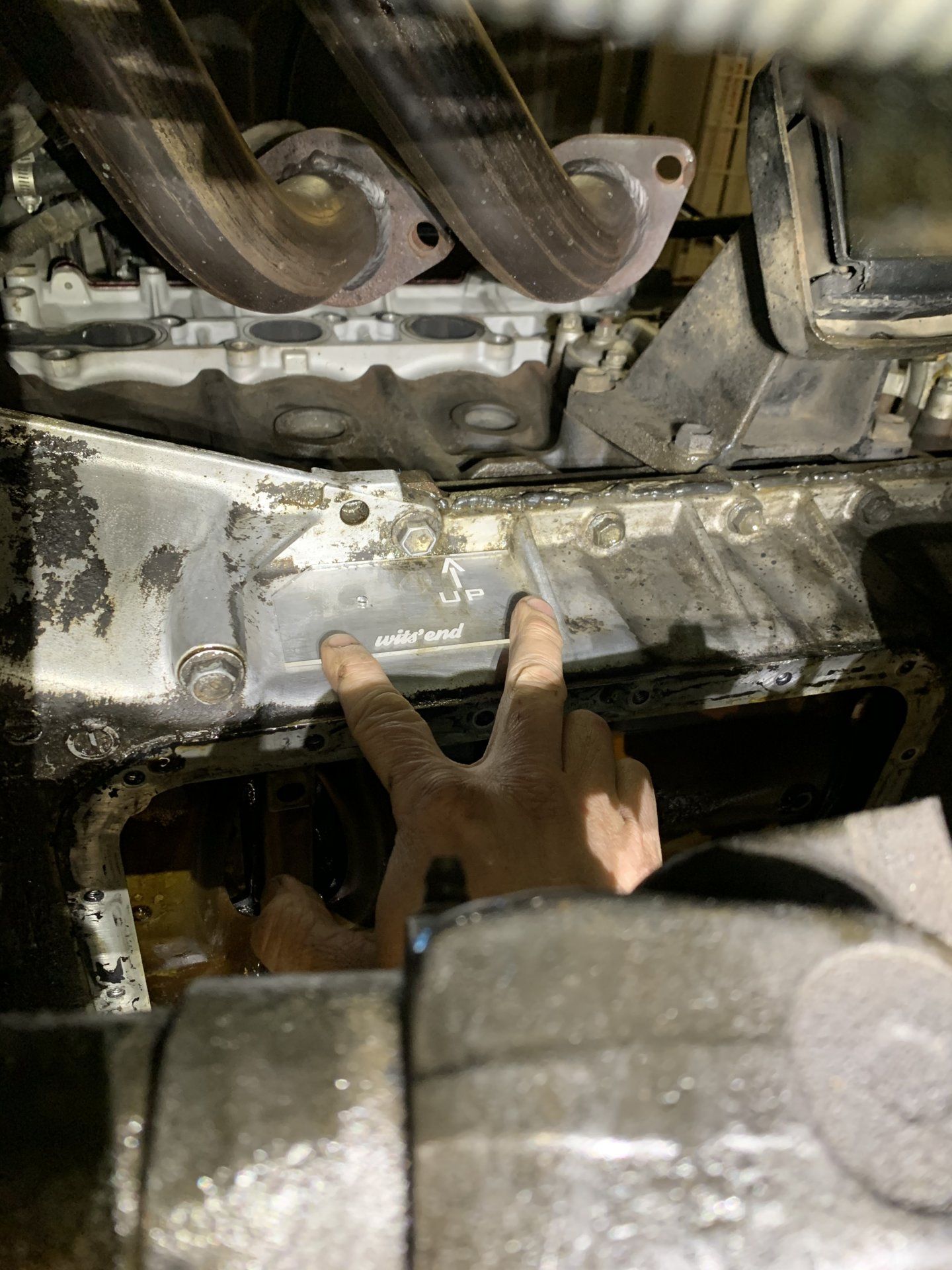

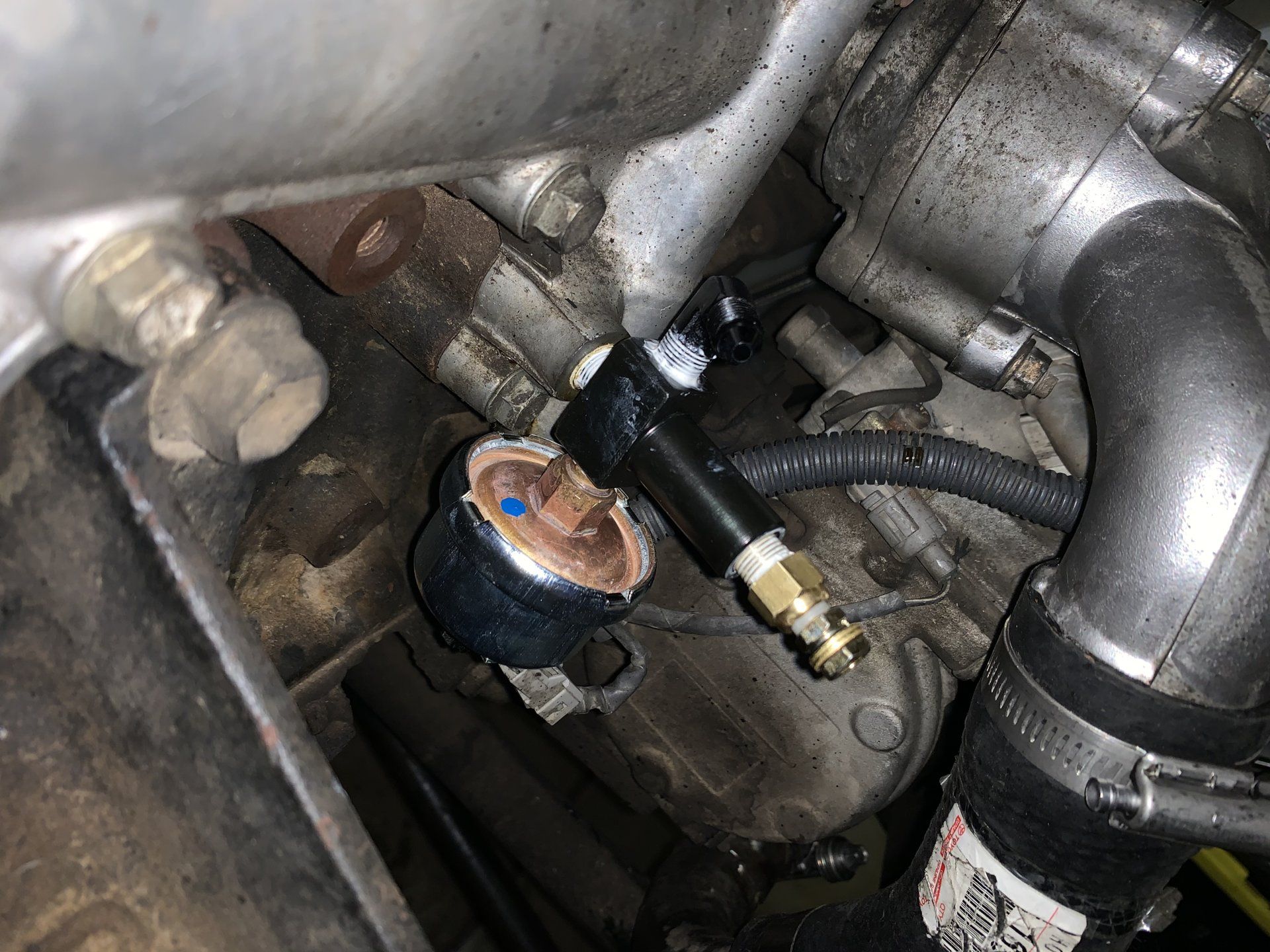

  5. Installed the wits end oil peace pipe with oil temp sensor, turbo oil supply fitting and a new oil pressure guage.

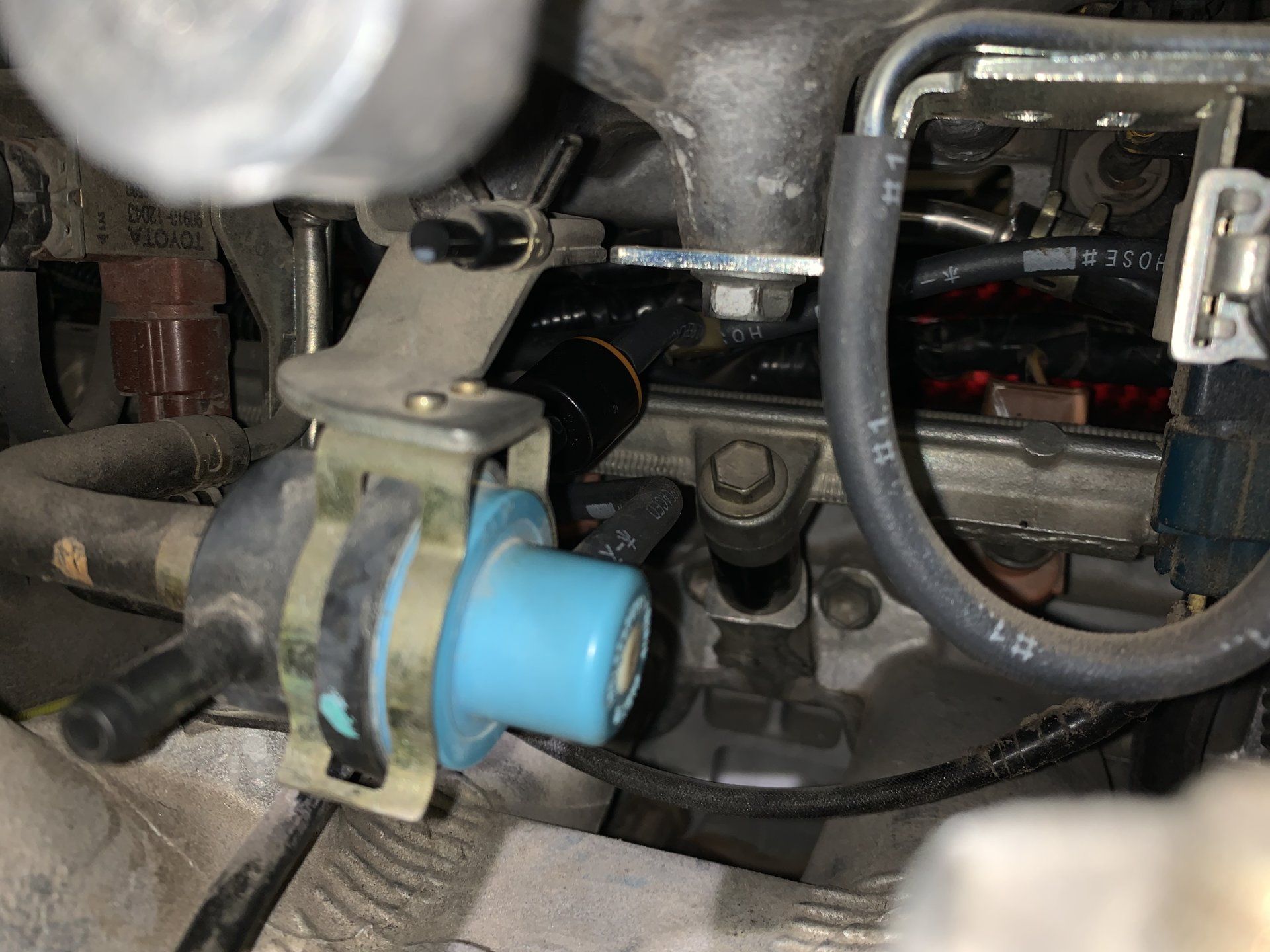

  7. Installed the Vacuum T on the manifold that will supply vacuum/boost to brake booster, boost gauge and turbo waste gate actuator. I had to order up a new hose barb to connect the brake booster hose as this is another part that gets omitted when running a Superchanger.
  8. I was bummed to realized that I had to go back under the manifold to replace the one-way orange/black vacuum check valve. Would have been much easier if I had do this when I had the throttle body off doing all the vacuum lines. New check valve in place now though.
  9. Replaced the vacuum line running to the charcoal canister and also installed a 2nd check valve in the middle of that hose.

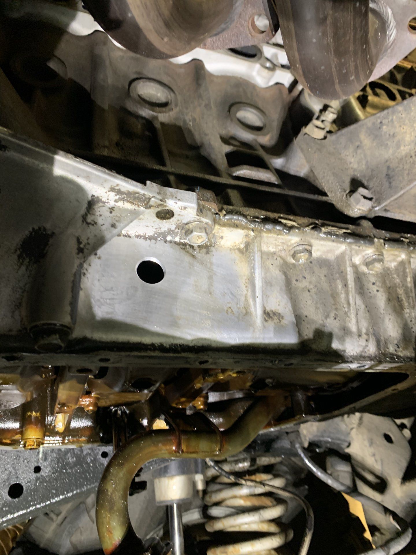

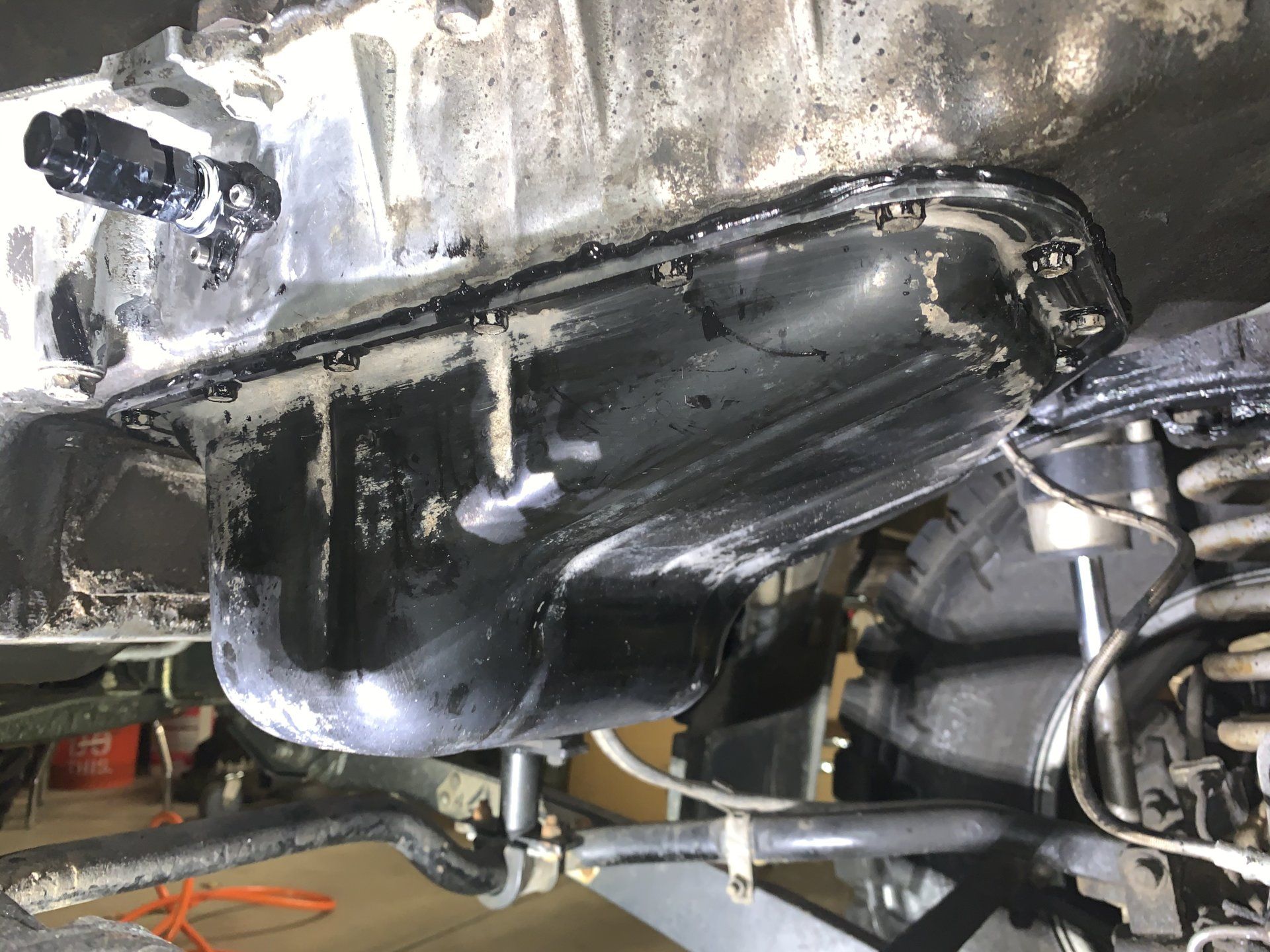

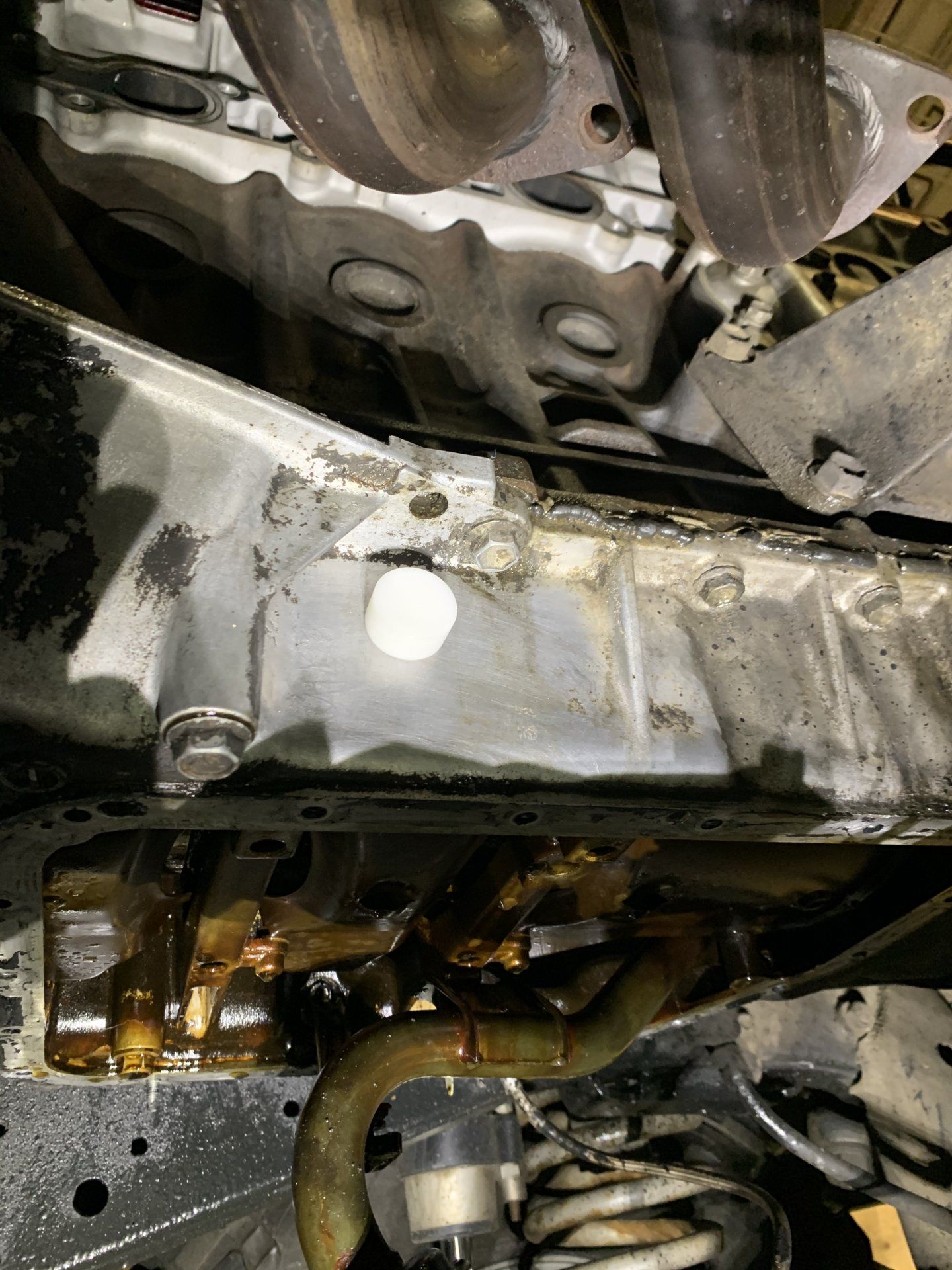

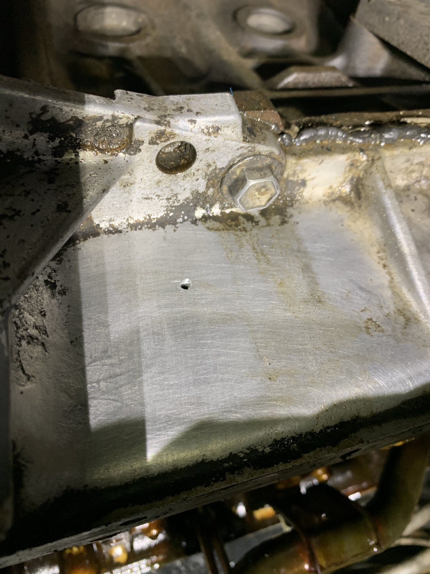

Also dropped the lower oil pan and got started modifying the upper oil pan for the turbo oil drain. This is the scariest part of the install!

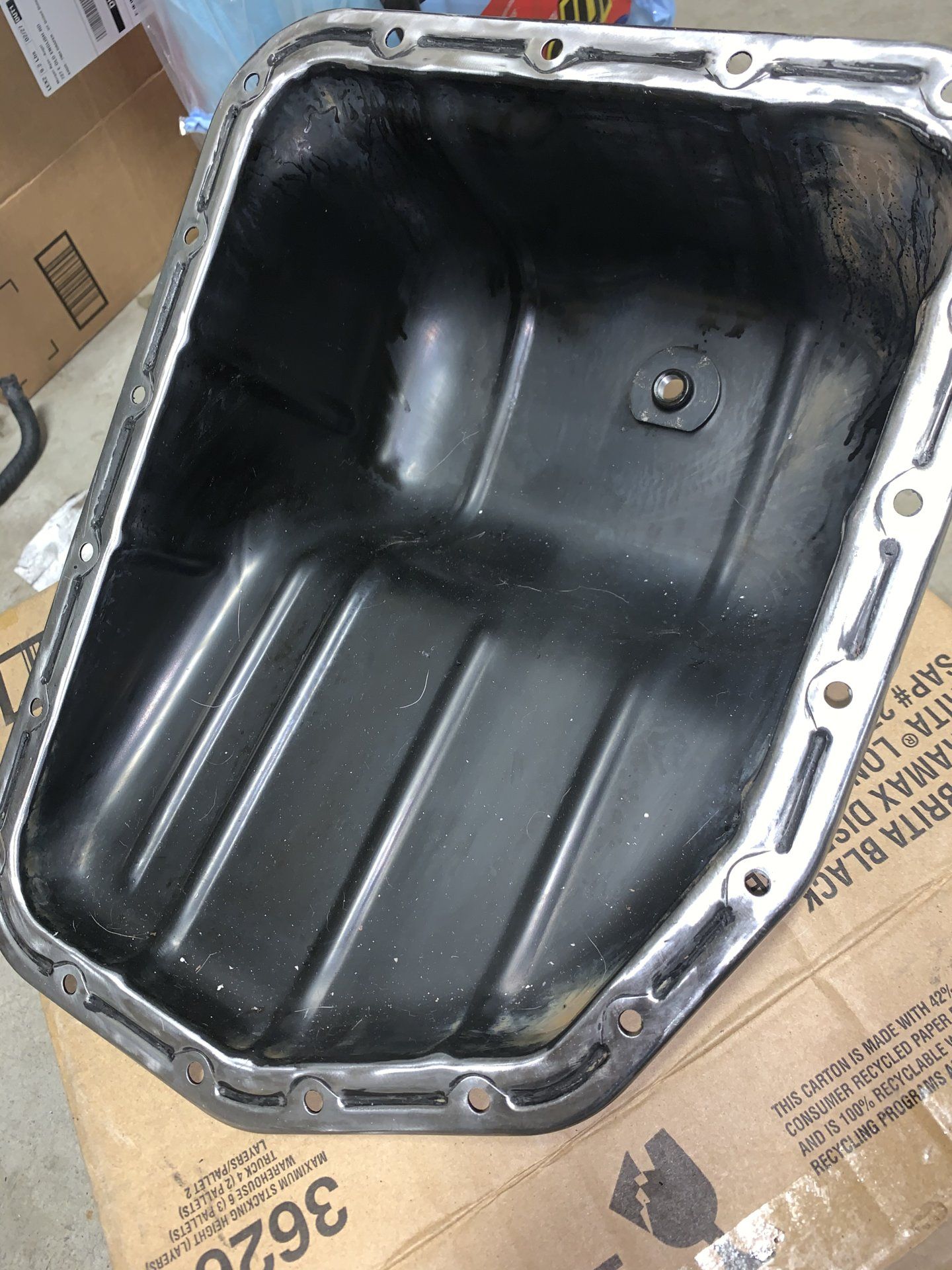

Tonight I finished up the oil drain fitting in the upper pan. I did manage to fubar the install by not noticing my 1/8” drill bit skipped out of the punch mark....resulting in a few extra unplanned holes having to get filled in...but all is good now. I used my endoscope to checkout the inside of the pan after the repairs were made and it’s solid.
I cleaned up the lower pan and upper pan mounting surfaces, but haven’t yet sealed it back up. I spent a lot of time trying to blow the aluminum chips that get stuck up in the pan on a ledge. I know there are still some there because I can see them with my endoscope...but they are proving real hard to get out. I’ll have another go at it tomorrow.

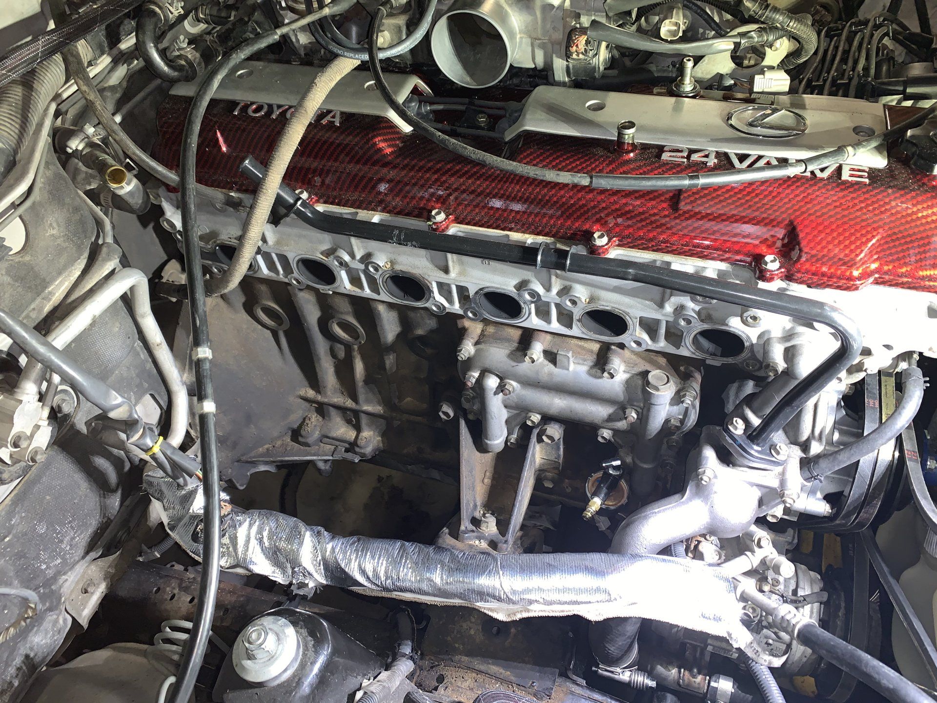

I relocated the AC line away from the exhaust using a shorter shock tower bracket that @NLXTACY provides and wrapped the AC line in a heat shield blanket.

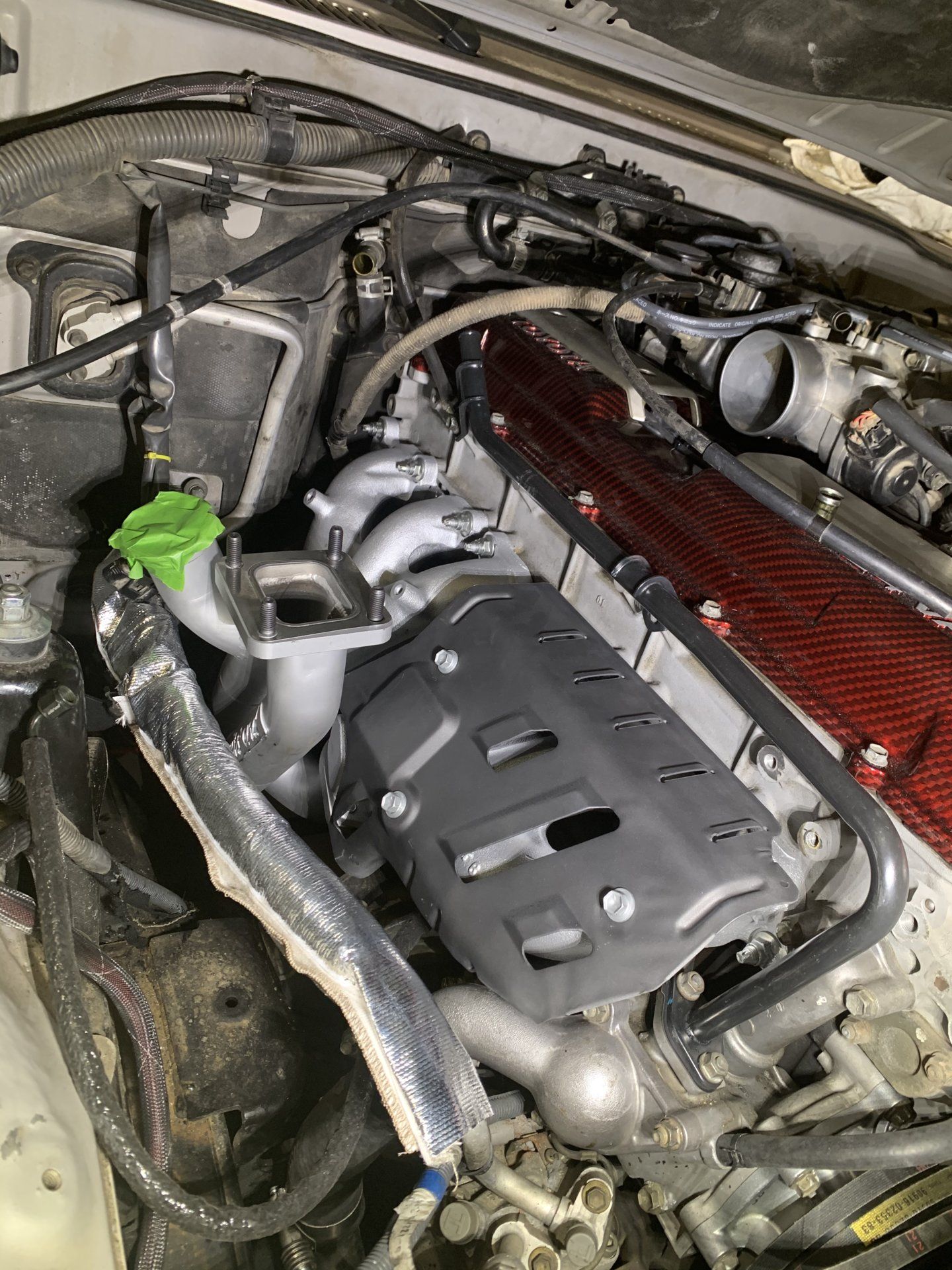

I decided to hook up the turbo oil feed supply line while I still had the front manifold out of the way. Then got busy installing new manifold studs, gaskets, manifolds and heat shields that I had ceramic coated a while ago.
Last update for tonight was that when I pulled my Y-pipe out, I managed to snap both studs for the front 02 sensor. I decided that the pipe and cat has seen better days so I will replace with a new cat rather than try to drill/tap and weld that rusty mess.
J-Pipe is on and T4 studs are in place just waiting for the turbo to get dropped on top. Pro-Tip: Tape up the ports on the J-pipe when installing the studs to prevent dropping a nut down into the pipe.
Wrapped up the down pipe with the blanket that arrived just in time. My wife now thinks I am totally weird for buying sweaters for my exhaust pipes.

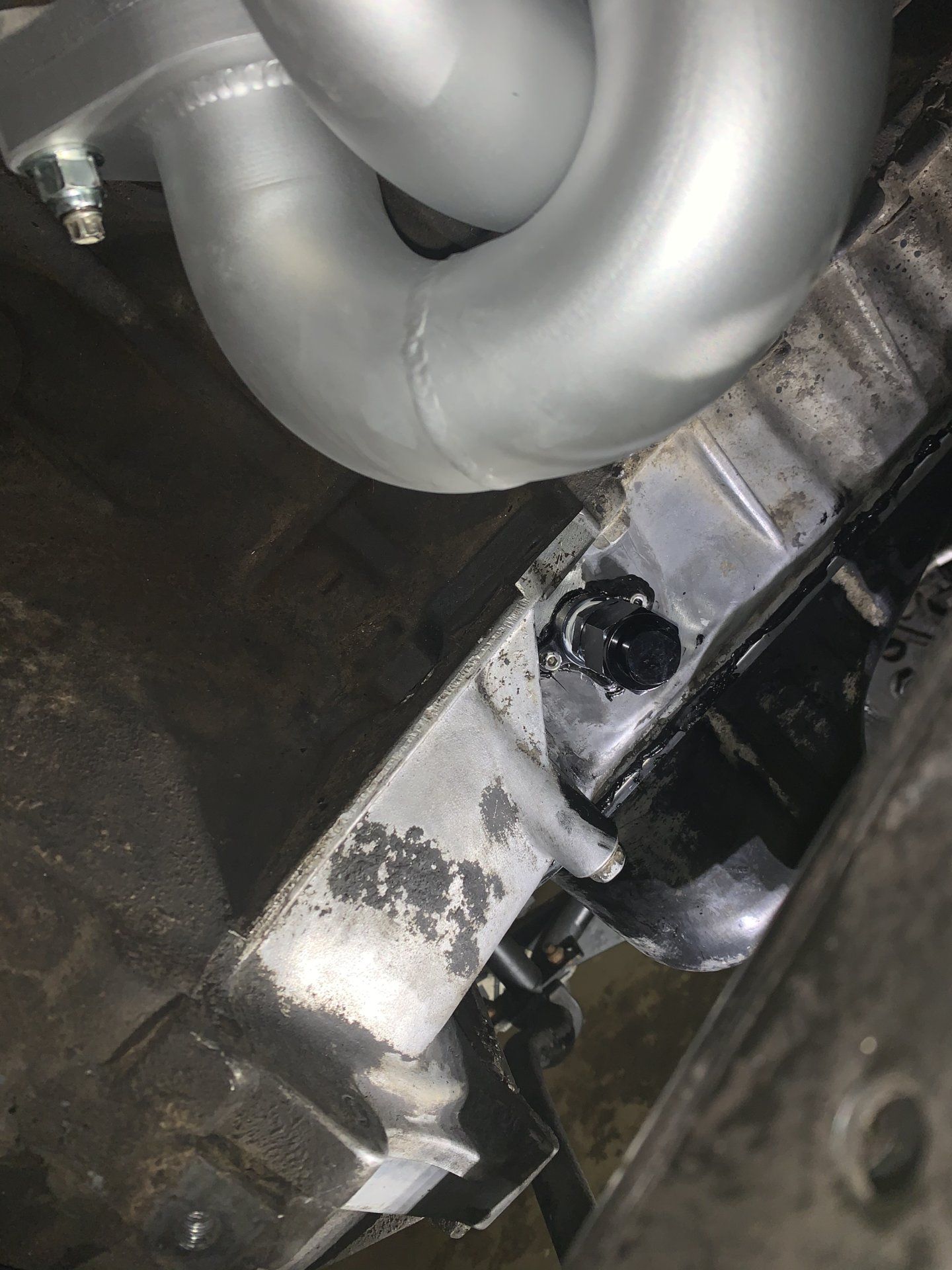

Finished cleaning out the aluminum chips and got the lower pan sealed back up.
Also fitted the NPT to AN adapter into the oil drain fitting.

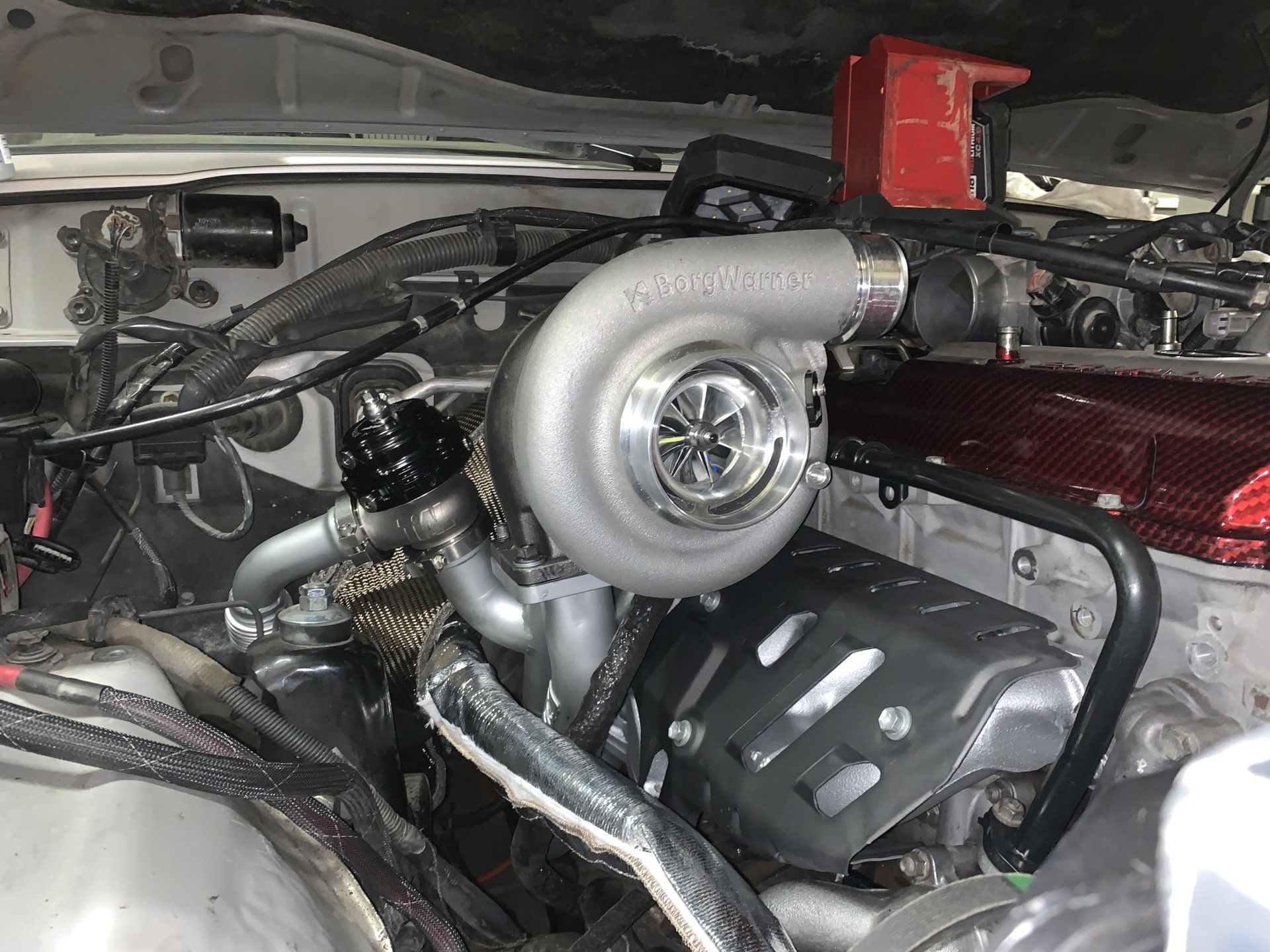

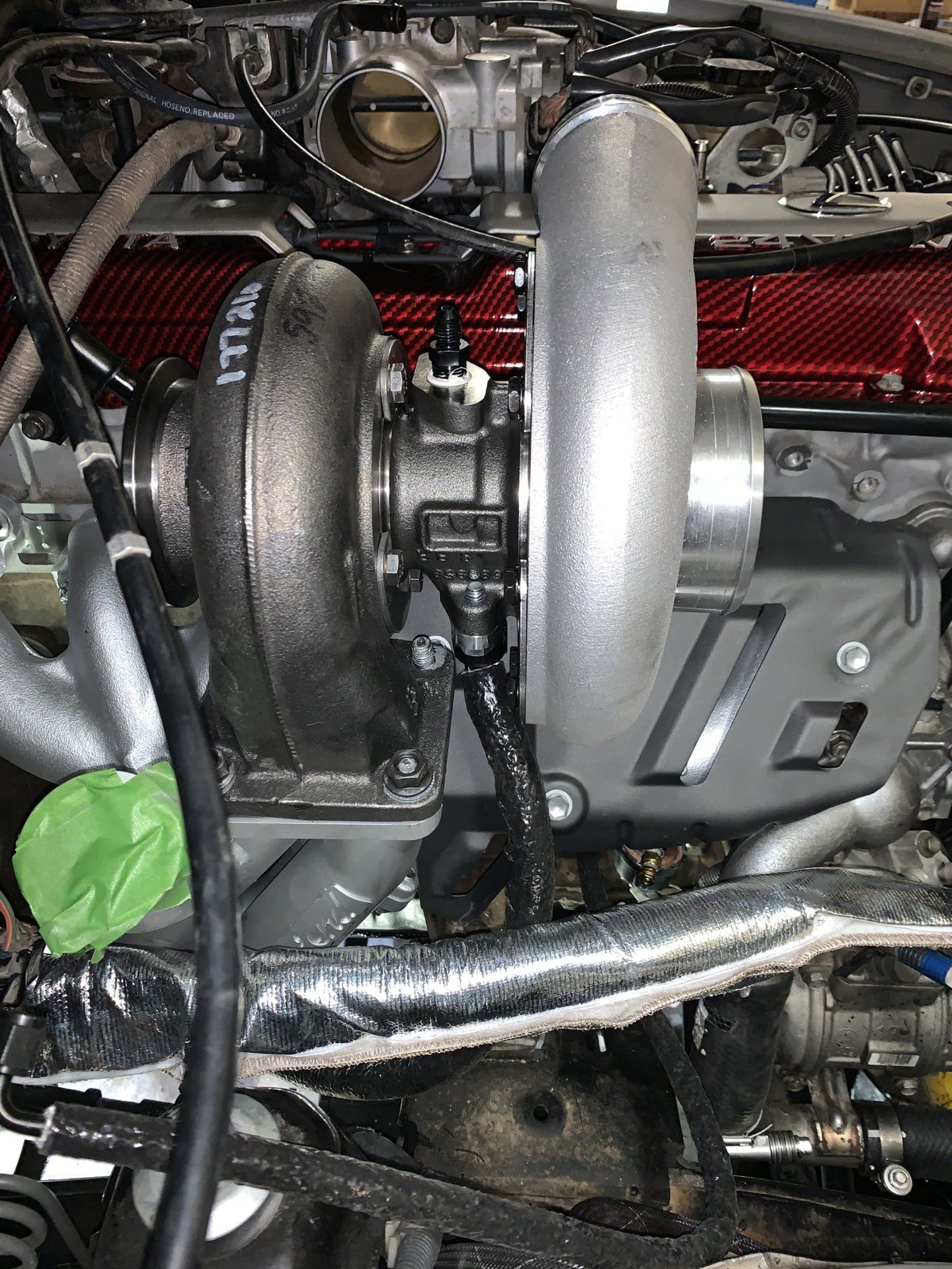

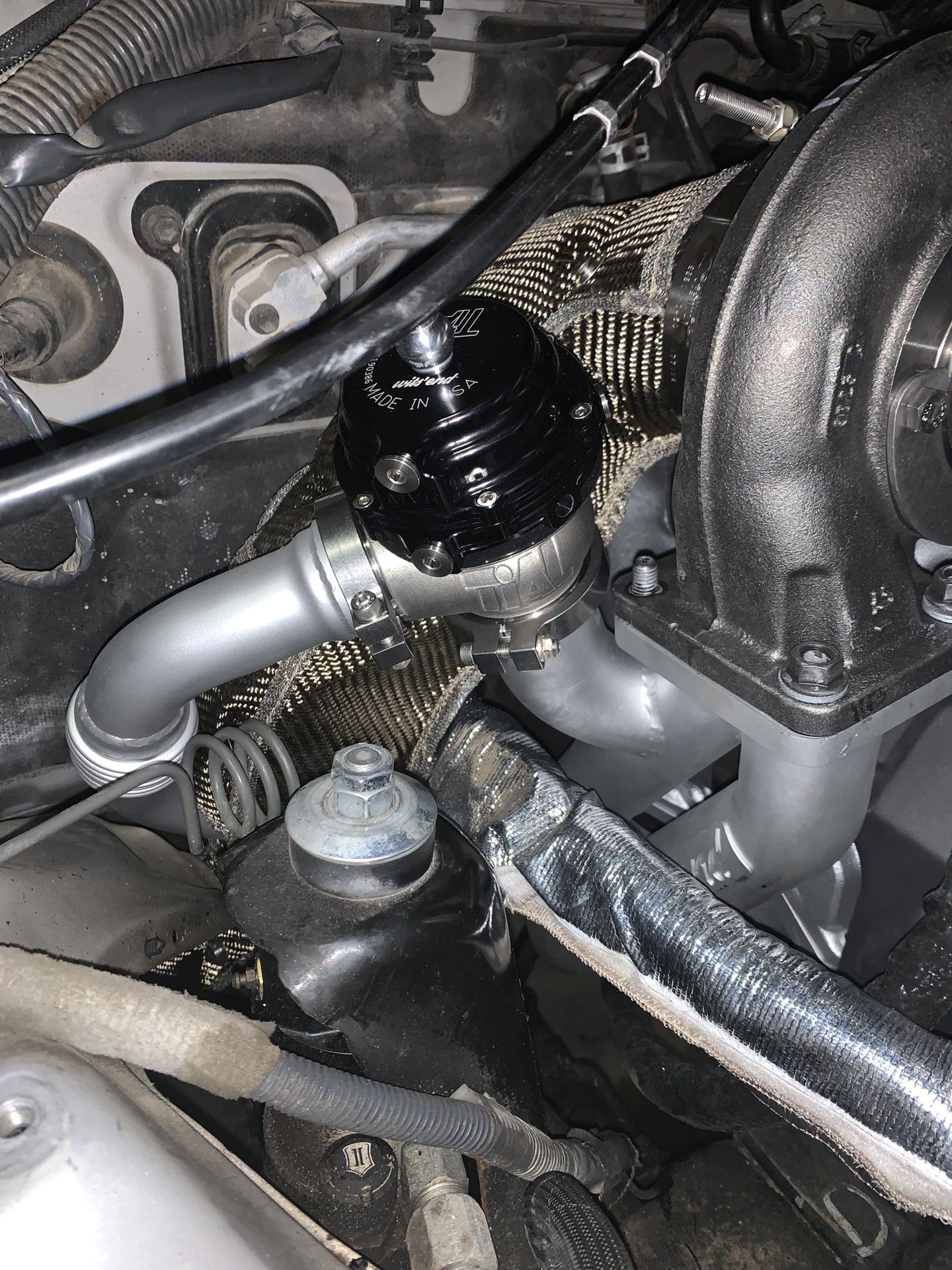

Haven’t done much on the LX in the past 2 weeks since COVID-19 took over the world...but this afternoon I got back in the garage and slapped the turbo into place. Took a little bit of trial and error to get the oil drain line routing correct, I would recommend to attach the line to the turbo before dropping the turbo onto the T4 flange.

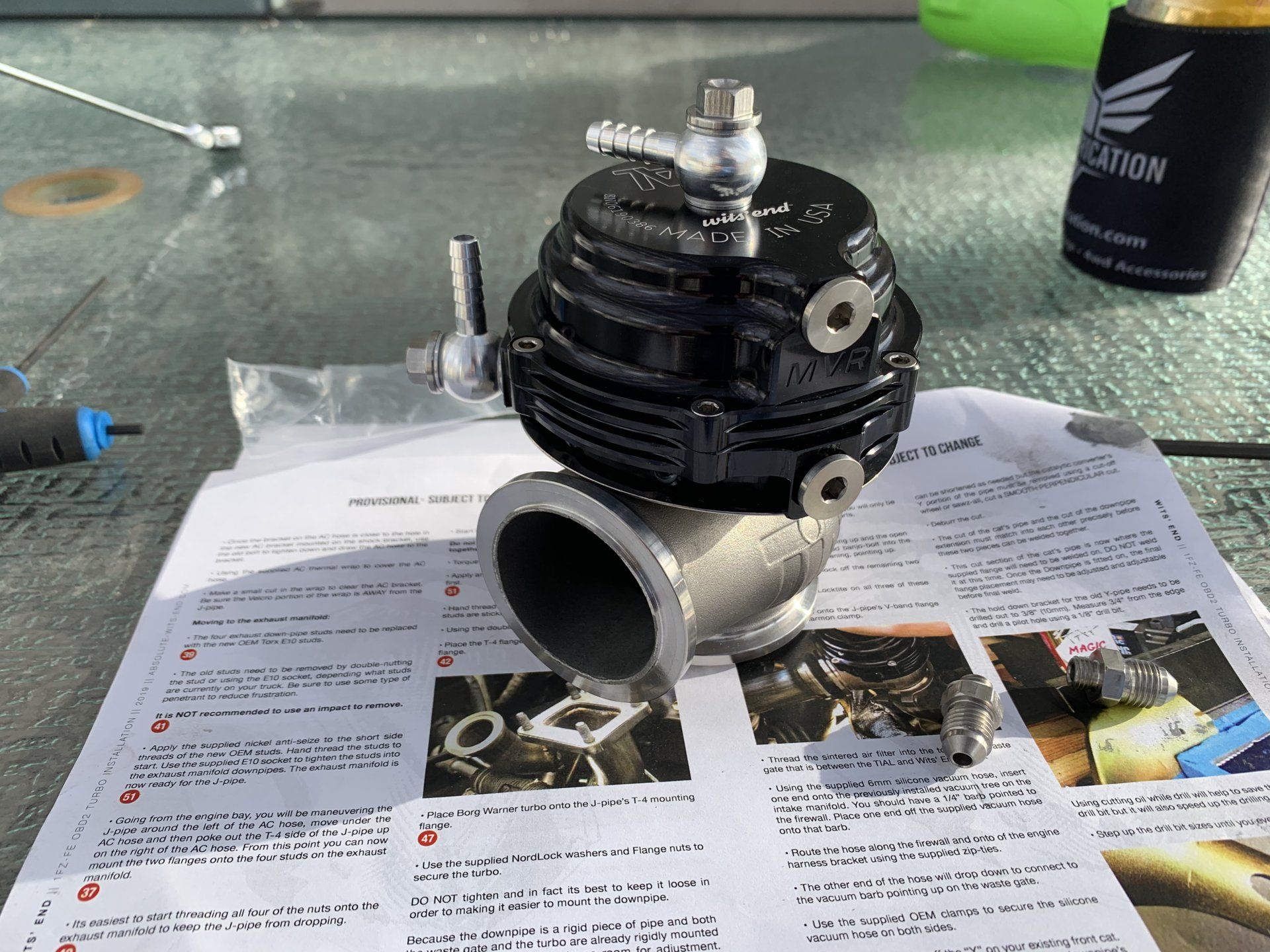

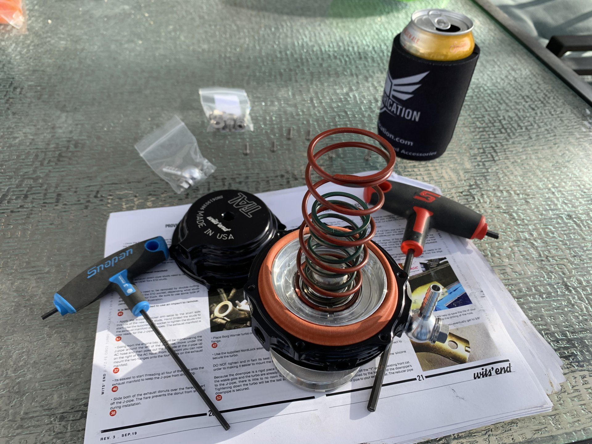

I then moved to the wastegate and installed the two supplied springs, banjo fittings and plugs, nearly losing a few screws between the boards on the back deck in the process.
This Tial wastegate is a seriously nice piece of kit!
Installing the downpipe and wastegate was a bit of a struggle to get everything aligned perfectly, but I got it done...I am sure @NLXTACY is about to block my number after today’s tech support messages.
