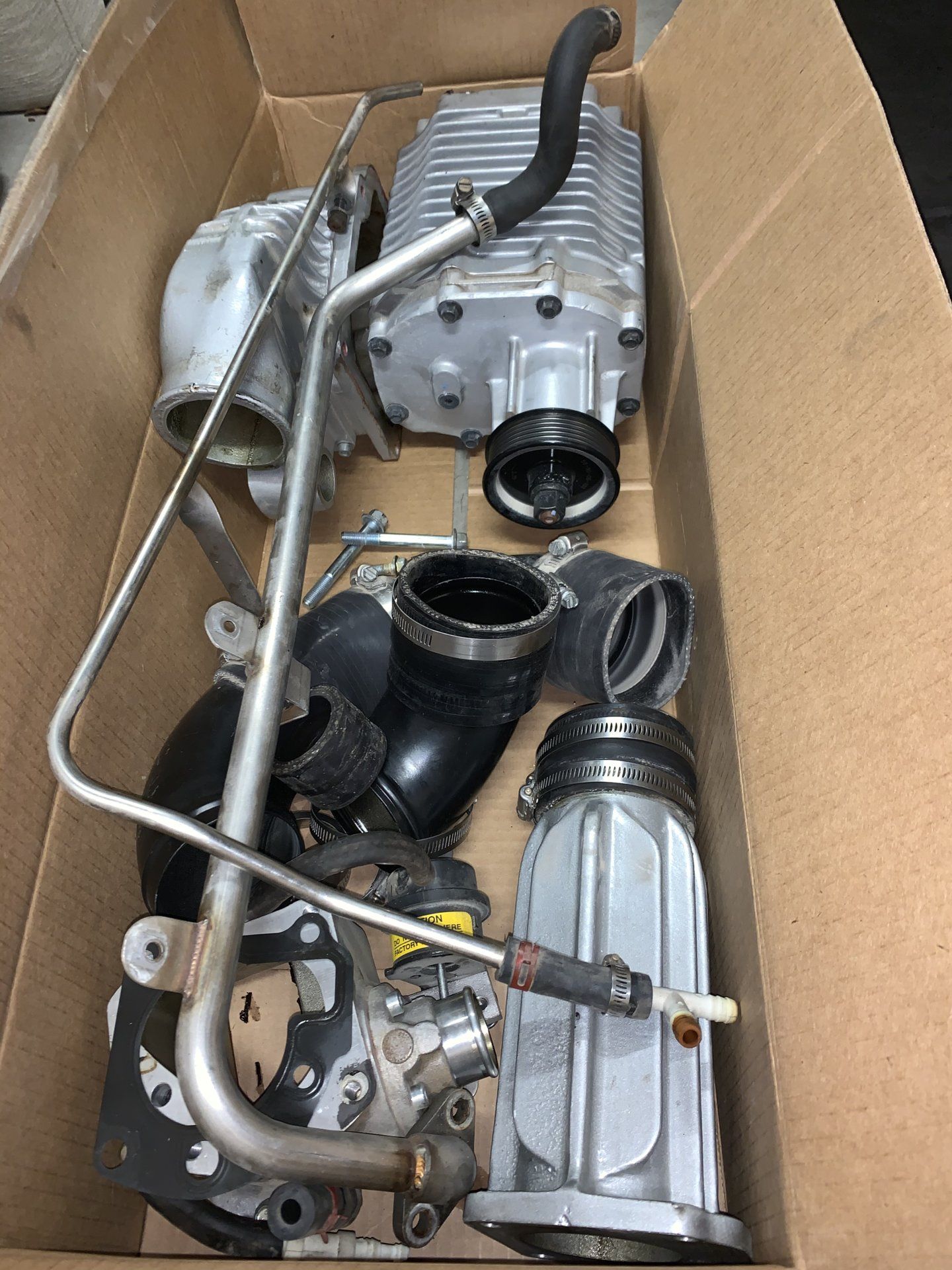

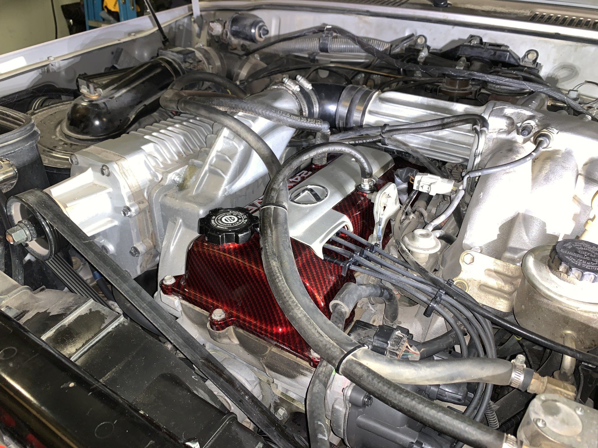

Bubbles got a Superchargerectomy today. I still need to remove the crank pulley, but this turbo swap is now in full swing.

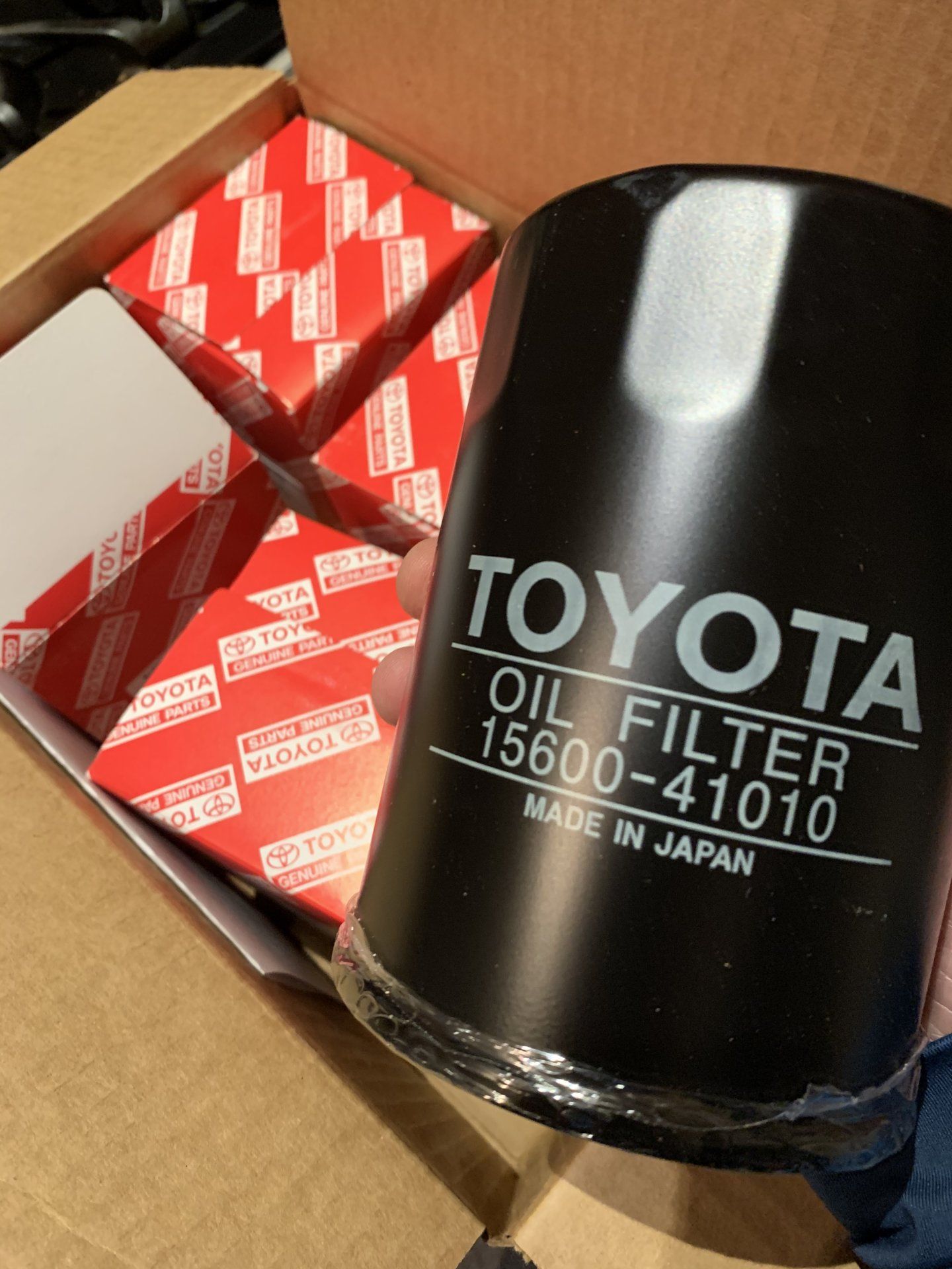

Need to change the oil as part of this turbo install...so stocked up on the good stuff.

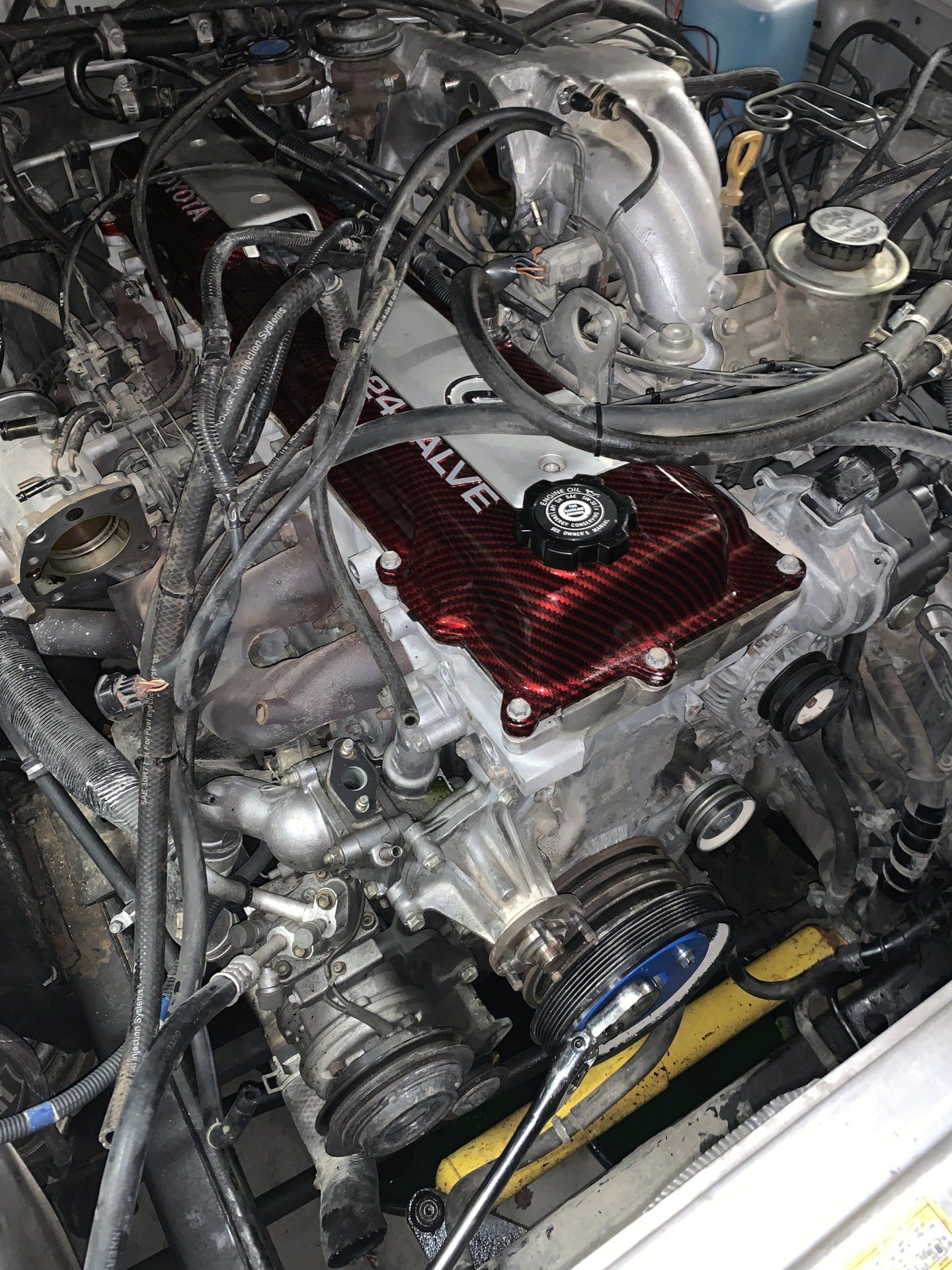

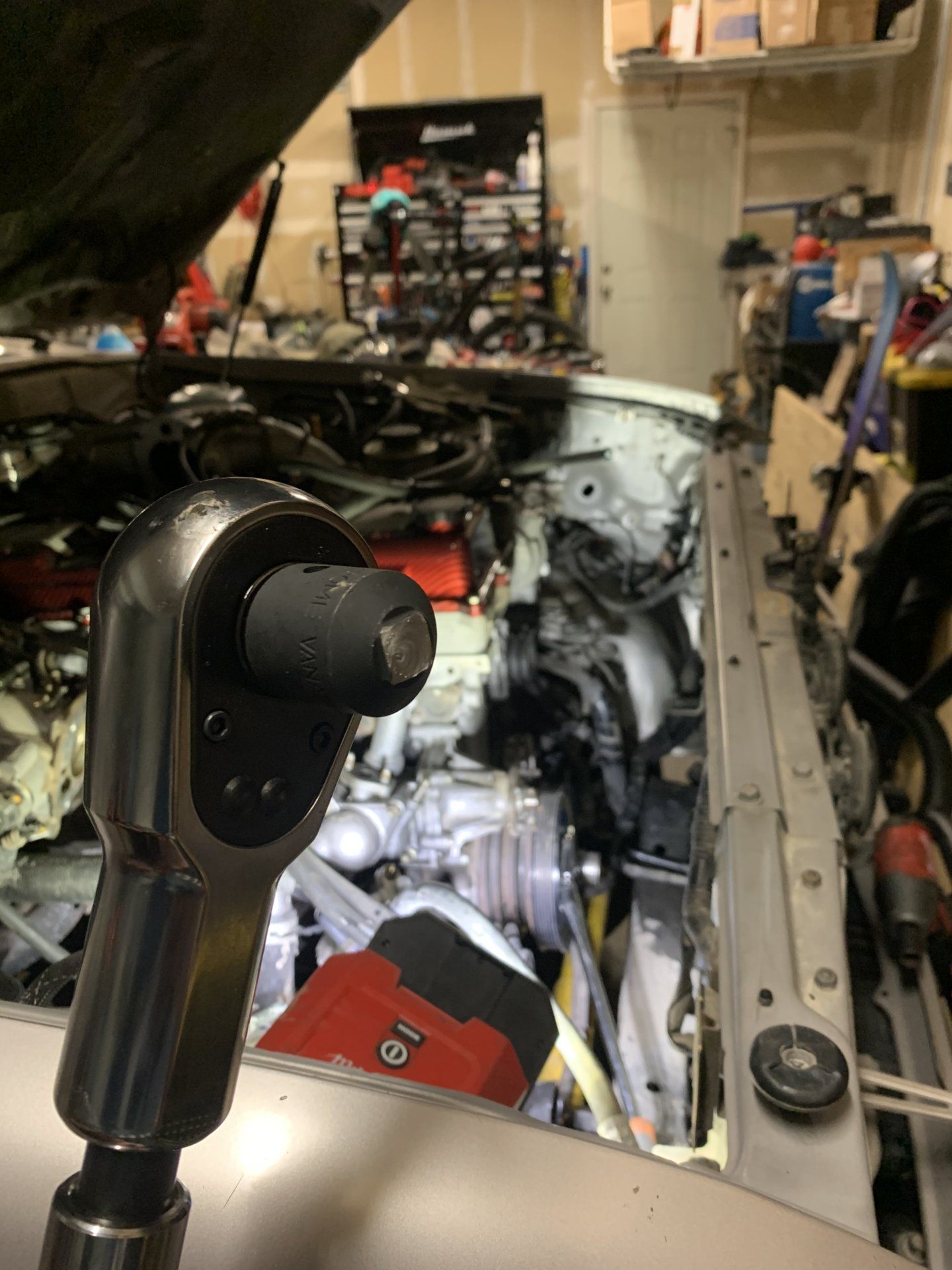

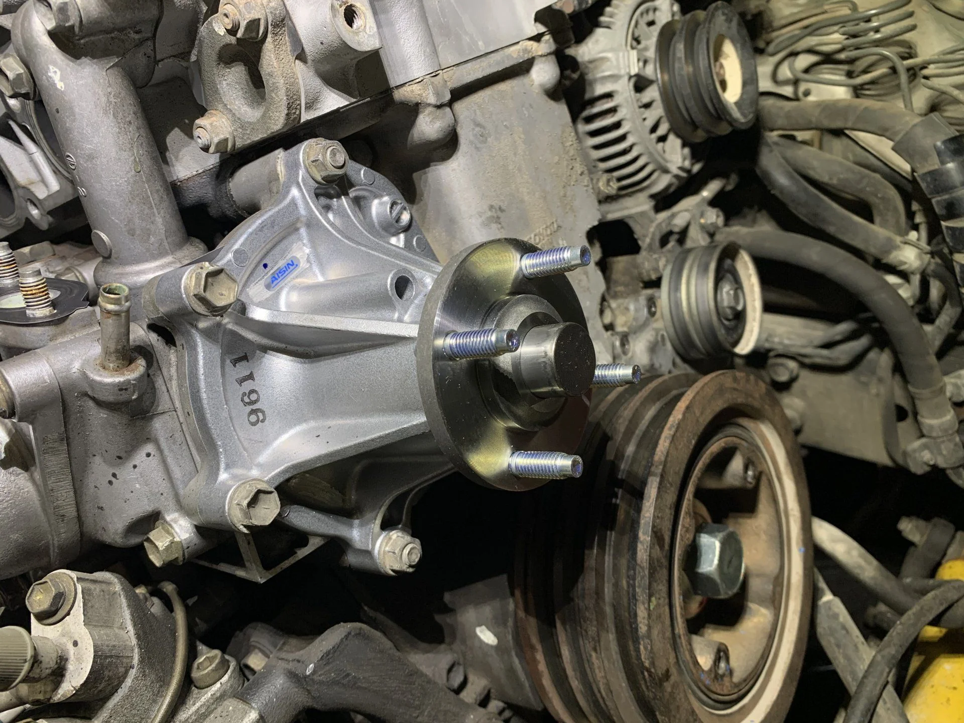

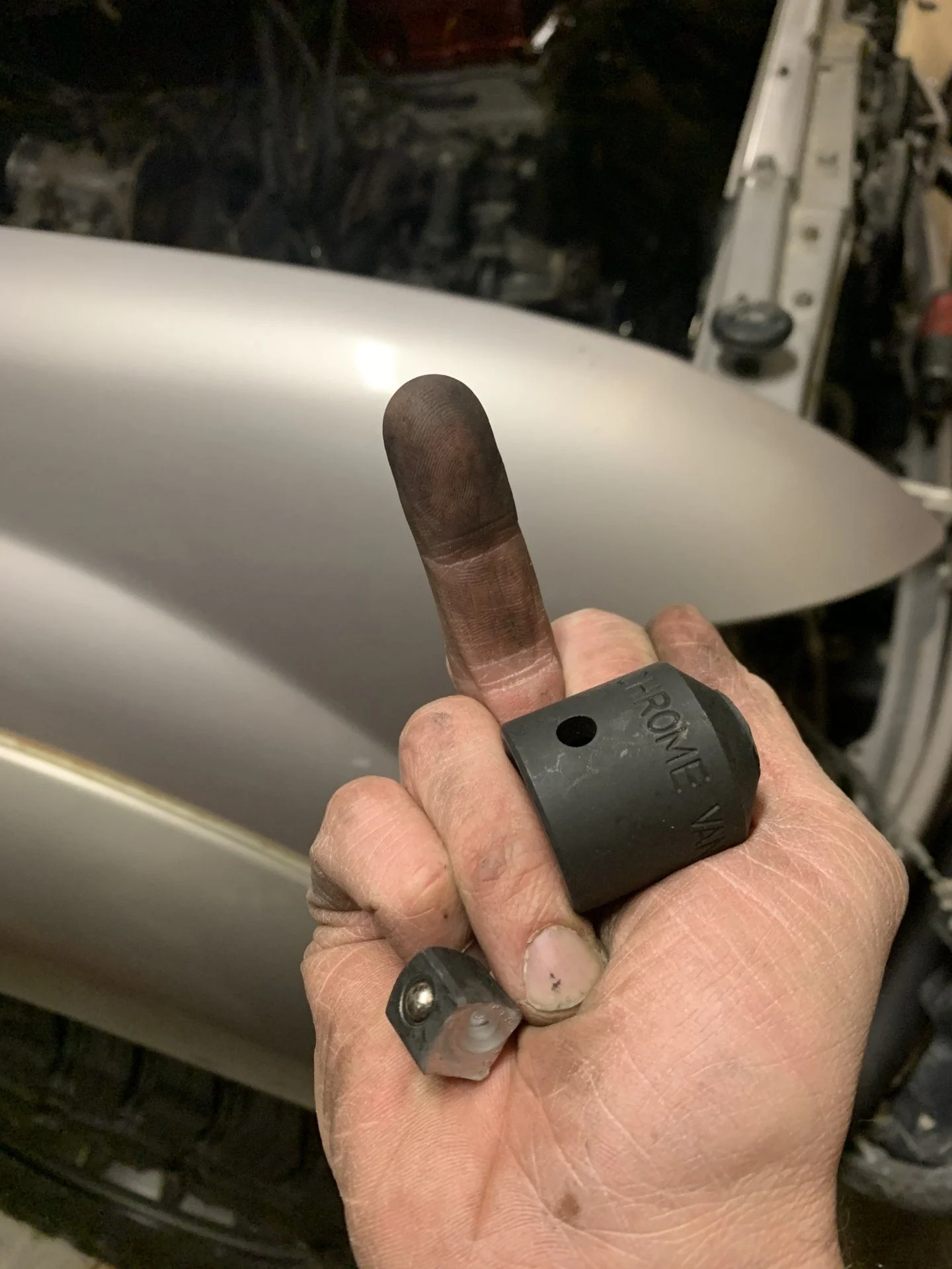

So while doing the valve cover and tune up work I had a knucklehead moment and must have leant on the bypass hose on the radiator...resulting in a broken nipple. I have done this twice now on two separate 80’s so I used it as an excuse to order up a Ron Davis radiator that I am less likely to break. I wasn’t planning on going this deep, but figured if the radiator had to come out I might as well redo the cooling system and front end seals. Lots of parts from @NLXTACY and @cruiseroutfit and I got stuck into it. Was going rather smoothly until it came time to remove the crank pulley. My 3/4” to 1/2” adapter couldn’t handle the Ugga-Dugga’s! Now to find a couple good quality 32mm and 30mm 3/4 drive sockets.

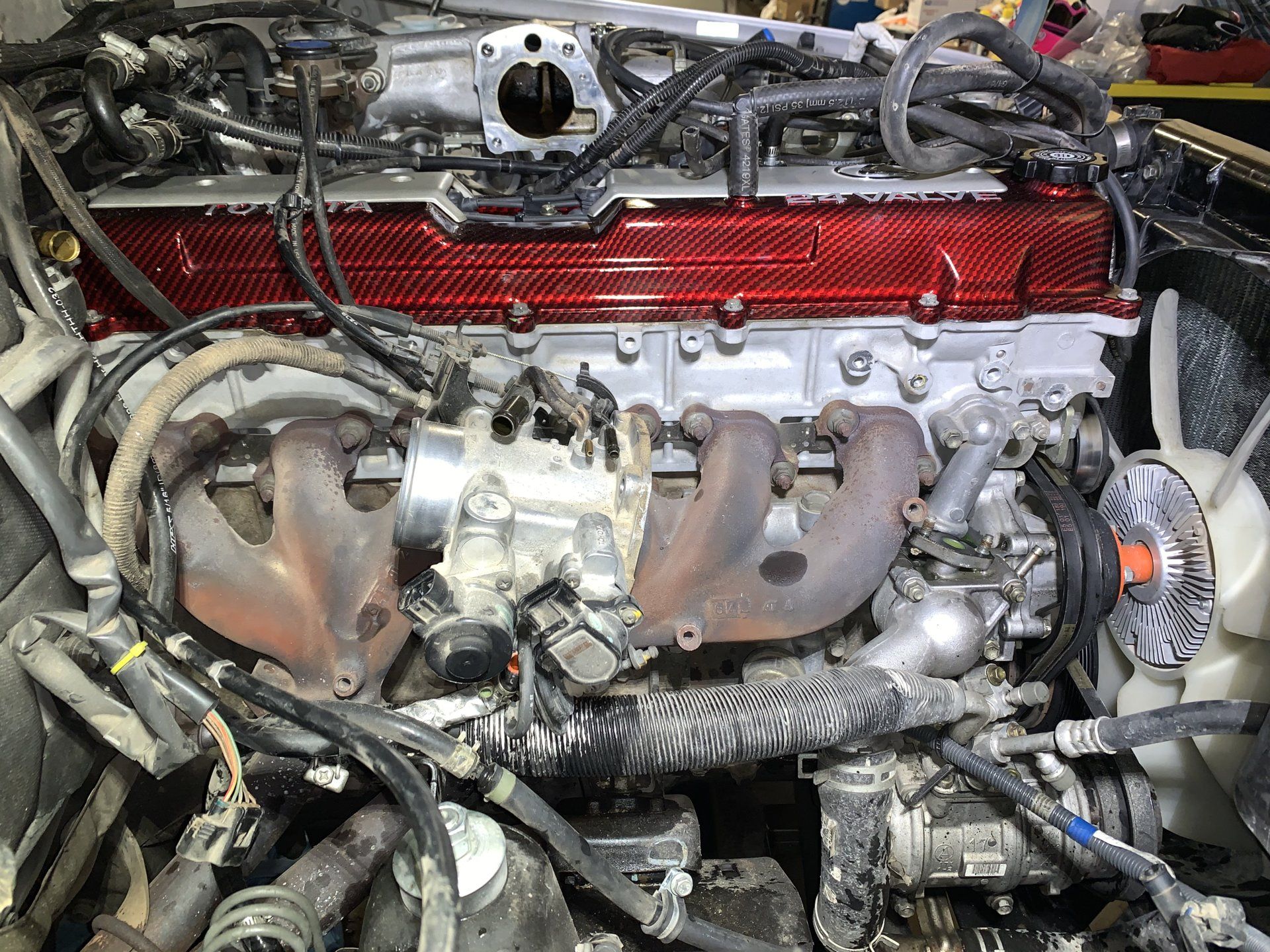

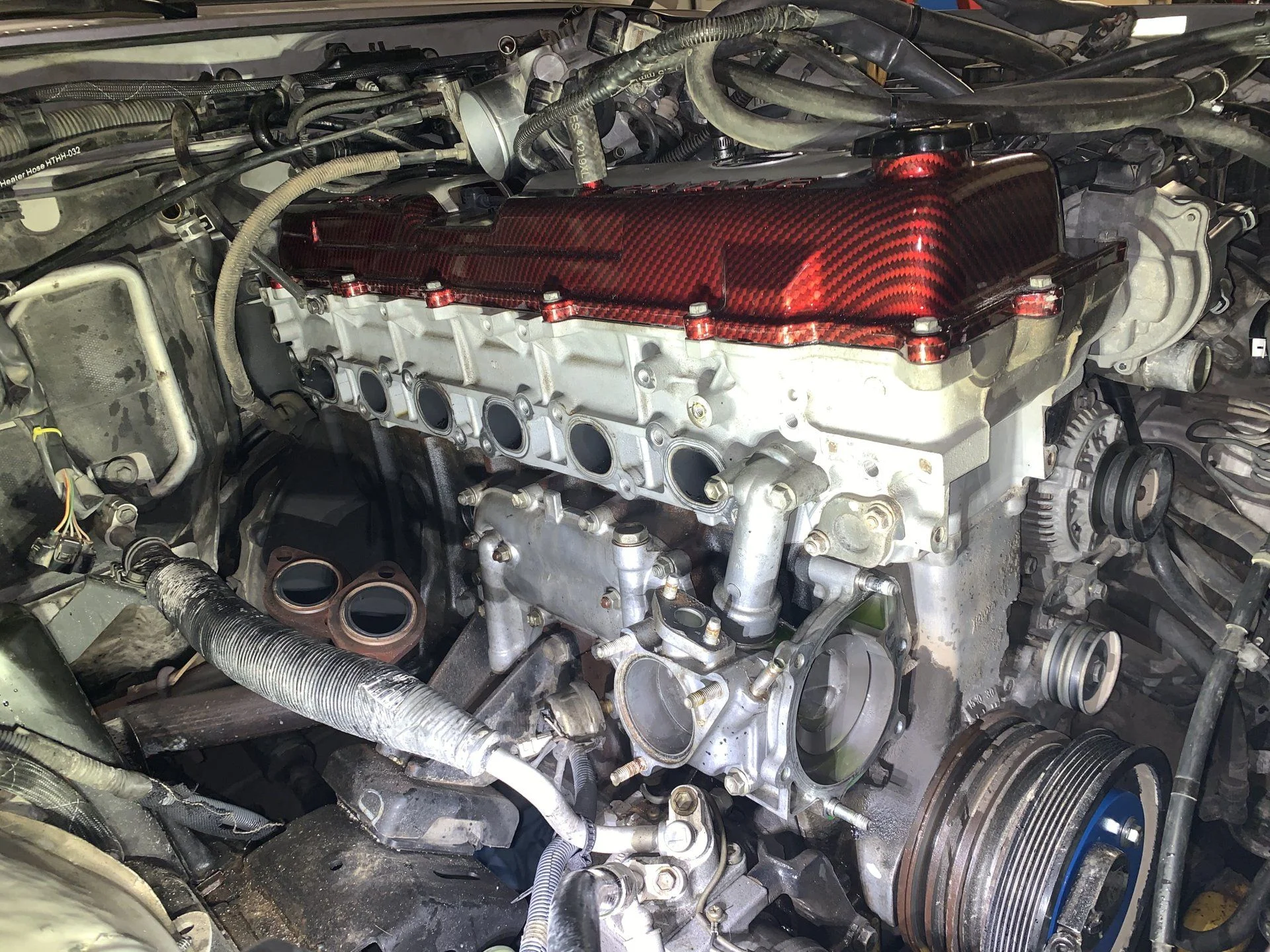

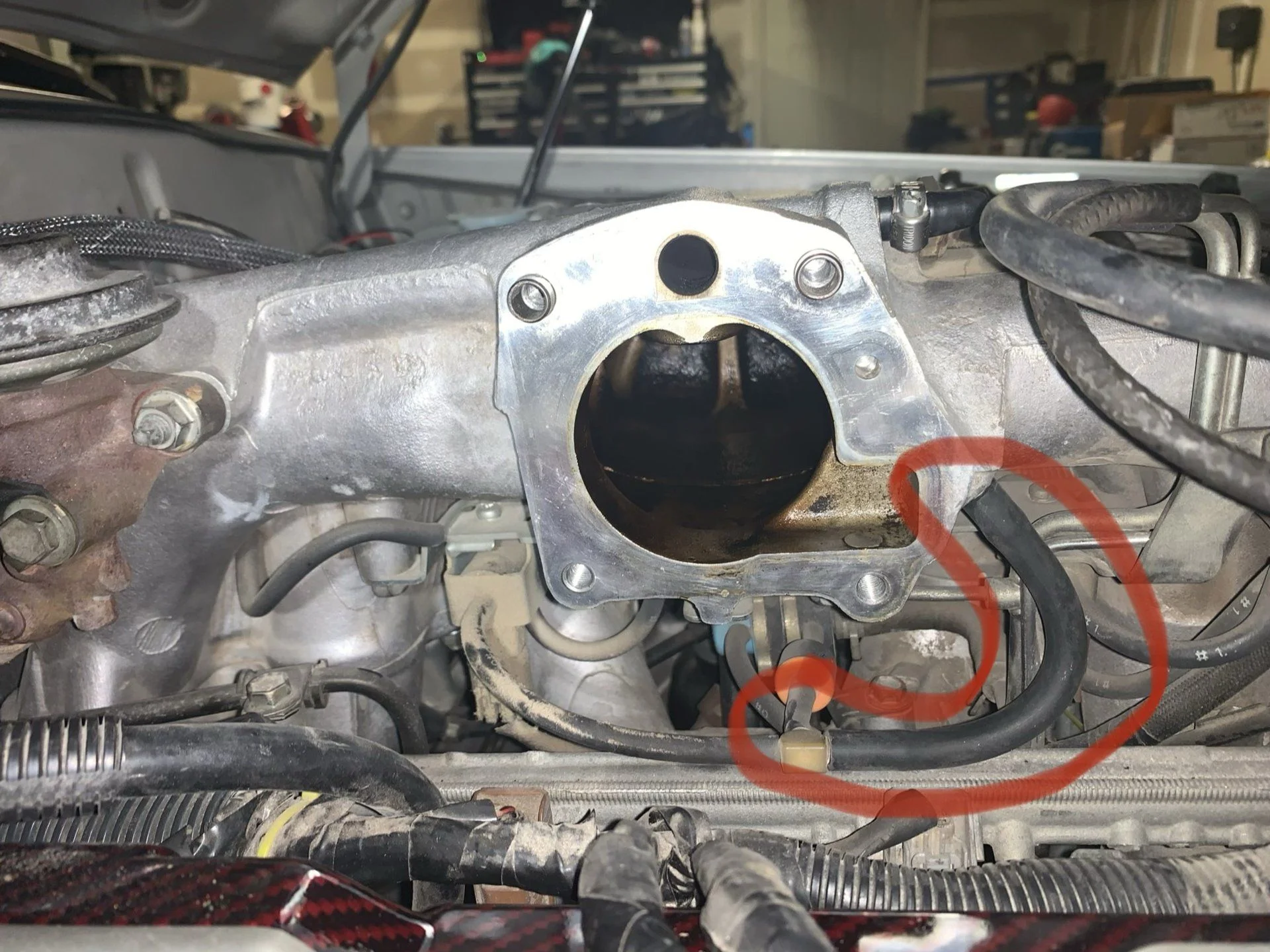

Had about an hour in the garage tonight, got the new thermostat and waterpump installed along with one of the 3 radiator hoses. Took off the exhaust manifolds and studs and sorted out the vacuum lines under the intake manifold...put them back to stock configuration.
@Onur problem solved
I had to pickup a new bypass hardline that bolts to the front of the block and routes up toward the throttle body....but I think I have to pull the dizzy to get that hard line installed. I think the hardest part about this turbo is all the Super Charger unwinding work I have to do.

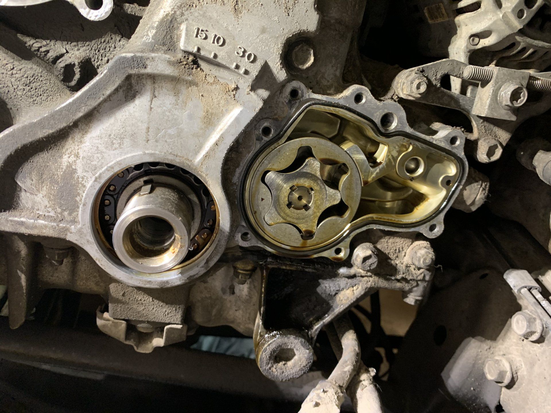

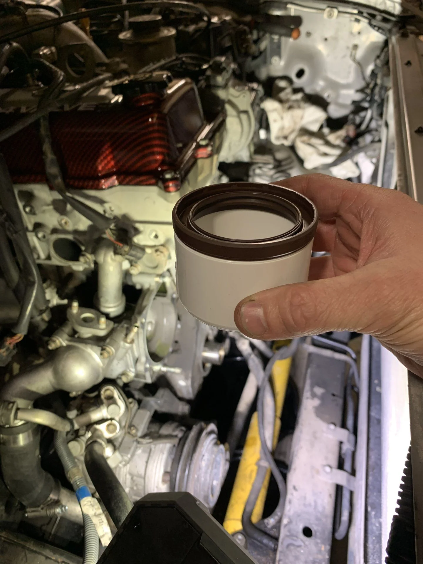

Attempt #2 at the crank pulley bolt was a success after I got a set of 3/4” drive sockets delivered. Popped out the crank seal which was still supple. Had no issues removing the oil pump cover with the #3 JIS bits from @NLXTACY. The oil pump o-ring was also still in very good shape...but they both got replaced anyway.
Joey provided the perfect sized PVC cap to press the crank seal in with, I added a thin layer of FIPG black around the edge before installing.

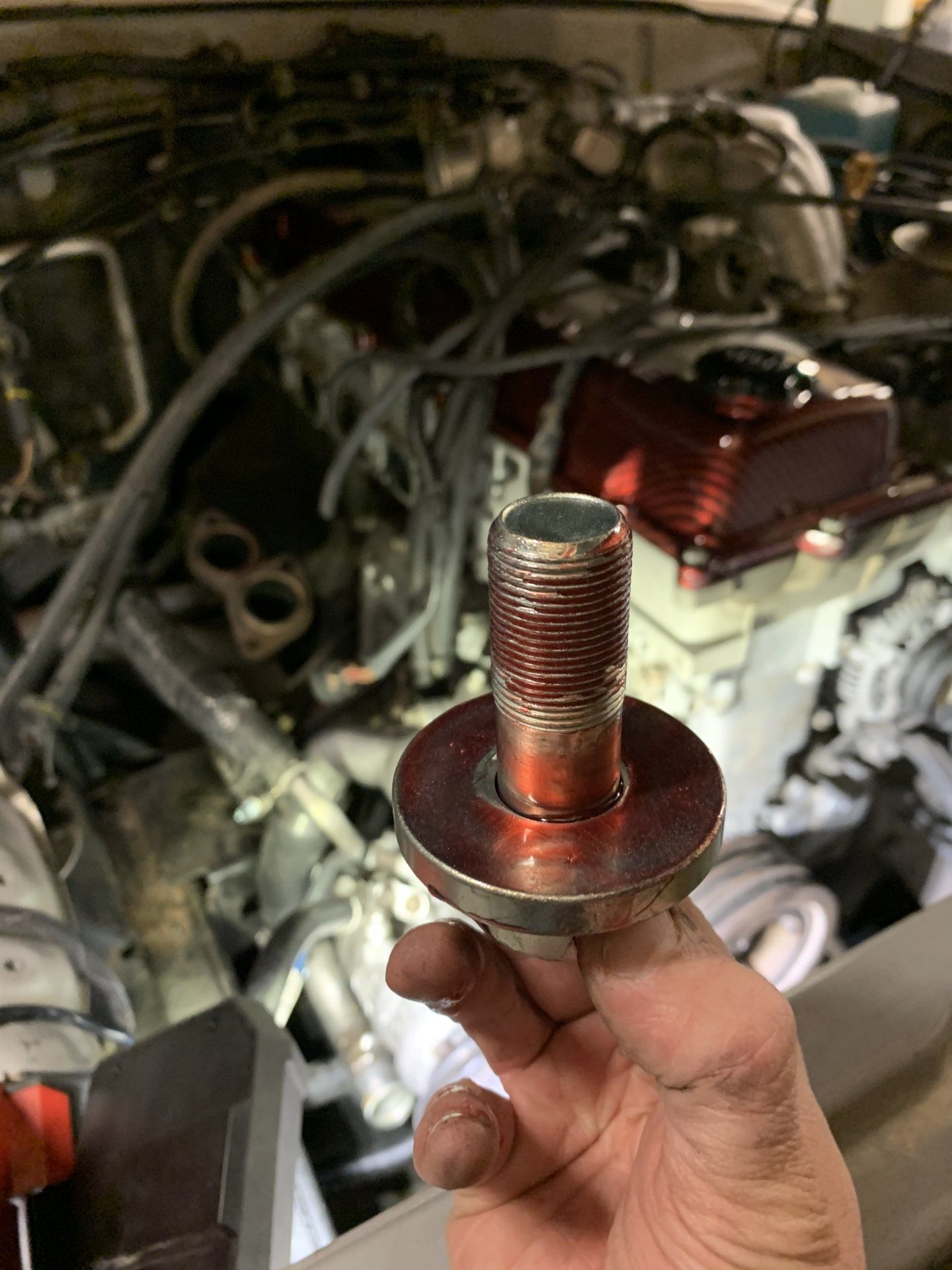

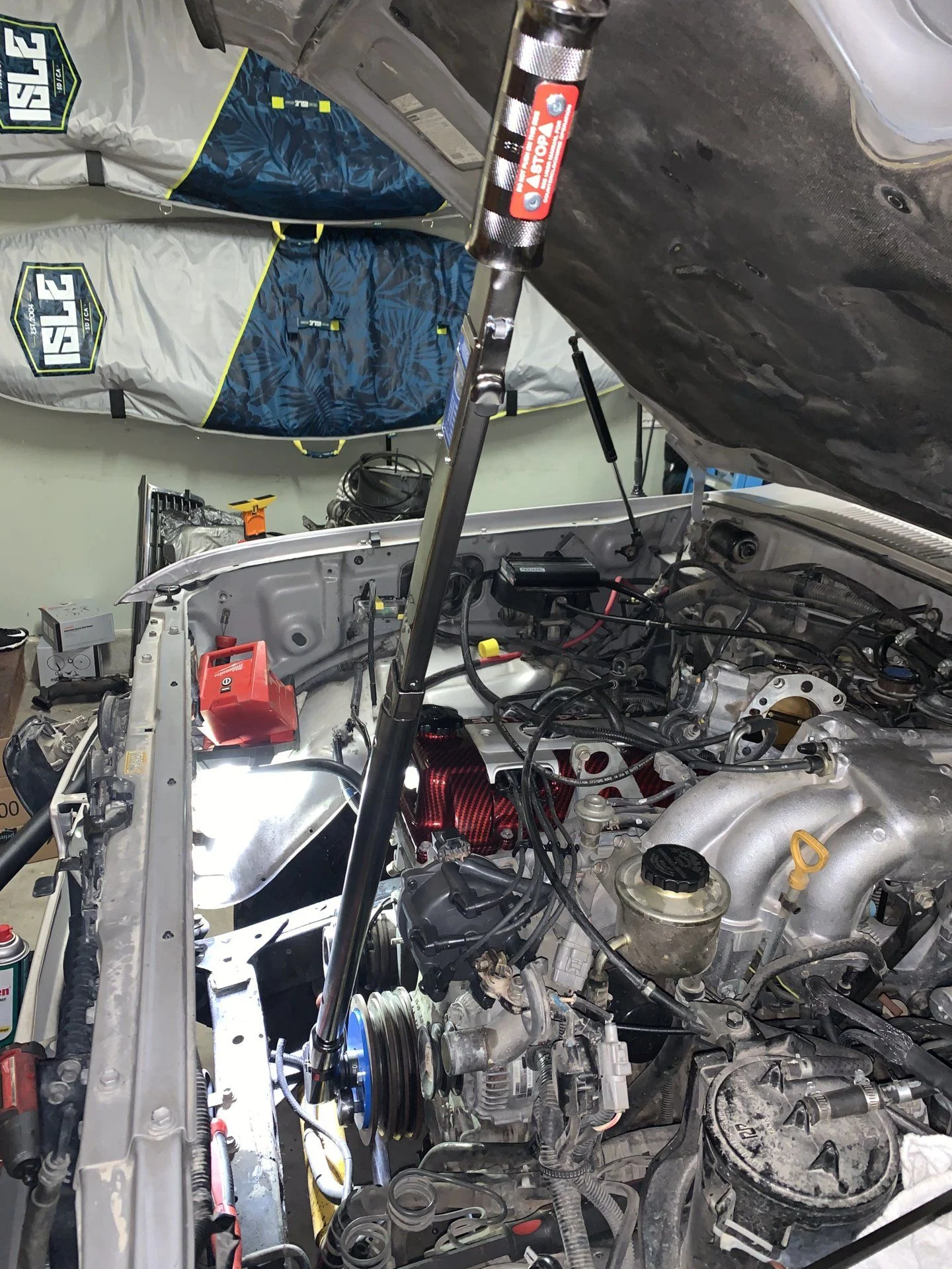

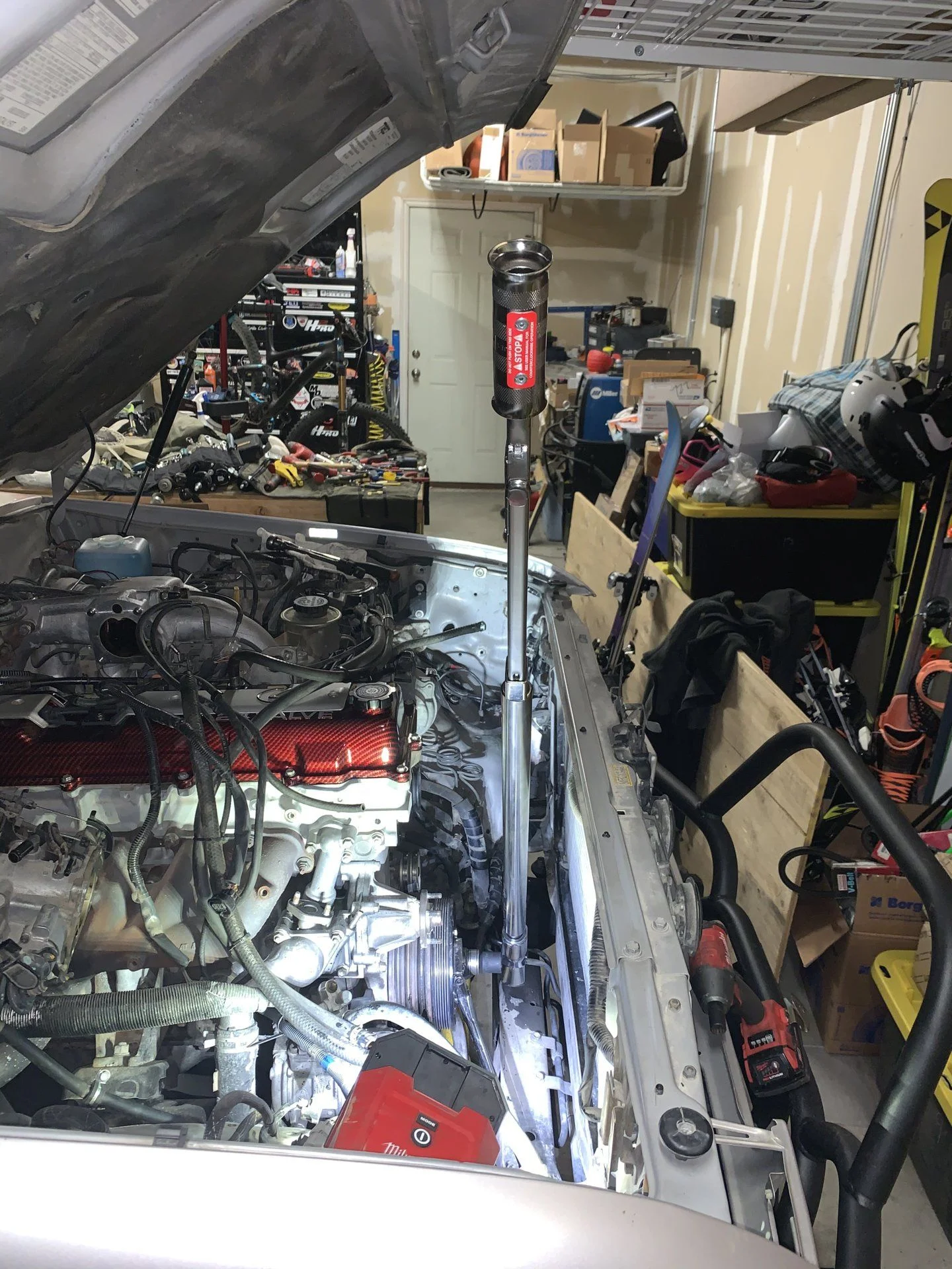

I had to buy a new crank pulley bolt since the longer one goes with the supercharger pulley. Got it lubed up well with ultra slick and using the @OTRAMM crank holding tool again torqued the bolt down to 308 ft/lbs. This torque wrench is a Monster!

Where'd you get the tourqe wrench? I rented one when I did my front main but I'd like to have one on hand.
I got it on Amazon. Not cheap, but doesn’t hurt as bad as buying a Snapon and it had great reviews. I am happy with it and I am pretty particular when it comes to my tools.
Precision Instruments PREC4D600F Wrench (3/4" Dr. Split Beam Torque w/Detachable Head (200-600 Ft/Lbs)) Amazon product ASIN B000RT8ENE
