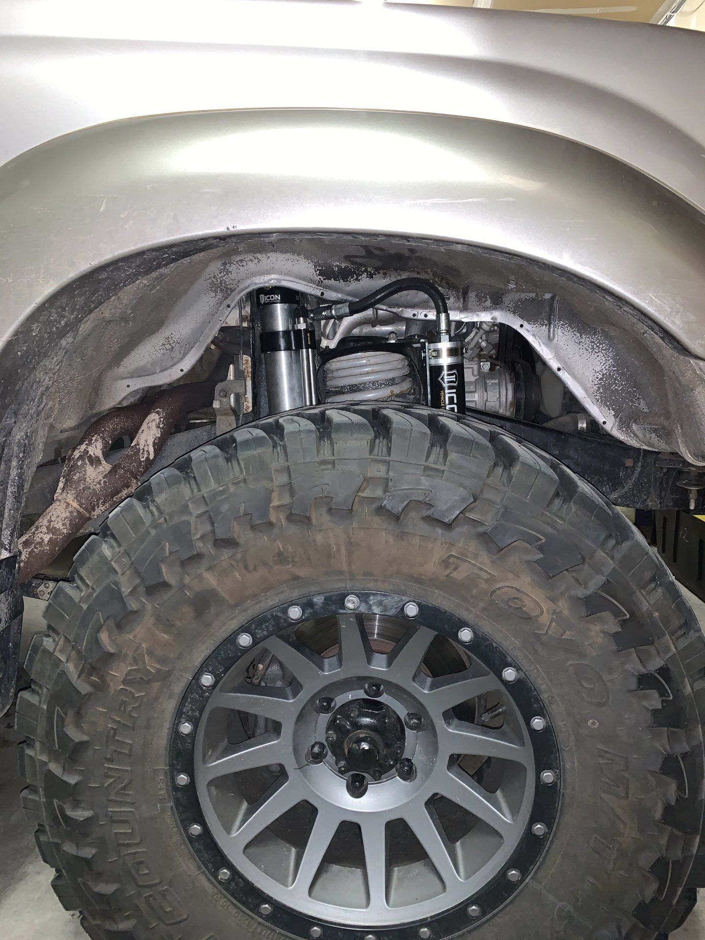

Any commentary on the suspension install? First impressions? Thank you!

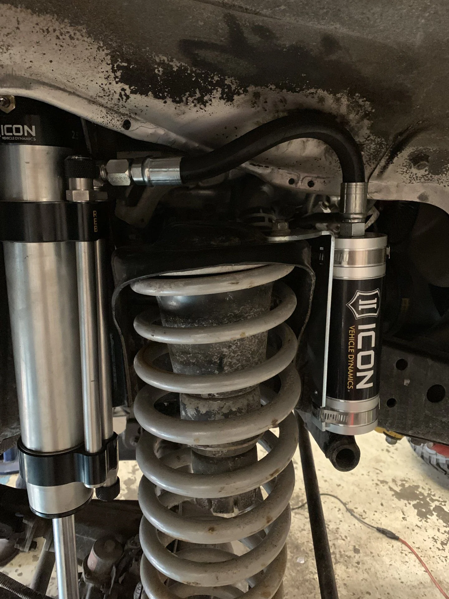

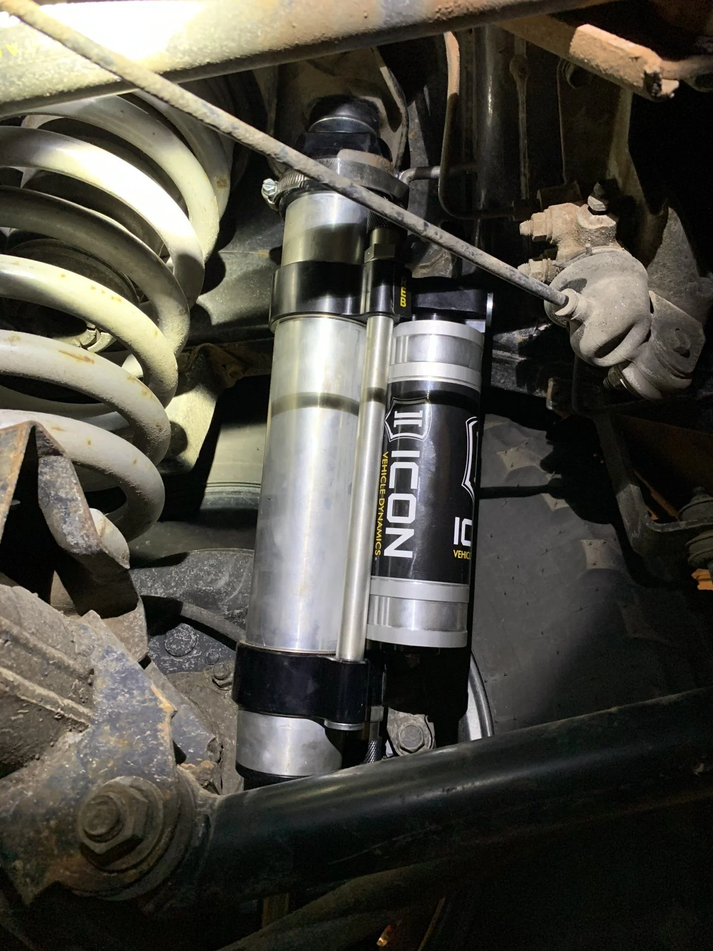

I have been running Slinky stage 1 on this truck for nearly a year and the ride is fantastic. I haven’t installed the stage 5 shocks yet...they are going on this week though.

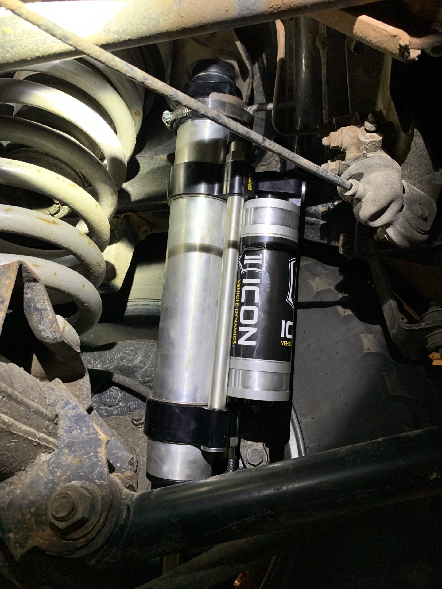

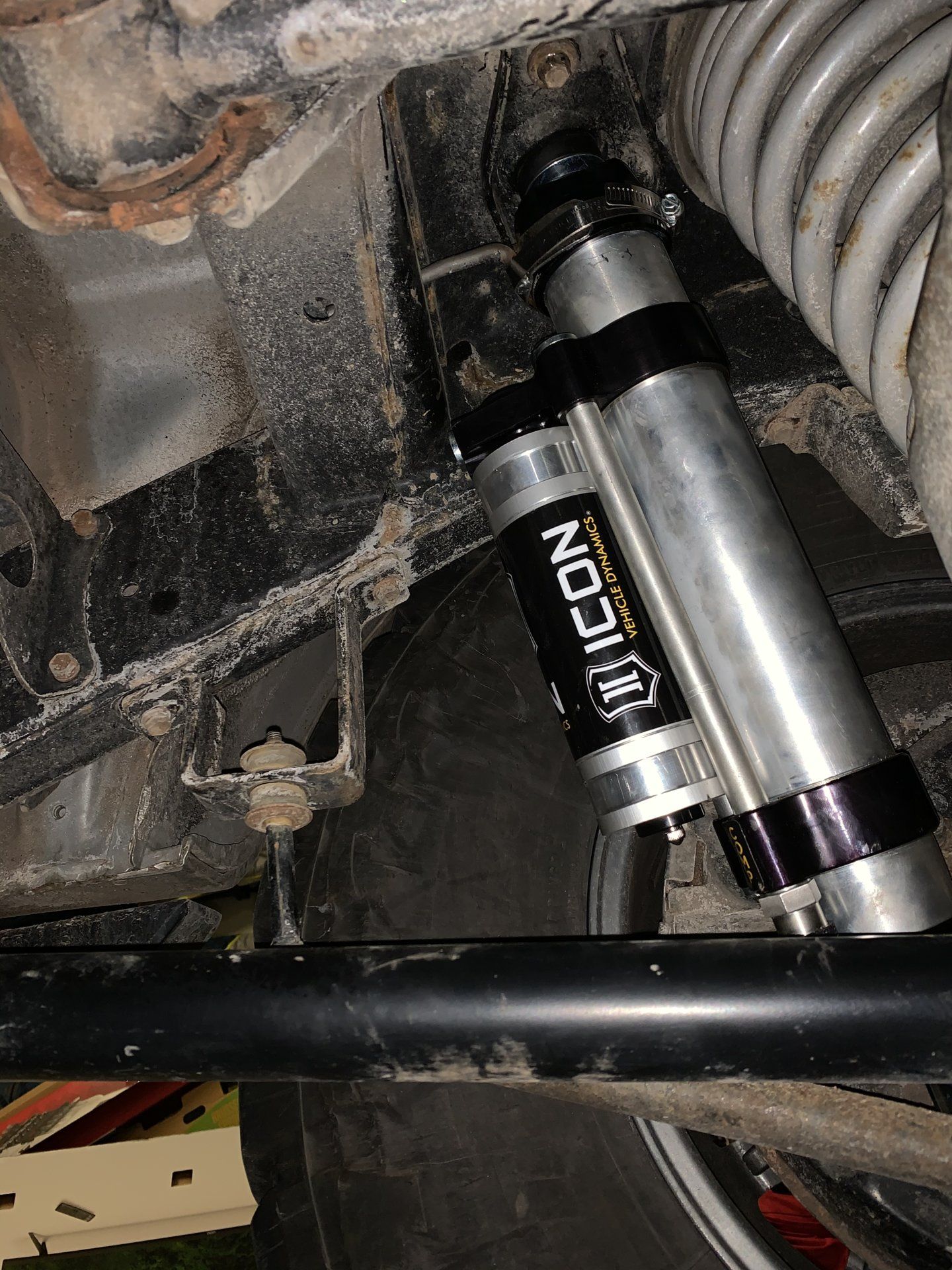

Today I got the Stage 5 slinky dual bypass shocks installed...they sure look pretty.
So far I have only done some on-road testing, but hitting the roundabout at 40mph and going over the roundabout rather that around it felt pretty good.

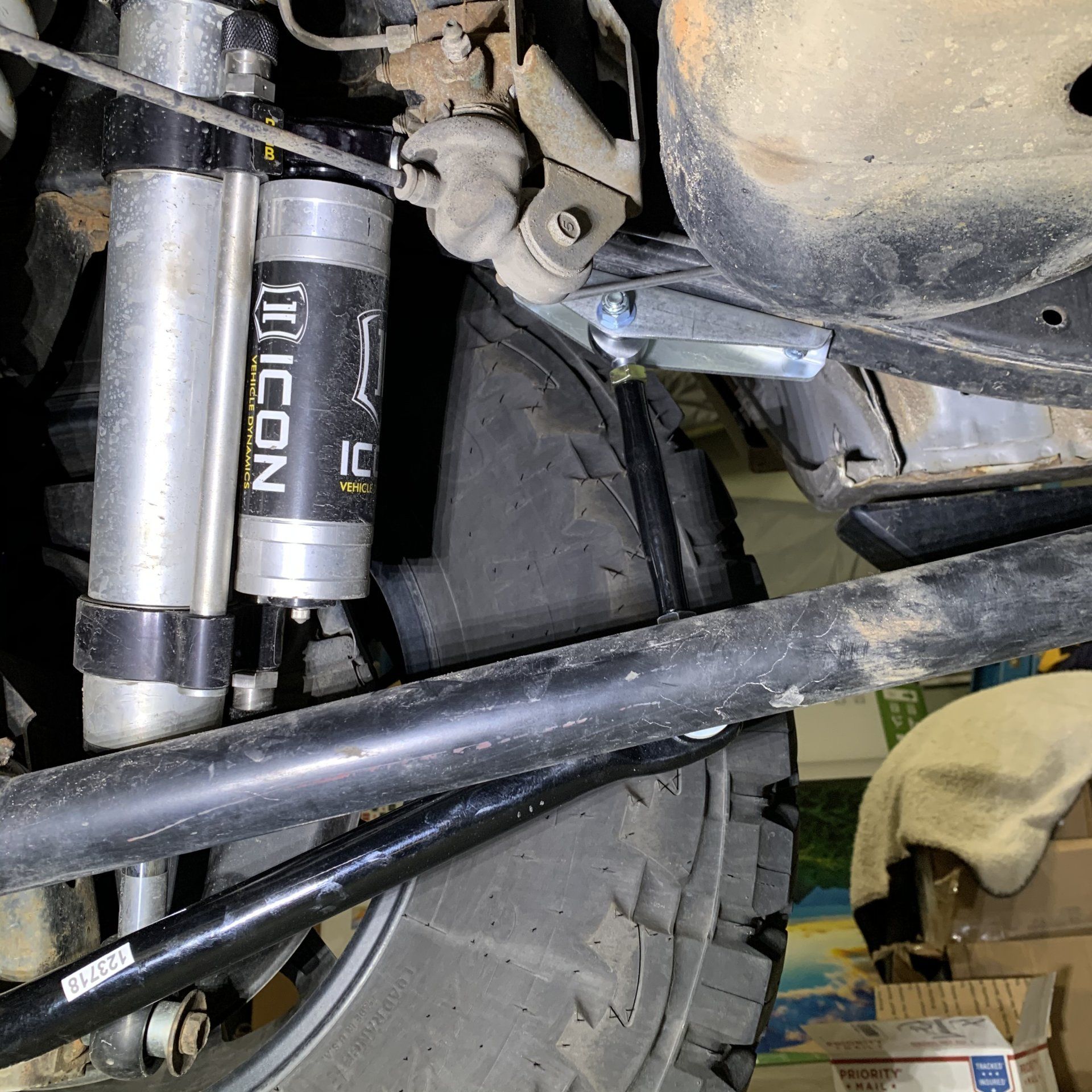

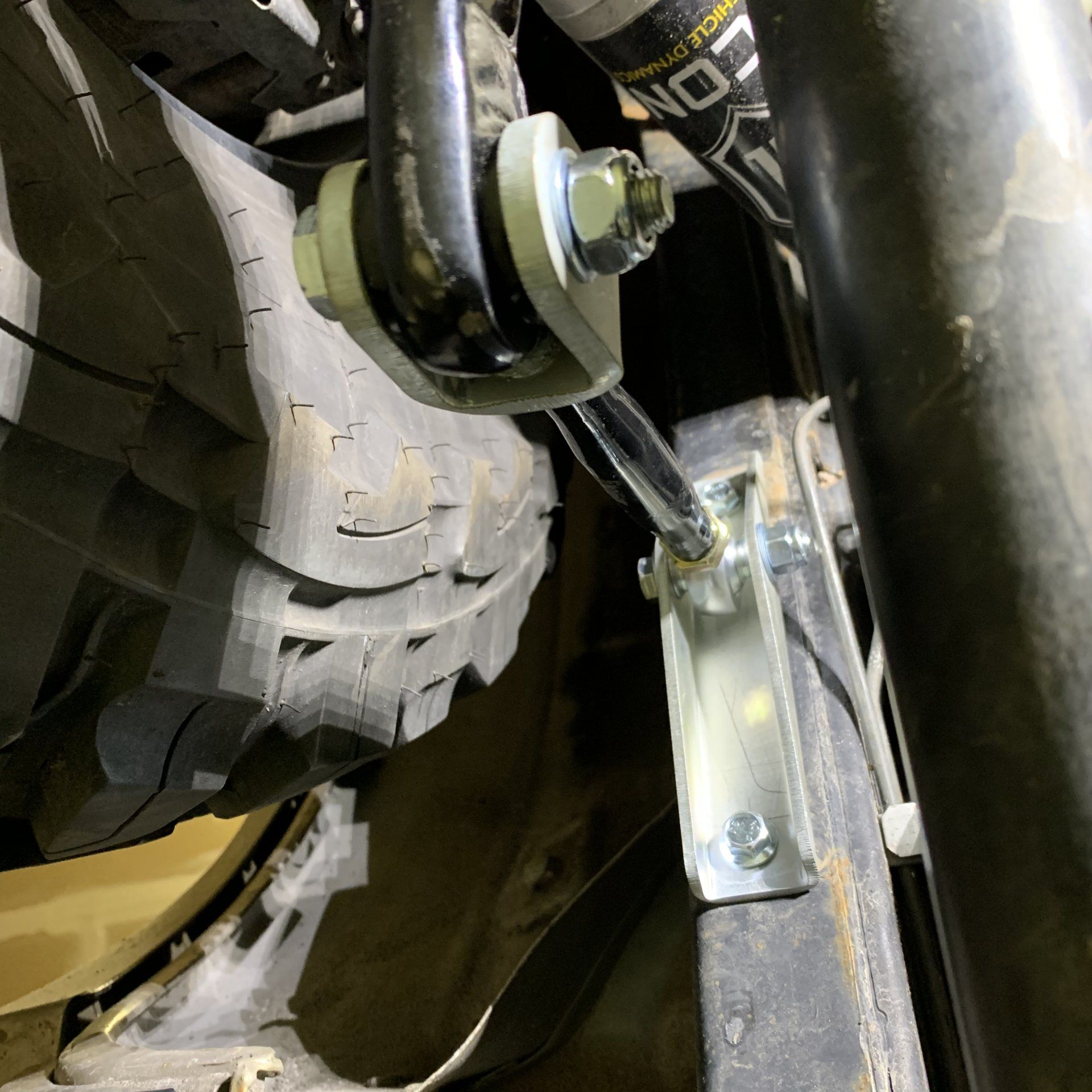

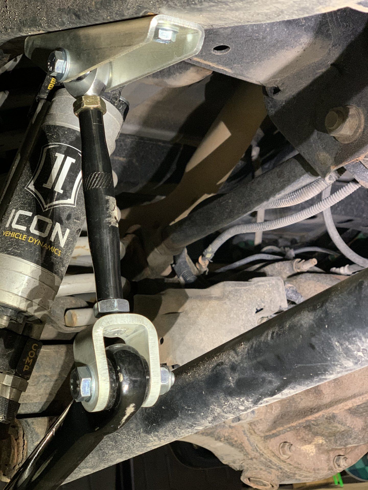

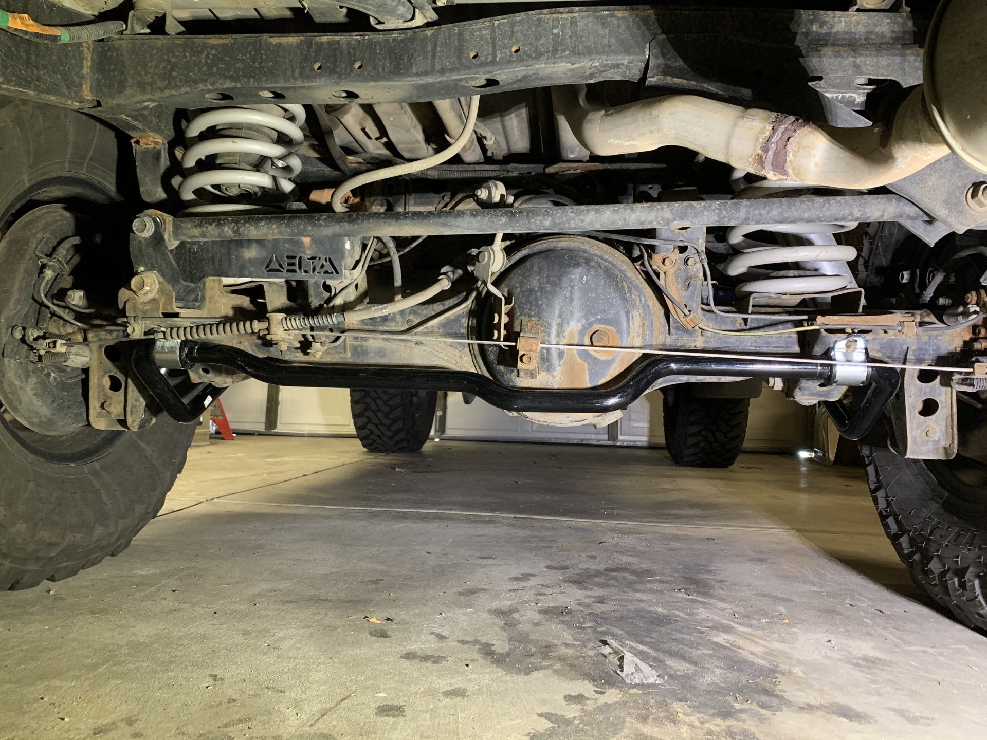

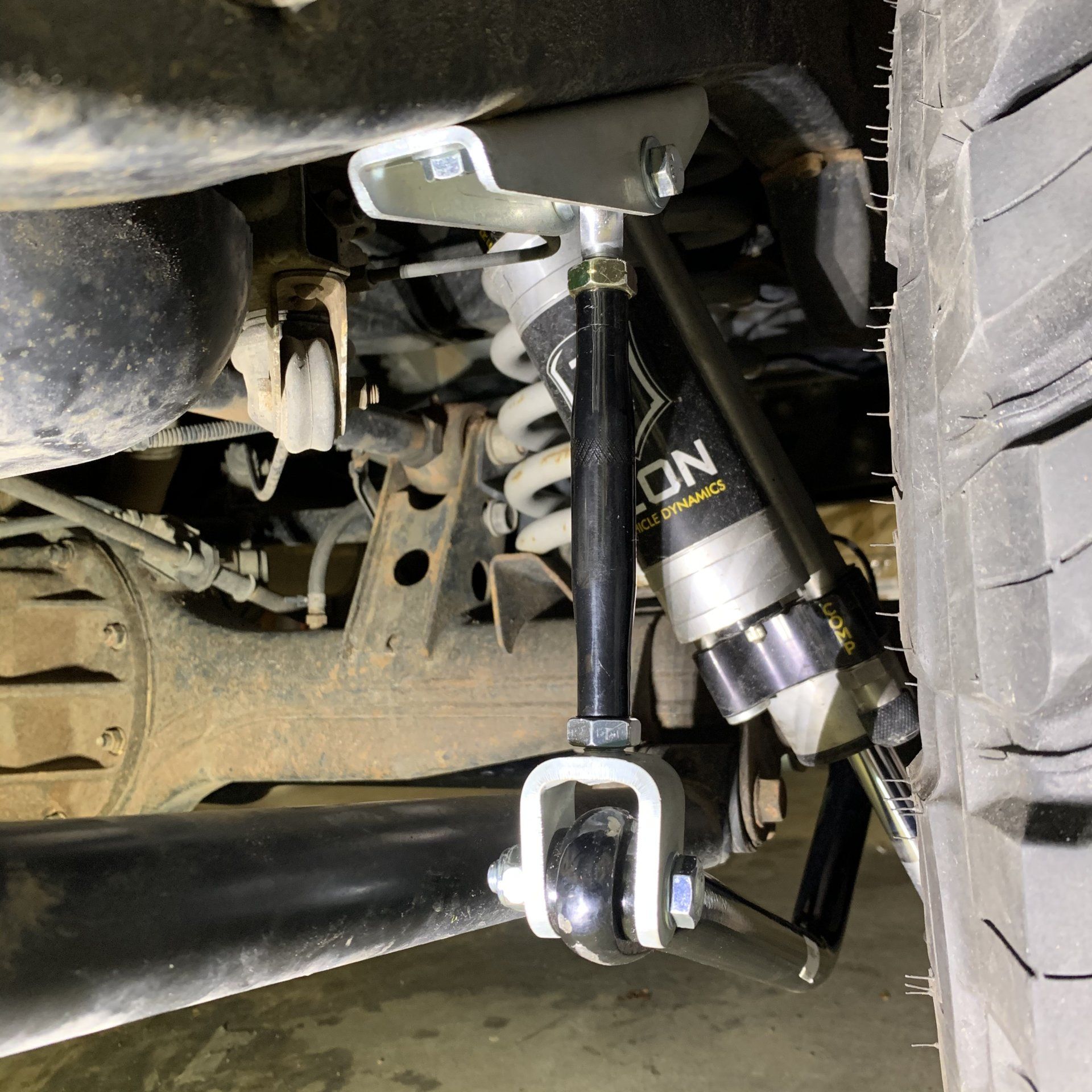

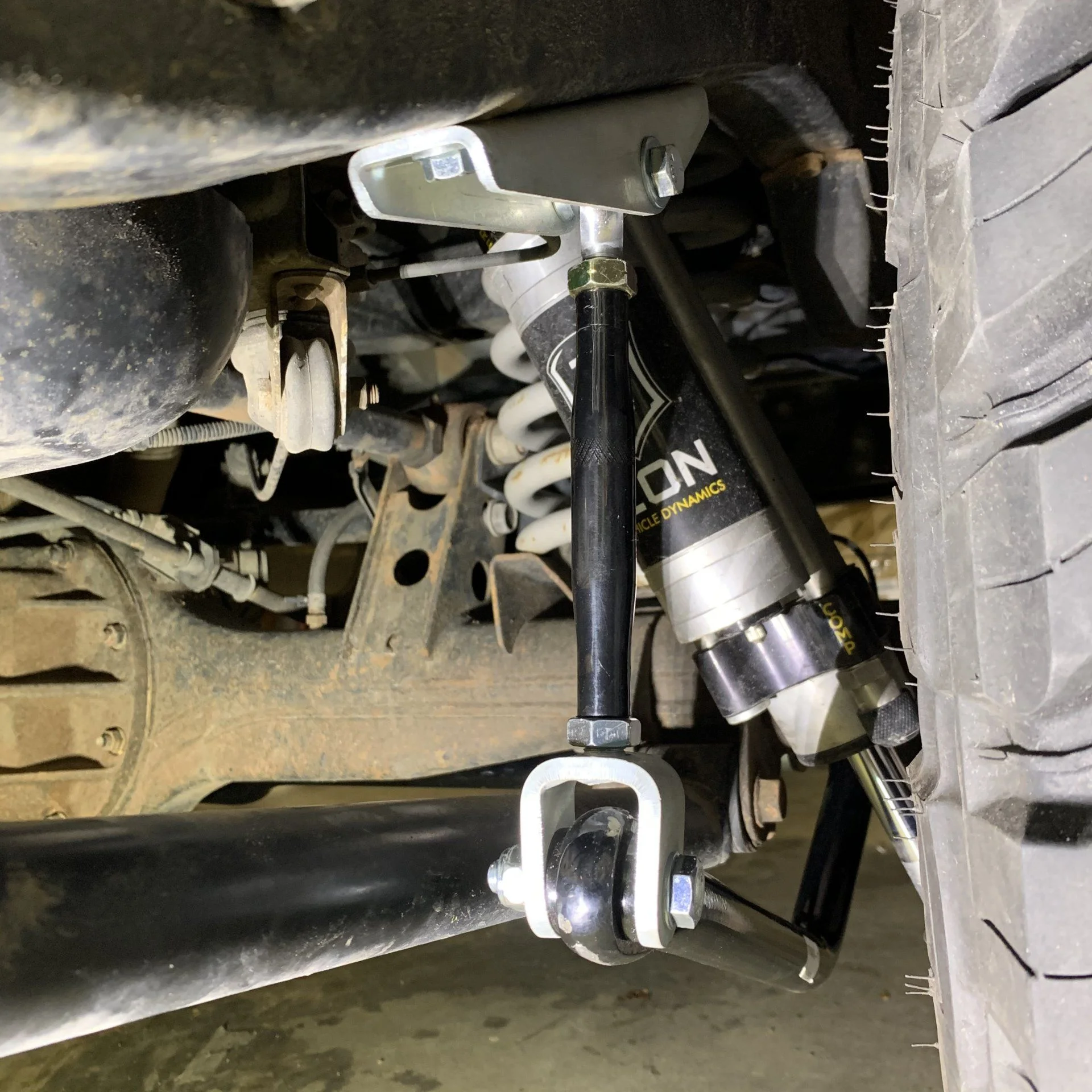

Spent an hour this morning replacing my rear sway bar with a HD white line bar from John @2KCruiser and a pair of Phil’s @LandCruiserPhil rear sway bar links. These links replace the Factory straps and incorporate a heim joint on the chassis end to eliminate/reduce binding and subsequent bushing deterioration that is common when running HD sway bars. I also like that they are adjustable without having to remove from the truck.

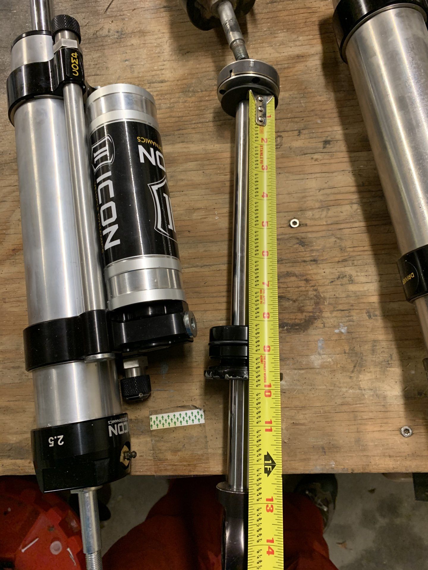

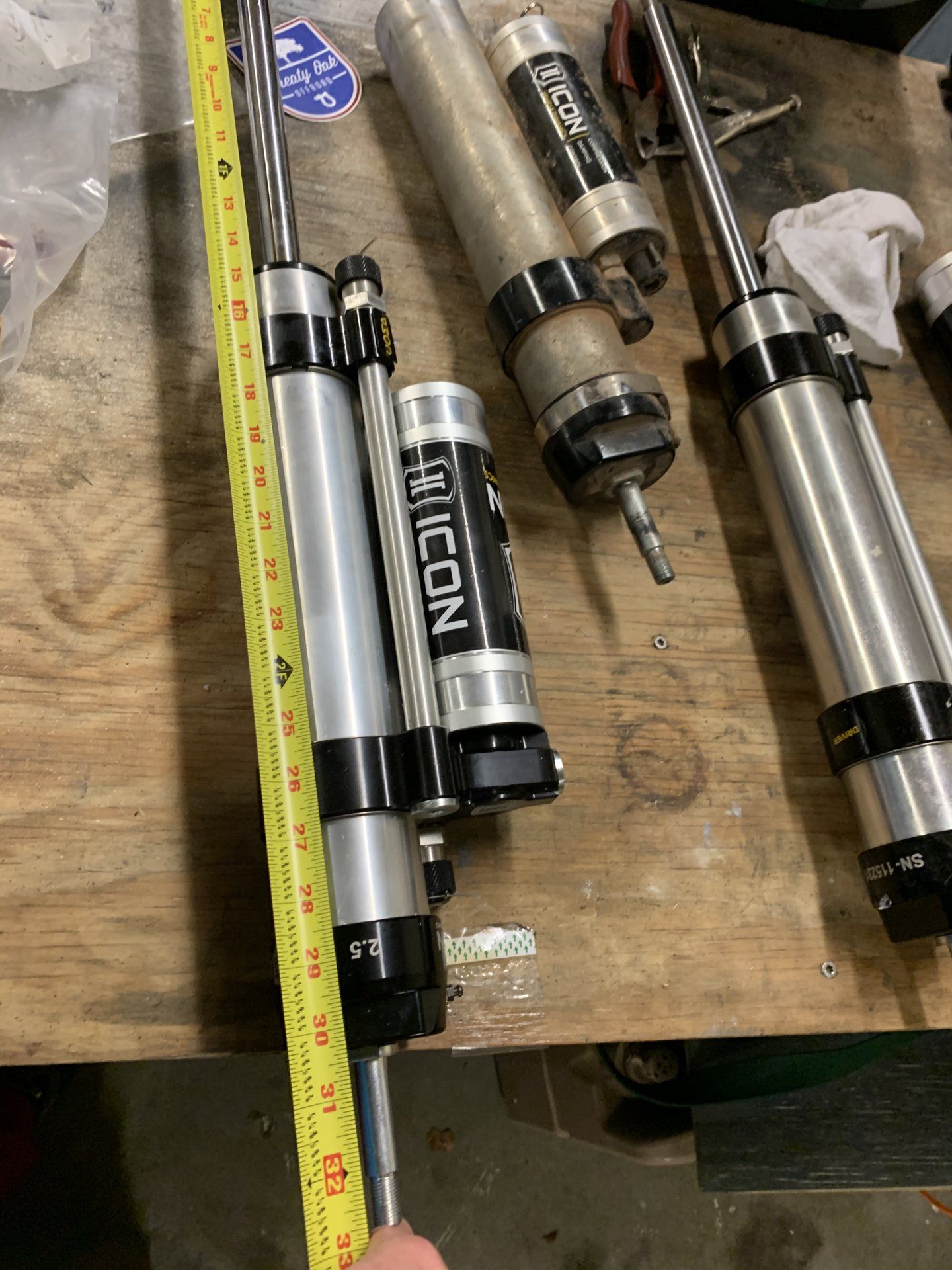

Do you know the collapsed and extended lengths of your rear shocks? Those swaybar links are freakin sweet dude.
Yes these links are bomber. The improved handling with the HD sway bar and links is very noticeable, I’m very happy with the result. In about two weeks I’ll be able to give it a more thorough test when we head out into the west desert for the annul Freeze Your Tail Off event.
The overall length of the rear shocks when extended is 33” This is from bottom of eye to top of pintop
The shaft length from bottom of piston to top of lower eye is ~13” which I beleive translates into ~12” of stroke.

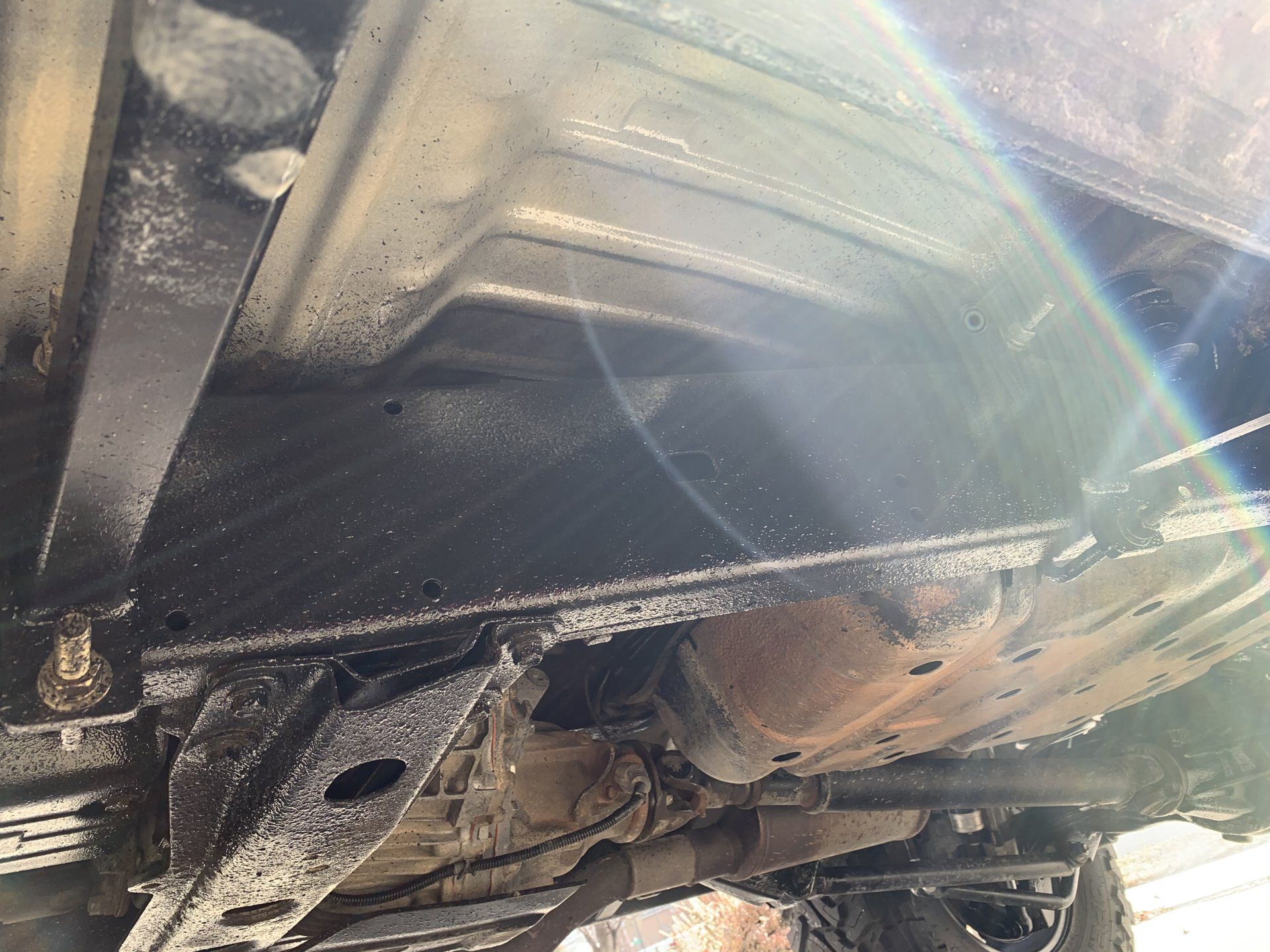

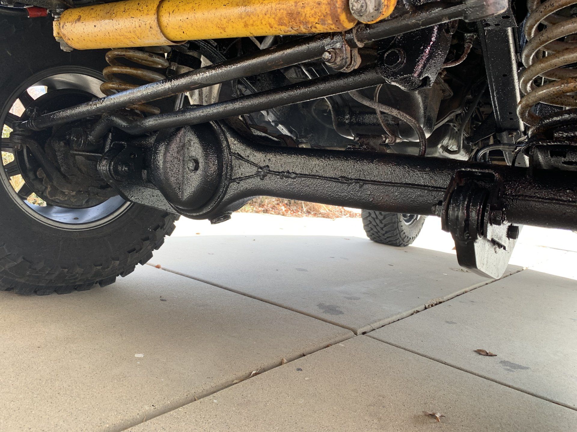

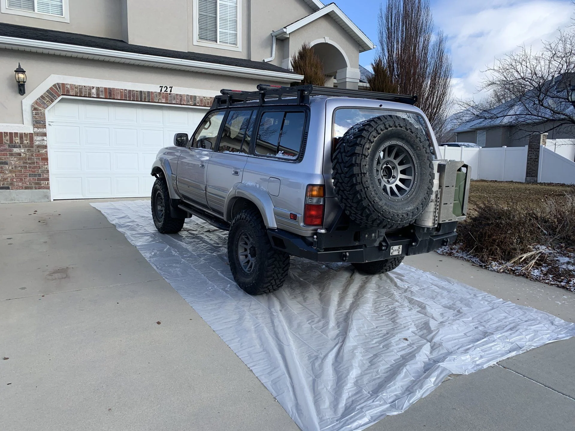

Since the LX is my primary Daily Driver and I am spending a lot of time up in the mountains I figured I better get a good solid coating of rust protection under the truck. I washed the truck twice and then took out the power washer to get all the remaining salt residue off. Let it dry overnight and this morning setup my Dexter’esk poly drop sheet and Donned a Tyvek suit.
I used Woolwax Black on the entire chassis, axle’s and suspension components and then used Fluid Film on all the sheet metal. The Fluid Film definitely sprays nicer than the woolwax as it is a thinner substance, but I am happy with the result and feel good knowing those rust demons will be kept at bay.

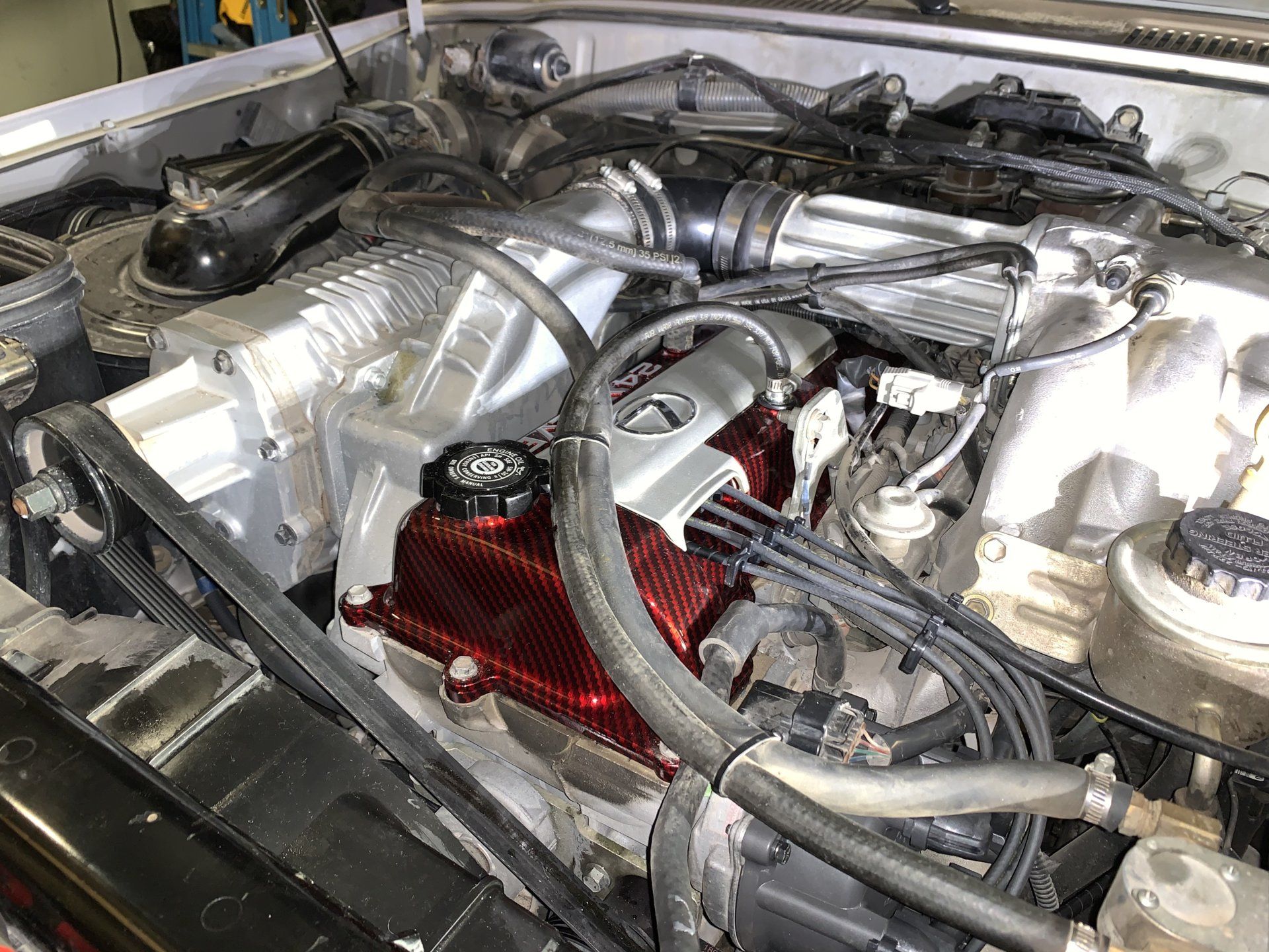

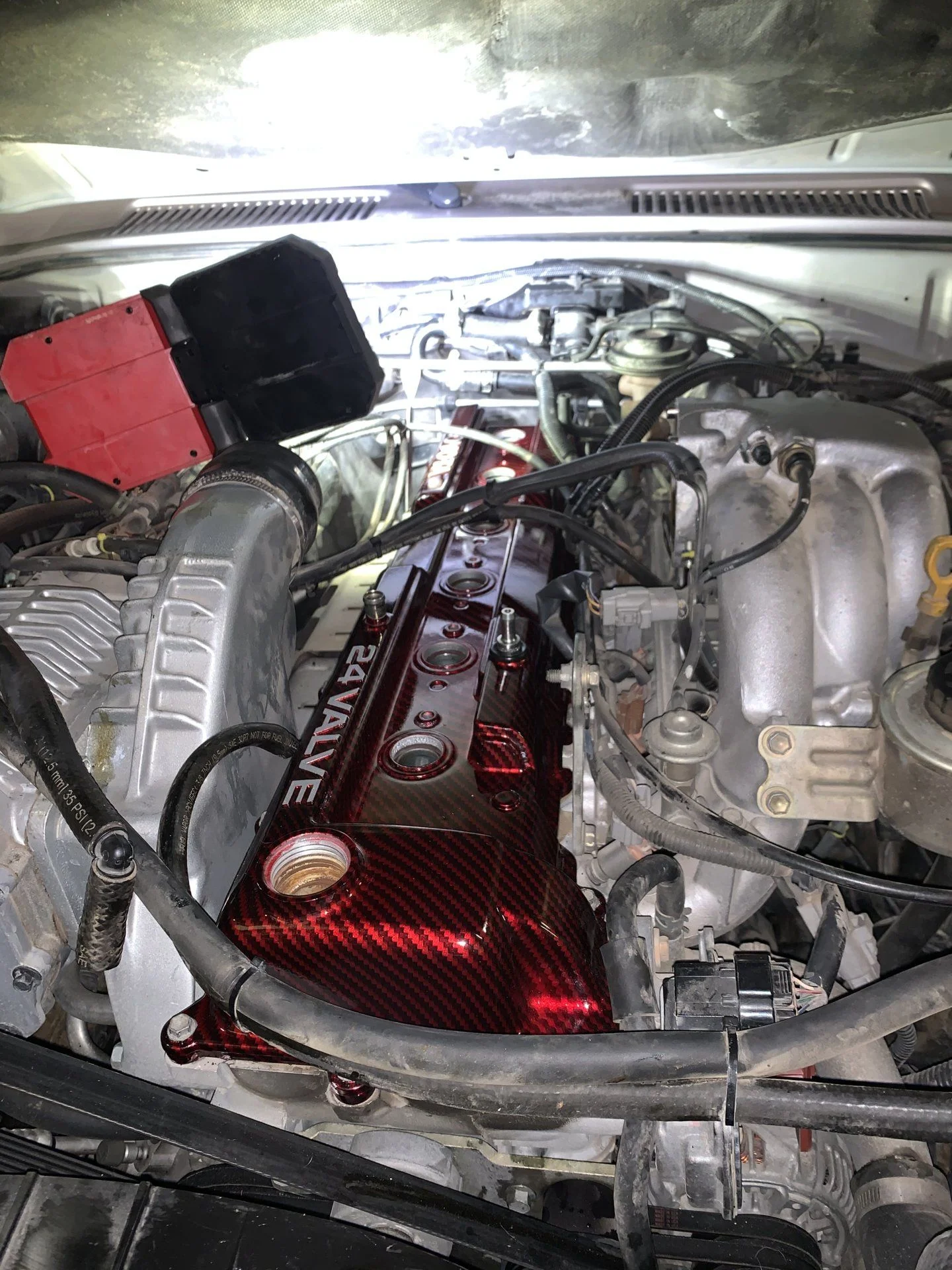

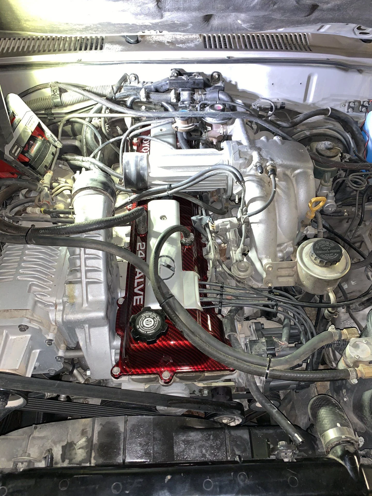

Finally getting started on the turbo install. I started out with changing out the plugs, wires, rotor, distributor cap and seal. The plugs and wires we all in good shape, so have held on to them for spares.
I also installed the refurbished spare valve cover along with a new PVC valve, grommet, spark plug tube seals and cover gasket...so much bling!
