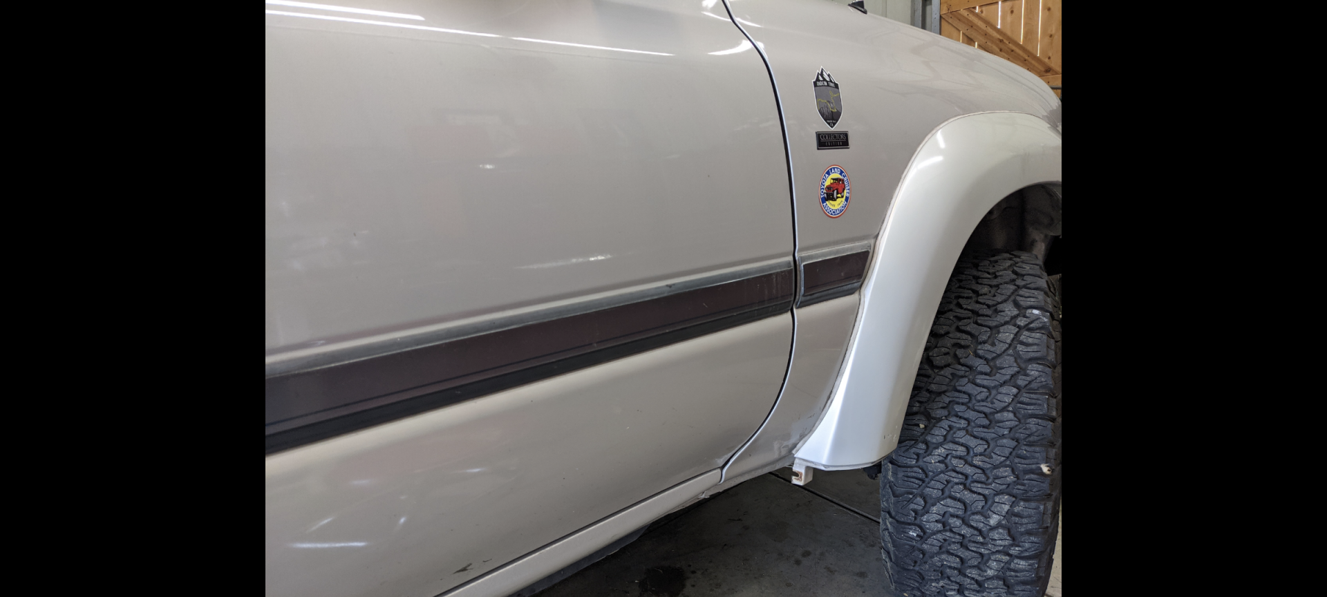

I now need to figure out how to repair the plastic flare stand offs that snapped, been thinking JB weld or small counter sunk stainless screws through the flare into the square plastic pucks

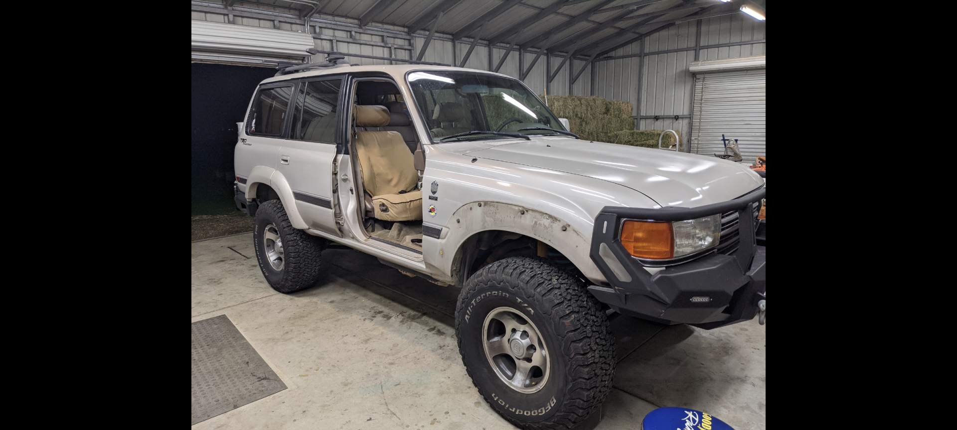

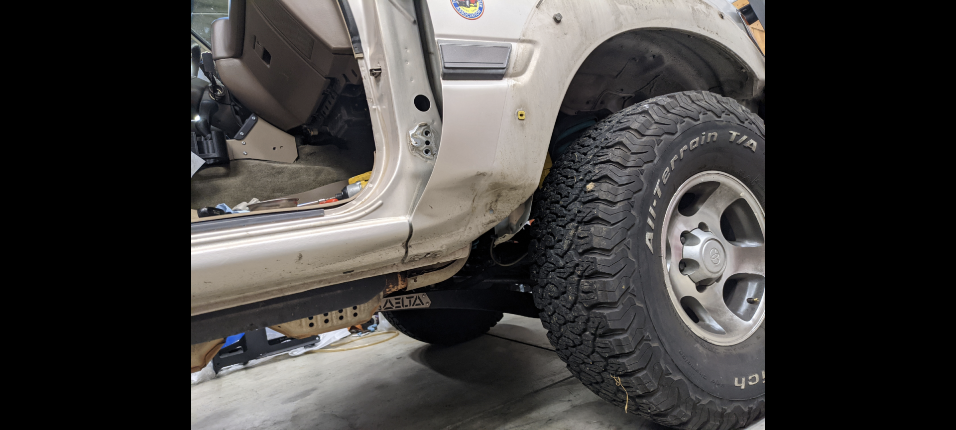

Wait did @BillyGoatMTB do the rubicon without sliders?
No sir! 🤪 That would have been 80 series abusive destruction. I love, love, love my 80.
I put on a set of metal tech 4x4 DOM sliders, they did great.

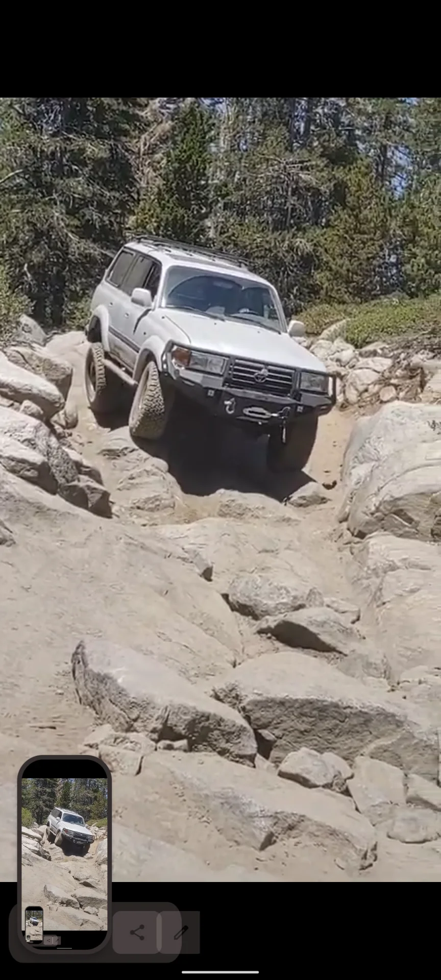

My two friends Chris and Allen are super into Jeeps and have a lot of Wheeling / rock crawling experience. They spotted me on everything. I believe that's the primary reason I didn't take on any heavy damage. Must have been dozens of close calls.
There are a few spots like at the bottom of big sluice I thought for sure there was no way the 80 series was going to fit through, I mean it was close.
When I watch this video I laugh and remember how much this was a Huge pucker factor for me.
Putting those @Delta VS radius arms to work 🤣
