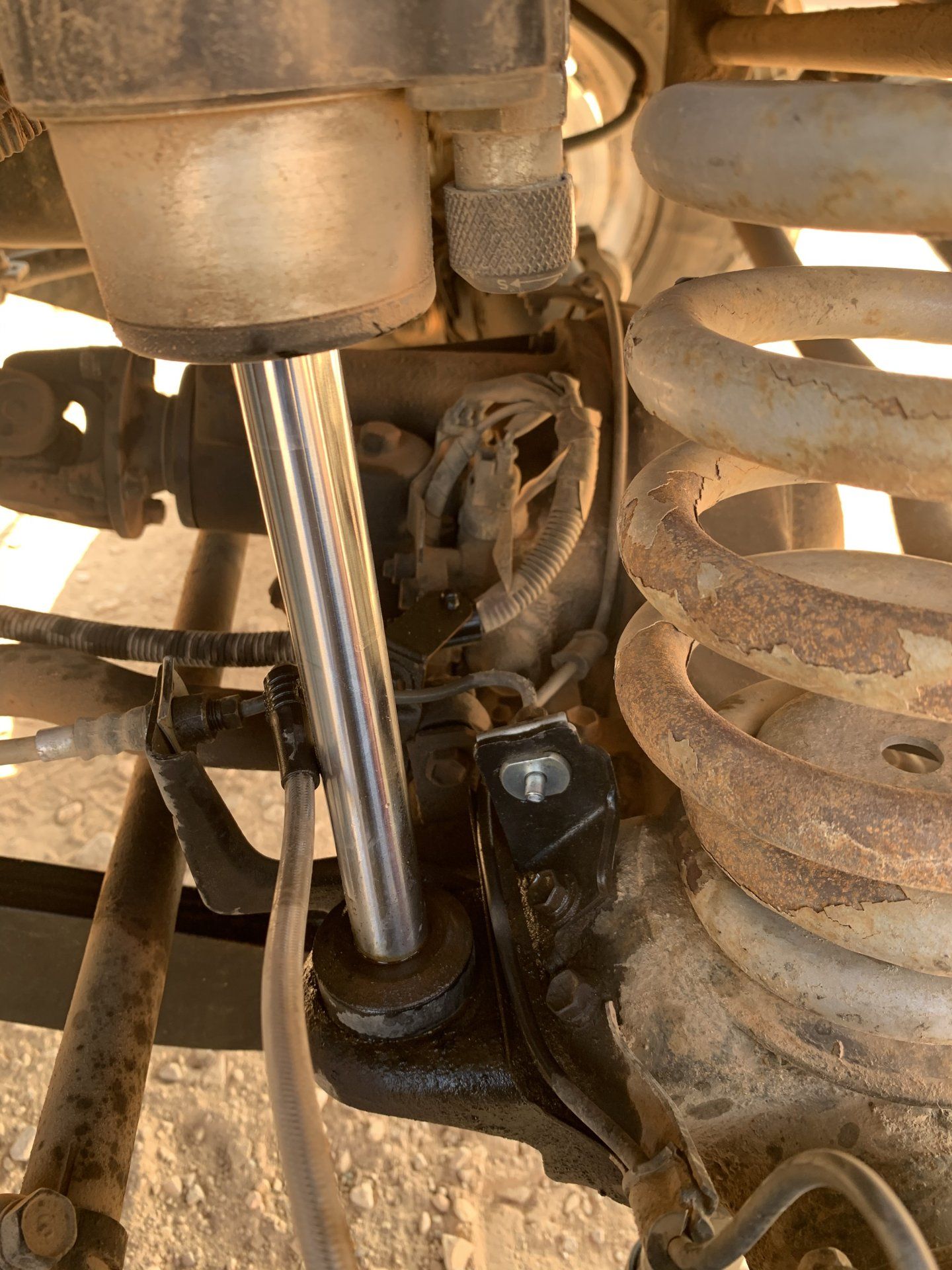

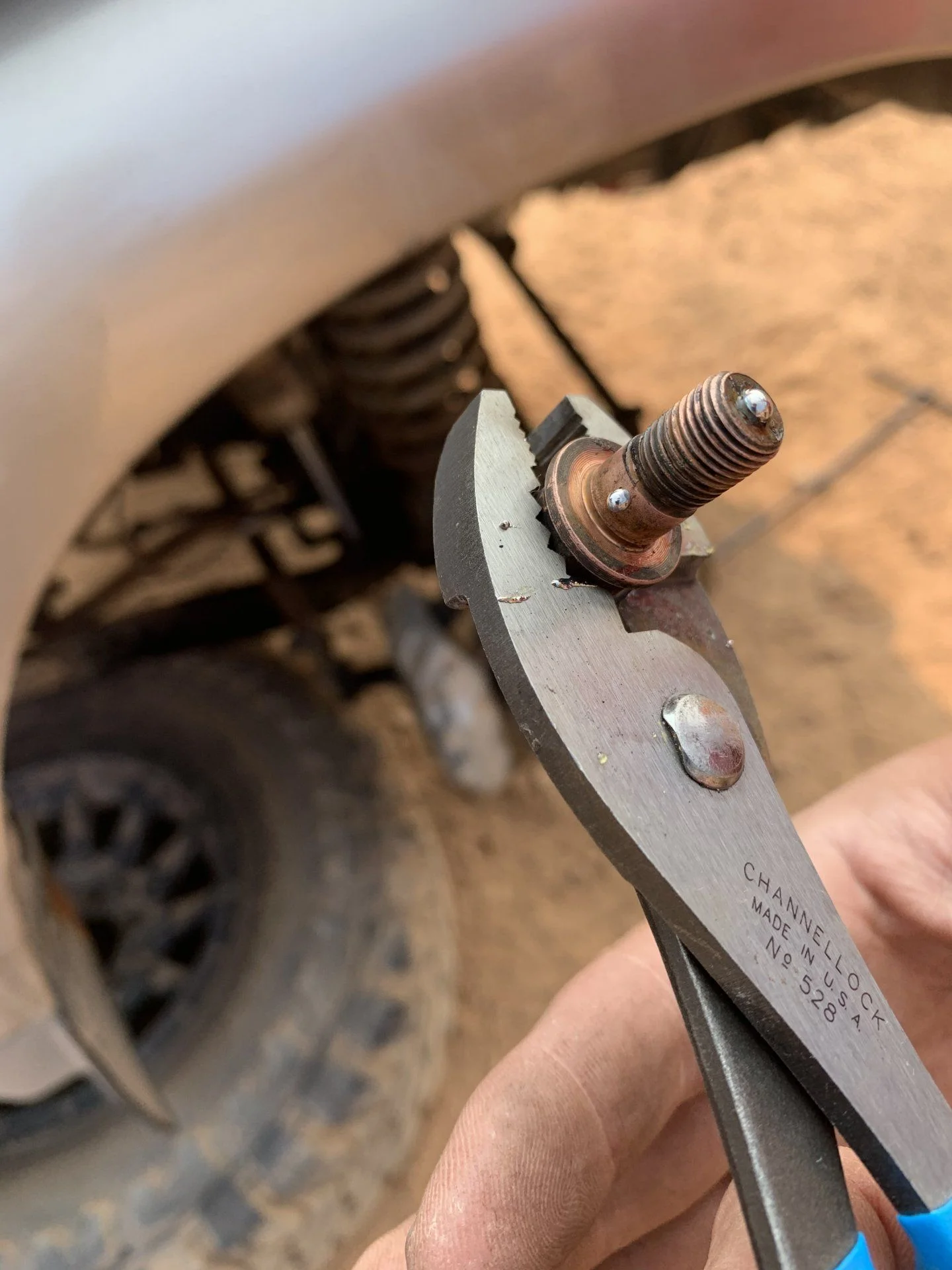

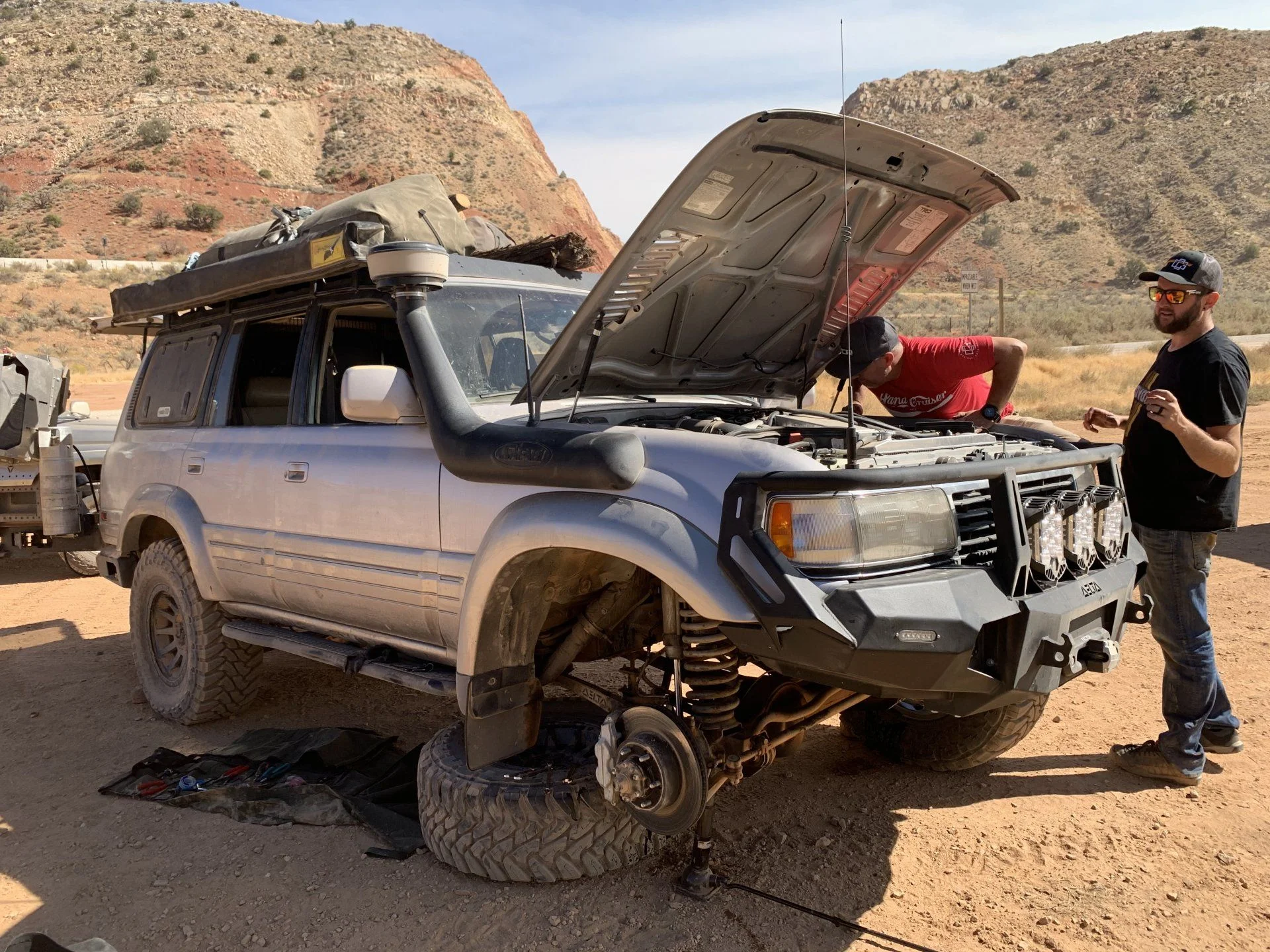

Brake line trail repair repair n full swing...pretty happy with this solution.
Snapped off at the crimp when the bypass adjuster made contact. I had my compression set way too soft and am not running extended bumps....yet.
Evaluating options
Soldered up spare banjo
Completed plug
Ready to roll again

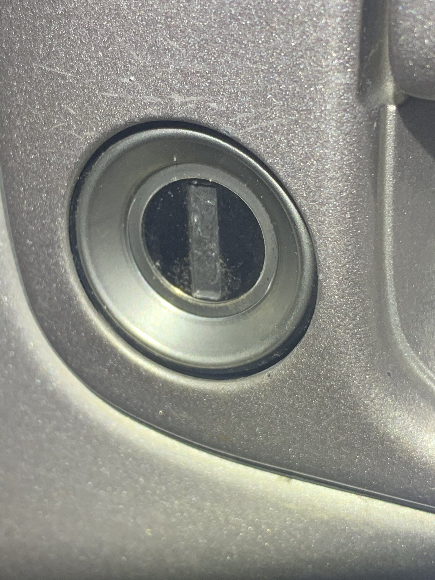

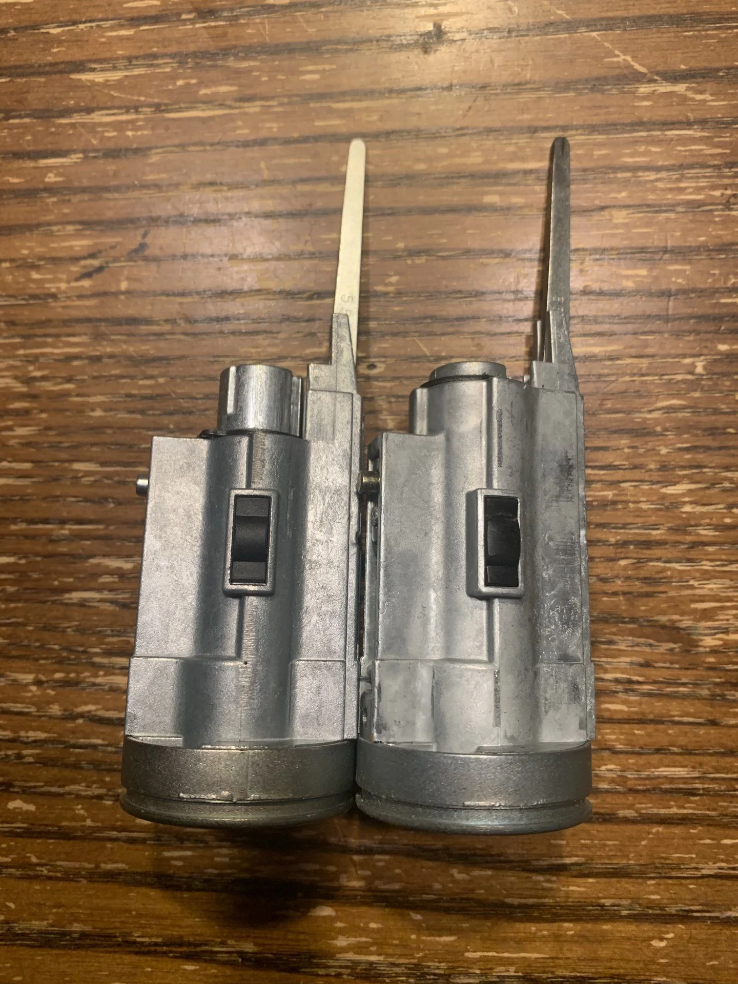

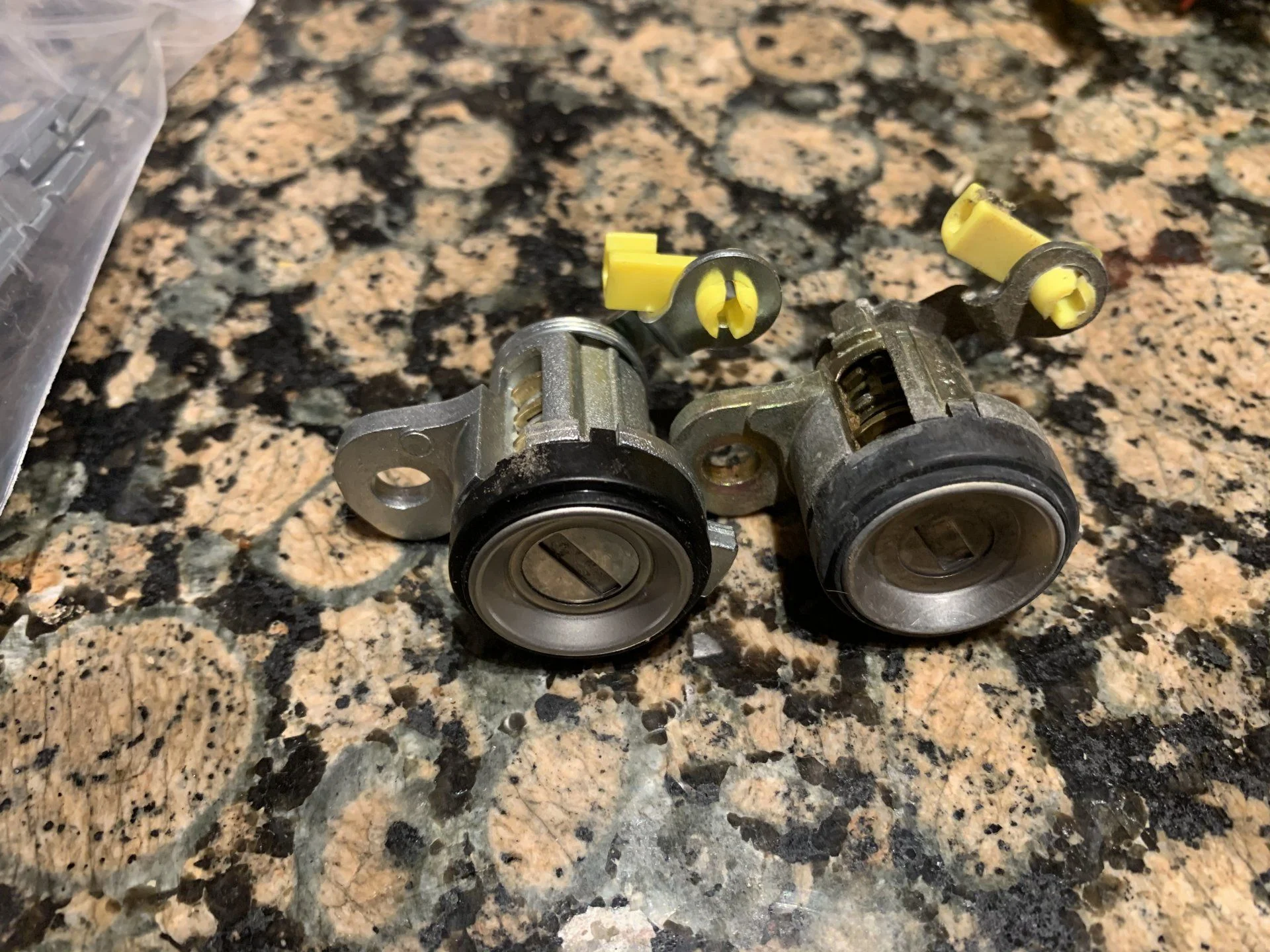

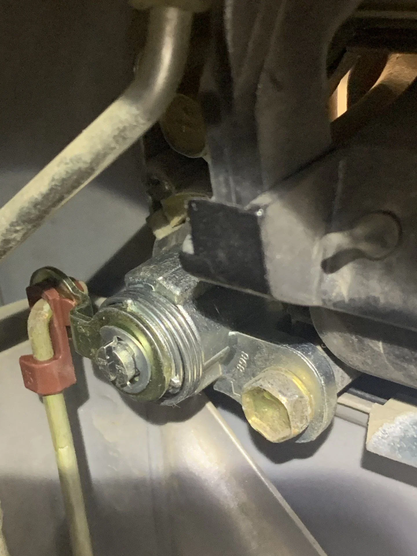

The passenger door lock on the LX has been a total PIA to get the key out of lately...a clear sign that the tumblers are worn out. New LX locks are unavailable, but Toyota locks are still available...just not as a matching set.
I have a complete set of matching locks from Delta (they rebuild new locks so they match the ignition cylinder) for my Cummins 80, and they feel so nice and smooth to use. I wasn’t sure if the Toyota style would work on an LX since the key and locks are an internal/inverse style.
@Delta VS sent me another set to try out in the LX, So I got to work one evening this week.
I am happy to confirm that the Toyota locks for the front doors and ignition swap directly into an LX and work perfectly. The swap was super easy, the most involved part was pulling the door panels off to get access. The second most involved part was figuring out how to break into the LX after I locked the new keys inside the truck ;(
I am going to send my LX locks up to Delta to see if it’s possible to rebuild/re-key them. If that tests out successful, then I’ll send up my LX rear hatch lock and glovebox locks to be rebuilt.

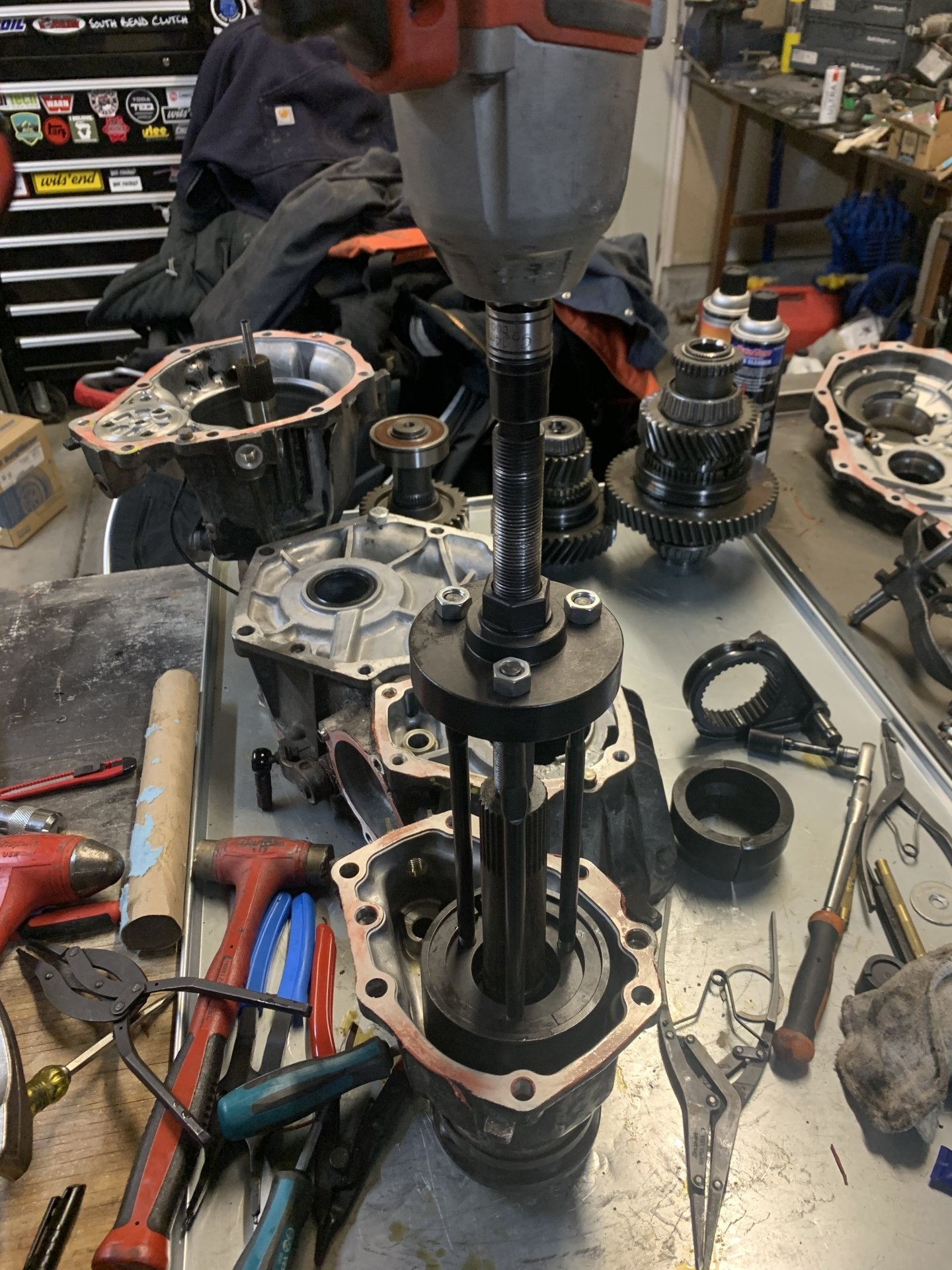

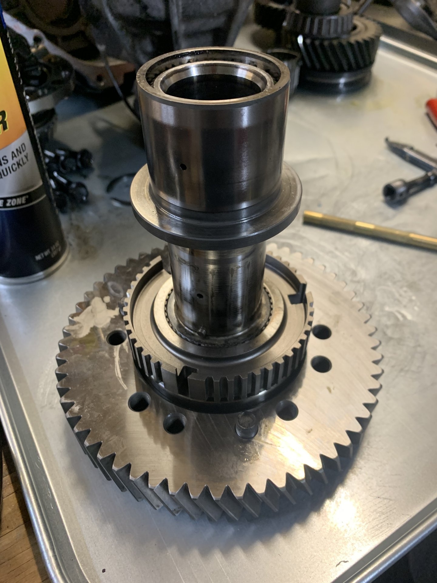

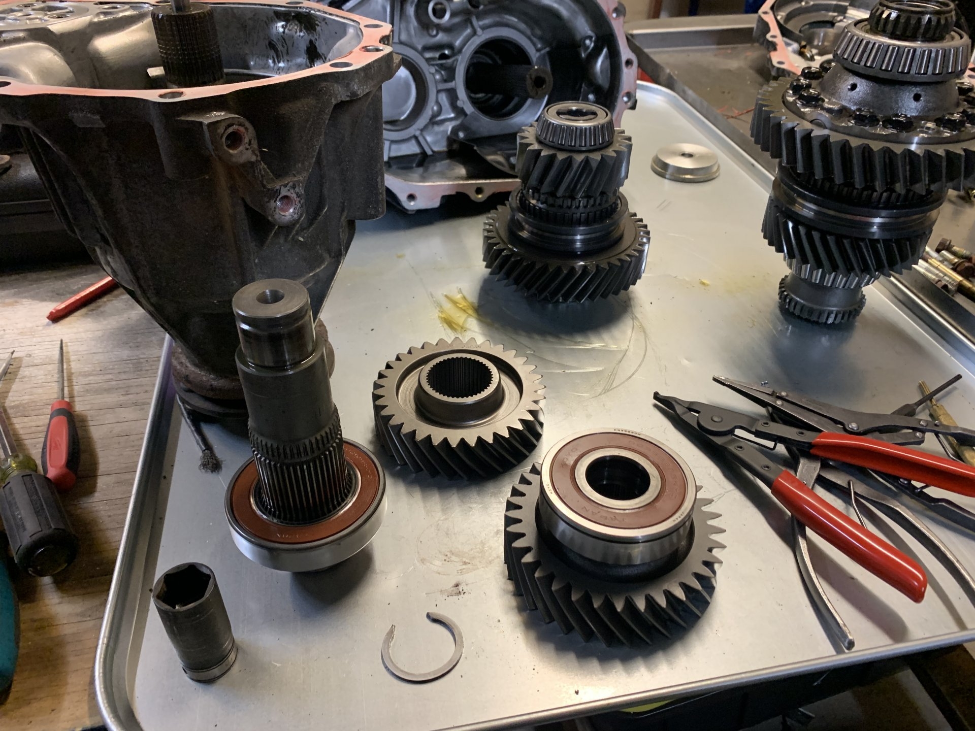

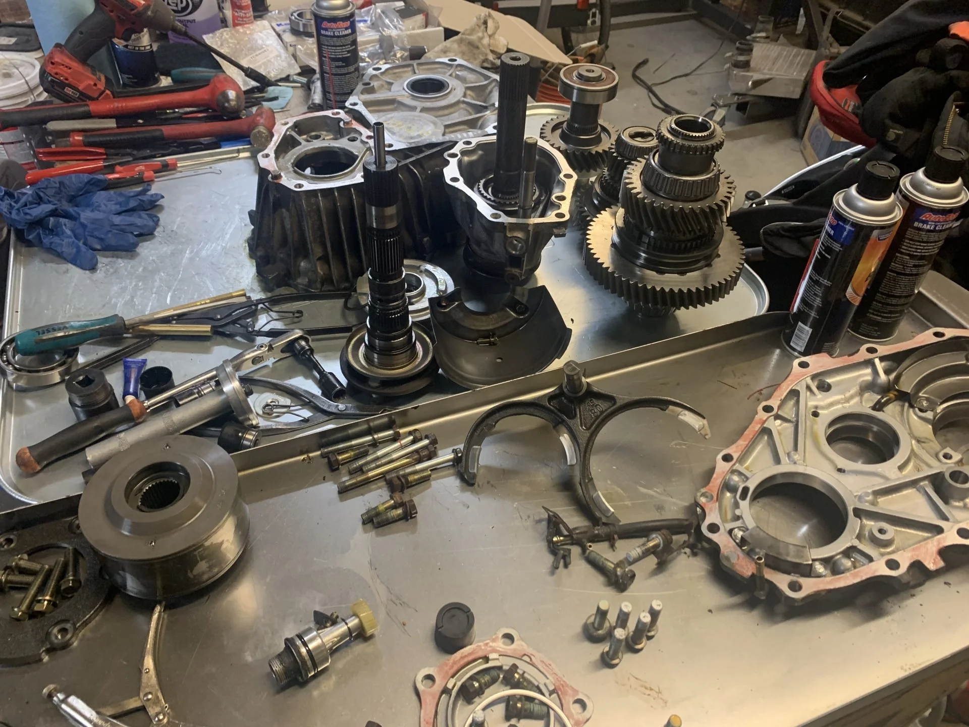

This week in between meetings I have been chipping away at my spare transfer case rebuild. I have setup the three gear clusters with 3.1 low range from @orangefj45 and 10% Underdrive high range gears from @cruiseroutfit. I figured since it was all going to be apart I might as well go all in and change out the bearings and seals so snagged a rebuild kit from Kurt too. It’s amazing how all the bearings have been in great shape. I decided to change the two input shaft bearings, the front and rear output shaft bearings and needle bearings on the output cluster. For seals, I am changing the input, front and rear output and speed sensor.

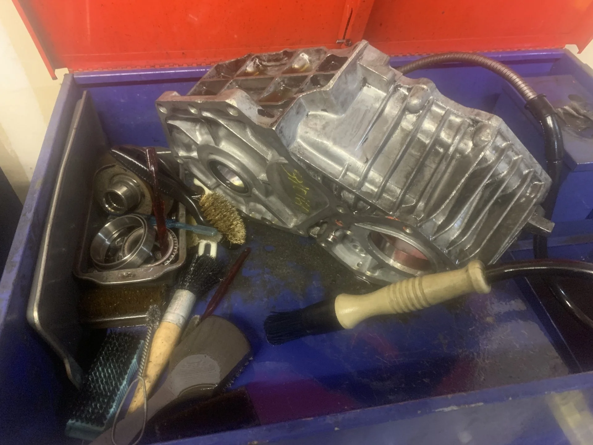

Today I continued the case cleaning process...such a PIA.

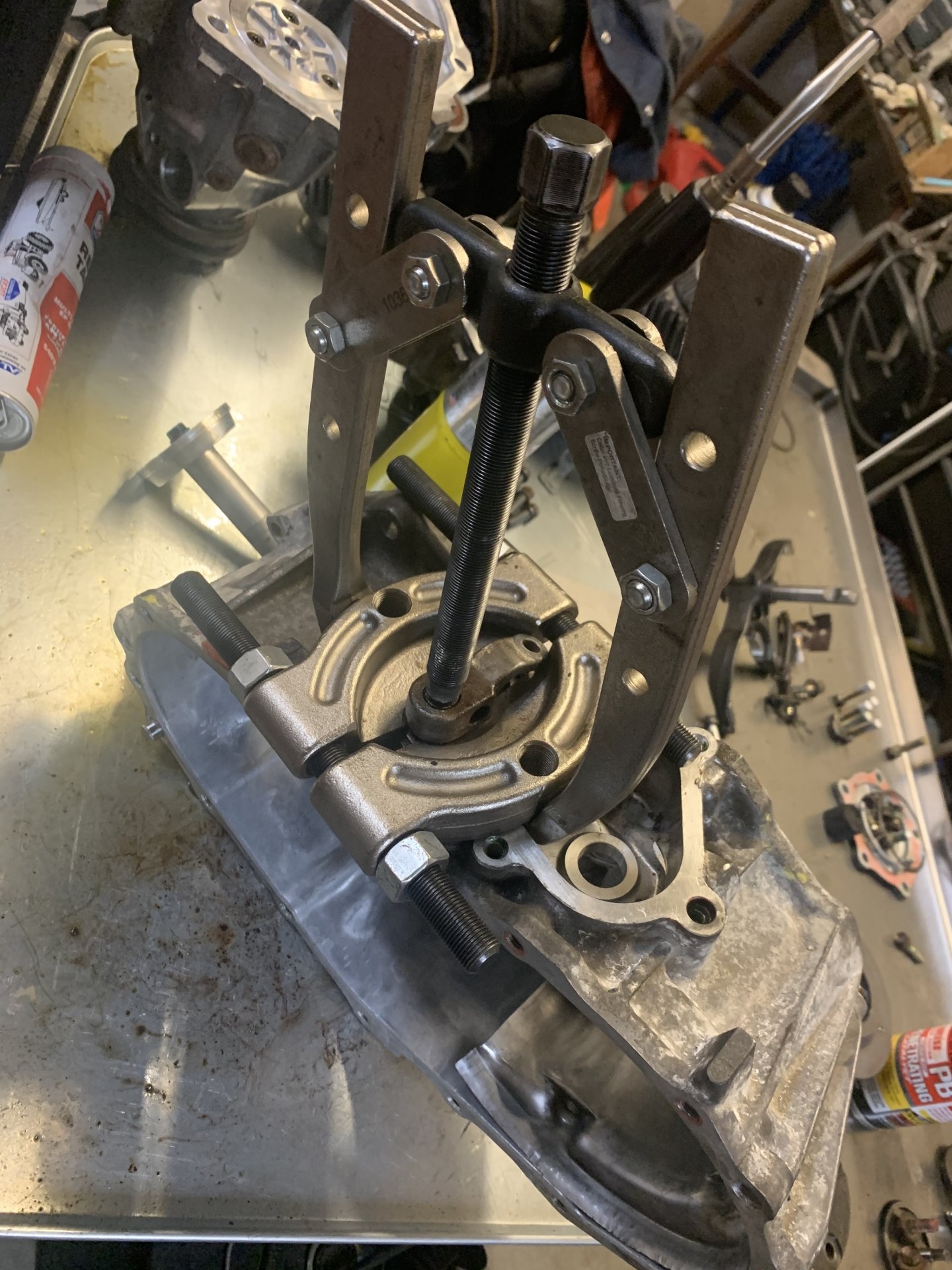

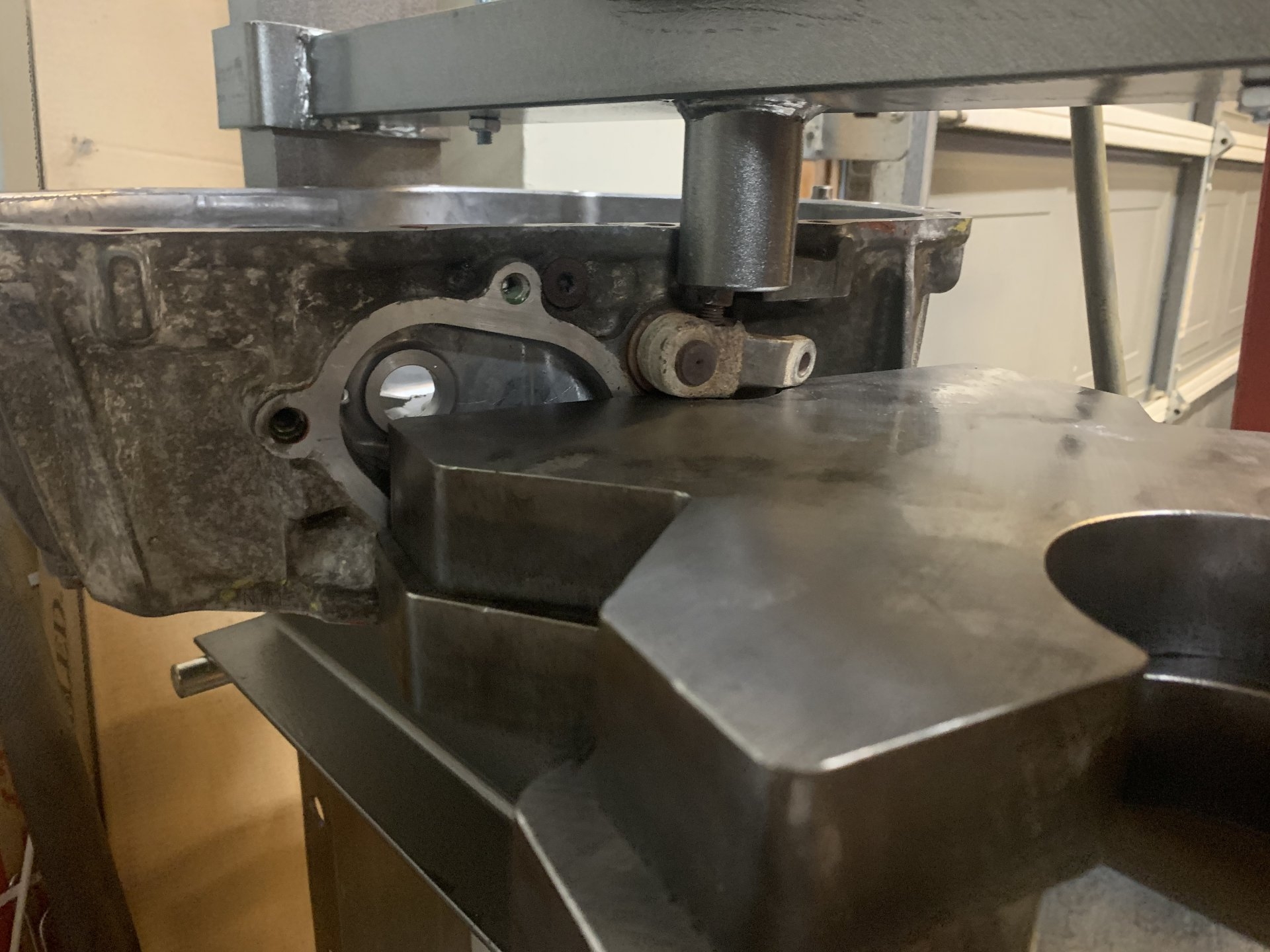

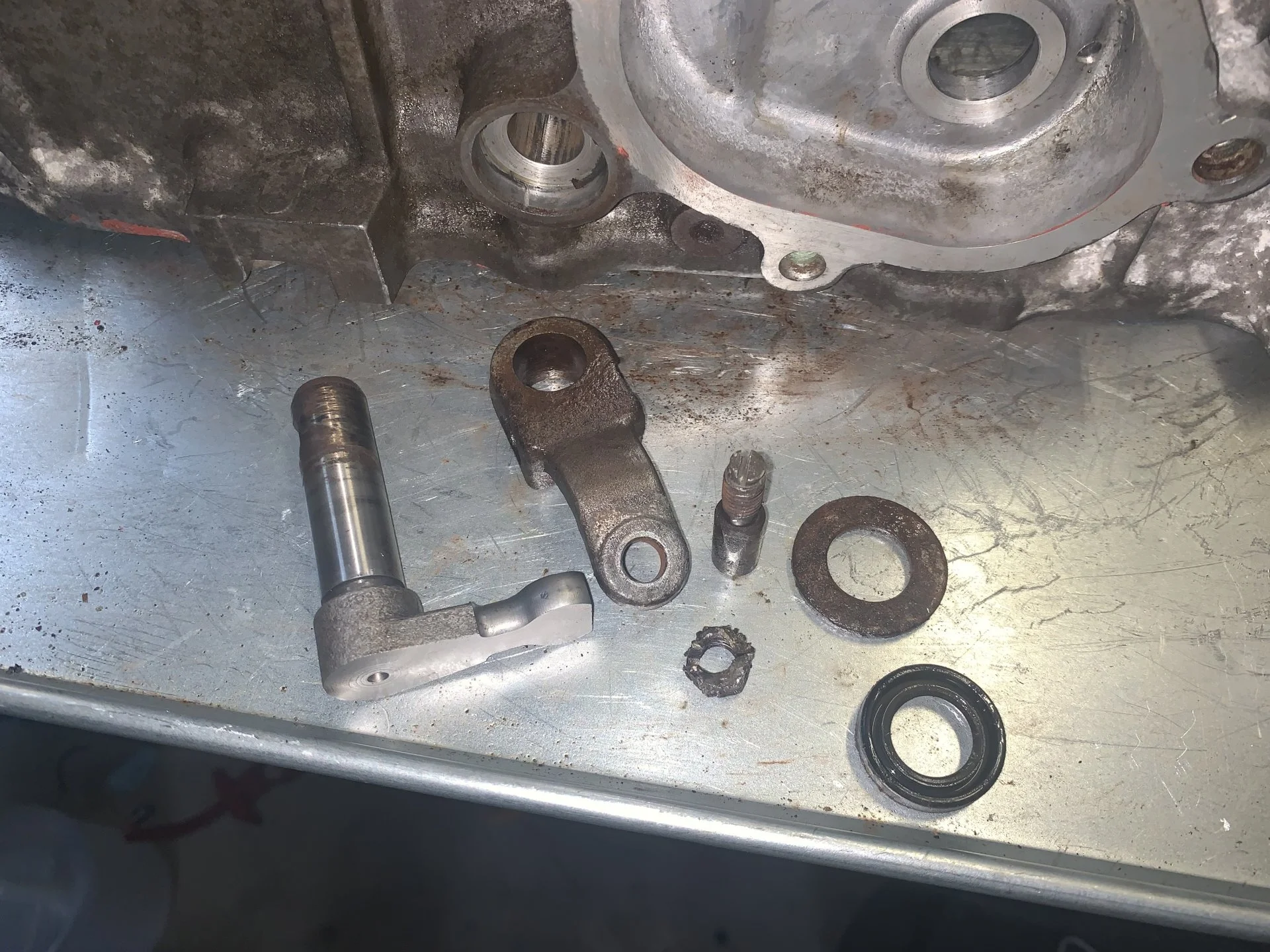

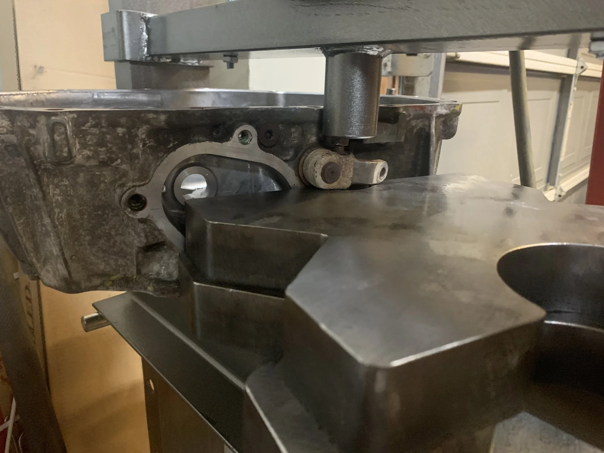

I then decided I wanted to change out the shift lever seal. This proved to be the most difficult step of the whole rebuild. There are 3 parts to this plus the seal. The outer lever and inner lever are held together with a threaded and notched cross pin...and in my case also rust. They were seized together mighty good.
I ended getting the pin out with my press and then separating the inner and outer levers with a big bearing splitter / 2 jaw pulled combo.
I’ll be replacing all those parts with new once they arrive next week.
