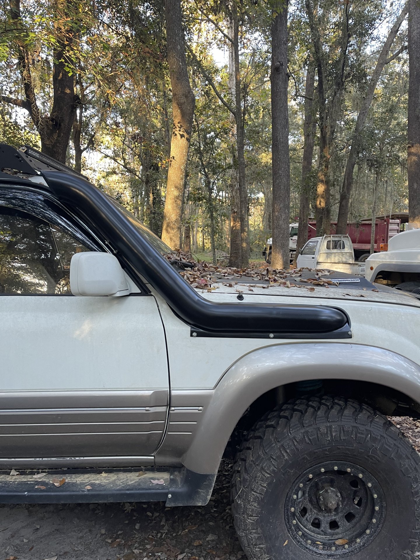

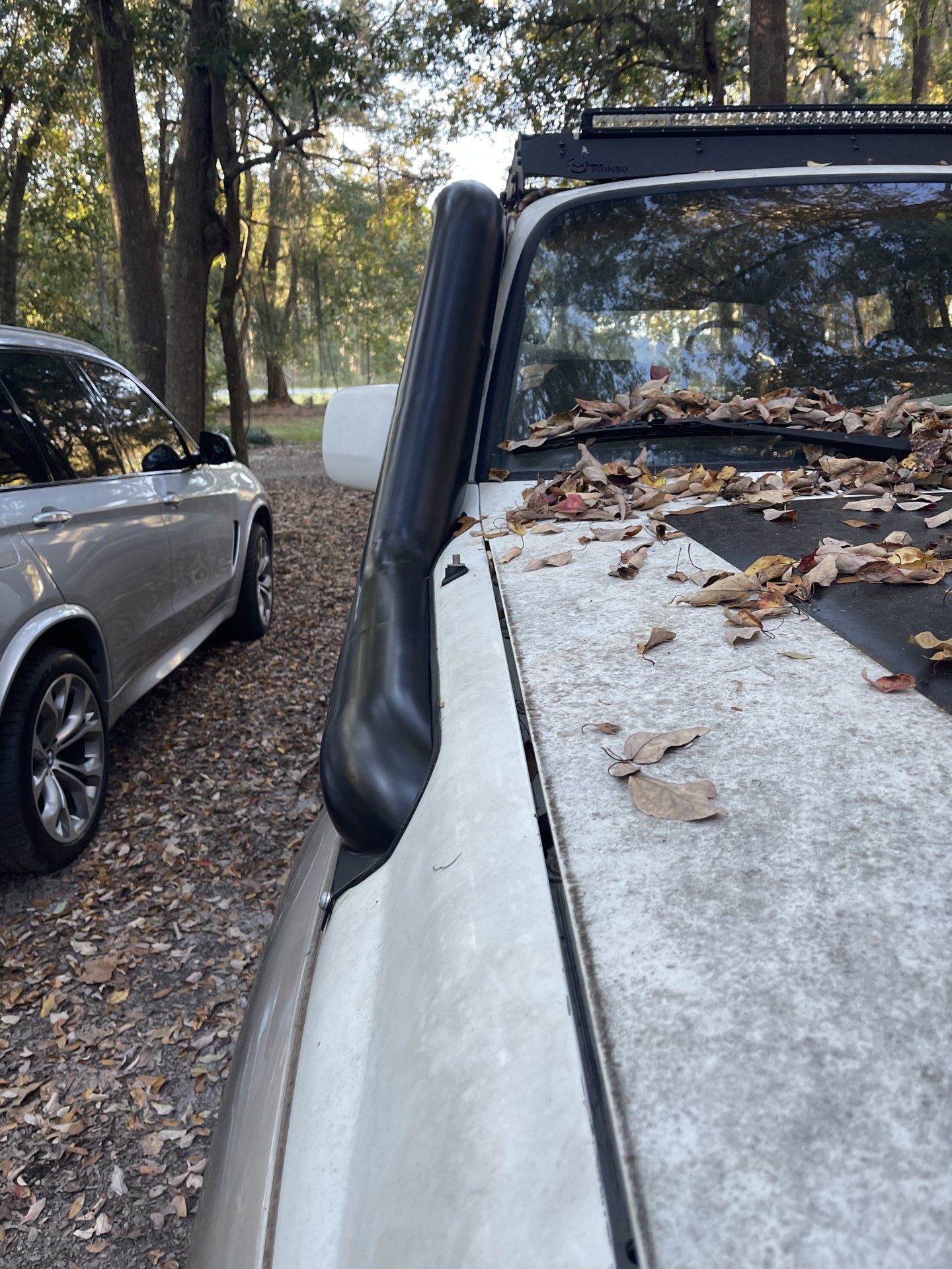

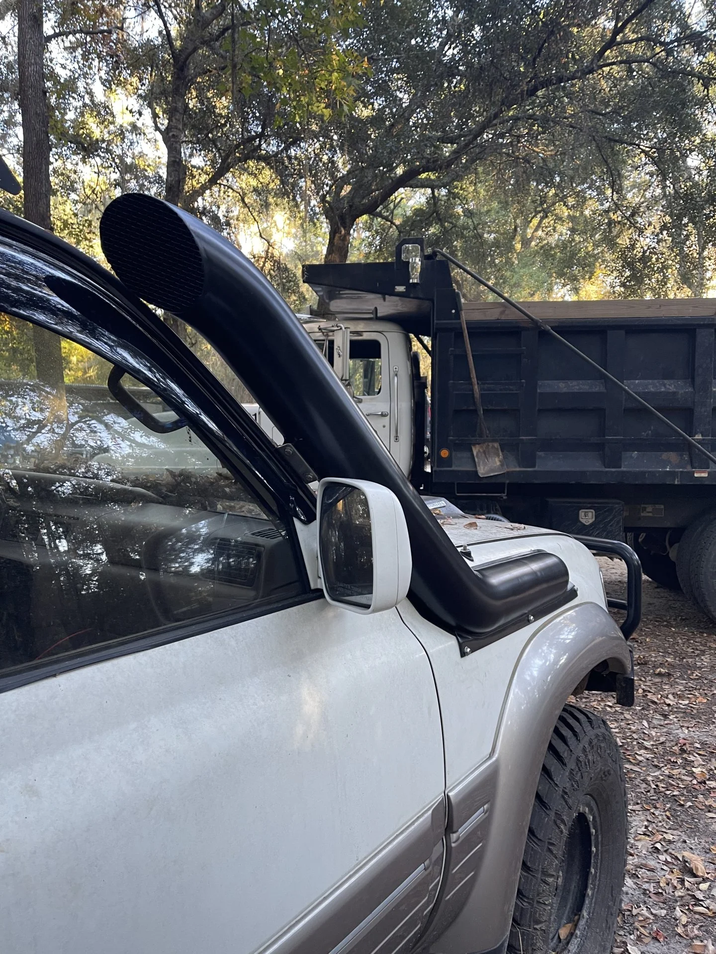

I need to go read through your duramax thread. I heard you worked up a big 5” snorkel…I need to figure out a similar setup for my Cummins.
I’ll save you the trouble of digging through my thread haha…unless you want to read over the build.
I think this might be the largest snorkel on a 80? I don’t know if any of the aus guys sell anything this size. I wish it was 100% seamless, I fit everything best I could.

You did a nice job putting that together. Did you already have a safari snorkel the you were trying to reuse the existing cut and mounting holes? Or did you start from scratch for this build?
Yeah originally it had a knock off ebay snorkel. Which I thought looked great they just flow really bad. It would flow enough for the previous ls swap, but I knew the dmax would need a lot more air. I had a 4” I built before this one, and it seemed to be ok but still not enough.
I can sell you my old 4” snorkel if you want haha. It would be cheap…like $100, but shipping would be expensive.
That’s really nice work. I’m in same boat as Morgan. Need more air and already have a Safari snorkel hole. I will be looking at 5” now looking at yours rather than 4”
