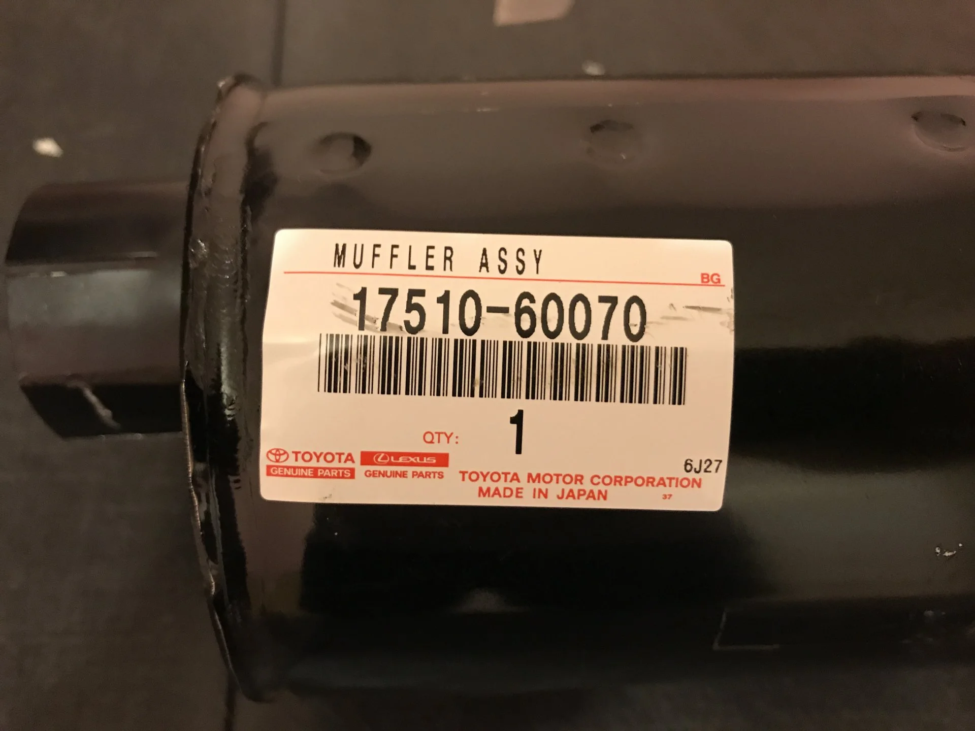

17401-60150 which I believe is the down pipe & 17510-60020 which is the muffler both appear to now be discontinued searching a few online Toyota parts sites. @jfz80 thanks for the link thats where I got the part numbers, looks like Beno got them 2 years ago but maybe they are NLA?

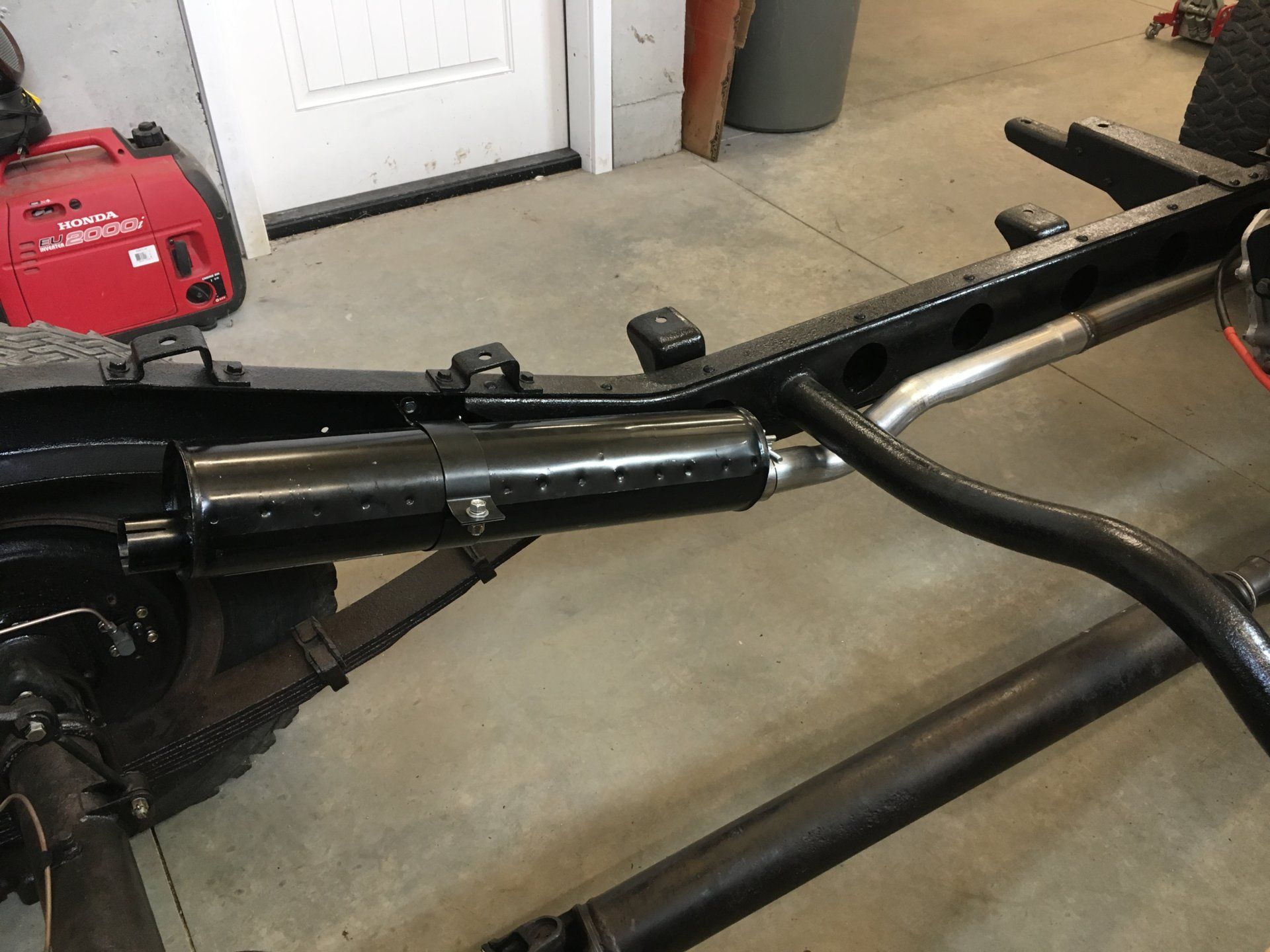

I put a 17401-60040 down pipe and 17510-60070 muffler on my '63 FJ45 SWB with 1F earlier this year sourced from SOR. The down pipe needed to be extended to get under/around the mid-body cross member, but the muffler fit the OEM location with OEM frame bracket (purchased used from Mud member). Still need to locate/make the tailpipe (17430-61120) along with it's frame bracket.
Pic here -
Exhaust is 80% in, just need a tailpipe. My local shop - 25 miles away - added 9.5” to the OEM 40 downpipe, plus dropped the bump under the torque bar an 1” or so. Fits good. And with the bracket from @php74 the muffler fits well.
