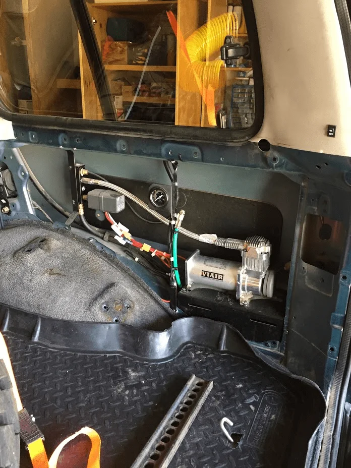

Next up on the Build was a on board air system from Viair. I wanted the hart of the system and the electrical away from the elements so I decided to mount them in the right rear quarter panel.
I fabbed up some mounting brackets and it all fit in there petty nicely

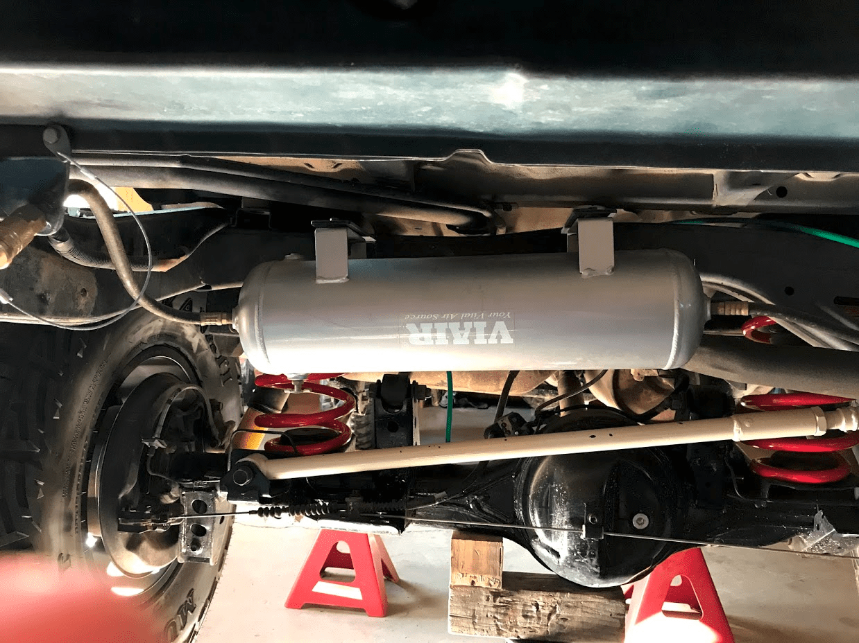

The air tank was located under the Reg in the area were the spare tire used to be supported by a custom bracket that I fabbed up.

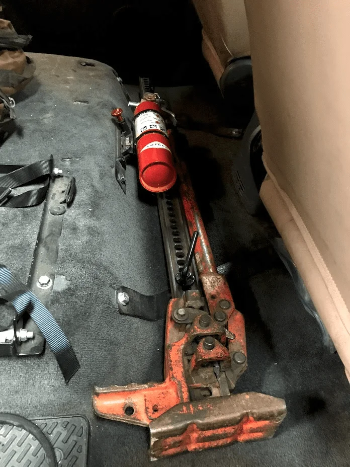

So I also made up some mounts for the Hi lift jack and fire extinguisher. I don't like drilling hole in my Reg so the factory seat mount points were used. I also liked this spot because it keep the weight down low
The fire extinguisher is easily accessible to driver or passenger. I never run the second or third row seats so this spot makes sense.

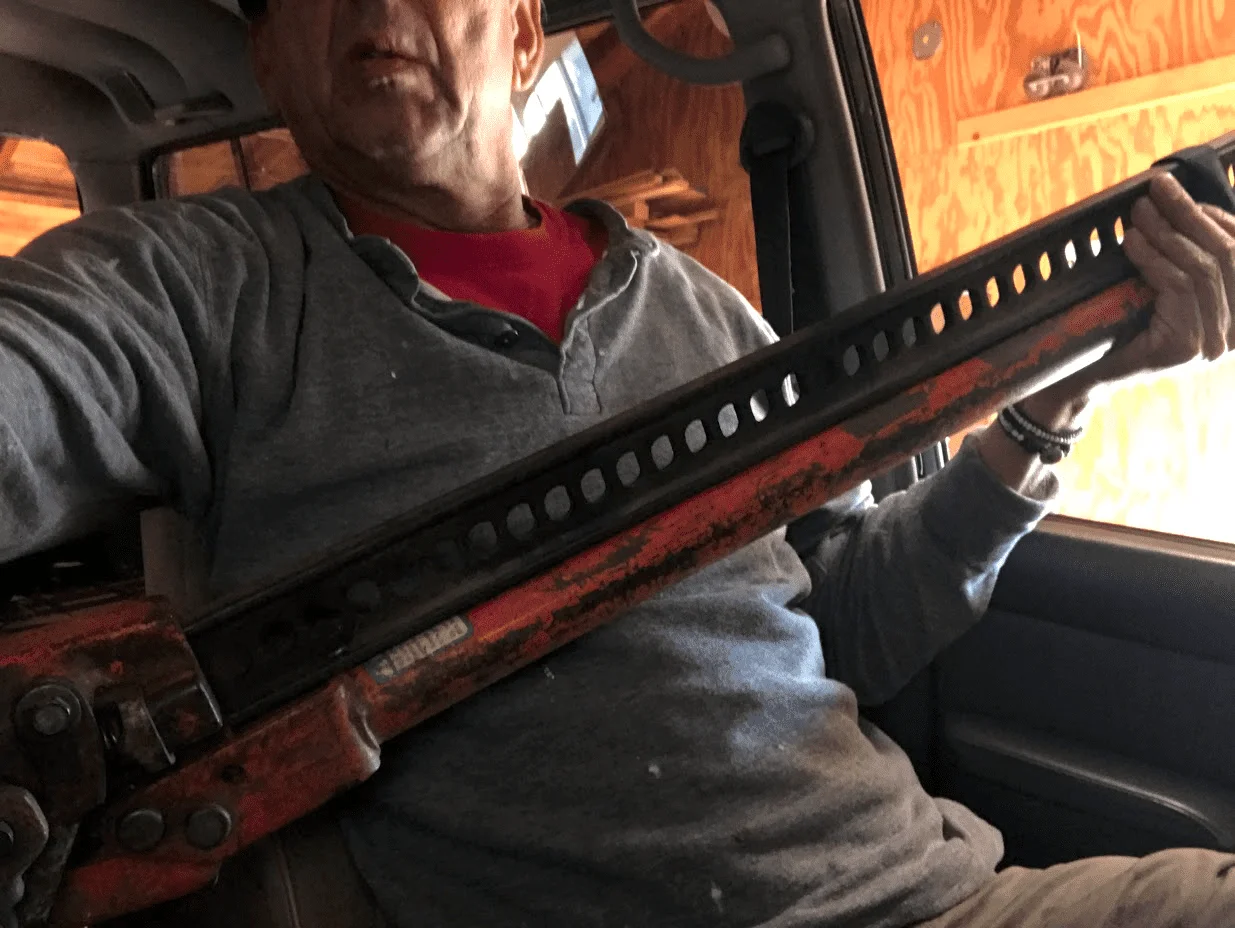

Doesn't accessing the hi lift require one of the doors to open fully? That's a pain
I don't thing opening the door is any more of a pain then swinging out rear tire carrier to access the jack. In fact I think it's easier form either door. Although not as easy as the rear doors. I can access the Jack from the drivers seat.
