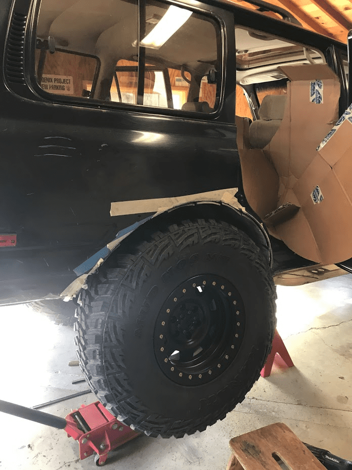

Had to run 2' bump stop extensions in the rear and 1" in the front. There was fender massaging as well to get the 37s to work.

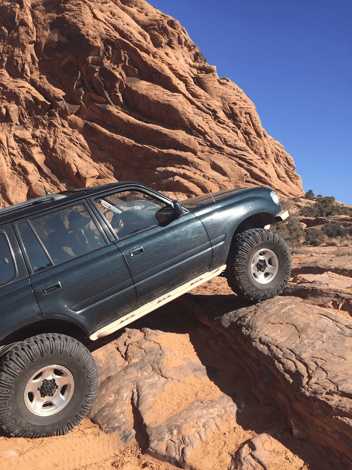

I also have gone to Cruise Moab the last two years since owning the Land Cruiser
I always have a good time at Cruise Moab and I am registered for Cruise Moab 20 20 :clap:
