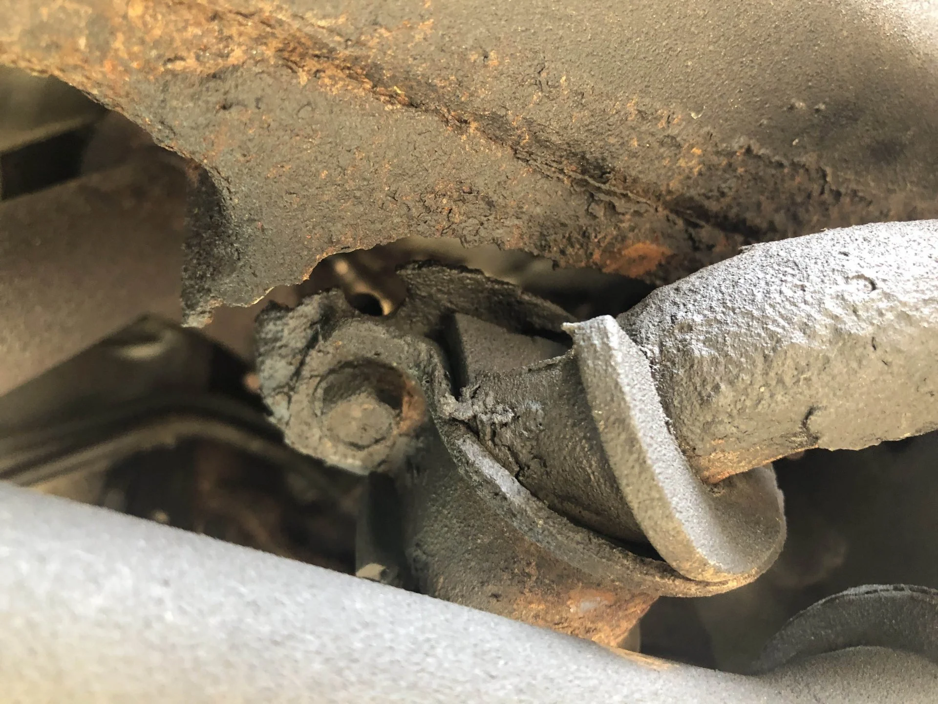

Something that I missed when inspecting my new LX470 before purchase: the front sway bar mounting point on the chassis is broken.
Does anyone sell a replacement part? Or will I have to get this custom fabricated by a frame shop?
Common place for rust due to the AC drain dripping onto it (little tube sticking out of the firewall. You should add a hose to it that lets it drain into the plastic skid plate)

You’ll have cut all that rust out and weld a plate on with holes drilled to serve as a new mount. Or just go without swaybar

Find a welding/fab shop shop that will do it like a quick surface clean and mounting bracket create/weld. Shouldn’t cost you more than 300$
I remember somebody recently using a Gen1 Toyota sway bar bracket (w/ a little modding) as it is available from Toyota.

The toyota tundra bracket is the one to replace your frame tab with. 51591-0C020. Search it to find other posts that explain how to use it with pics (one cut + weld)
