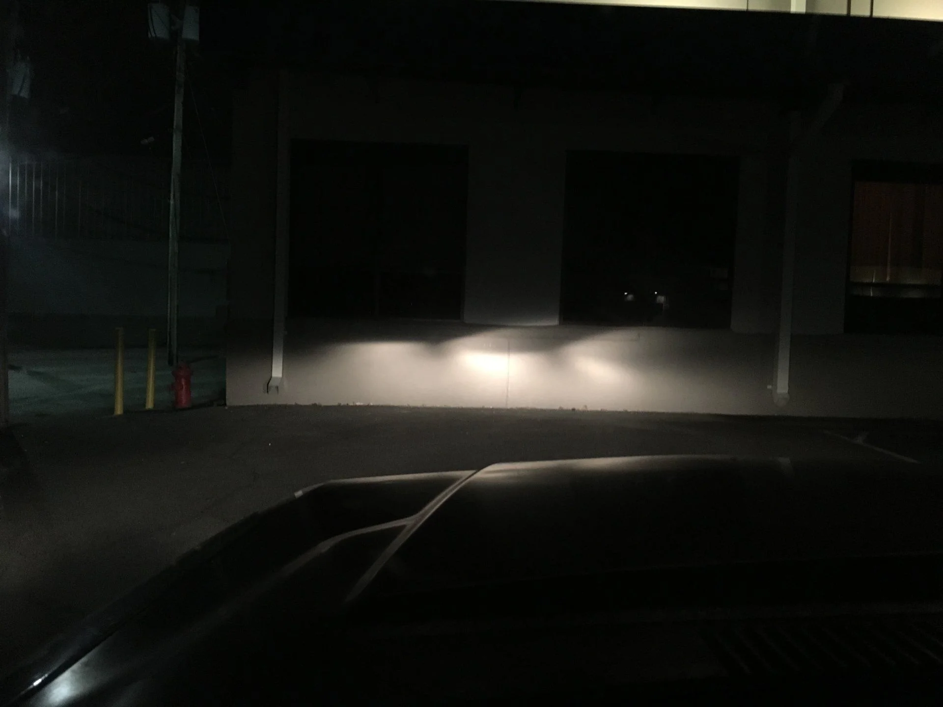

So hard to really tell anything from headlight pictures. To me, the light looks uneven, bright spots, dimmer spots, stray light. And the color of the light is way too blue (cool) (IMHO). But this could just be the picture. To me, the H4 pictures above look like a much better light. Again, pictures may not accurately show how it actually is.
These are LED headlights not HID projectors. There won’t be an even spread because in essence it’s an LED Bulb reflecting outwards. Not projecting like newer cars. There may be some dim/bright spots but I’ve had all three ( sealed, H4 and now these ) and the LED lights are superior. The temp is about 5000-5500. I wanted something that will match my LED lightbar. Hate having halogen/LED mix. Also they aren’t as hot and last longer. It’s not for everyone but I can say they are brighter than the H4s for sure. At least the 55/60 bulbs that I had. I never upgraded my harness for the hotter ones.
I understand the technology. My problem is that I've never found a LED replacement reflector that came anywhere close to the quality and engineering that went into a quality H4 like a Cibie. And hot isn't all bad. LEDs in the snow suck because they don't melt the ice build up. If you want more light, put in higher watt bulbs. If you want different color (I don't know why), they have that too. There's more to a headlight than a bright light source. The problem with LEDs isn't making the light, it's getting it out on the road in an even, scatter-free fashion.

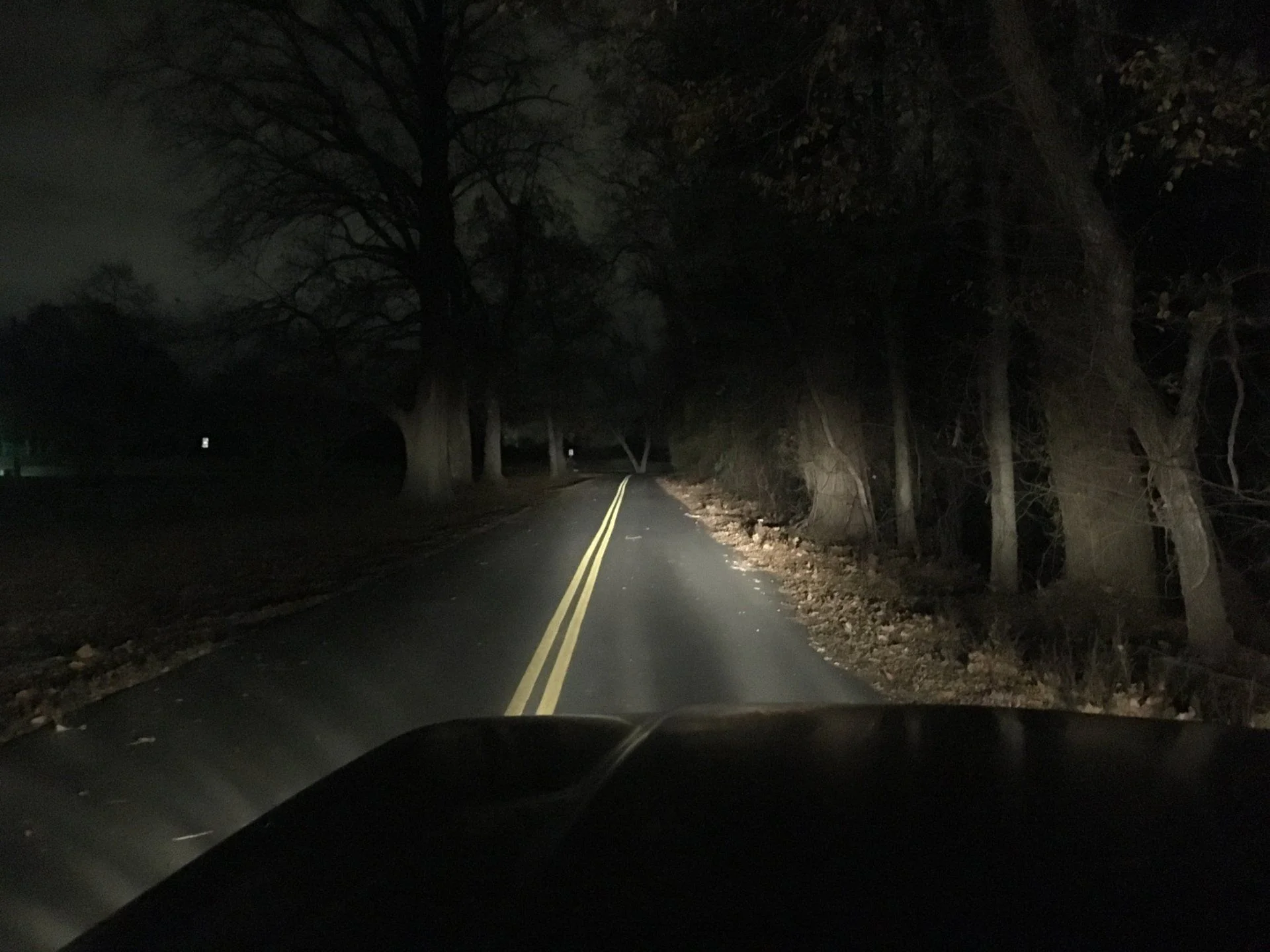

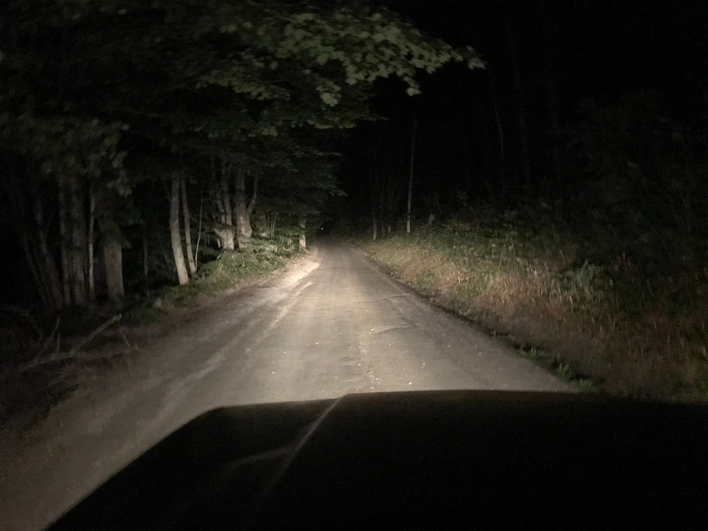

Two pictures taken on a dirt road near my house. Top picture is low beam and bottom is high beam. Standard 55/60 watt bulbs in Hella 7" H4 housings with stock wiring. Pictures were taken on my Iphone 7 and I didn't modify the pictures however the camera compensates some for the night exposure so the actual light looks brighter than reality however the pattern in distance is accurate.

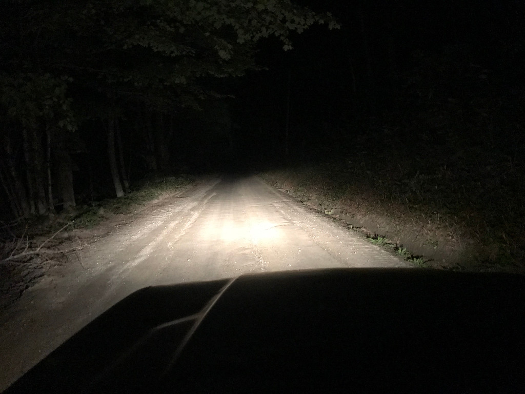

a few others on high beam with same setup:

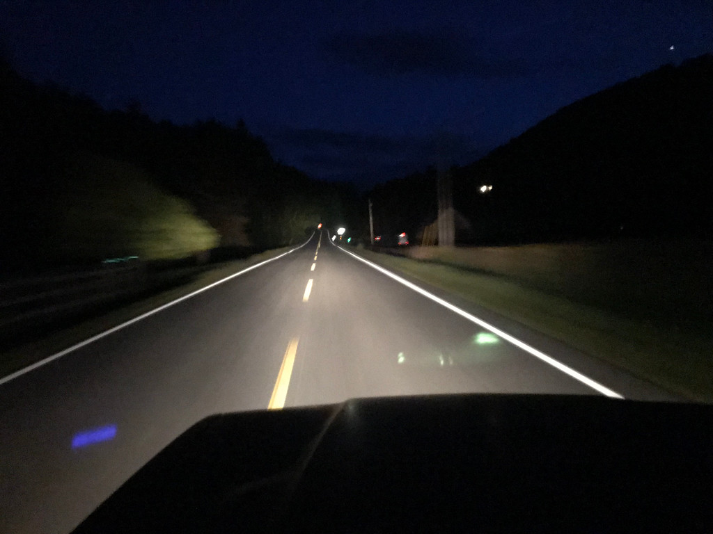

This one at 55mph....curve going up hill in distance is about 1/2 mile away:
another on the dirt road. Again the brightness is too high but the light throw is accurate.

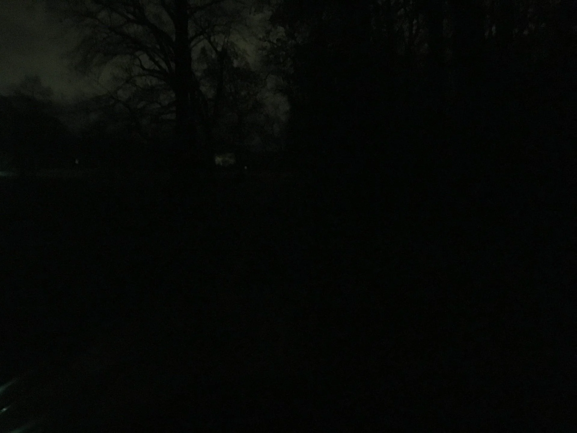

Here are a few shots of the cibies on my 60 that I took the other night. Still need to adjust the lighting angles a bit but I couldn’t be happier.
First picture: no lights
Second: low beams
Third: high beams
Fourth: low beam pattern (still need to adjust)
These are great!! What an improvement from the stock. I consulted with Daniel Stern. What an interesting guy. Has a wealth of knowledge about headlights, harnesses, color temp, etc. He's a nerd about it. Super nice guy and I ended up getting the Koitos he highly recommended. I guess they are a Japanese company that sells strictly to Toyota. No upgraded harness needed for these or the Cibies which is a bonus I suppose. They are speedy though but then again you can definitely spend a lot on harnesses and lighting packages all together. I will post some pics after I get them and report back. So far though everyone has had some great upgrades on this feed.
