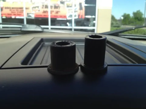

The original bushing is on the left, the ones that came in in the right. The diameter is the same, but different lengths. Shouldn't be an issue, right???
i'm with tj...od is larger on the stock one. od and id need to be the same. too long is ok because the others didn't touch in the middle anyways, plus you can always take off, you just can't add on.
Also, shoulder thickness is very important...remember when I told you to order from Mark A.?
The correct bushings now ordered from $pecter. Damn....should listened to Pighead in the first place. Now I'm paying for O/N shipping.
