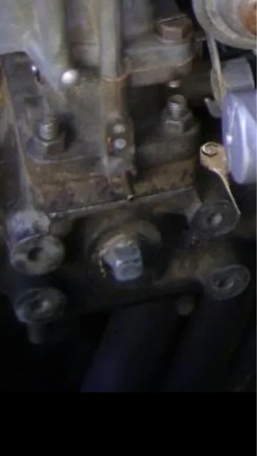

Couldn't let Boss Hog drive around on an old junkyard mini master cylinder, so today he got an 80 part. Parking brake works now too.
