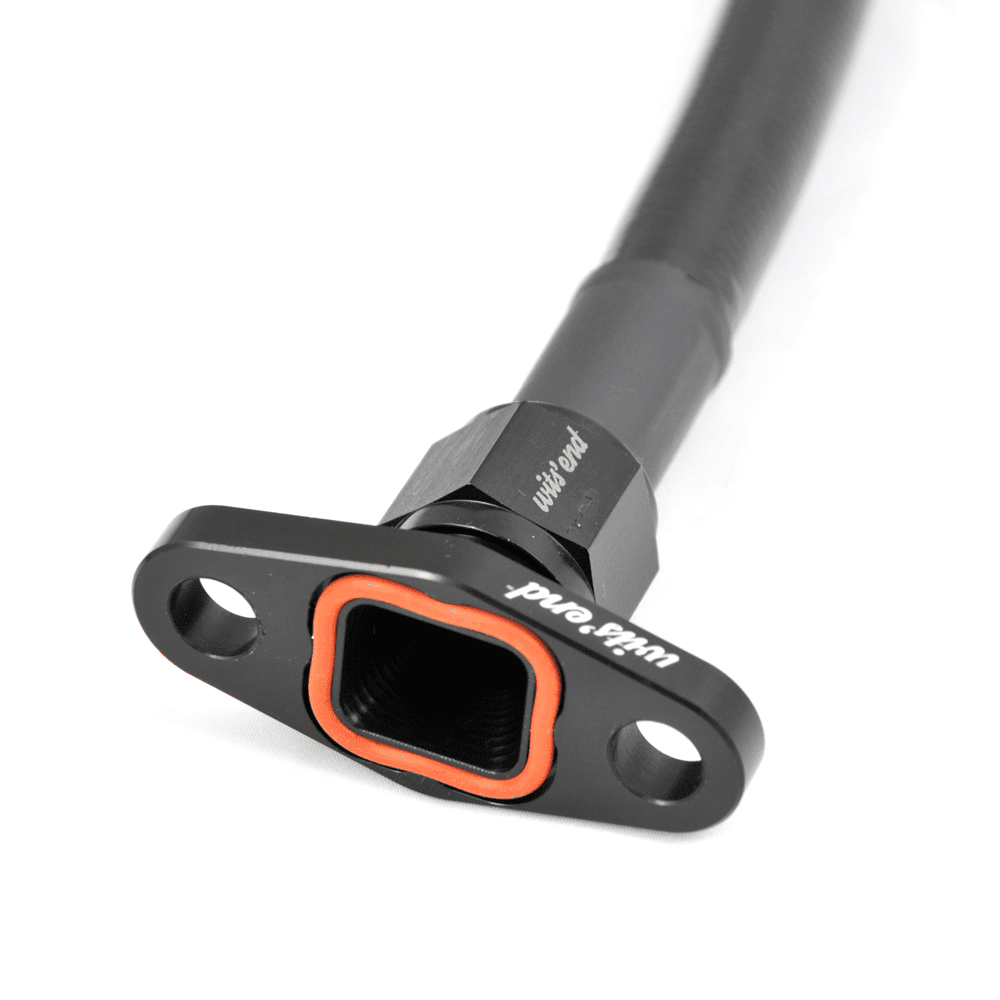

Next up is the Oil Drain Kit. Its now 100% done except for the heat sleeving which hasn't arrived yet but it'll be part of the kit. I have a couple of things yet to order to complete 25 kits of these but I'm getting closer.

Drain kit looks way nicer than mine. I'm hoping I can just slap that doohicky over my existing hole. I will say the brass plug is holding fine and leak-free, so as long as the fitting is 1/2"npt, I could probably just screw it in too.
1/2” NPT ;)
