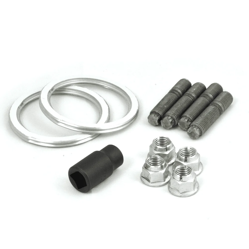

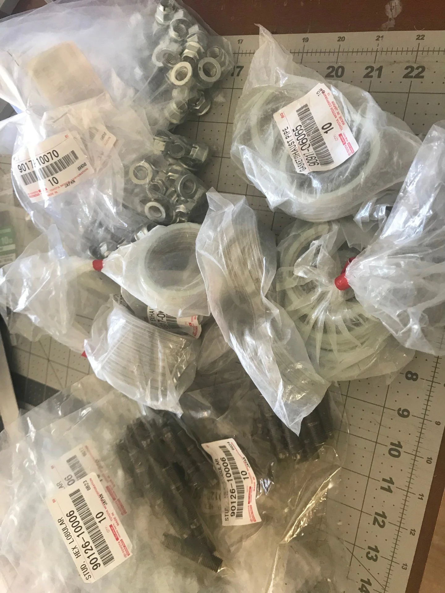

Just got in a bunch of exhaust components from Toyota. The Turbo Kit will be coming with new exhaust manifold downpipe studs/nuts along with the E10 socket for the studs, and two OEM gaskets. I will also be making this a kit available on the site for those just looking to swap out their Y-pipe with new hardware.

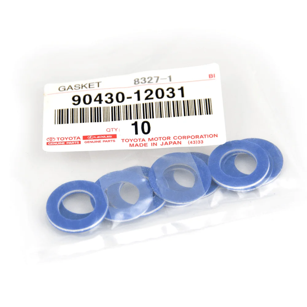

Gaskets not need. Just put a big WARNING on the manual in RED letters. "OIL CHANGE Frequently!"
Or in the Wits End turbo sticker, put a warning that says oil change to remind some of those that aren't meticulous about maintenance.
In order to PROMOTE oil changes...
I'm including a 10-pak of oil drain plug gaskets.
