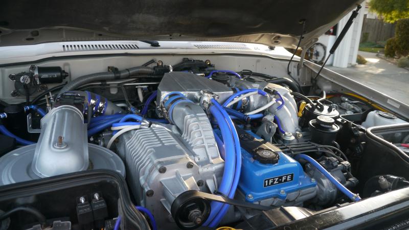

So something like this if the heat exchanger and fan can fit in the front and the intercooler sits in the OEM washer bottle location?
Water to Air Intercooler
Yes something like that but not garbage. lol. The intercooler would fit between the SC and throttle body. That is the space I would want to make work.
similar to this.
1fz-with-intercooler-jpg.644516
I like it. That would be really clean not having all the intake pipes going everywhere like the air to air. Would you mind sharing a kit that isn't garbage in your opinion?
That is the whole point of this thread.... To gather interest to see if making a good high quality kit is something actually worth doing. haha.
So all of the parts will be custom made? I figured that all parts would be sourced i.e. turbo, manifold, intercooler etc from manufacturers who already made the product and then put together to make a complete kit.
similar to this.
I'm down for one. I'd love to have the setup shown there. Need to IC the S/C I installed last month. Was thinking I'd try to replicate Blarsens A/A IC but an A/W would be better. Do like the WRX hood scoop he was running though . . .
There isn'y currently a air to water with the inlet and outlets in the right places. The one above has custom end tanks and while yes the core would not be custom made it would be a standard core, but the end tanks would be custom for the kit.
