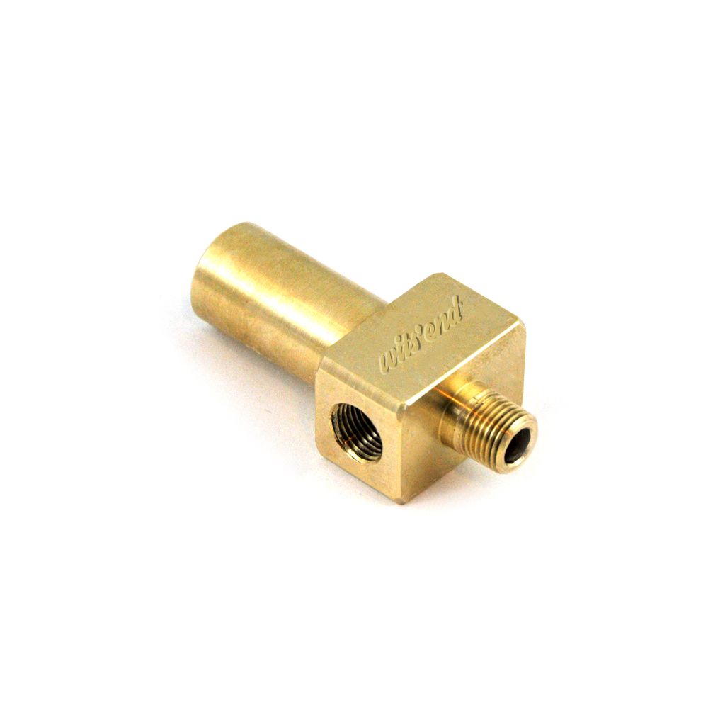

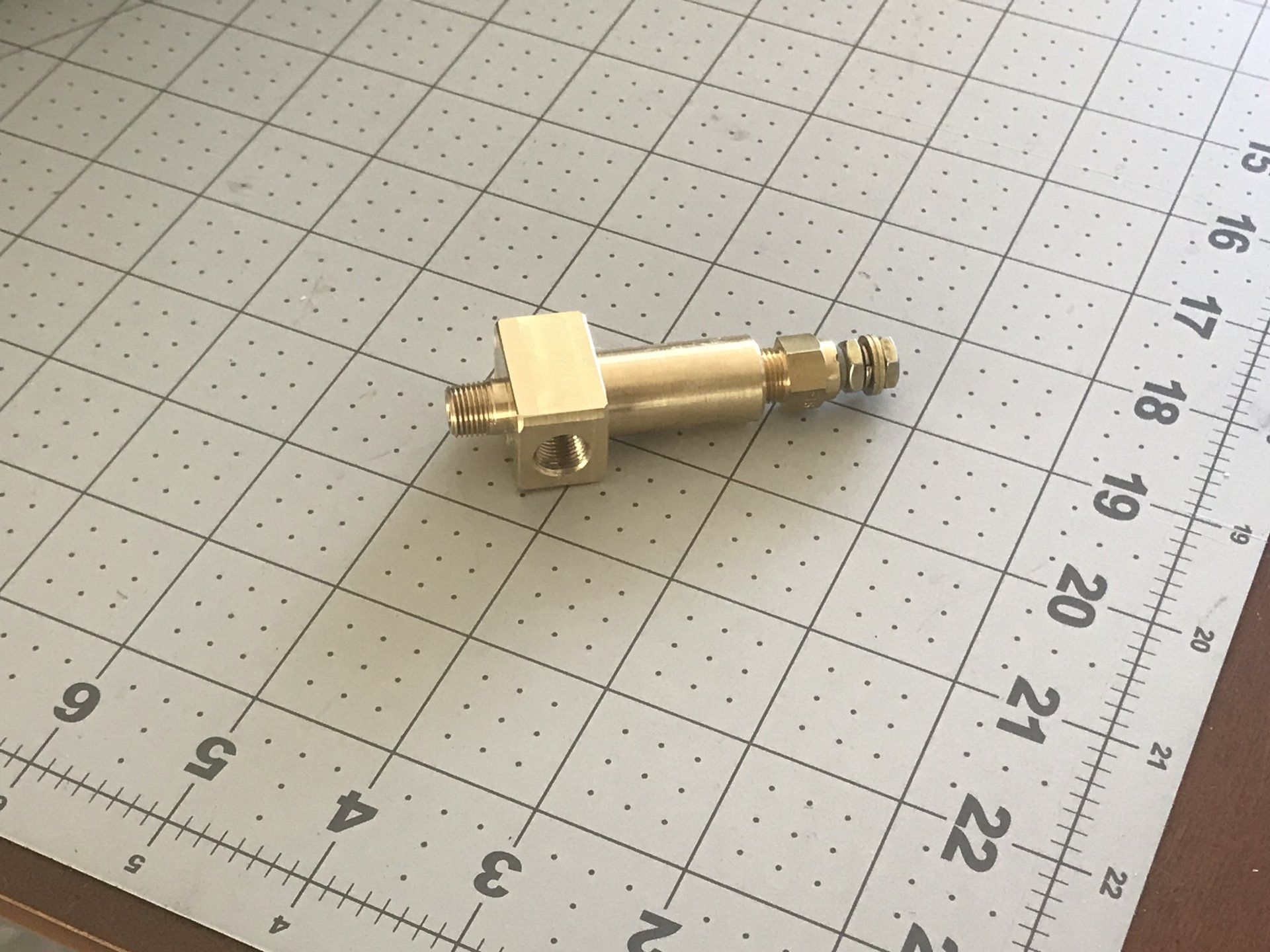

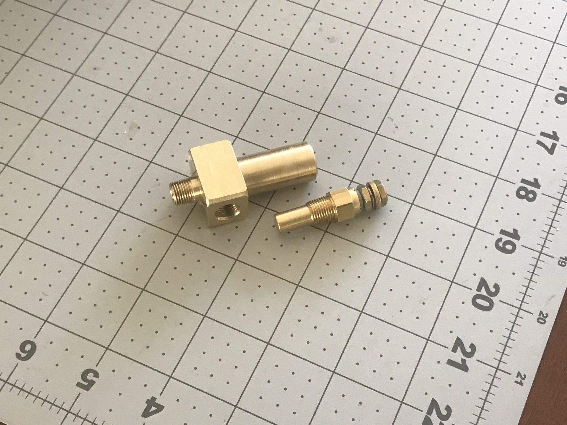

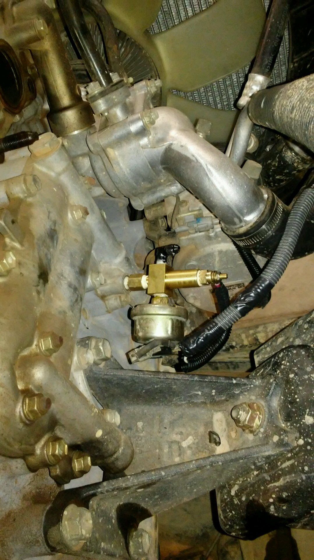

One of the things to consider when adding a turbo is where and how to tie in the oil supply line to the turbo. In this case I’m pulling oil from the stock oil pressure gauge. BUT it needs to serve other purposes.
This Oil Peace Pipe is threaded to attach to the stock oil gauge sender location while adding ports to thread in a brand new supplied OEM sender, an after market oil temp sender, and a 1/8”NPT port with 3AN adapter fitting for the supply line. All included.
The male is BPT. The short female ends are BPT and NPT. The long female end is NPT.
