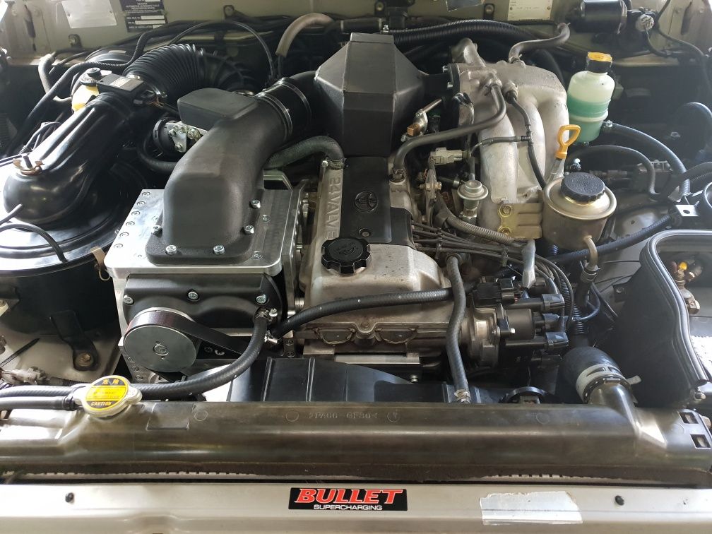

I really want to do an air to water intercooler on this kit at some point and have been digging around on that. I ran across this supercharger kit from Australia that includes an intercooler in the location we would need it. I am wondering if we could leverage some of their work for this? They have already spec'd the front radiator, pump, reservoir, switch, and intercooler. The throttle body has been relocated upstream of the supercharger, so the intercooler housing is not direct bolt on.
Thoughts?
Bulletcars.com J80 Supercharger Kit
To be fair A2W setups for the 80Series have been working out great. I’ve yet to hear about someone not happy about them. A2A is something I’m not pursuing at all but others are welcome to DIY it. Meth injection solves the issue plus can net you more HP by playing with timing but yes it involves the painstaking and arduous process of filling a washer tank full of...windshield washer fluid 🤔
