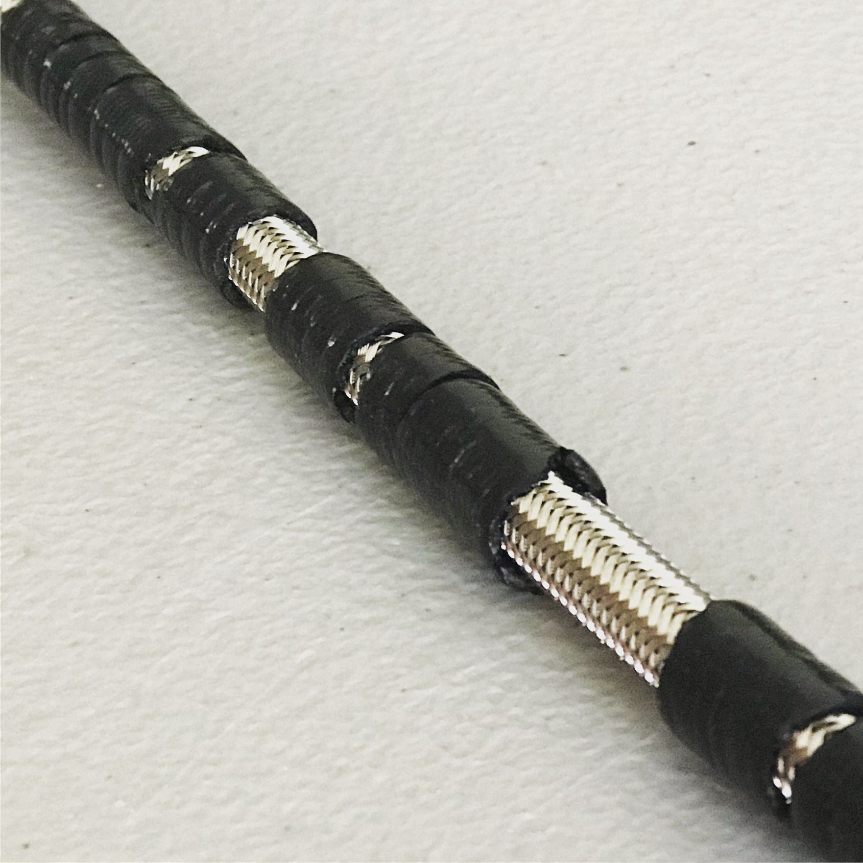

Ah the importance of testing. This is a small example of why it takes me so long to bring some things to market. Sometimes testing doesn’t give the desired result and so you need to recalibrate and test again.
In this case I completely forgot to secure the methanol injection hose that goes to the nozzle post turbo. This caused the hose to drop and get with an inch of the turbo downpipe and this melting the sheathing on the hose. Now the hose itself is fine because it’s stainless sheathed with a Teflon inner tube. It’ll be fine, but it looks and smells ugly. So new hose being made and new heat sleaving going over it along with something to secure it in place.

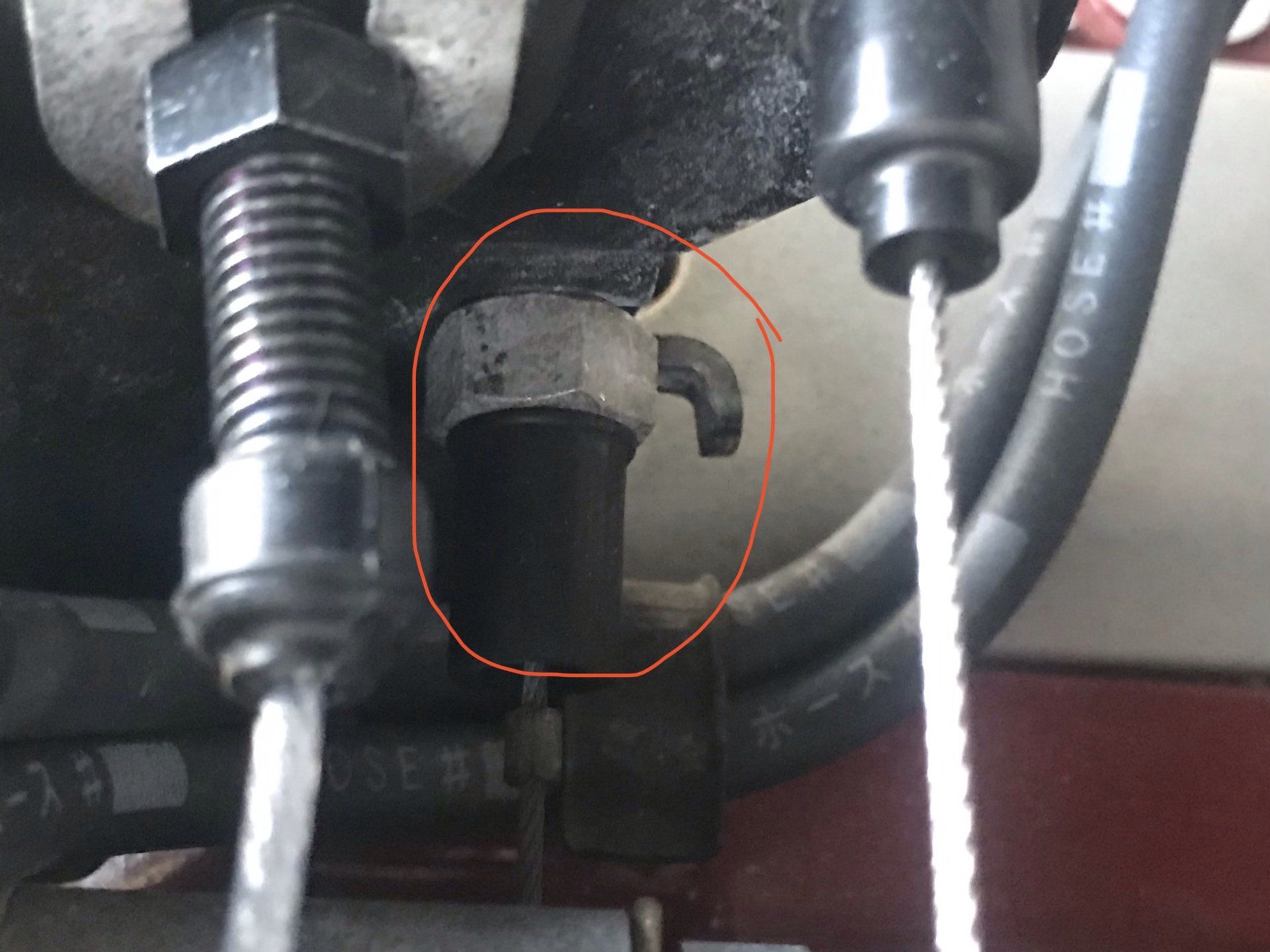

Want to breathe new life into your 1FZ 80Series Land Cruiser? Want to add even MORE pep to your turbo install?
Well look no further than your throttle cable. I’ve always known this as a lockdown cable but Toyota calls it a throttle cable. The problem is yours has easily 200k miles on it and very very likely never ever adjusted. Now is the time. This cable dictates when the transmission shifts (ok one of the ways) and keeping it properly set will go a long way to making your truck feel like it’s driving and shifting properly.
Basically feel for the slack on the exposed cable end. Now move the nut all the way towards the rubber boot until it’s almost pushing to the boot off. The cable should feel taught without pulling. Then tighten the backside 14mm nut and violá!
BTW don’t judge the ugliness in my setup. I have to get things certified before I touch any of this side of the motor.

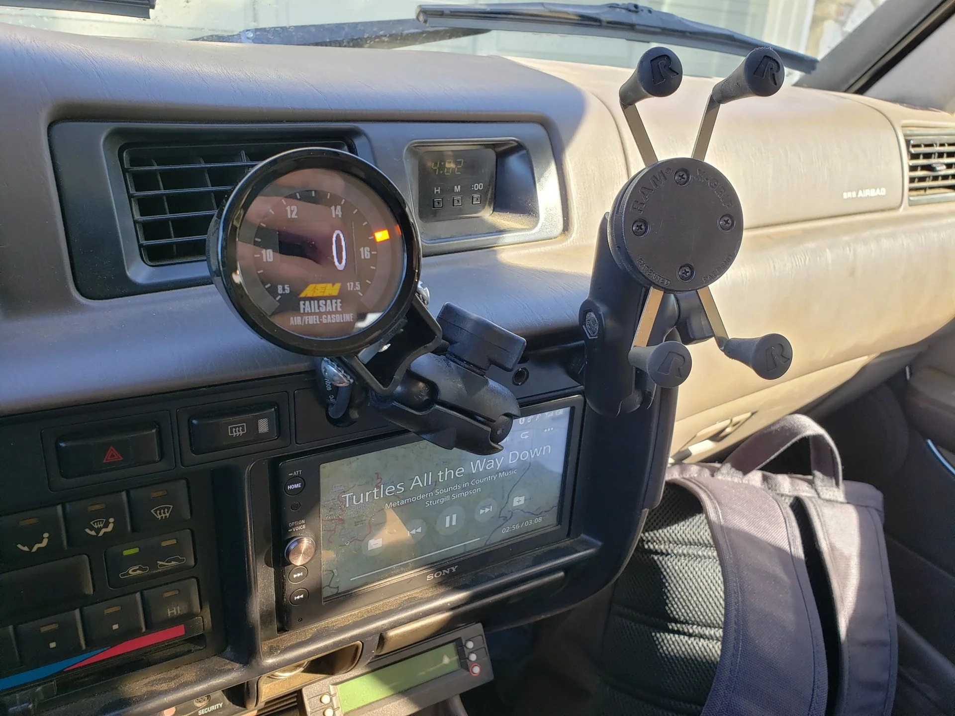

Moved my boost and wideband gauge to a more ideal location. It's more visible than down low on the trans tunnel and not obstructing my view like a pillar pod.
This gauge needs to have a "oh ****" and "hell yeah" printed at the correct locations!
I think we need a HUD option for extra gauges. Yes, I'm being serious.
Id love one!
That's one of the things i talked about in my gauge options thread.
They make OBD reader HUDS but nothing for external sensors that i could find.
