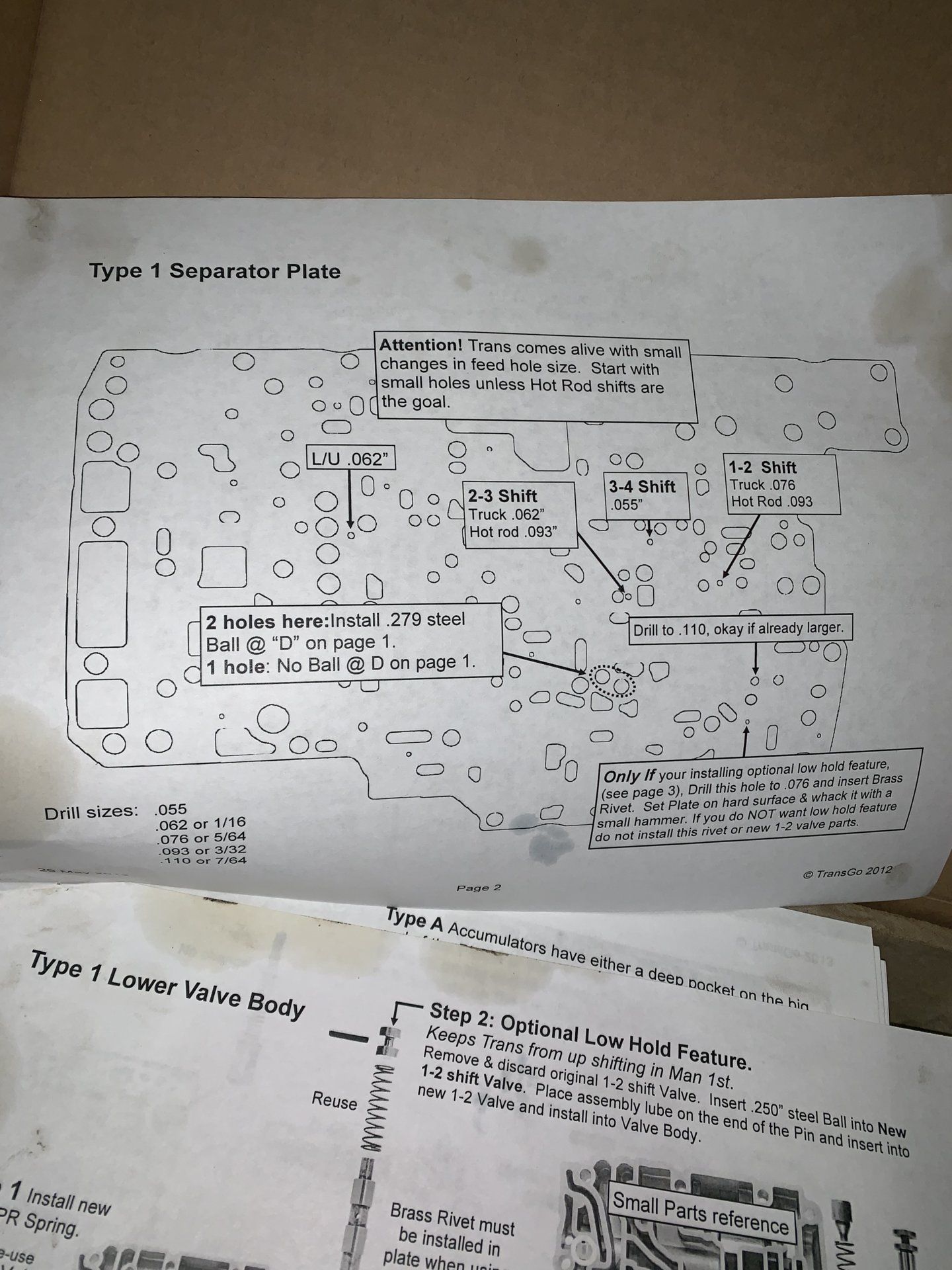

I'm reading shift kit threads. Some seem to think that you shouldn't drill the 1-2 cause the shift is so hard. Others don't think its aggressive at all. Thinking overall the kit is a good idea, but not having ridden in one with a kit may wait until after i have the turbo in. Can't decide which way to go.

On my 80 we set the shift kit to "truck". Its not smooth and its not obnoxious. I do hope the the turbo smooths it out. The shifts feel better on the interstate than in-town traffic. 1-2 is what gets your attention. I even tried the 2nd start to see if that did much, negligible. I only had 100 Miles seat time in before the shift Kit was in place so not much to compare. For all i know thats how the 80 rides.

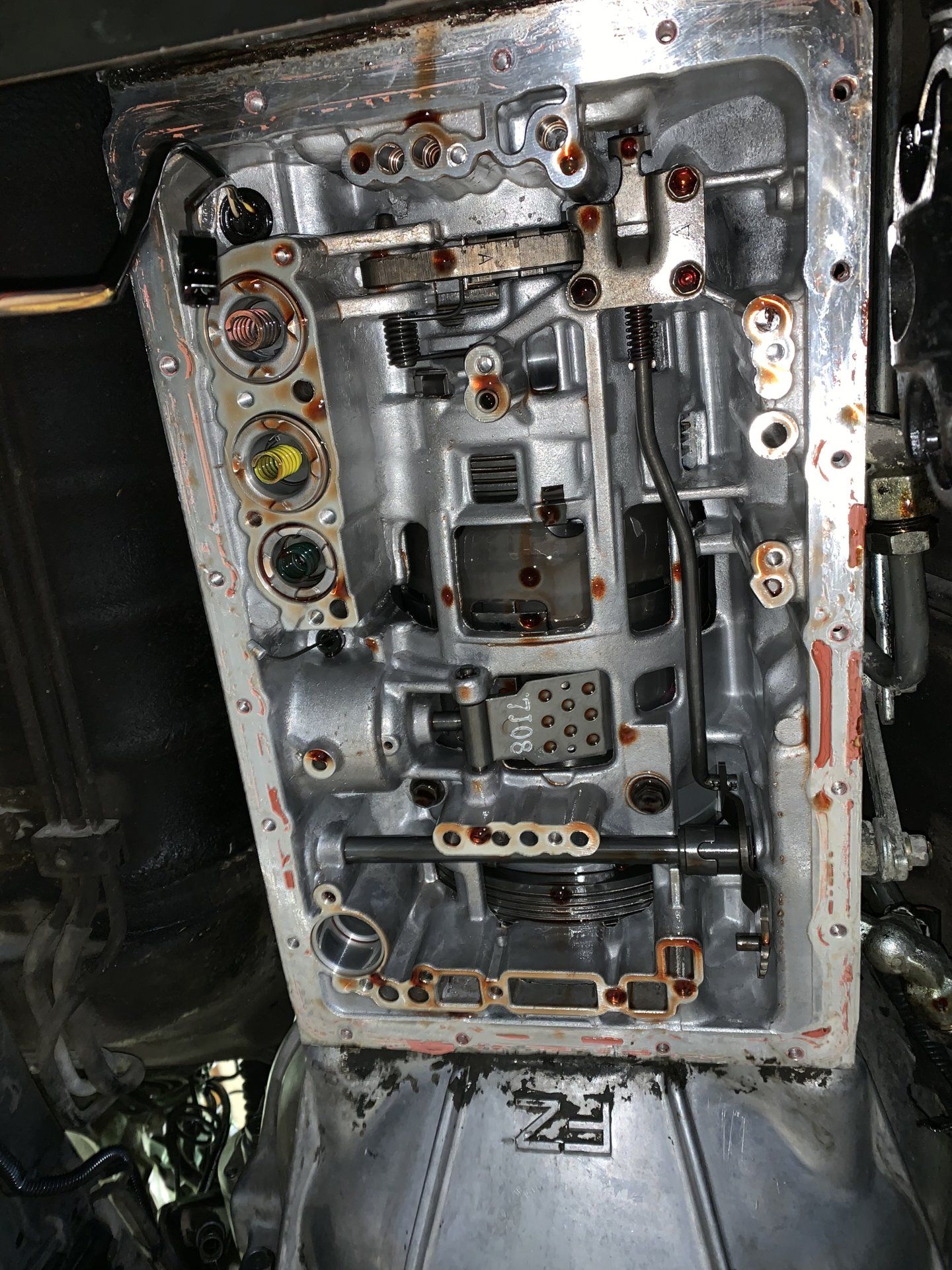

Nice pics! Can you point out the 1 - 2 hole that you enlarged please?

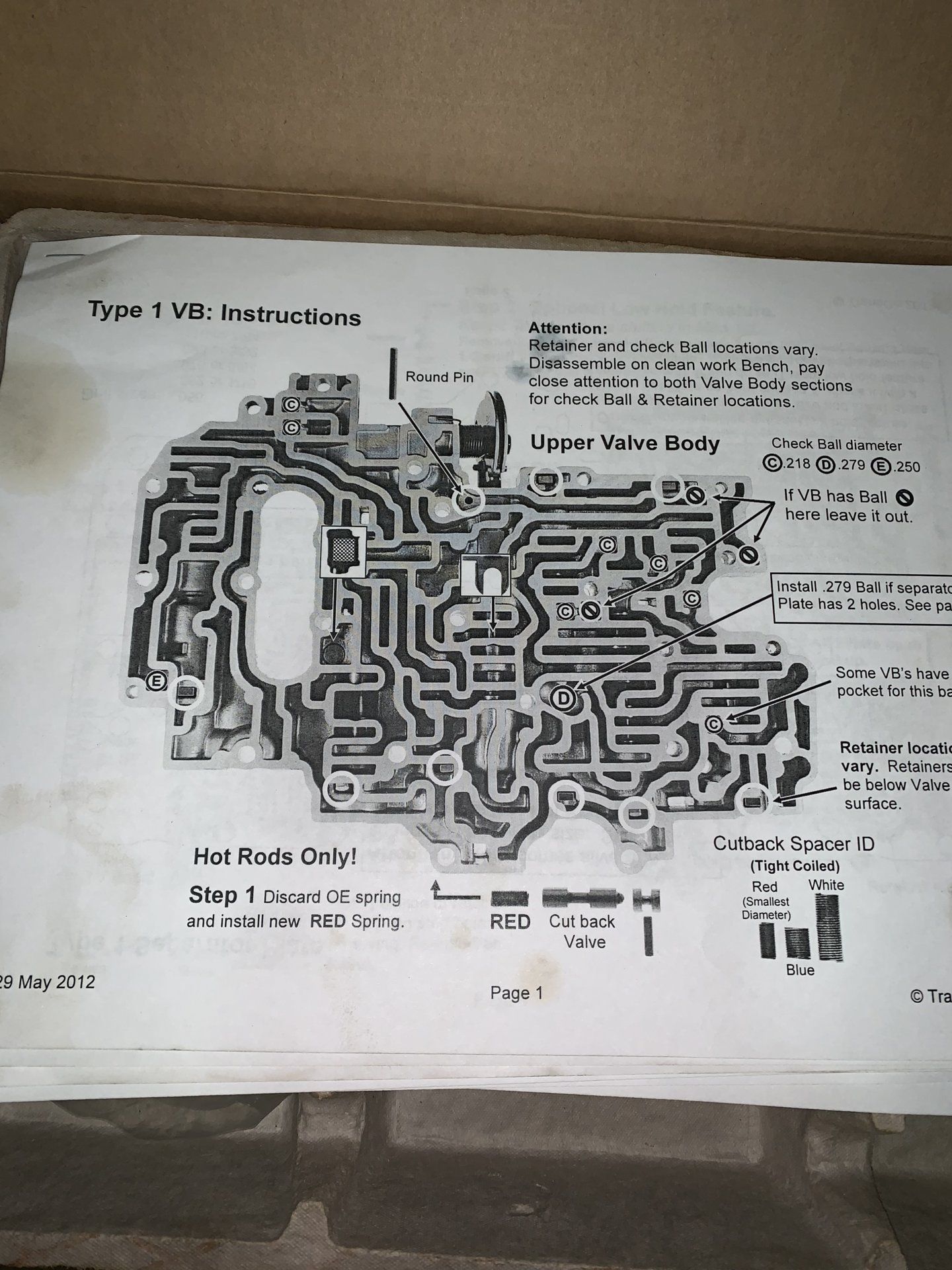

My box showed yesterday. I was disappointed that they didn’t list which of 4 options an application would have.

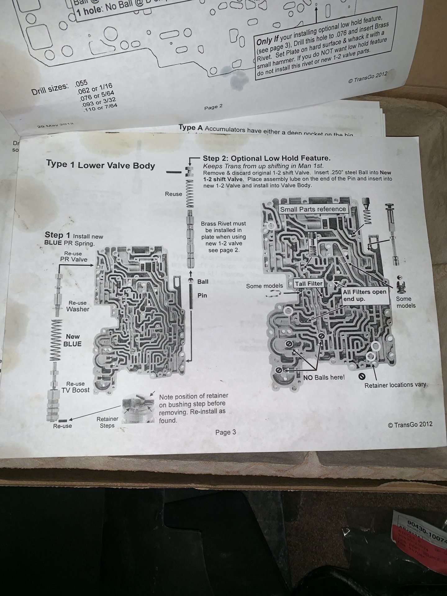

I was FAR more disappointed they didn’t put part numbers on the bags!! Directions just say take the “red” spring, etc. There are several “red” springs. I was really wondering about the pins and dowels. I haven’t taken anything out of bags yet.
As far as I understand, the “1st gear hold down” part of the kit is unnecessary for us, transmission stays in 1st when “L” is selected in a stock truck anyway.
Correct you do not have to worry about any of the 1st gear hold down parts.

I just did mine last week. Read the link above(from lilevo) and follow that. It’ll be clear once you pull the accumulator pistons what goes where. You’ll clip the springs on the bottom(between the pistons and valve body). It’s all in one bag. Plain, red and blue springs, plus a pin. It’s meant to be a do-all kit and cover lots of different models of the same transmission family.
