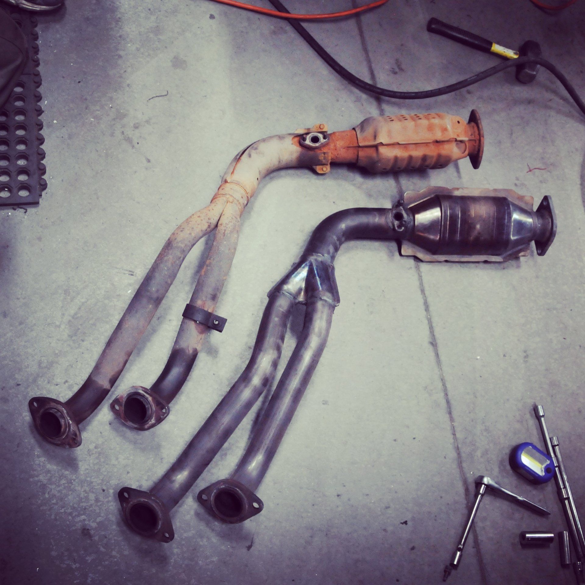

Wanted to point out the differences between the OEM cat/Y-pipe and the Magnaflow aftermarket. Mounting is identical. There is no heatshield on the Magnaflow so you will need to add one or else it gets hot under the passenger’s feet. But since it’ll all be a new downpipe setup there may need to be another solution. I think I may redo what i have on my SC’d LX. The cat on the Magnaflow is rotated to lay flat on the truck which is a good improvement. Only bad thing is my Magnaflow cat’s honeycomb dislodged itself from inside the cat shell and rattled like CRAZY! :bang:
