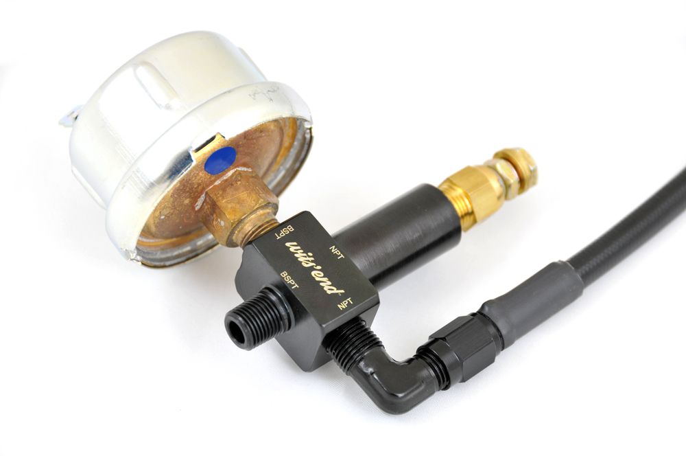

Not that you need it, great explanation above, but the Safari systems have a similar oil tee and have had successful operating experience for about 20 years. Here's a photo.
