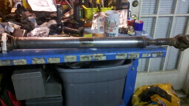

Then had a rear driveline made up for my new axle.

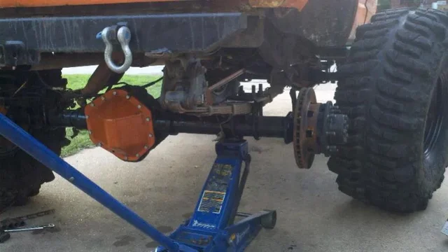

And then started getting it all put together and bolted together.
Also got the caliper bracket welded on over on the other side and caliper ground down to fit my 15" wheels.
Still waiting on a brake line to show up and have to get a couple of others made still, well 1 and me bend up a couple of others or at least re-flare and cut for the right lengths.

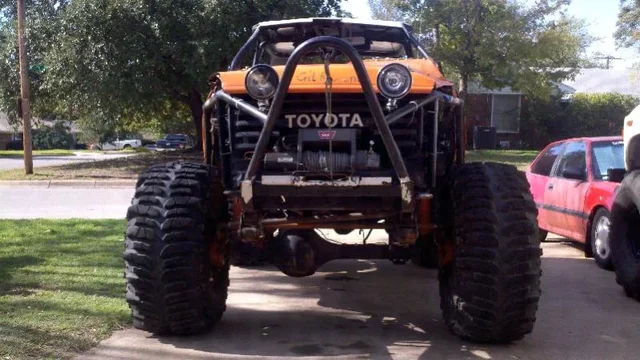

Then decided today to go ahead and move the headlights to a more secure location since I kept hitting them and breaking them out. Also when I stretch the front and link it they would have been in the way if the tires so easier to just do it now. Also they needed new bulbs so just did it at once. I kinda dig the way they look, not to mention with em higher I should have a little better visability as well and less mud covering them.

Sweet good to see her getting back on the trail ... I sure miss the olde girl too
Looks like an alien!
Nice orange parts under there. Is that little thing just to protect the u-joint?
Yea the rear axle no longer has a flange to bolt to. Instead it uses straps to hold the u-joint in place. When in the rocks you will notice that the flange can take a pretty good beating without failure (my flange and yokes had some nice deep gouges from this) but the straps will have a tenancy to stretch and distort, once they do.. PLINK! you just busted a strap and threw your u-joint. With the pinion guard it will hit first and protect the straps.

That's what i need to start on, a nice beefy 14B.
Looks nice under there.
Thought you were putting fr fenders back on?
Holy Krap..!! Guess that was what it used to look like huh??? :D Just like me to be late to the party! Nice Toy you have there. :cool:

Yea the 14B makes me happy seeing it under there completed finally.
And I was going to put fenders on it but the way the hood was cut and shaped from the factory the fenders are a couple of inches to short to reach the end now and the angle of them is all off when they are lined up not to interfere with the door opening and closing. I haven't given up all hope yet tho, may buy some sheet steel, cut them apart, and section as needed to get em on there. I still think that a stockish looking fender skin would make this thing just kinda pop and be more identifiable again. We will see.
