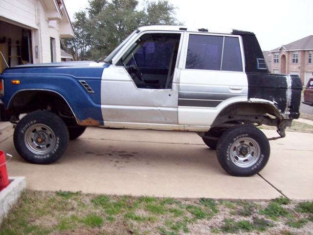

BObed the 60 16in
lookin good. i like the round stock idea

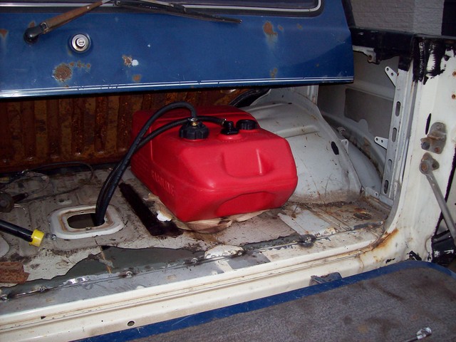

got the door on and backed outa the garage ... put a out bord motor tank in for a gas tank for now :toast:

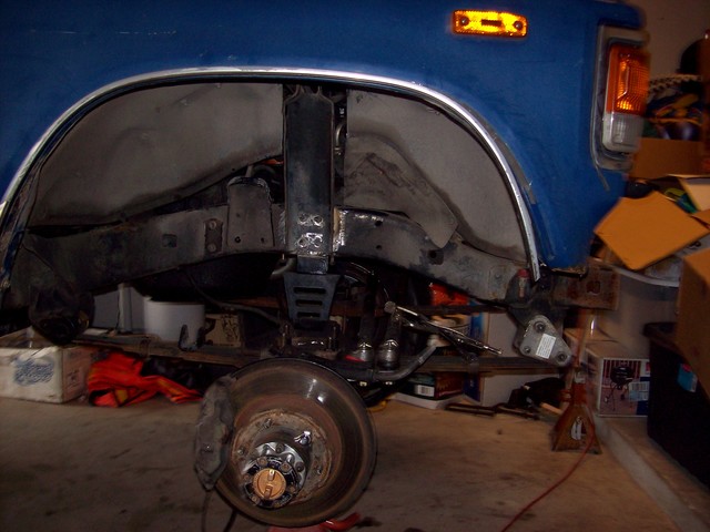

heres the cross member thank JK for helpin me out
got the front shock mounts on the drivers side sucked to clear the P?S box but its on there and pulled the rear diff to swap the gears round up here I come

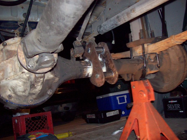

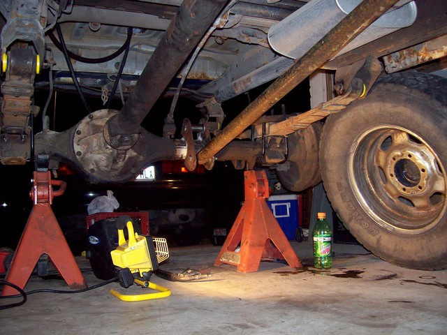

cut some sleves that just happen to fit jeep spring bushins I had
mount tacked
jeep shackle on the cross member
bottom bar on for lookse
i think it will work out ok
Wow. Looks pretty sweet. Like the short look. Almost Bronco-esque or something. Would consider myself, except I sleep in the back of mine out hunting, and I'm already too tall for that. I have to go corner to corner and still scrunch just a bit. Maybe I'LL buy a second....
started chopin the rockers and fenders
how are you going to finish the "bed" ?
what do you mean ??? the rear cab area ... or the bobbed joint ???
Behind the rear seats, the wall that goes between the seat back and the bed area. To complete the ute thing.
for now nothing but I want to make it a cubby all the way to the back set so a cooler will fit it
