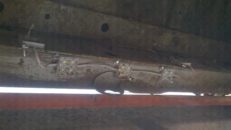

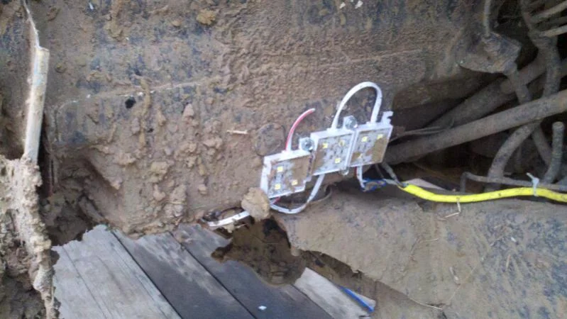

They come all strung together on one long strand. I just Cut off what I wanted. I ran 4 up front per side and 5 out back in the center since I was covering more area and also wanting to light up my drivetrain.
So I still have some to make an under hood light and maybe something else if I can think of anything. I will try and get ya some pics this weekend, its over in storage right now.

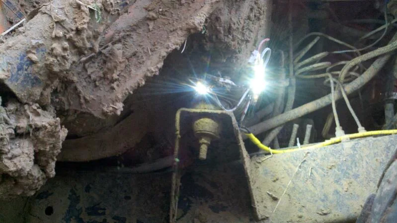

Up front on each side I have 3 mounted to the firewall right in front of the body mount and one facing straight down right beside the body mount.
Out back since I am bobbed my tailgate is a lot closer to the diff than a regular 60 and I stuck 3 in the middle directly below the tailgate and on either side I of that I have 2 facing towards the front of the truck.
Since they are all strung together just get power to one and good to go. I used the 3M tape they come with to attach them and then ran some self tapping screws into the 2 little tabs on em to secure em through the texas heat combines with the mud and water they will be submerged in frequently.

How I mounted the lights.
Sent from my DROIDX using IH8MUD

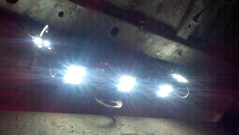

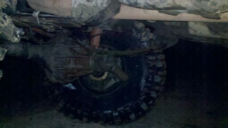

And the lights on.

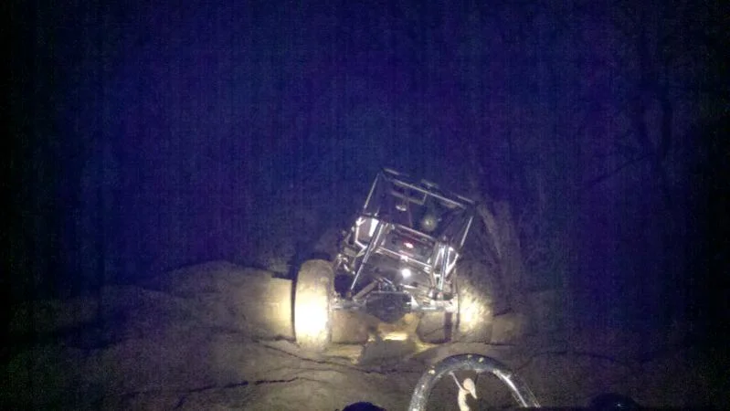

What happens when you floor it up a slick hill with some deep ruts 3/4 the way up that have a lip and much softer ground?
You do a wheelie!!
What happens when you stay on it hoping the coming bounce will get you up that last little bit you need to get enough bite to be the only one to make it?

You loose a front drive shaft!
It sheered all 4 bolts to the front shaft at the transfer case and dropped the shaft out.
14 bolt u joint strap bolts with some washers borrowed from a jeeps street lock wheels and some nuts for a u bolt style u-joint strap for a Dana 60 had me wheeling again.

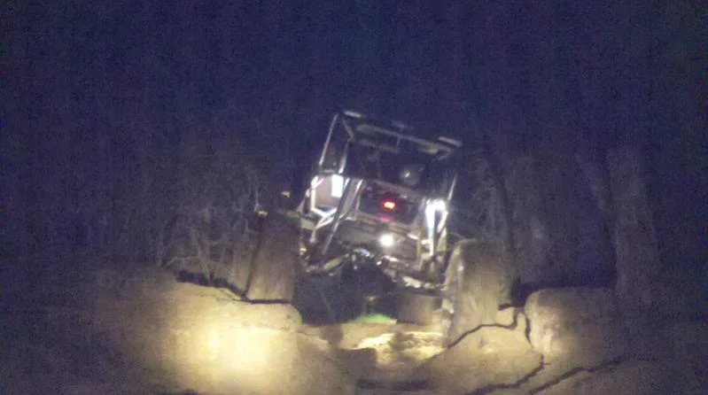

The jeep I was following trying this first and taking out his front shaft. Broke the u-joint straps on the front dana 60.
And having to back out of the creek we went through to get to the climb with rear only.
