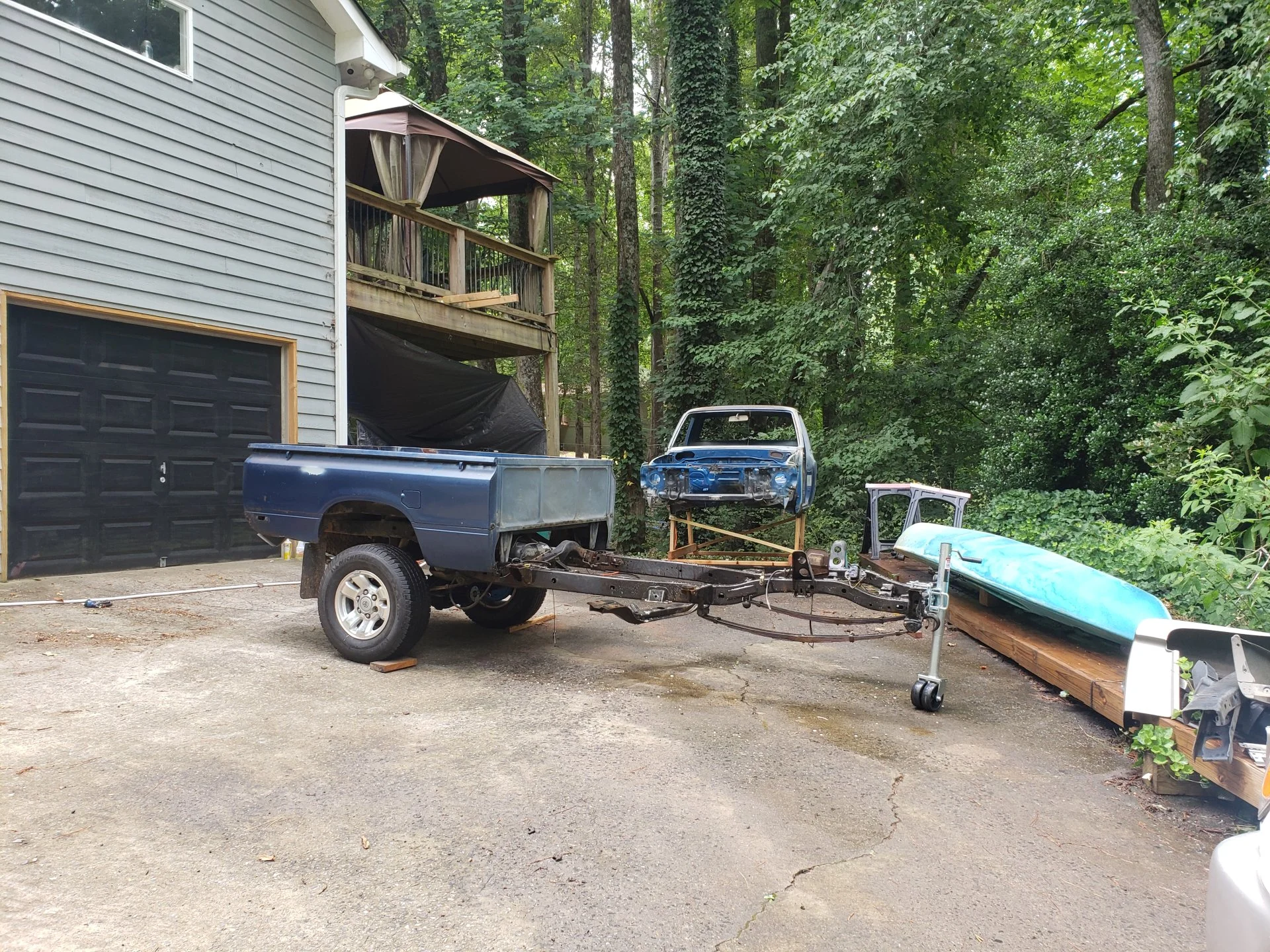

Anyone know where one might find a rebuild kit for the stock AC compressor? It might be fine but I have been rebuilding everything before putting back on the truck. Might try this kit but doesnt contain bearings Denso 6P127 and 6P148 Body Seal Kit MT2140 - https://www.shopcenturyautoair.com/store/p87/Denso_6P127_and_6P148_Body_Seal_Kit_MT2140.html
Nice build! Not surprised the original axle was bent, they were the only solid axle in those trucks that didn't have a gusset at all. Toyota remedied it with a half gusset from 1980-1983 and then a full one 1984-1985.

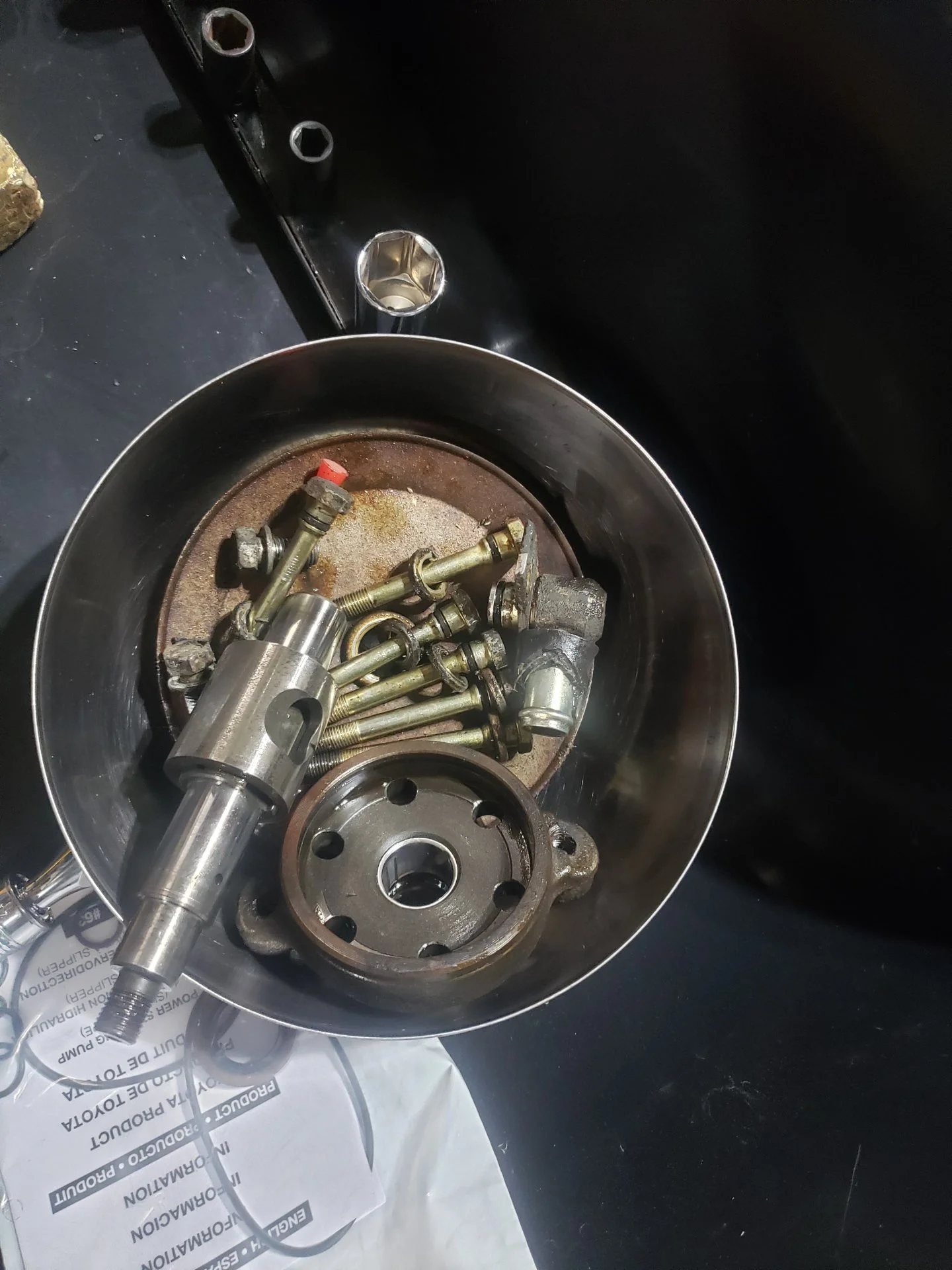

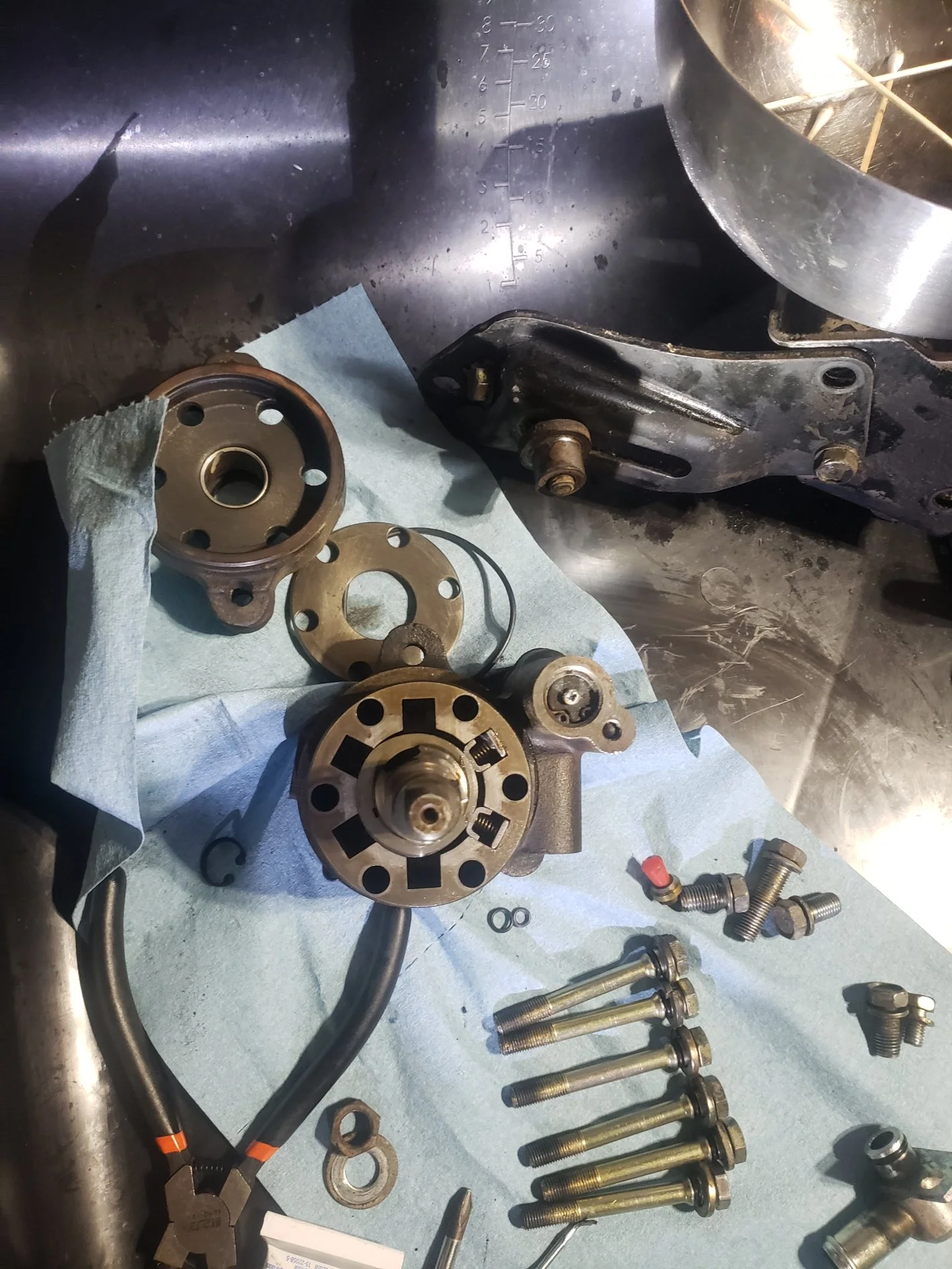

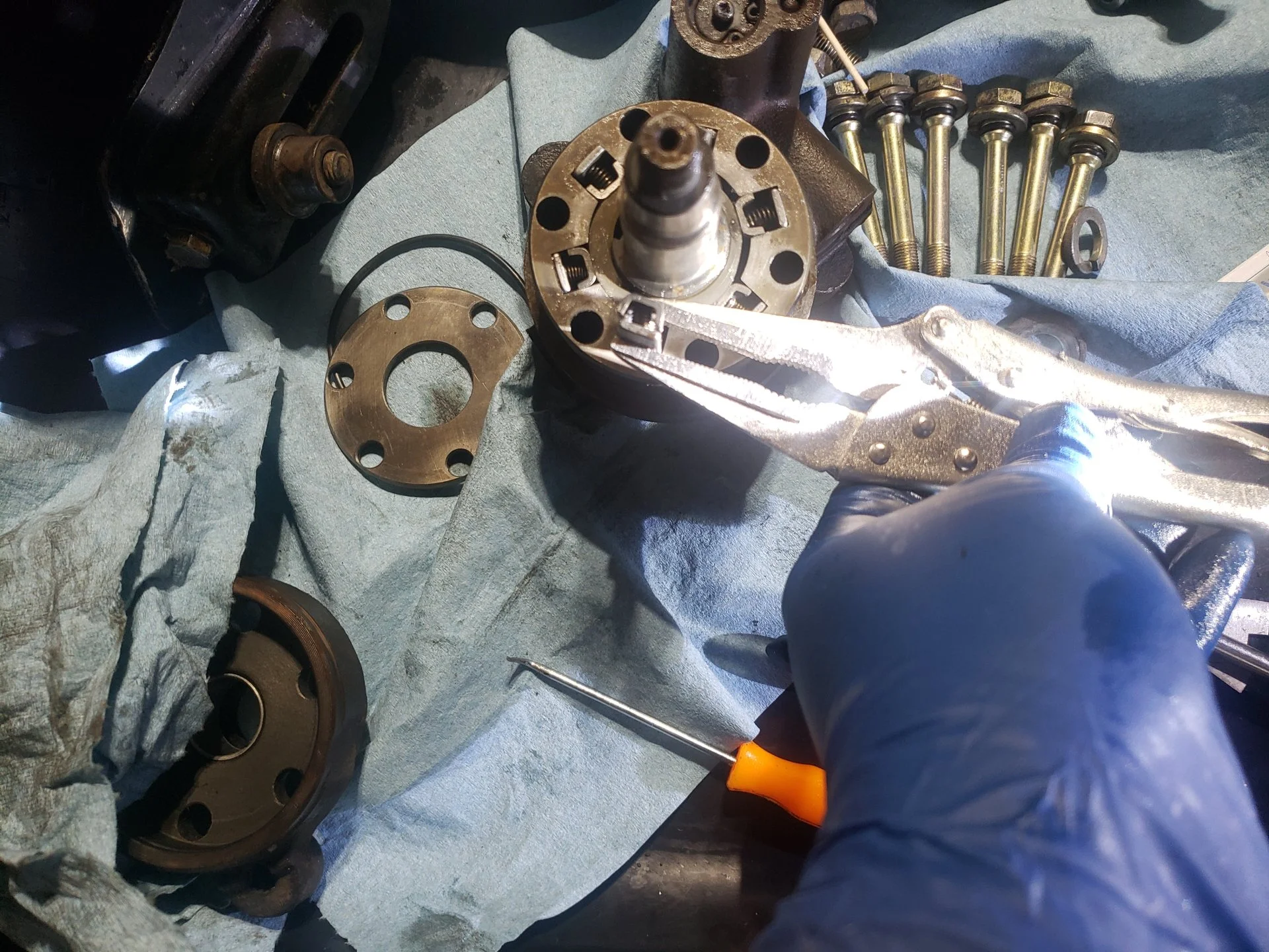

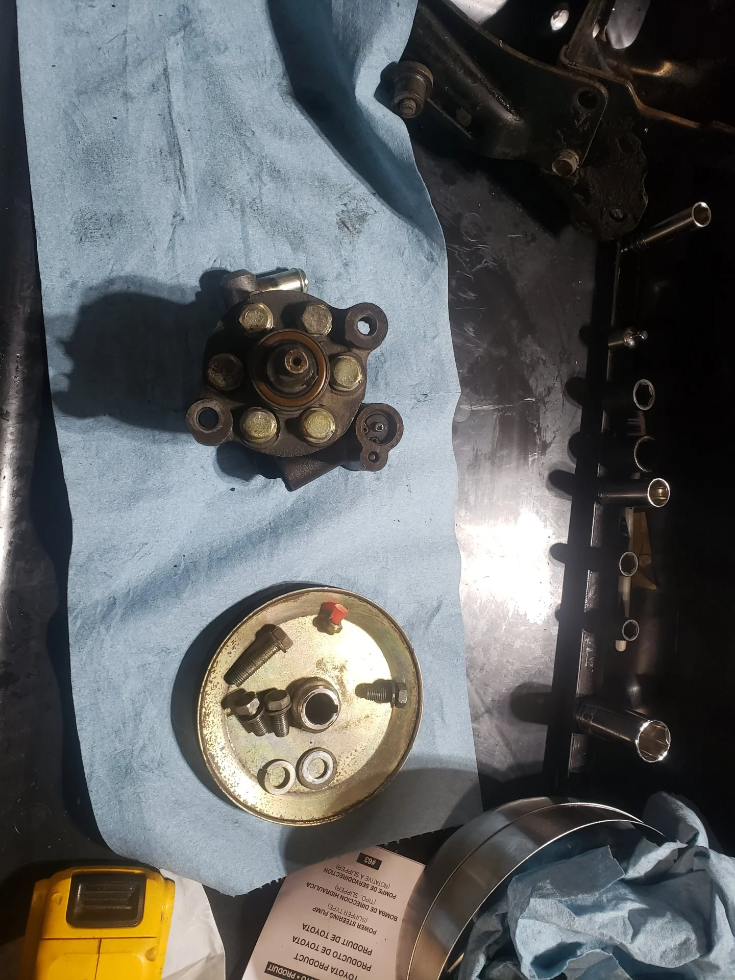

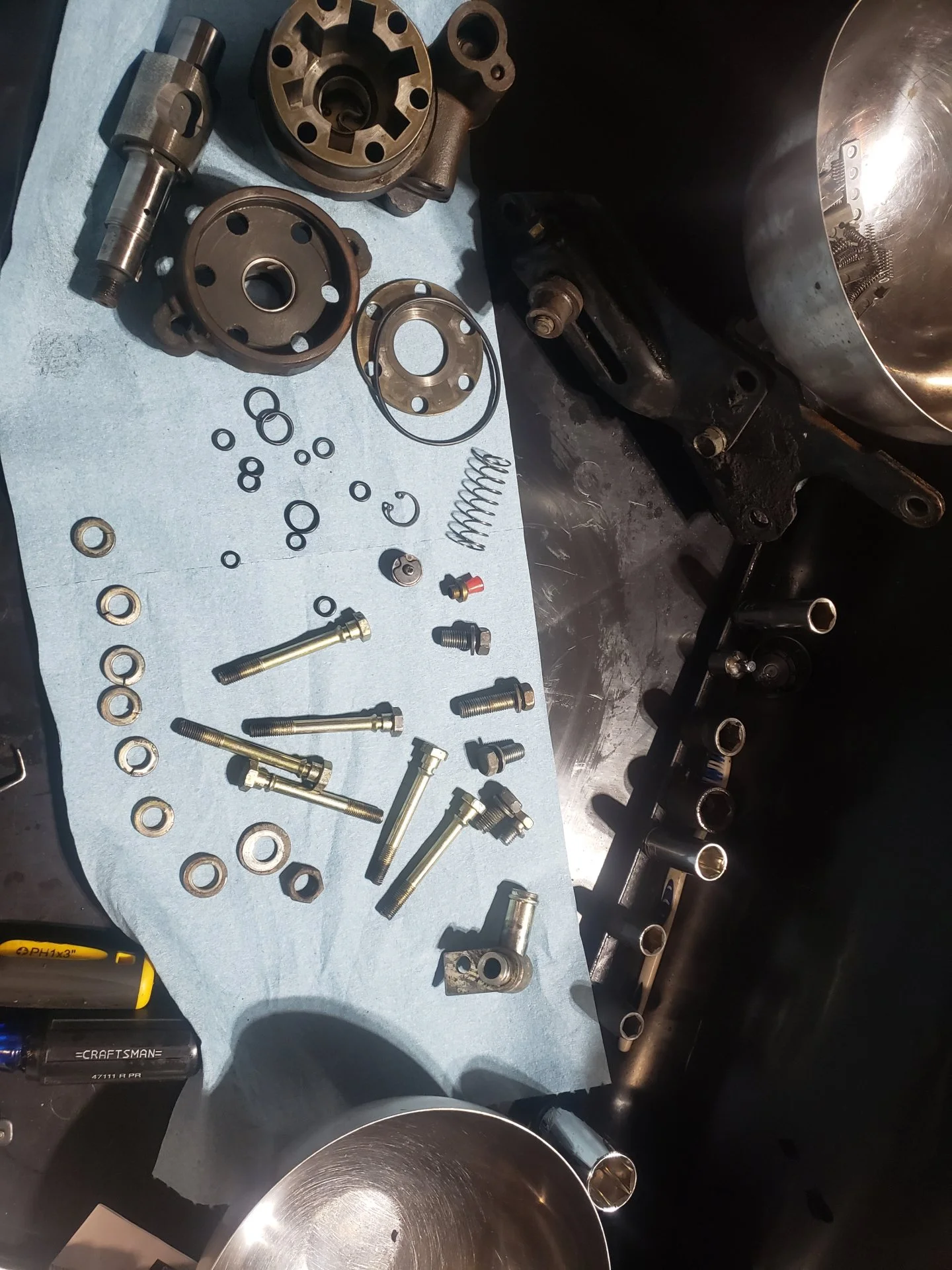

Got started on the power steering pump.
The Flow control valve cap that has a little snap-ring for removal. you will need to reuse the one there, as the one in the kit is the wrong profile and doesn't fit on the indented cap.

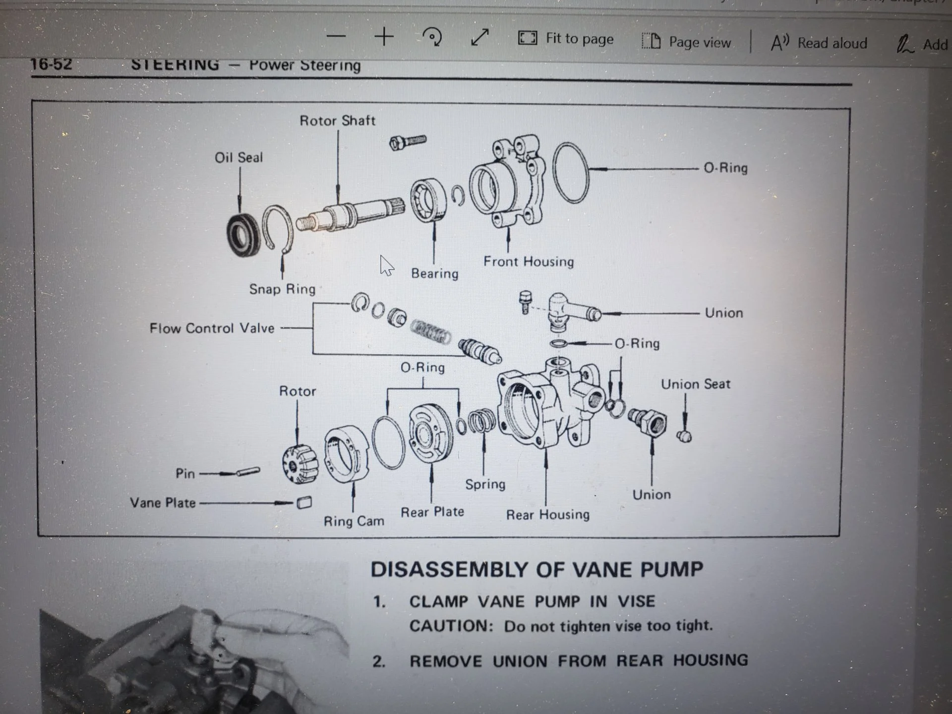

Something about this pump matches none of my factory service manuals.

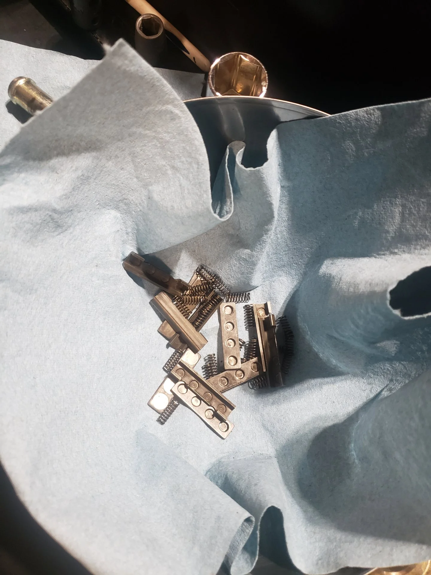

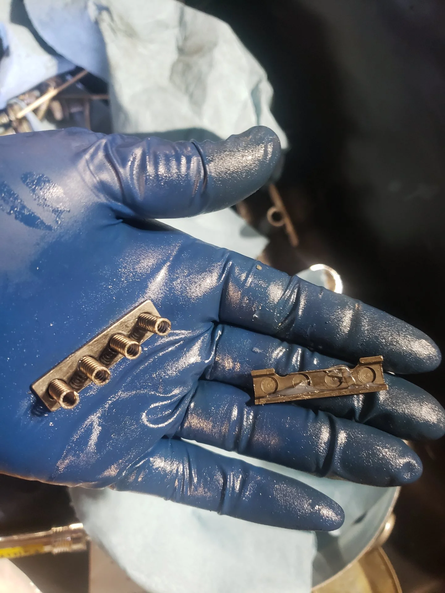

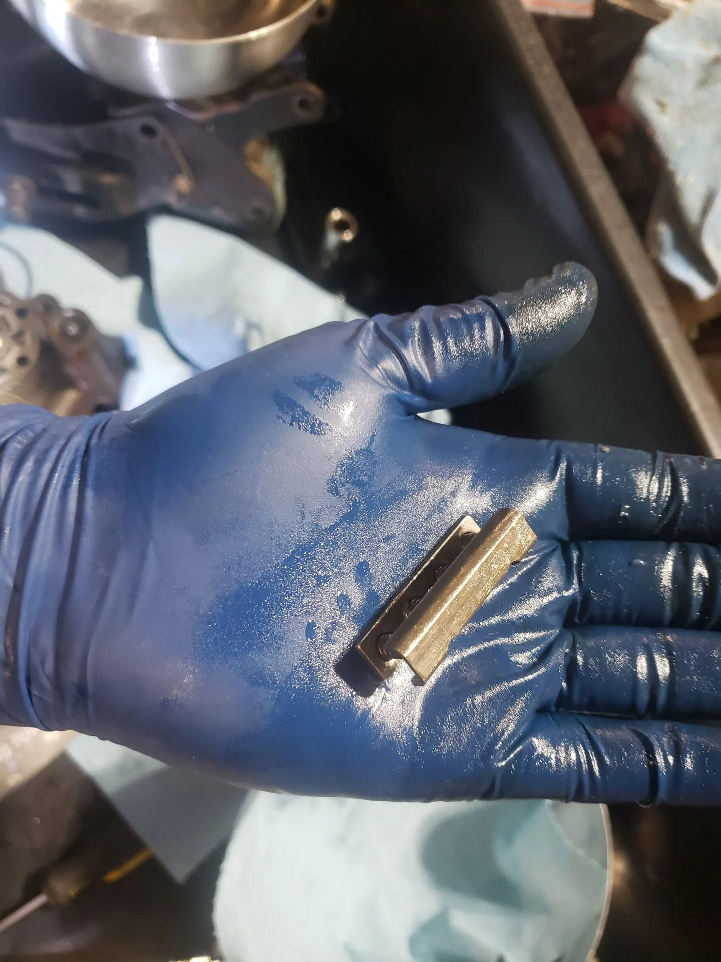

The vanes are completely different that what I was expecting. These were by far more complicated than needed. I may consider grabbing a newer pump and rebuilding it just because this format does not seem like it would be nearly as efficient.
Used some very sticky dielectric grease to get the little springs to stay in place. You need to make sure that you get these brackets in facing the correct directly. You can look inside the housing and see which side has wear marks for to show the direction.
Make sure you use this SST to compress the springs and be careful to slide both plates equally at the same time or you will be doing it over and over again.
This is what I was expecting to see which is the same style as what is used on the 80 series land cruiser pump that I rebuilt previously. Vane plates are a lot easier, but on the flip side you don't need any sort of press to get stuff back in like a large snap-ring.
Here is a link to what I should have reviewed before hand from partsouq's website: https://partsouq.com/assets/tesseract/assets/global/TOYOTA00/source/MC/MC6163E.gif
Back together.
How many parts did you have left over? :rofl:
Ha none this time, but the snap ring that comes with the rebuild kit doesnt fit exactly right so you have to reuse the old one. Fortunately it wasn't rusted or stretched.

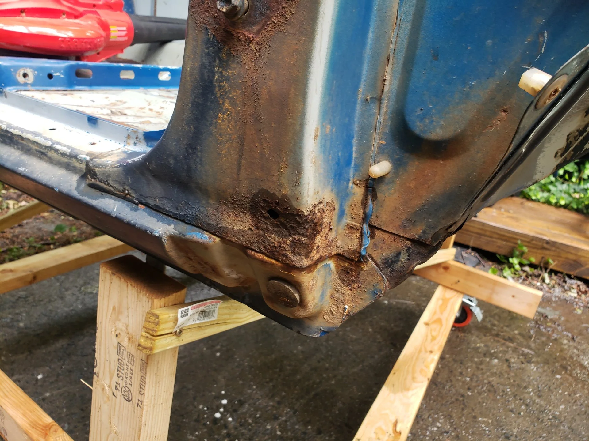

Today I rolled everything out to the driveway and went at them with oven cleaner, pressure washer, leaf blower, then degreaser, then pressure washer, then leaf blower again. Removed over a quarter inch of buildup from the trans tunnel and got a good start on much of the undercoating down to paint. I have a few areas in need of being addressed but grease has been keeping me from doing any of the little steps after work etc.
A lot of clay came out of the frame. I clear the clogged drain holes. My idea to run a rotating drain nozzle from my pressure washer down the framerails failed as there is no way to run it all the way down one rail. Did what i could using the access holes but i will have to find a way to spray and apply rust converter on the inside and then some sort of coating before i start painting the outside of the frame.

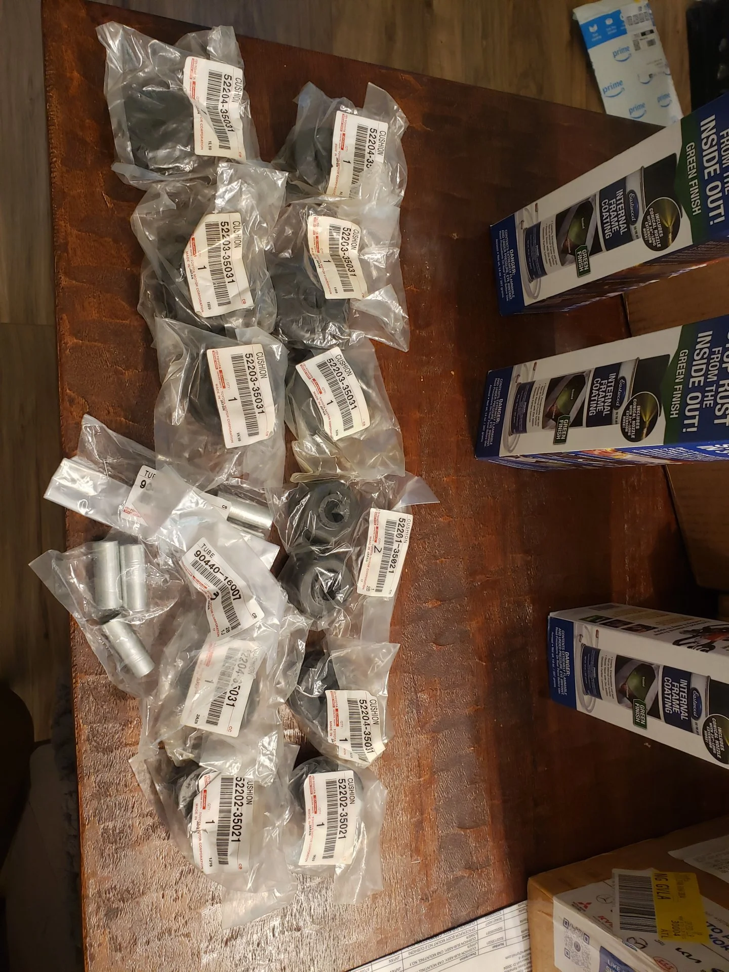

Body mounts are in and internal frame coating also arrived on the same truck!
Well for the outside of the frame I will be using KBS Coatings Black Satin Frame Coater Kit 57002 but I am going to use the Eastwood Internal frame coating (in green) which has these multi directional spray nozzles on 24" tubes to spray inside the frame. The frame doesn't have any bubble rust anywhere but still plan on using rust converter to get in all the little places I won't be able to get to via sand paper or wirewheel. I am also hoping that the eastwood will allow dirt and water to run out easier and that the drain holes in the frame won't get clogged up with mud and dirt. I cleaned a fair amount of Ga clay out of the frame in chunks. I know the truck was slated to be a rock crawler by the two previous owners so I am sure the truck saw at least a little mud before they spun the bearings on the 20r. The truck is going to be a daily driver for me but I don't want to spend a bunch of time working on the outside of the frame only to have the inside rust out on me.

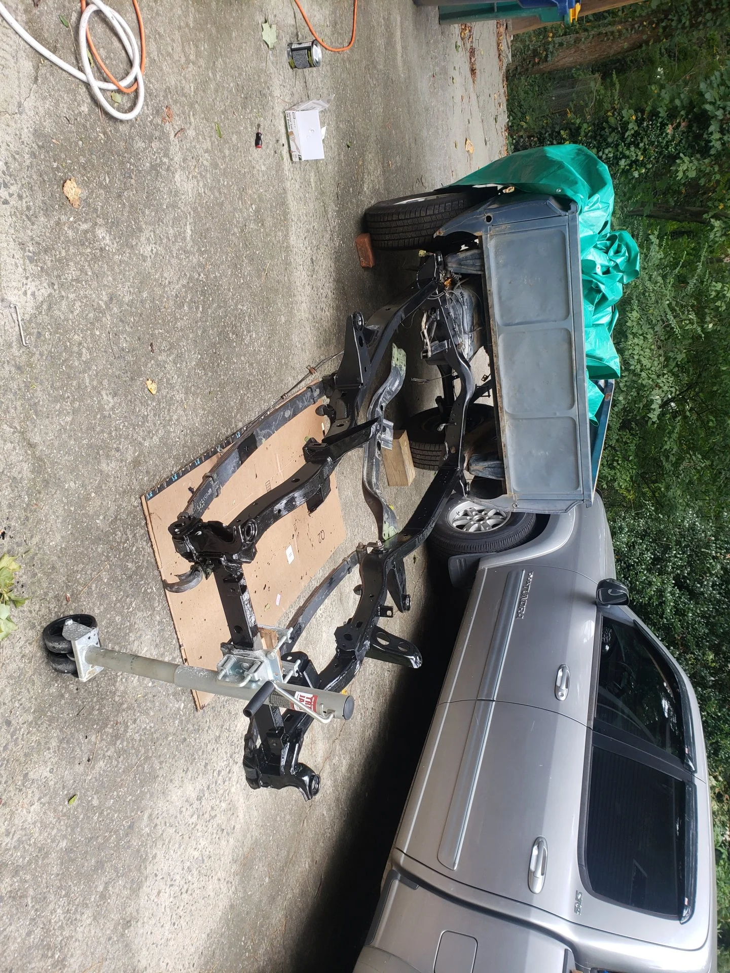

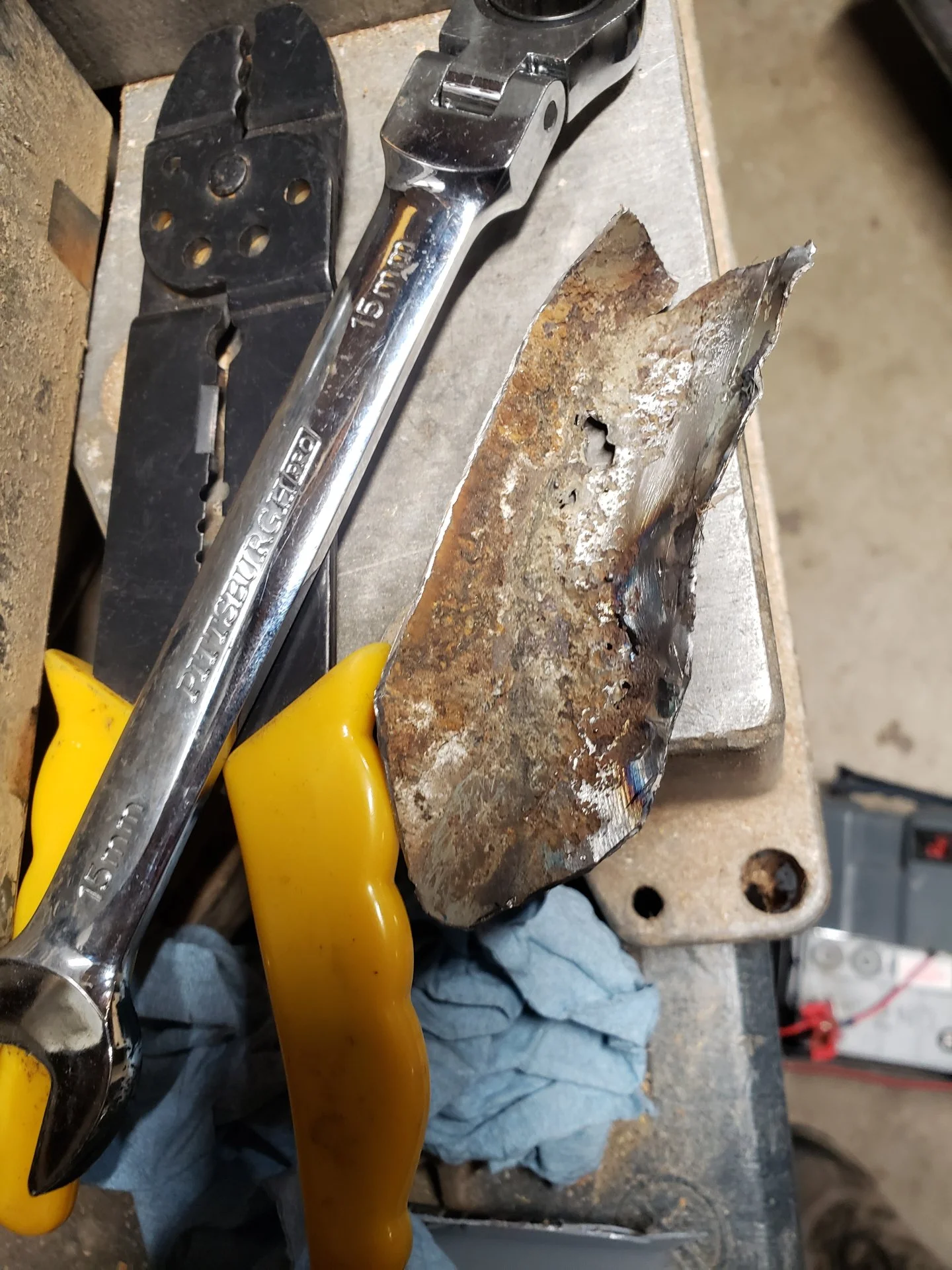

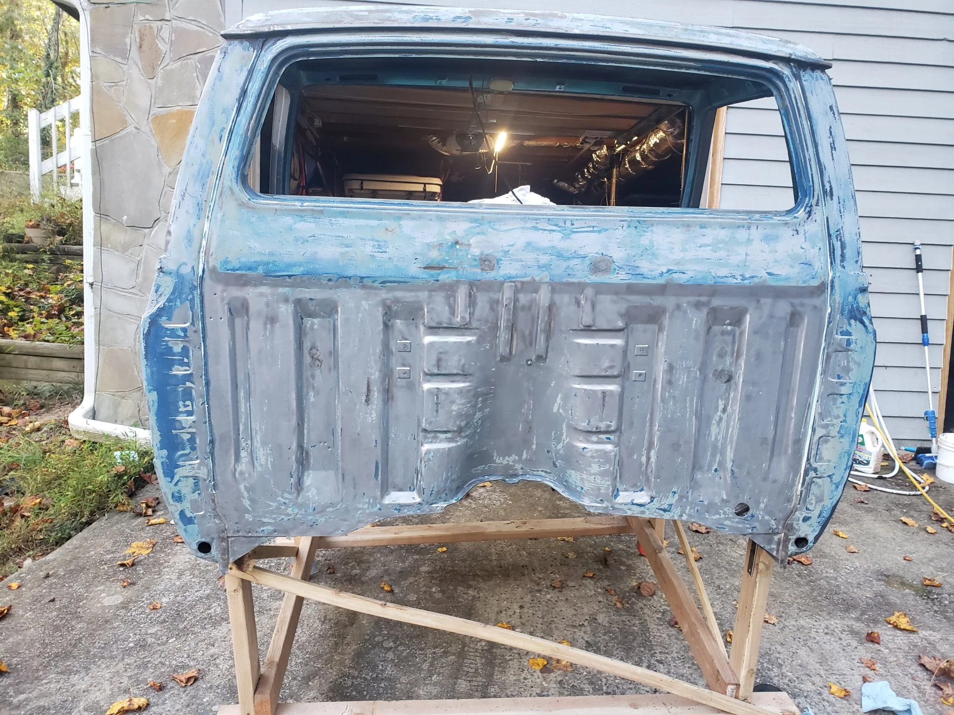

Well it has been a bit more progress. Front part of the frame has been cleaned and coated, inside and out. Bottom of the cab cleaned and painted. That includes welding the rip from some driveshaft explosion in the past. Cut out some rust and replaced. Re seam sealer a bunch. Now to get the back and roof ready for primer and paint.
I have been replacing seam seal or adding here needed to various places using 3M grey but i am wondering what to use inside the roof gutter around the top and down the A-piller as that might be something that is supposed to be hard. It is hard to tell since it is so old everyone is hard and brittle.

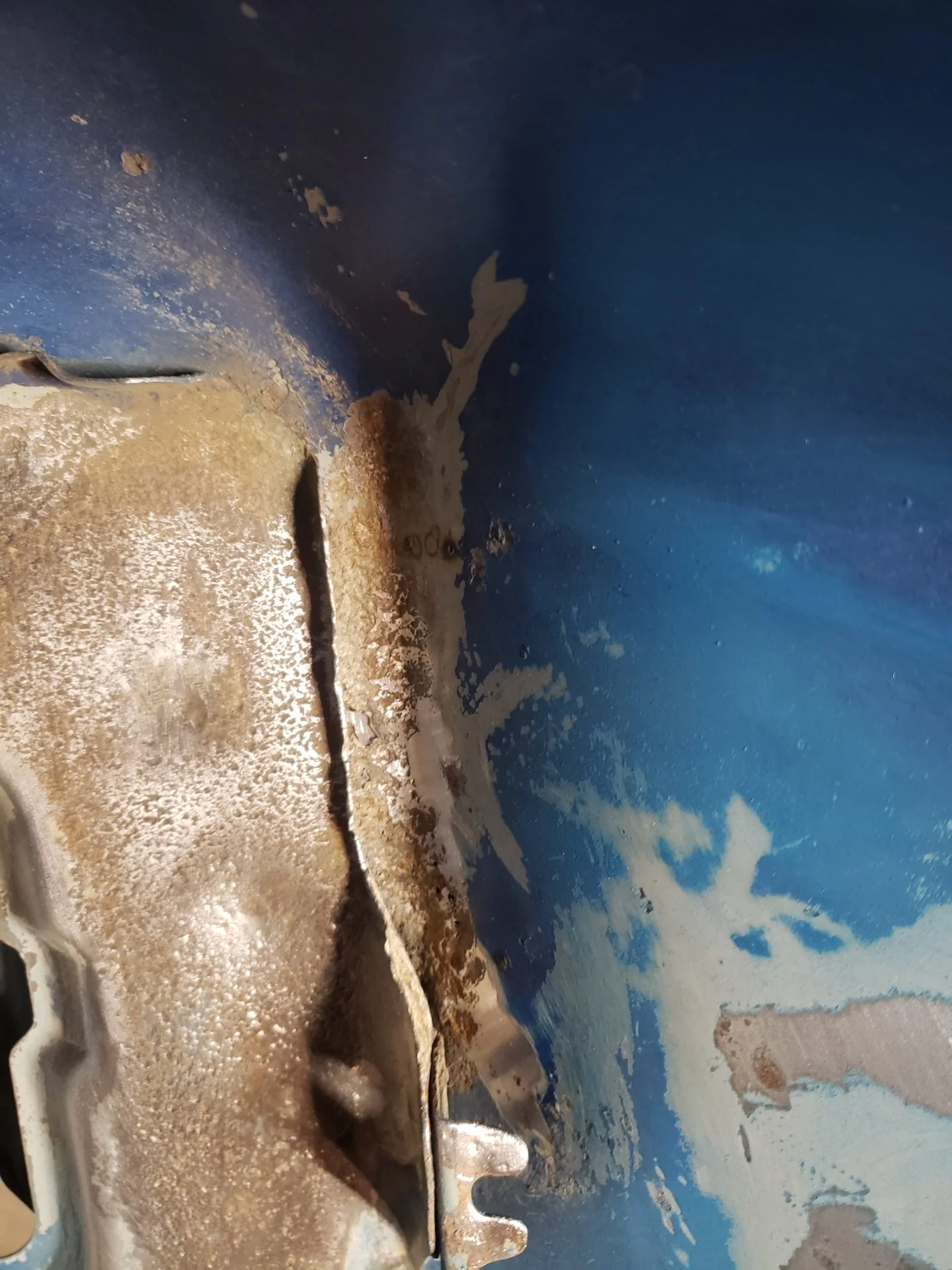

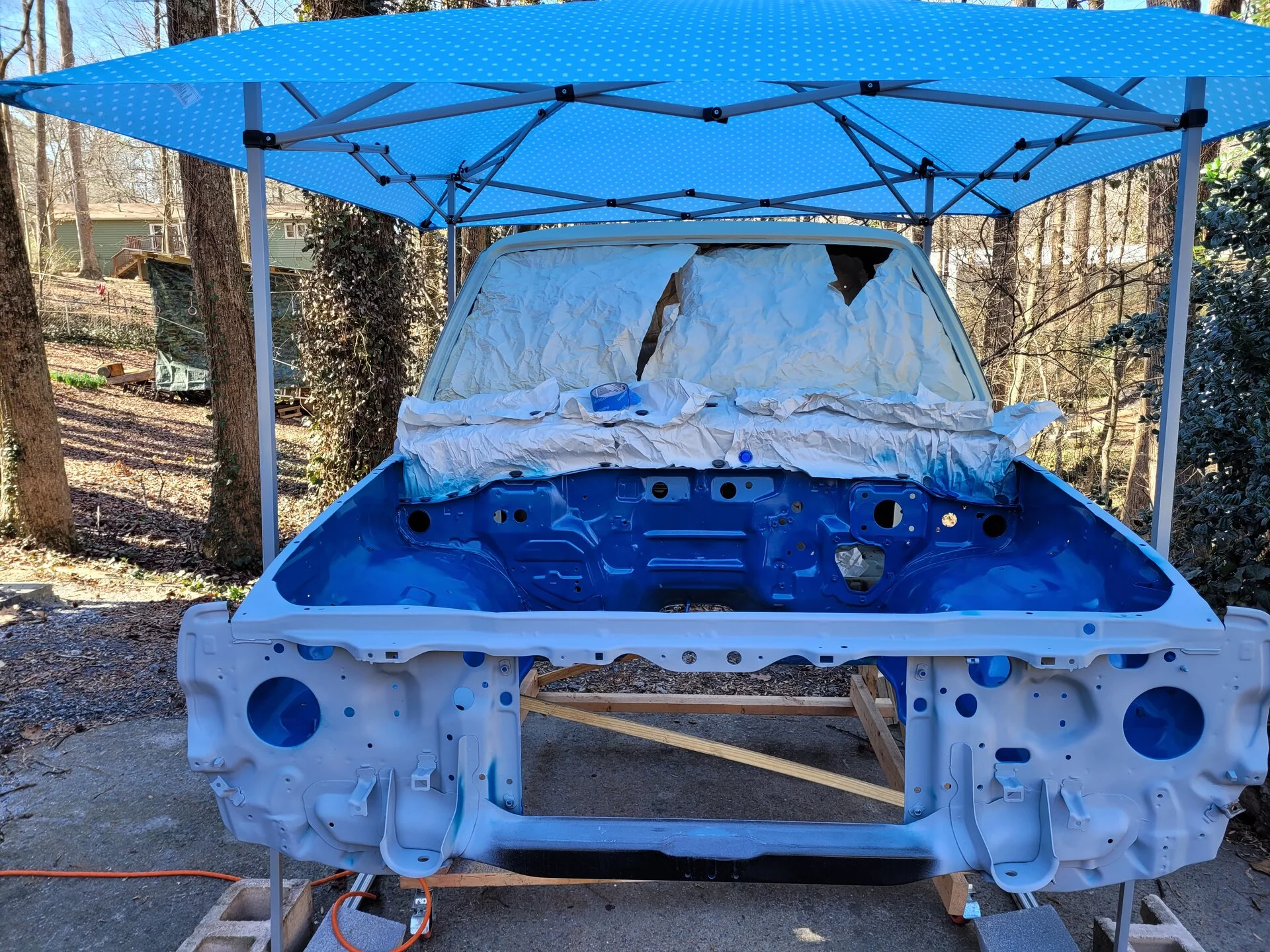

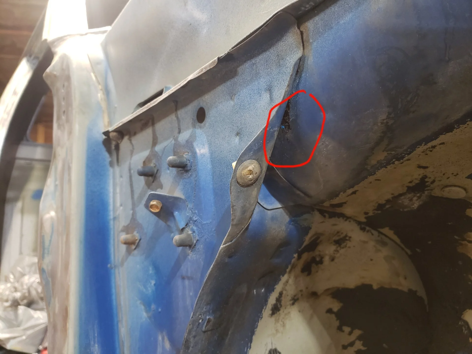

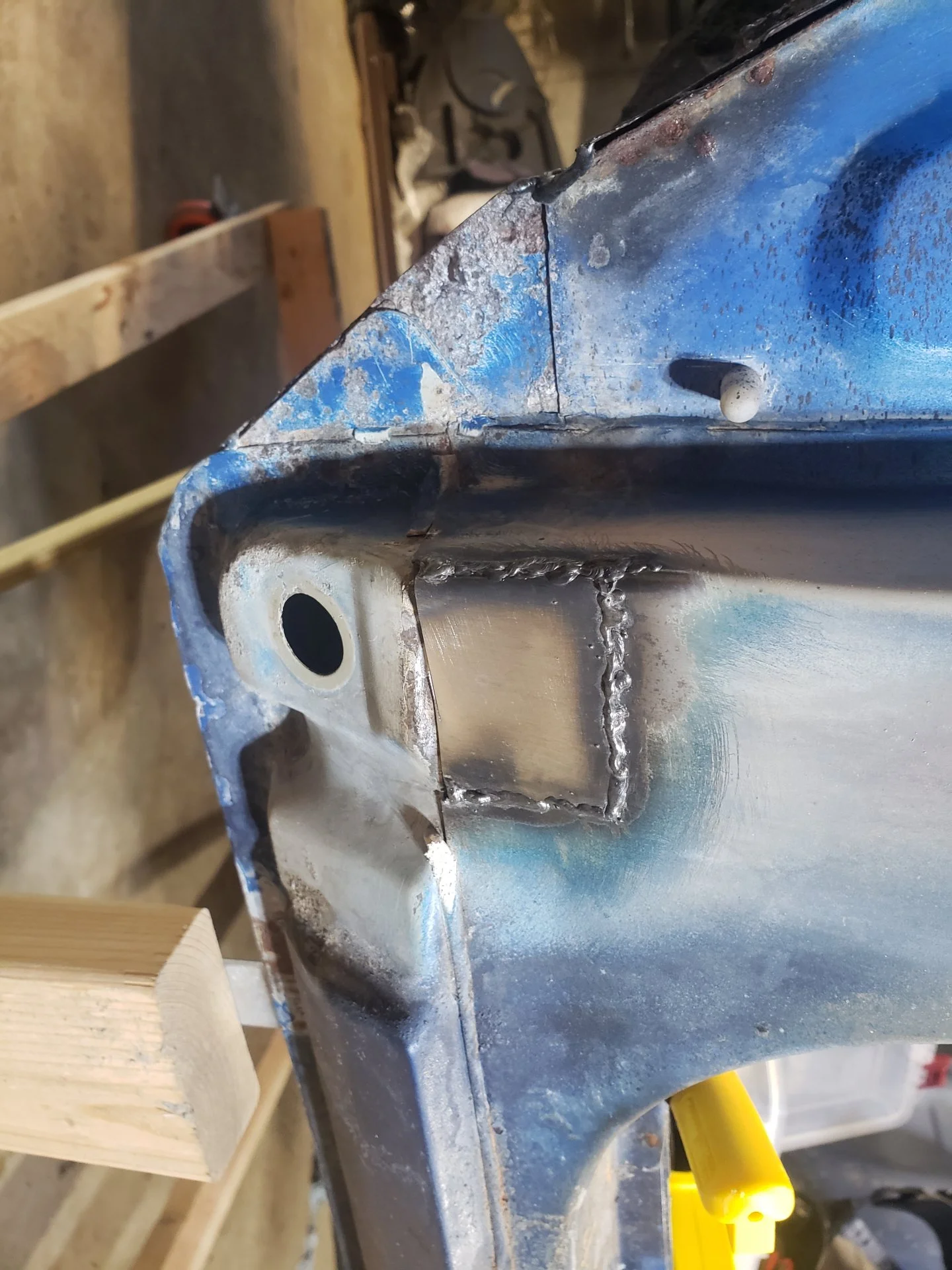

Starting on the engine bay body work. I can't leave the holes there next to the battery tray. I also found another hole and not sure how i am going to fix it and paint/seal the repair after because if where it is at.

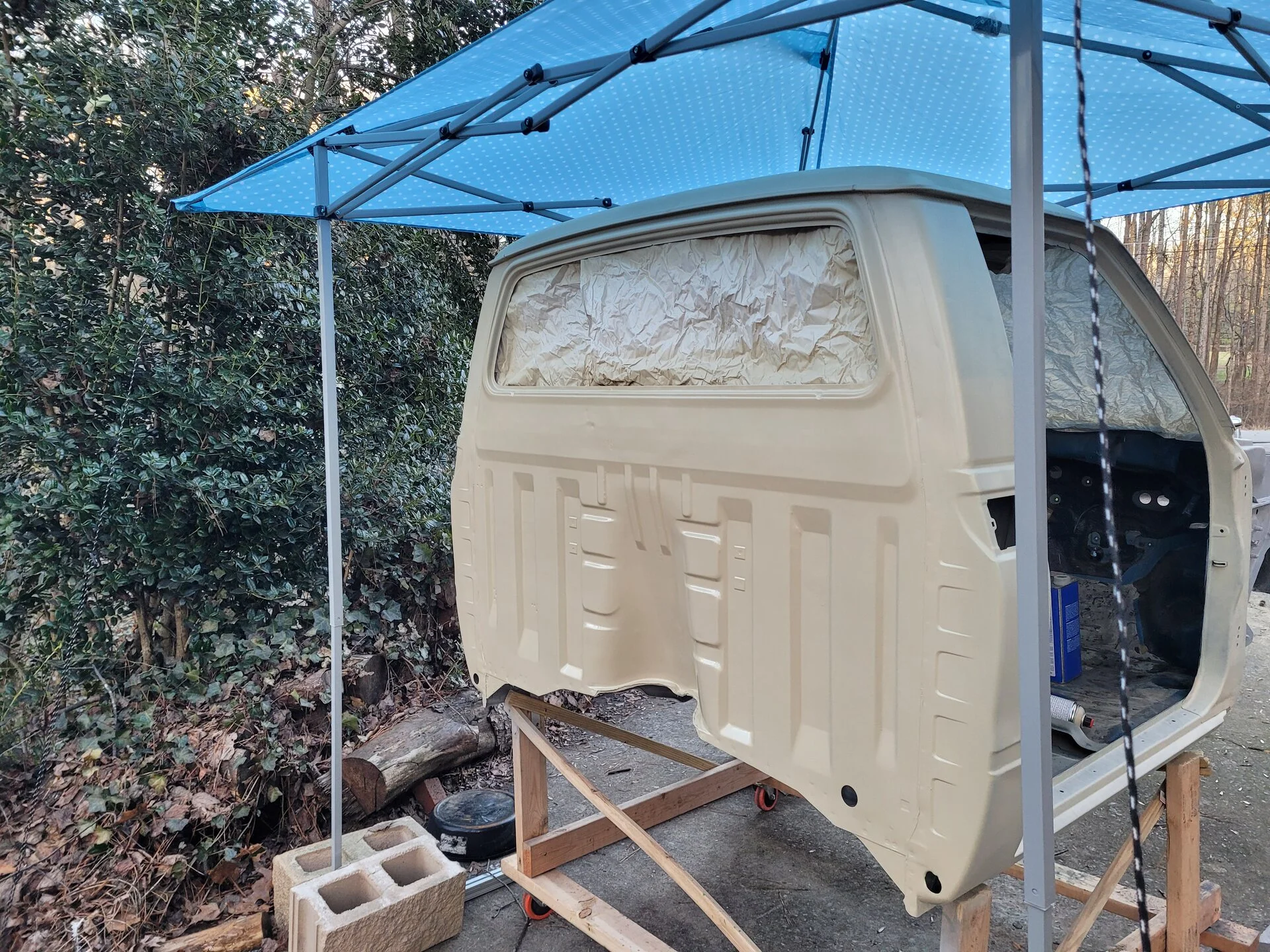

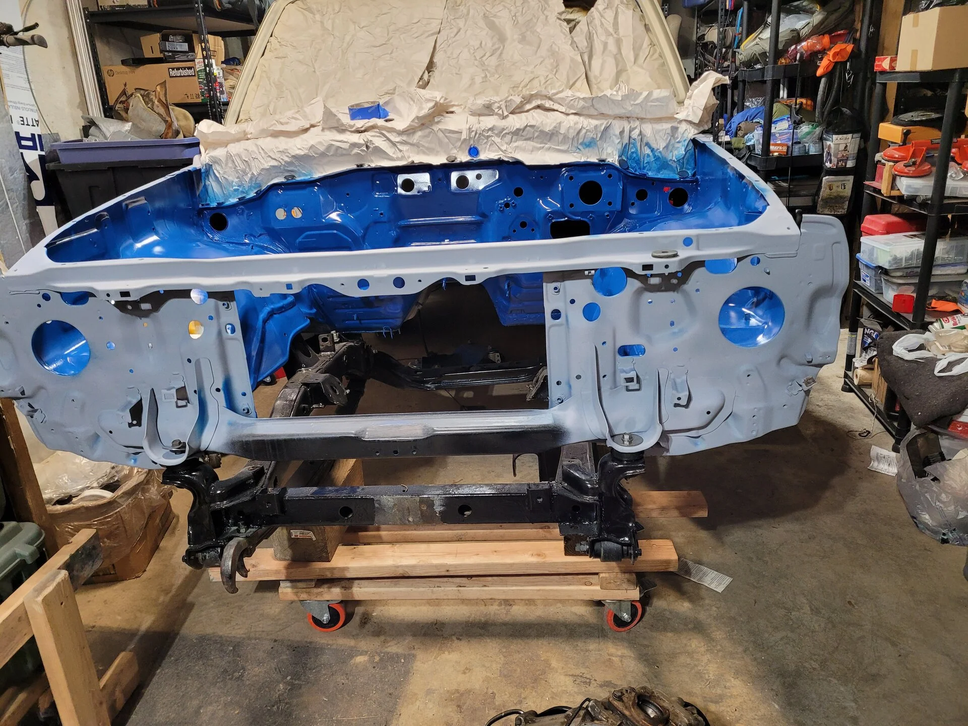

It has been slow going but the hard to reach places have been epoxy primed, painted and clear coated so that I could get it back on the frame and off the dolly.
