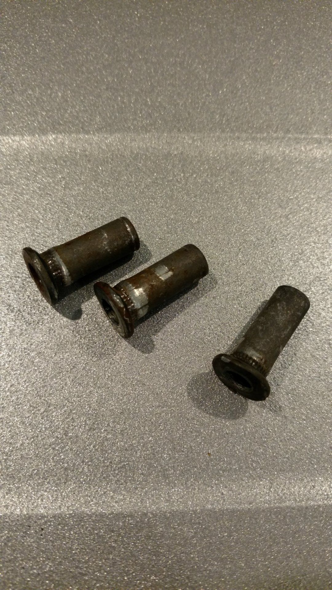

Next was the nut/thread rivets on the top edge of the lift gate. The spoiler/wing was missing when I bought the truck, and I got some of the Labrak brackets to install rear lights in those two spots.
Well, all the old inserts were loose, and I unintentionally pulled one out with a pair of pliers. Then I pulled the rest... Here's what I found.
Toyota Fail.

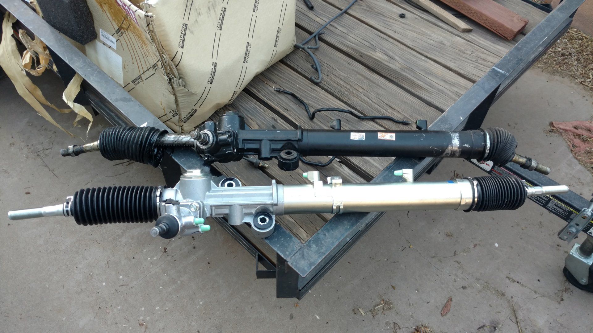

Next was the steering rack. This kicked my butt. But the forum threads on rack replacement were very helpful. I found that the unit I pulled from the truck was a POS reman'd unit. It was leaking on driver side, and the bushings we're SHOT.
Replaced with a new Toyota OEM unit, and added whiteline poly bushings. Had to hulk the hell out of them too. They were a tad too big for the holes.

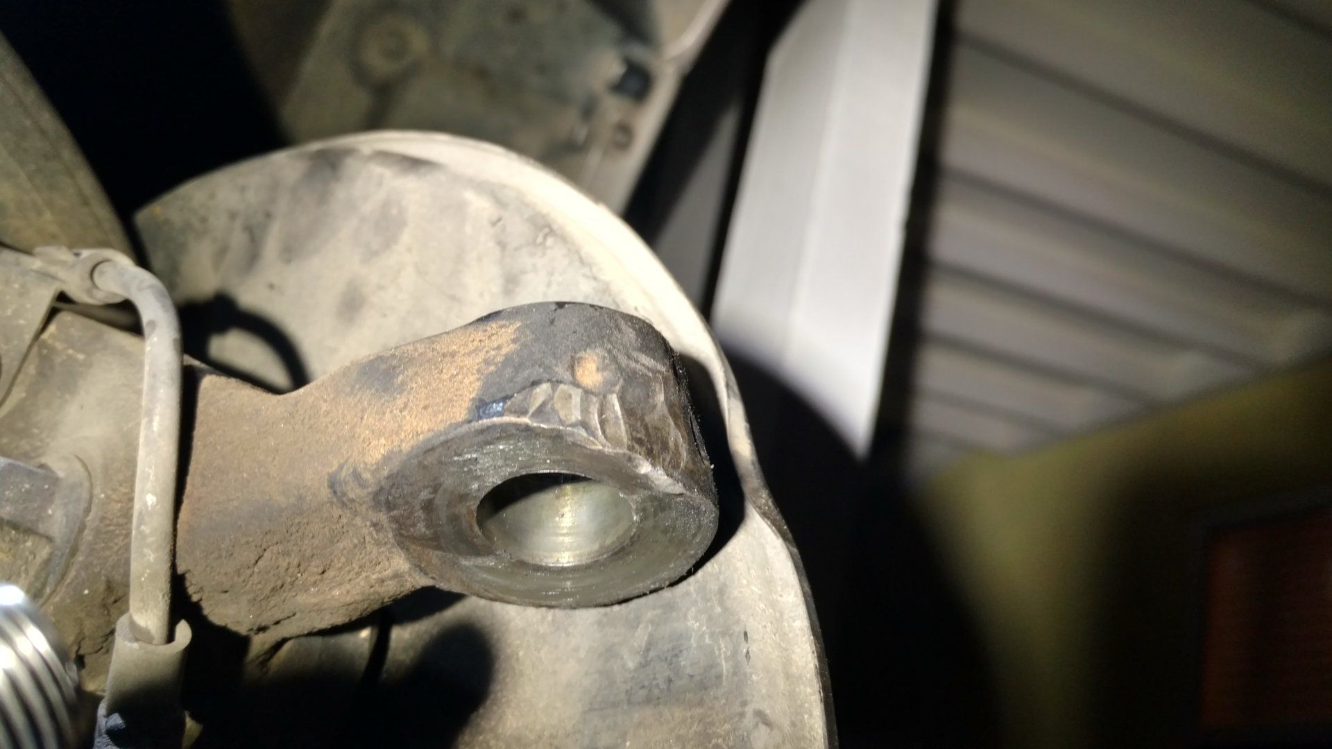

I had just replaced the pump with OEM unit, so my steering is all new. Only thing to replace is a steering arm the the PO must've gotten mad at...

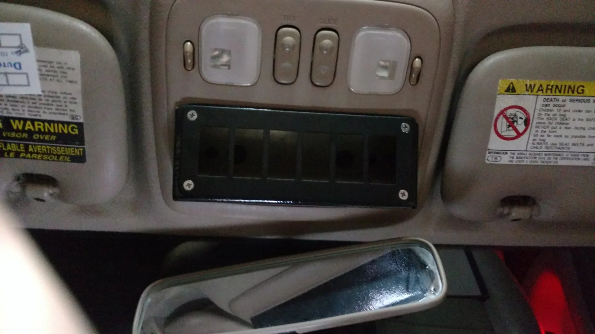

Next, wiring the switches and relays in preparation for a Dissent roof rack.
I fab'd a simple aluminum bracket for the center ceiling console. Not very much room up there, so it's angled for the rocker switches.
Well, all the old inserts were loose, and I unintentionally pulled one out with a pair of pliers. Then I pulled the rest... Here's what I found.View attachment 1470491
Toyota Fail.

how did you pull them out? My screws are spinning and I'd like to reinstall my wing.
Large wire cutters. You can get the cutting edge under the riv-net lip, and pry. Mine were so poorly "installed", I removed a couple with needle nose pliers
The finished switch panel
*Edit
Follow up. The LED's in these switches are unbelievably bright. Even hooked into the dash light dimmer circuit. I'll have to put a resistor or two in line.
