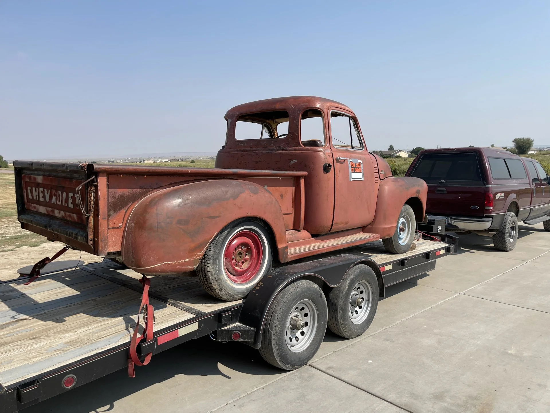

Funny you mention that. That’s my next project after Bluebonnet. I’m putting the frame from that S10 under a 5 window Chevy 3100. Truck will have a 5.3 and be slammed on bags.

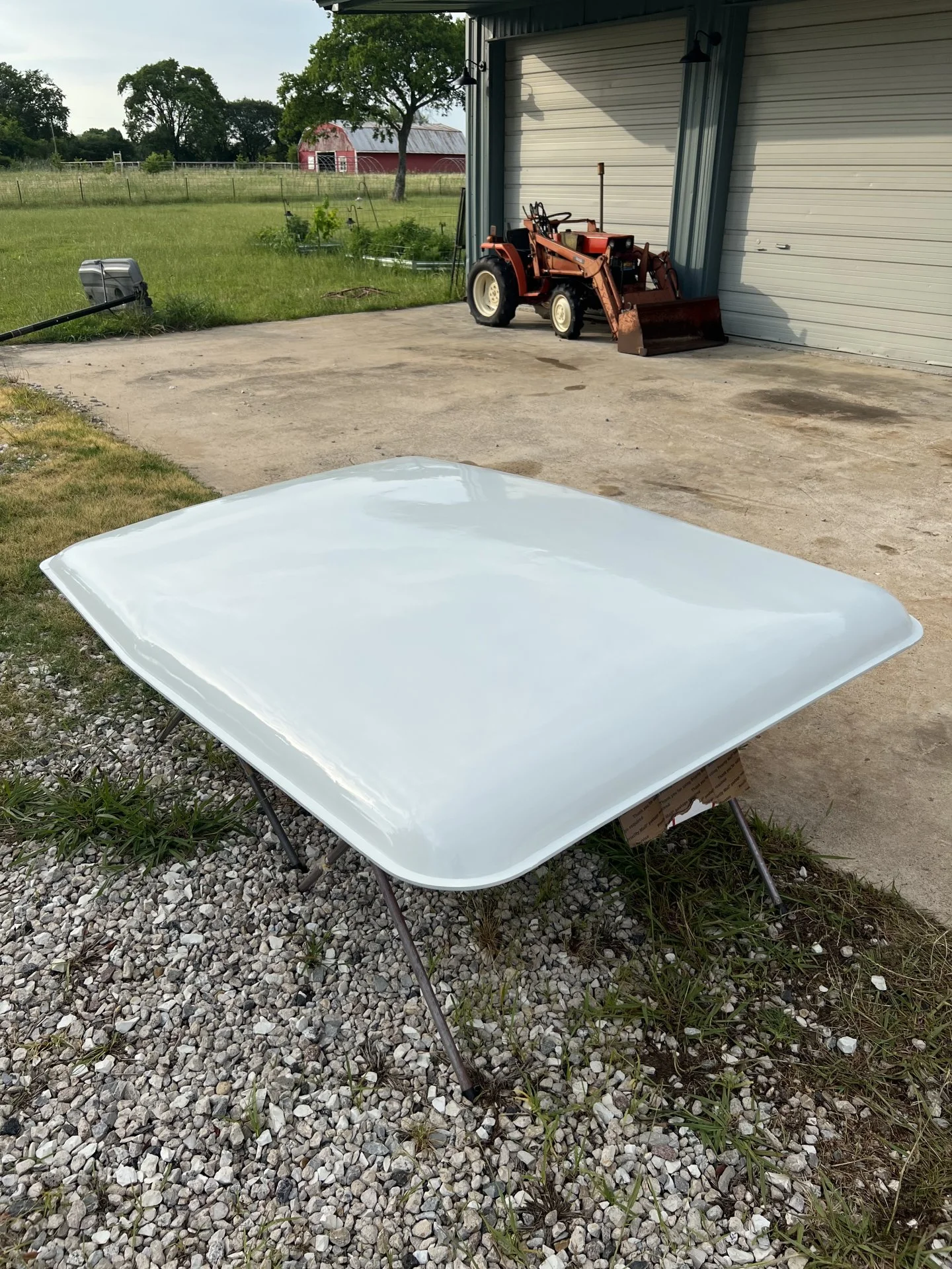

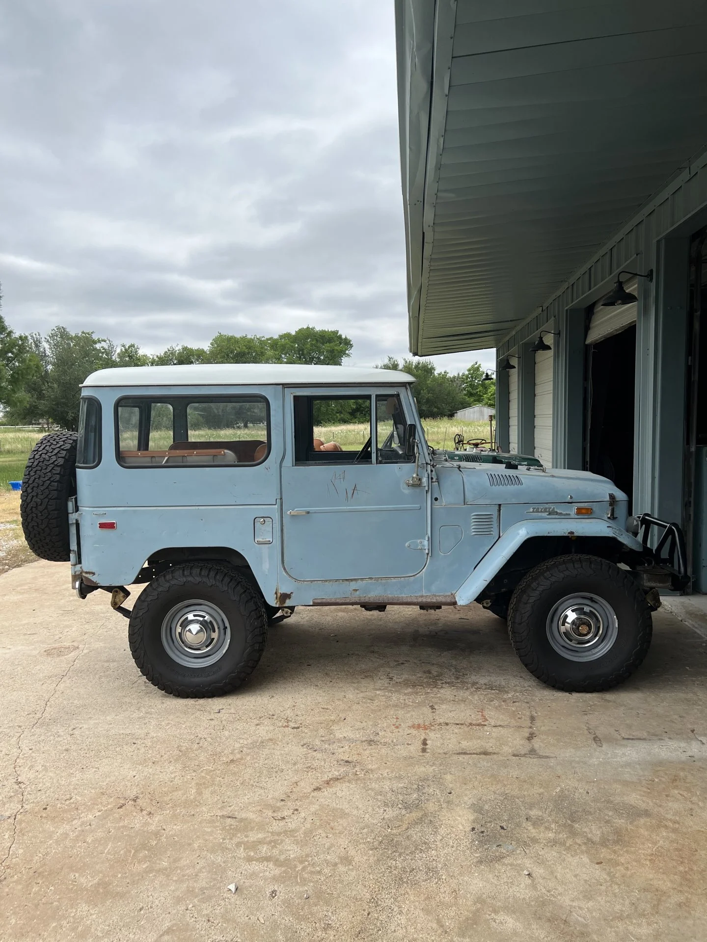

Paint and clear went down today, top is done.

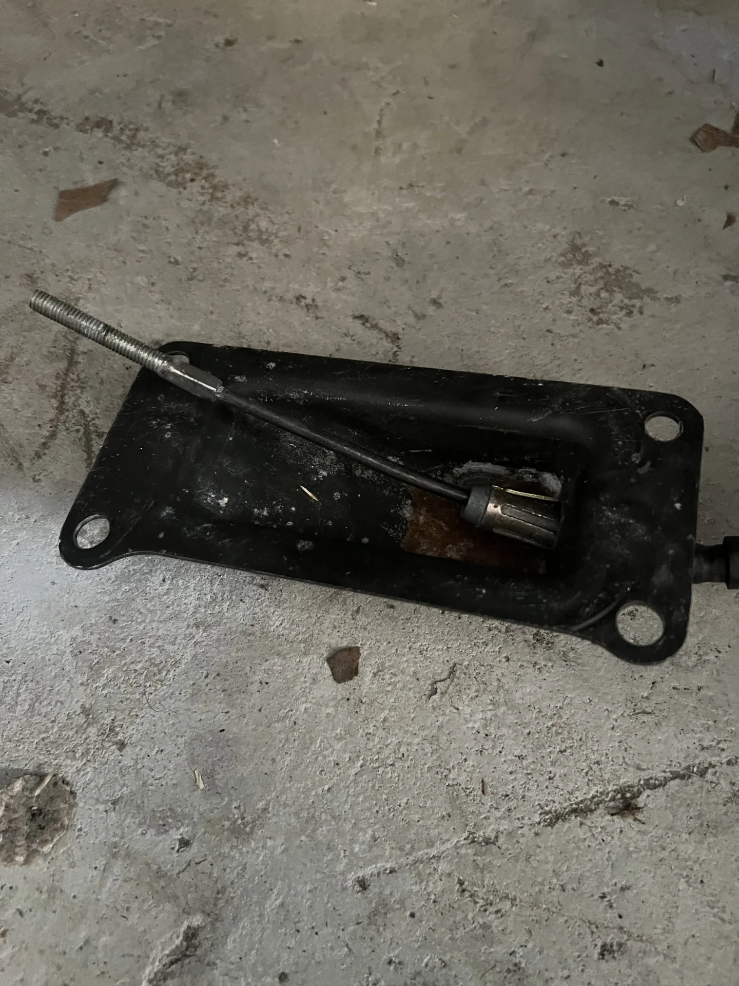

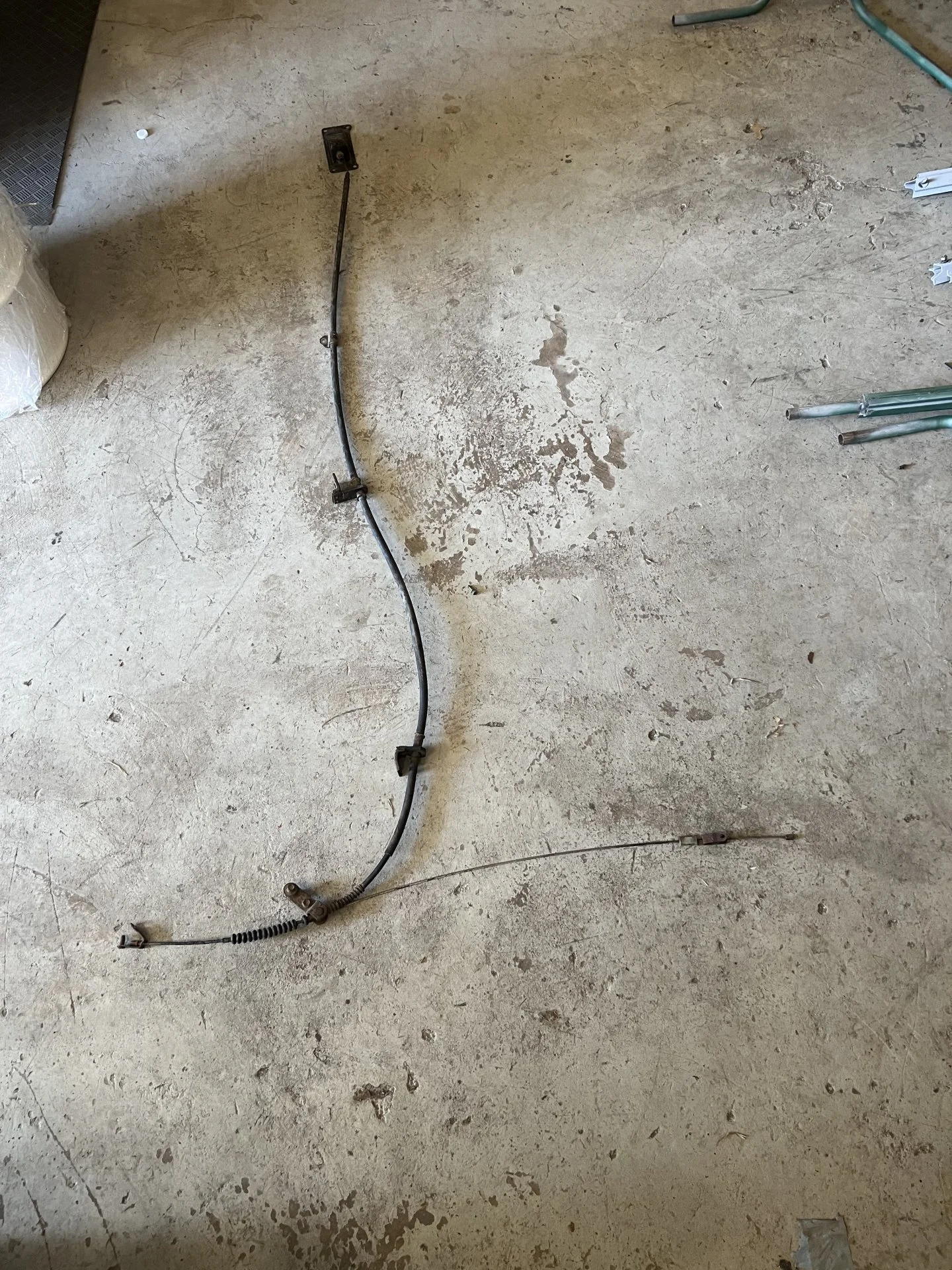

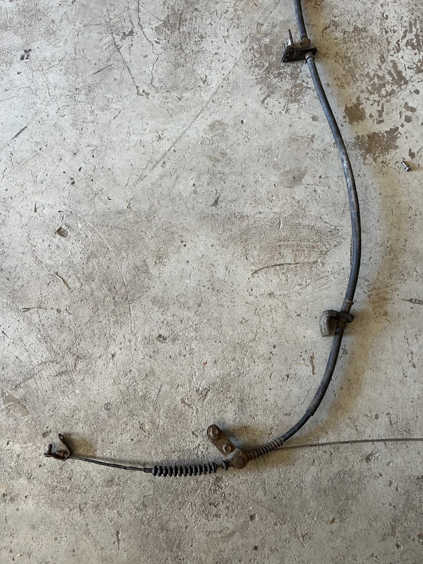

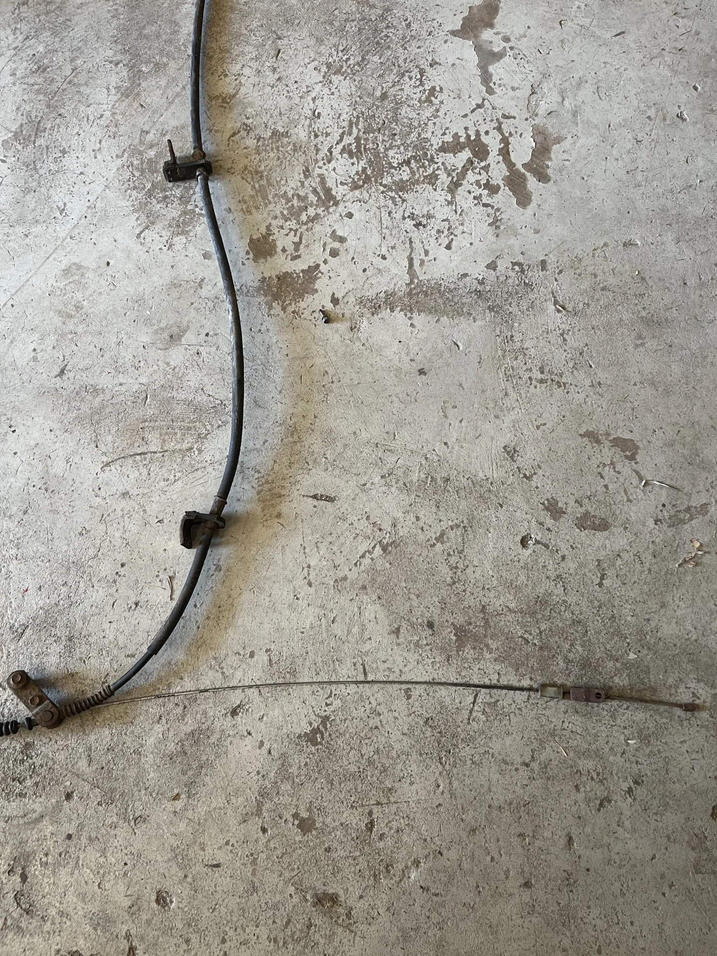

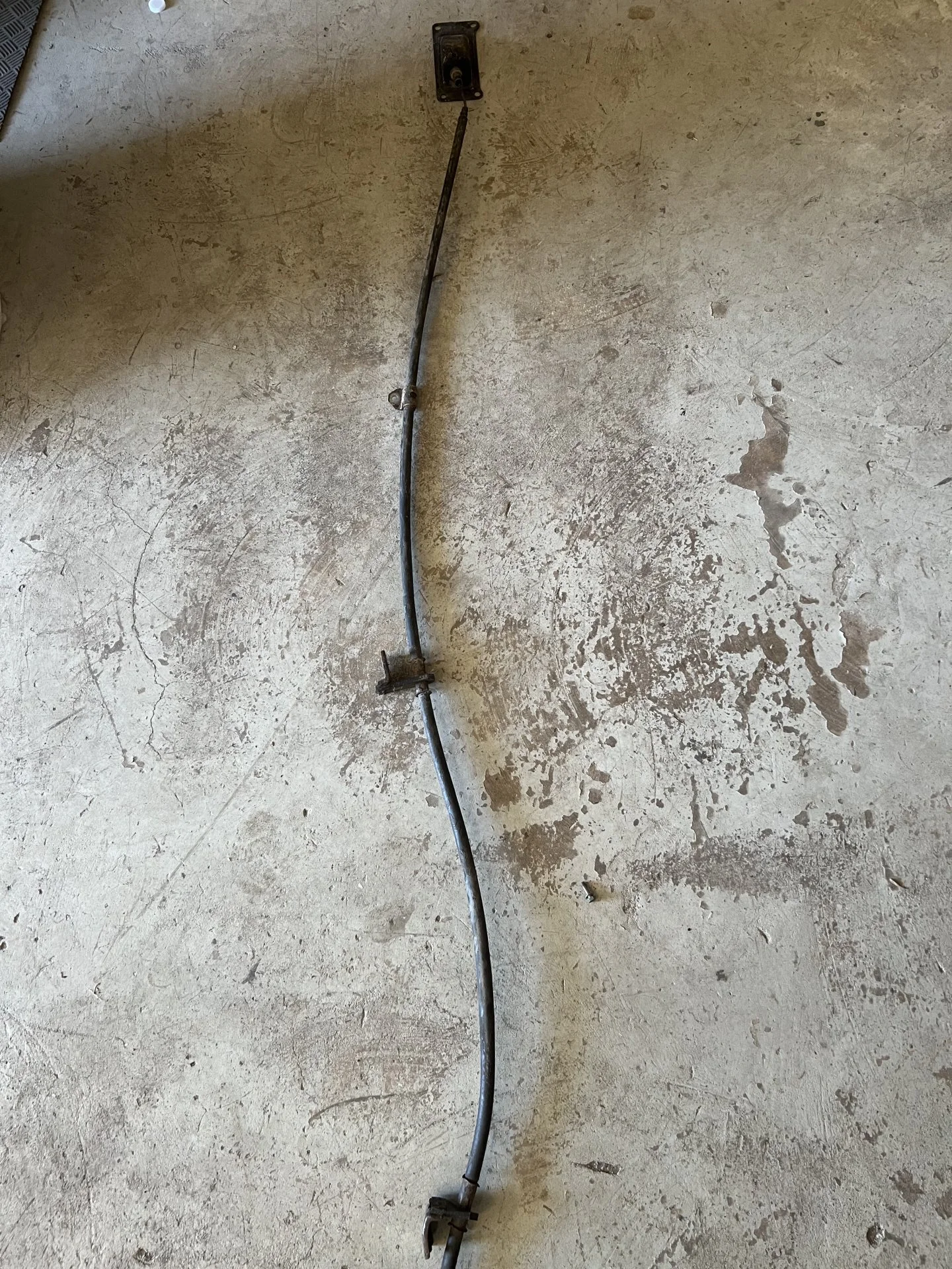

Also looked into my rear parking brake cable situation. Taking this truck to SAS in August and want to have a functional PB. The cable I had was from a troopy and was 75” from equalizer to the PB handle. Going to try a SWB 70 series cable and PB handle that should be about 20” shorter from equalizer to end of cable.
View attachment 3011395View attachment 3011396View attachment 3011397View attachment 3011398View attachment 3011399
Looks great! I will try to get you that cable measurement tomorrow!
Awesome! That will be the coolest truck on campus. You did a lot of hard work in a short period of time.

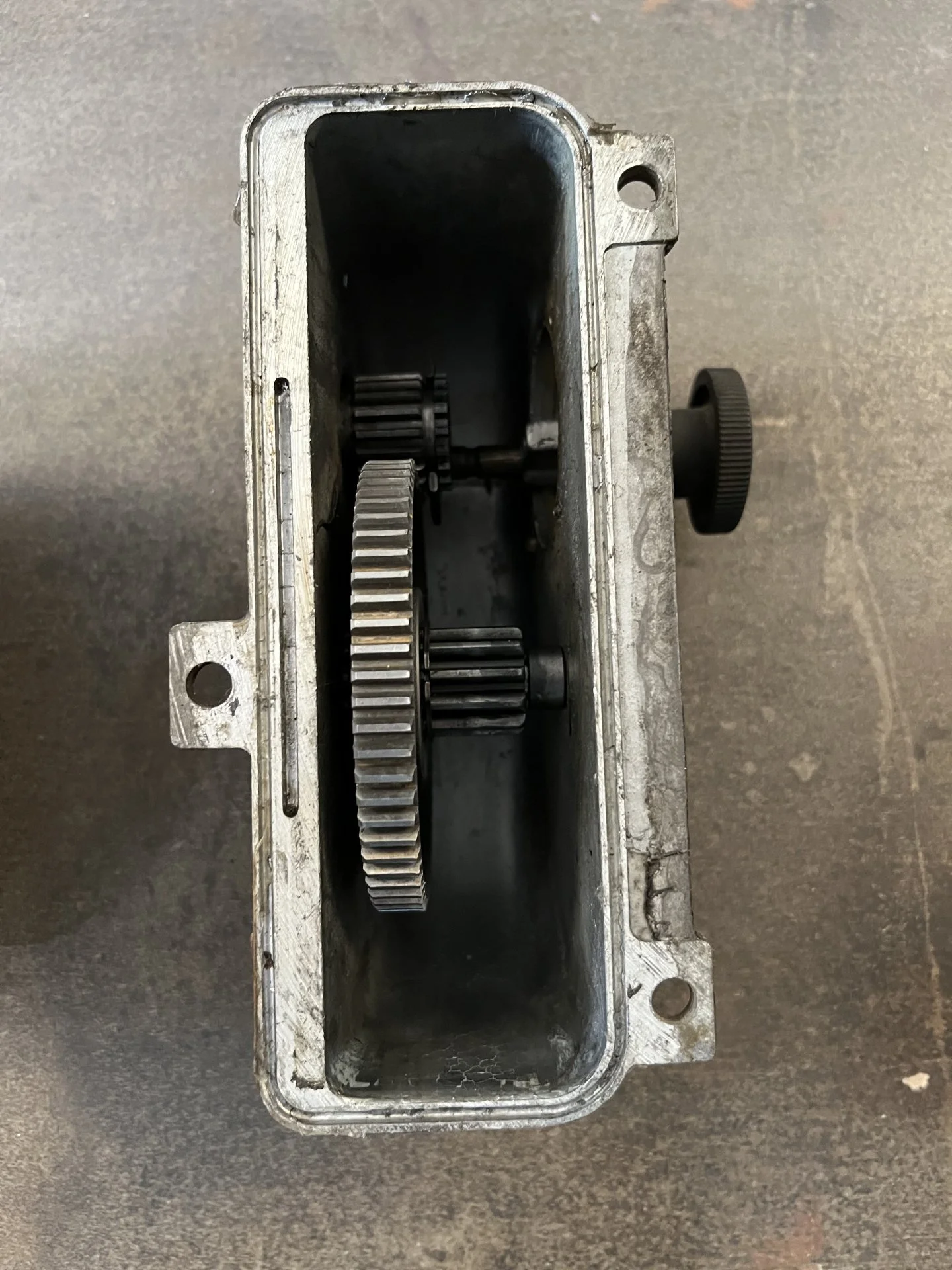

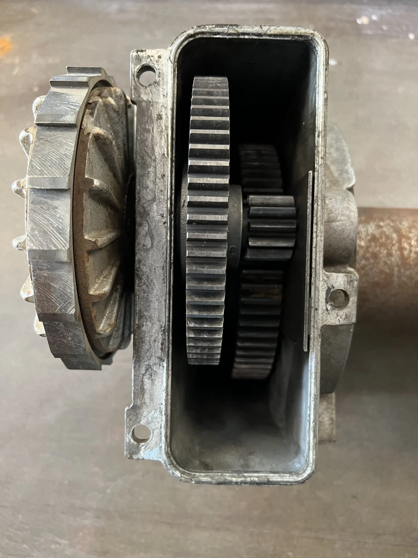

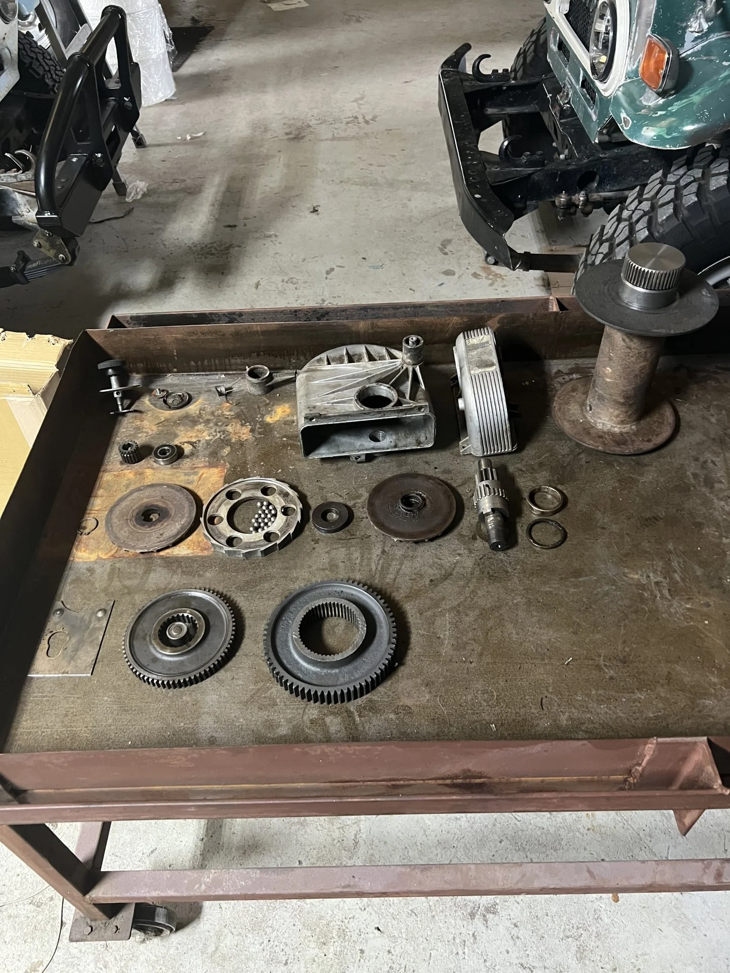

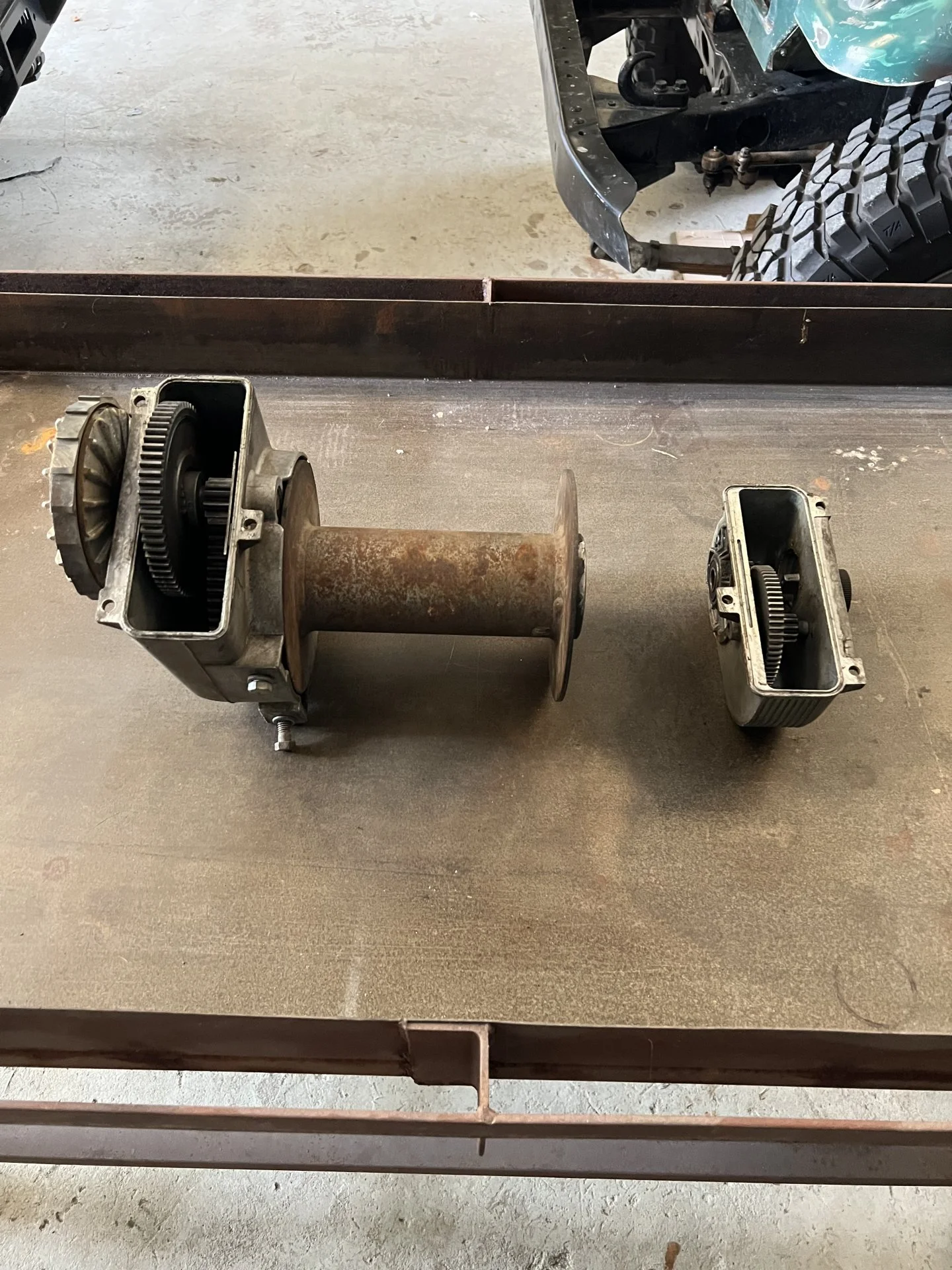

Always wanted an 8274 on this truck, they just look right on 40 series cruisers. Picked up this bare bones 8274 to build how I wanted. It’s getting a warn contactor, 9.5xp motor, and some other goodies.
Disassembled today. These old rolling butcher tables are great for disassembly. Keeps everything neat and organized.
