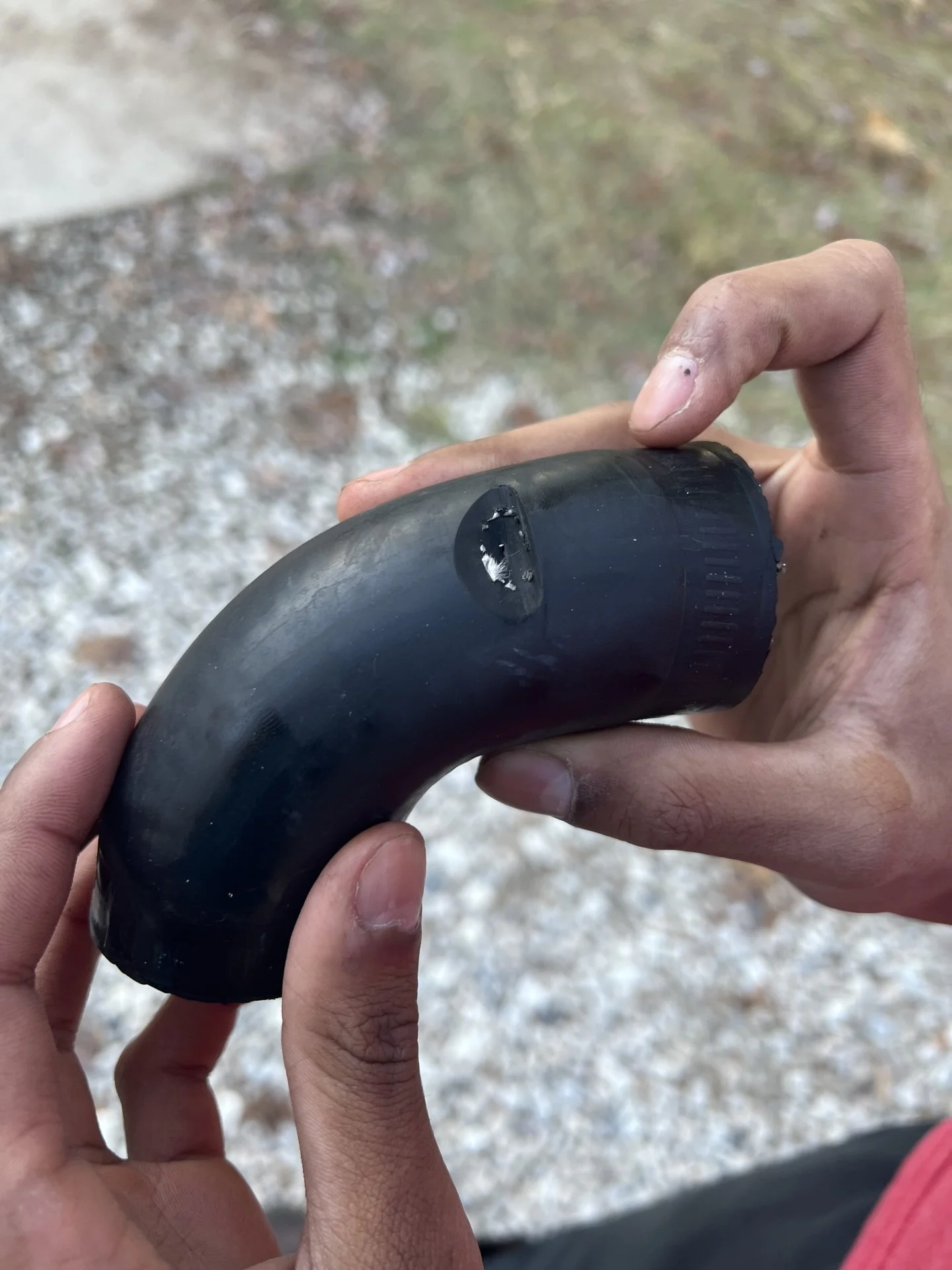

Will do although the limiter vid will be on standby. Pulled into the driveway otw back from the exhaust shop and looks like the new Champion rad is seeping :(. Will dig into it tomorrow and see what I find.
Pulled the rad and got it tested, no leaks. Found the culprit when I went to assemble the lower rad hose. Thought I had enough clearance but the fan nicked the lower rad hose when the motor was under acceleration. Shaved an inch off my fan blades and she’s good to go, no more leaks. Also running temps still remain steady at around 190.

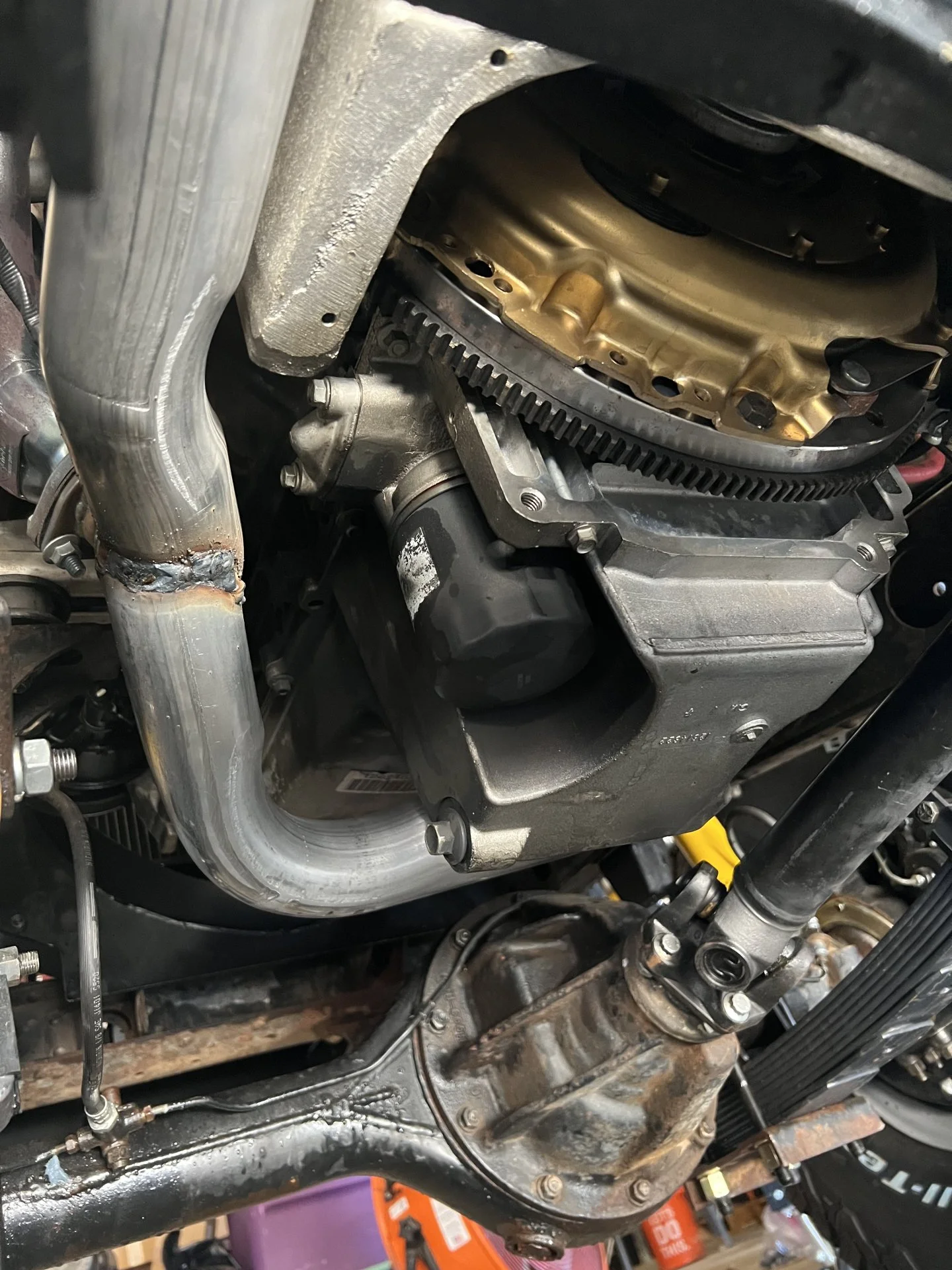

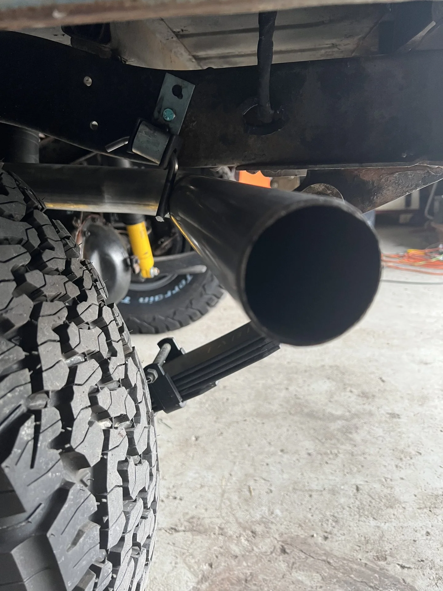

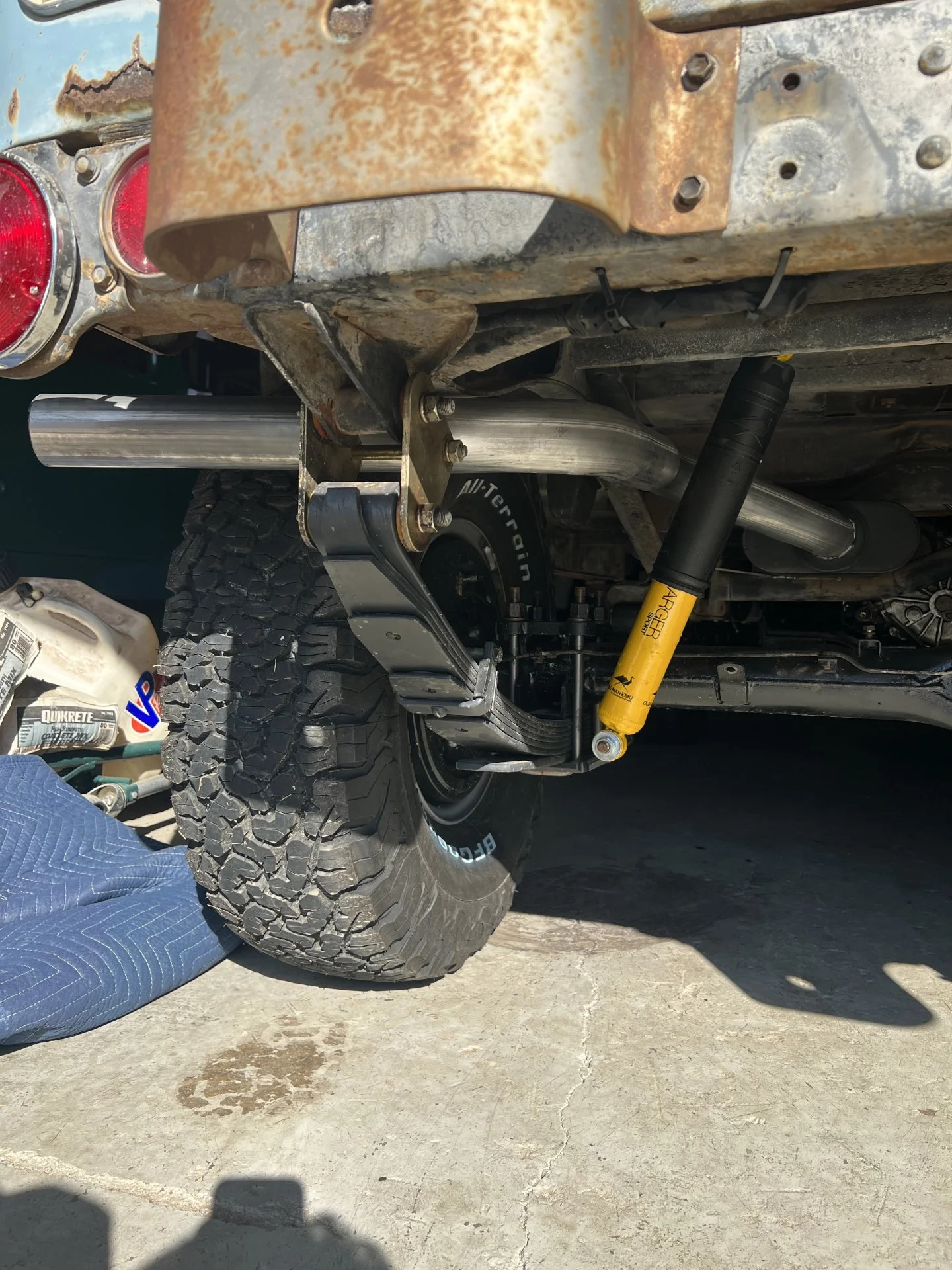

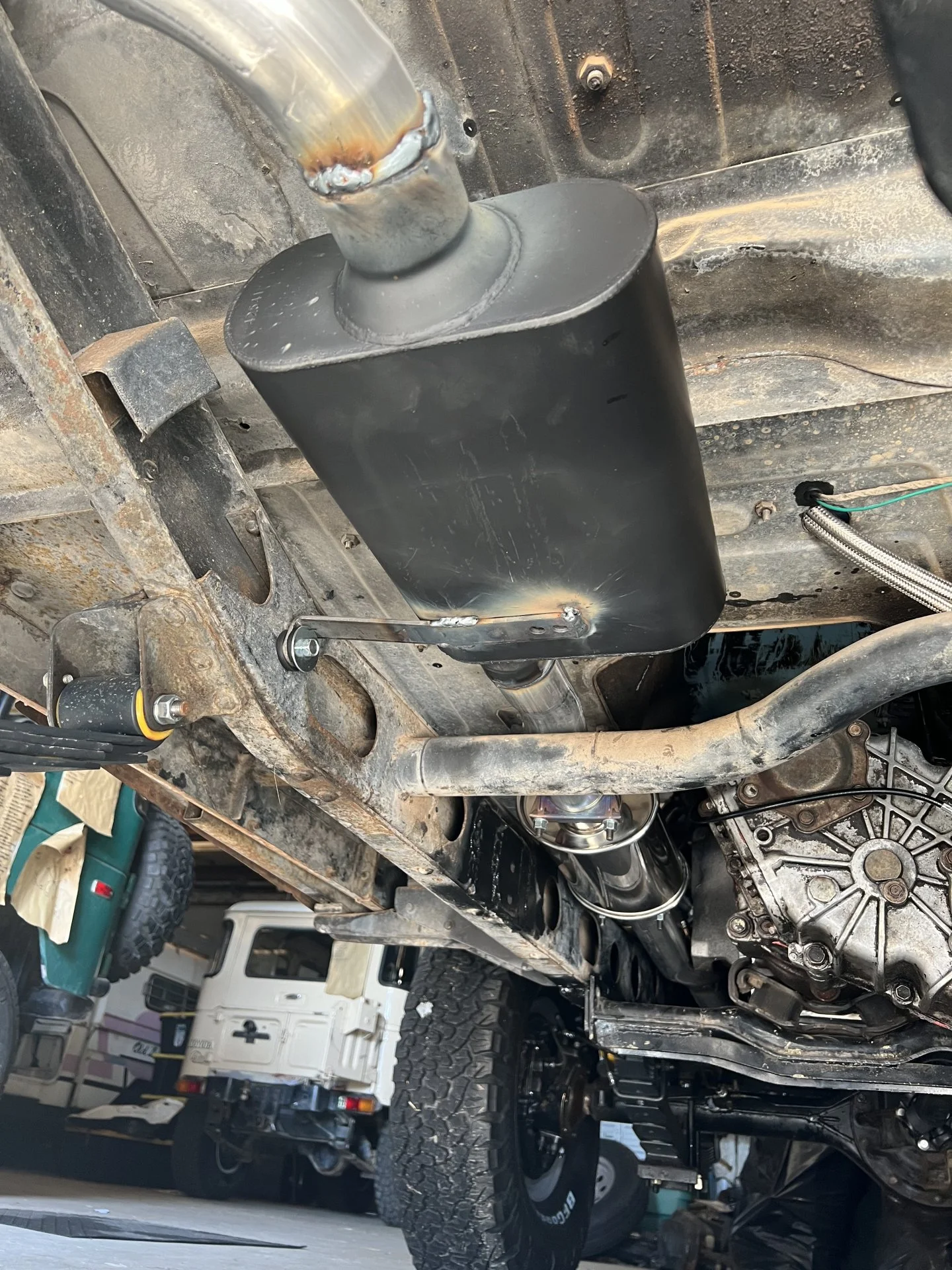

Running a vibrant performance resonator and flow master muffler. O2 sensor is threaded in where the down pipes merge together. Nice and quiet but still has a good low rumble. Will get some exhaust vids uploaded soon.
I would add another exhaust hanger towards the end of the tailpipe for when that one going sideways off the muffler splits :)
