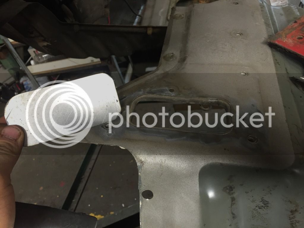

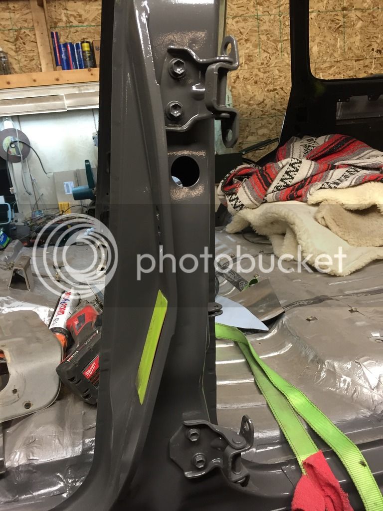

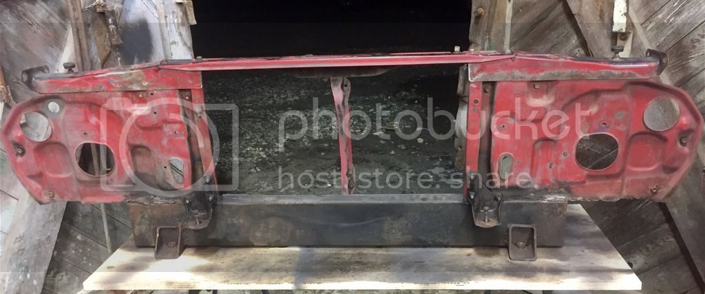

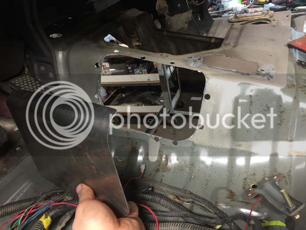

I need someone with expertise to help "fit" my firewall into the window frame as apparently it needs to be "bang on" for the window to seal properly. With the edges needing some repairs I don't think this is something I want to go solo into. So, if anyone is confident they have some skills and want to help a brother out...

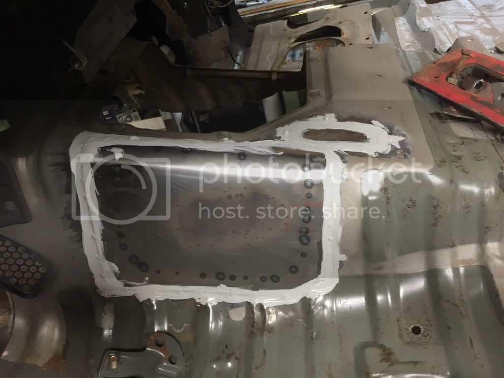

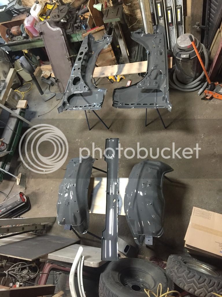

Also found a couple places to put bondo as I've been prepping the fenders for engine compartment area paint.

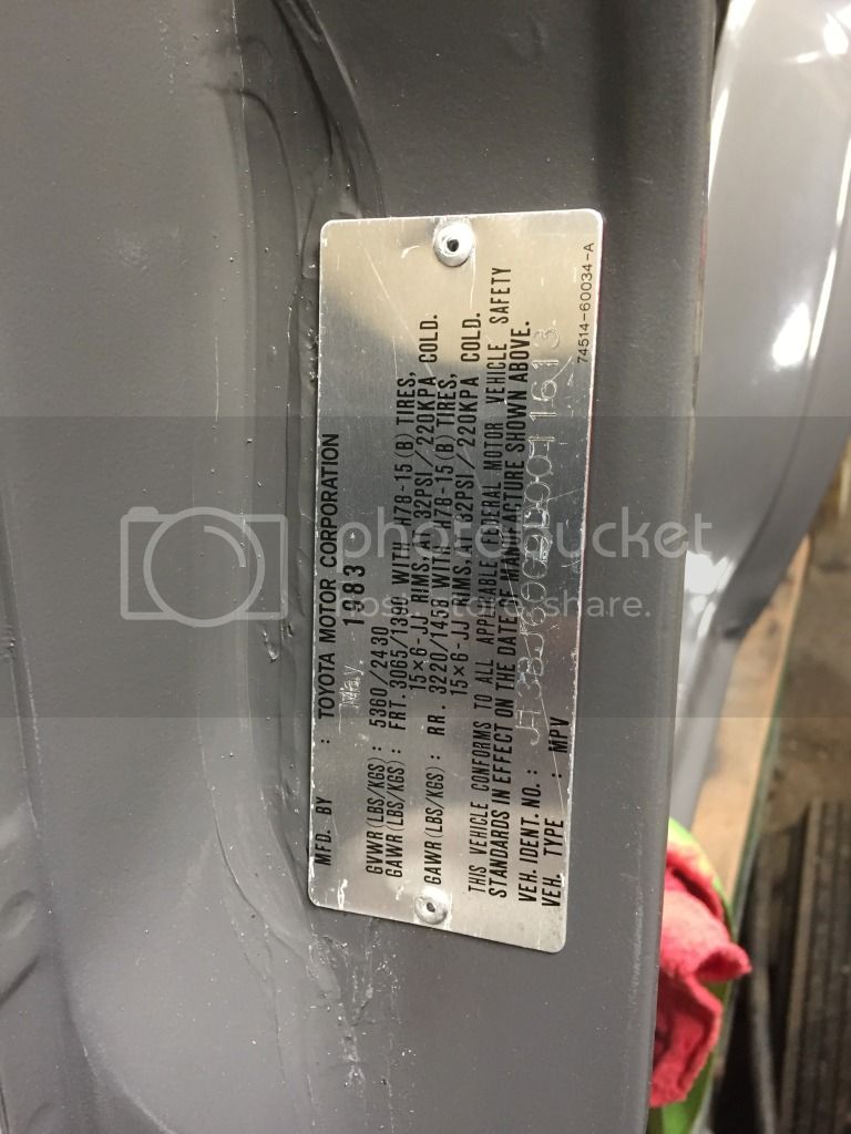

And officially turned the HJ back into the BJ it really wanted to be by putting the VIN back onto the door panel. There's probably some official way to do this, but I just riveted it over top of the previous vin that was put on when it was imported.

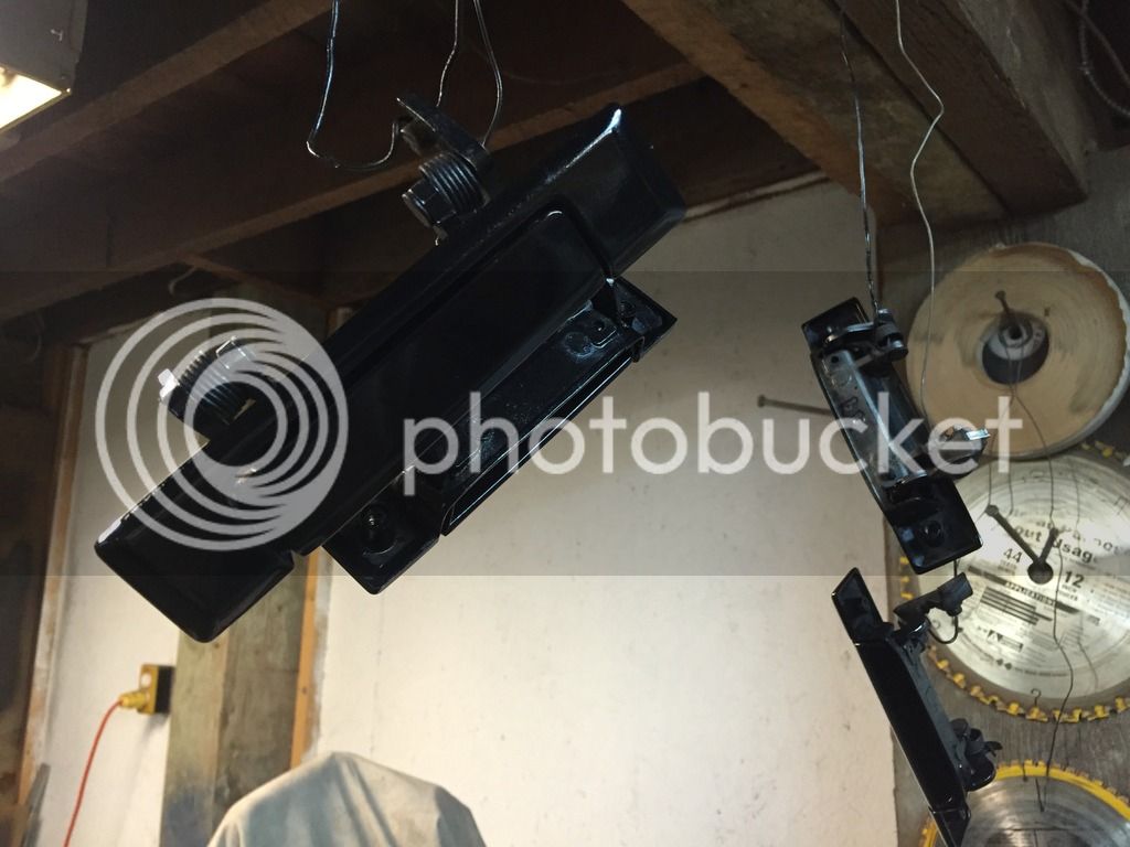

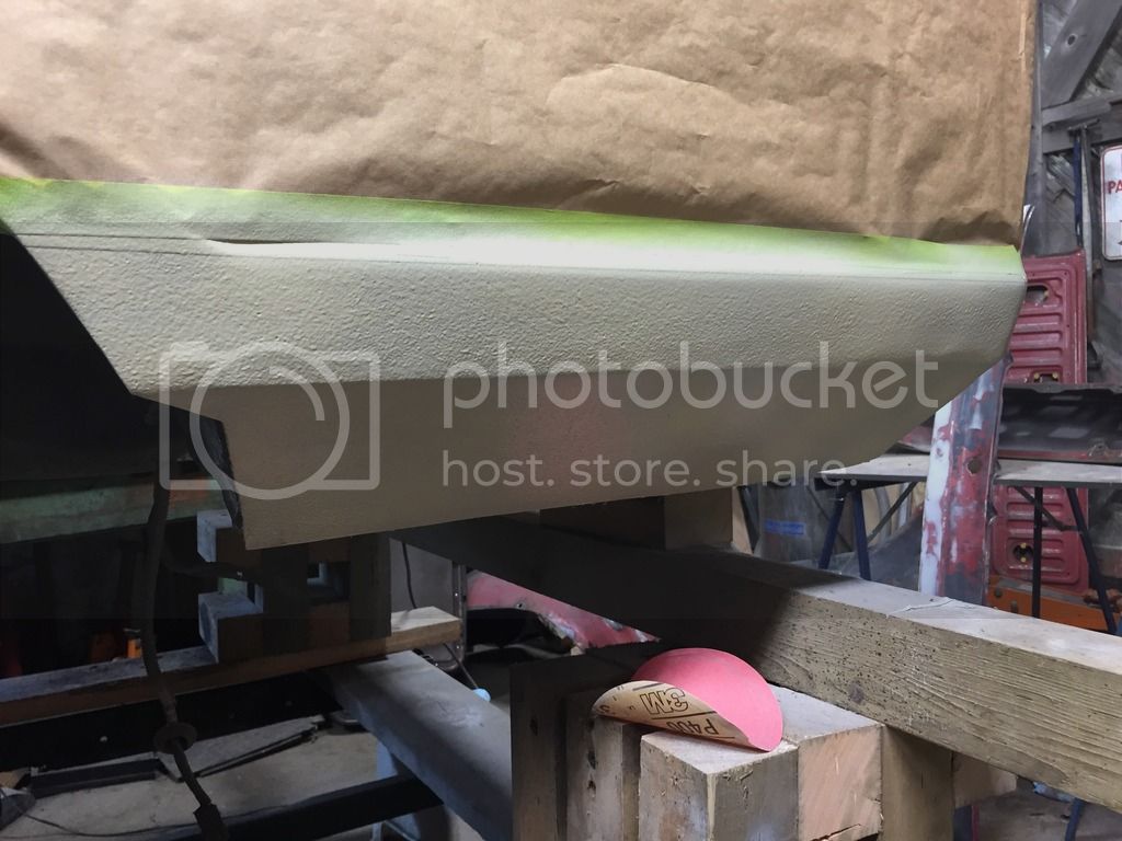

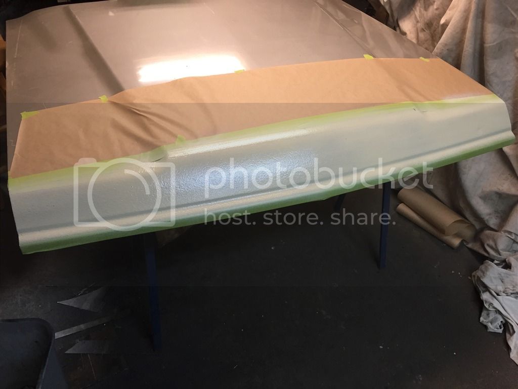

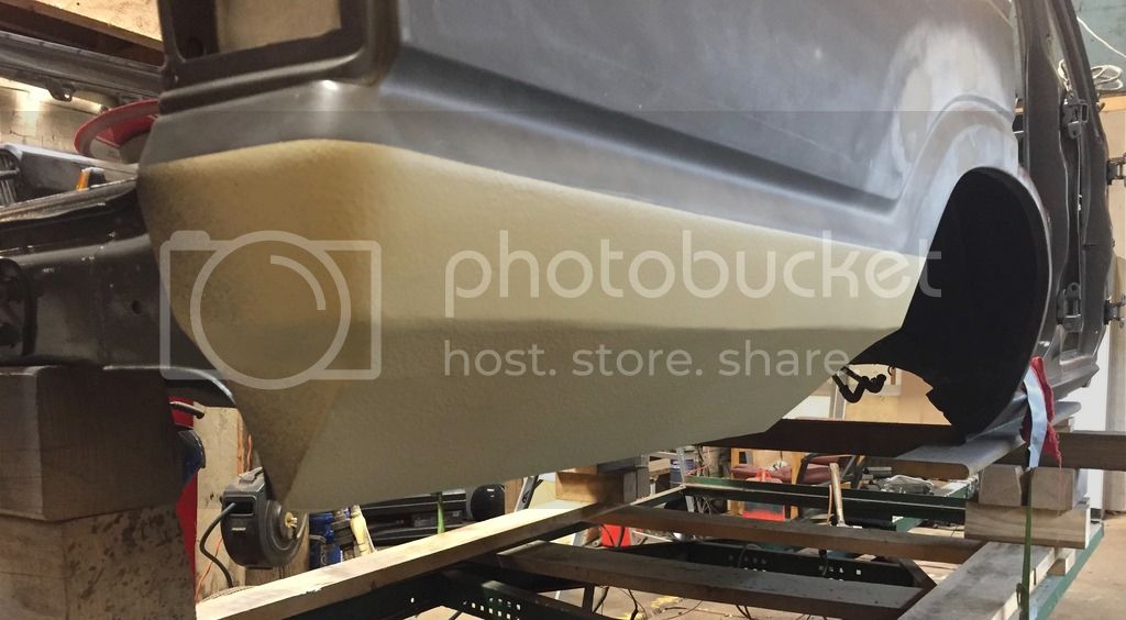

Some more body work completed, painted some more parts, and slapped some gravel guard on a couple spots. You can really see the uneven spots on the rear lower quarters from my novice body work.
Got around to:

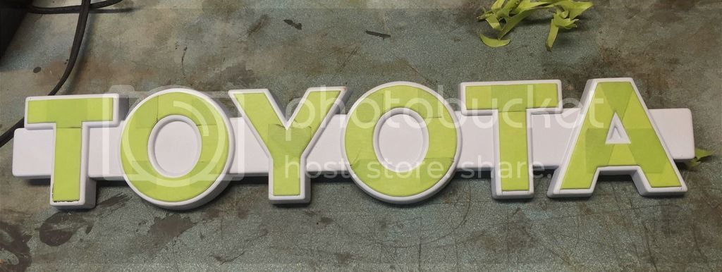

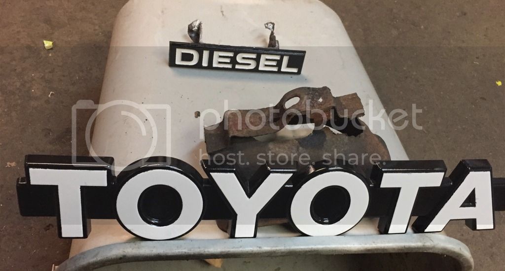

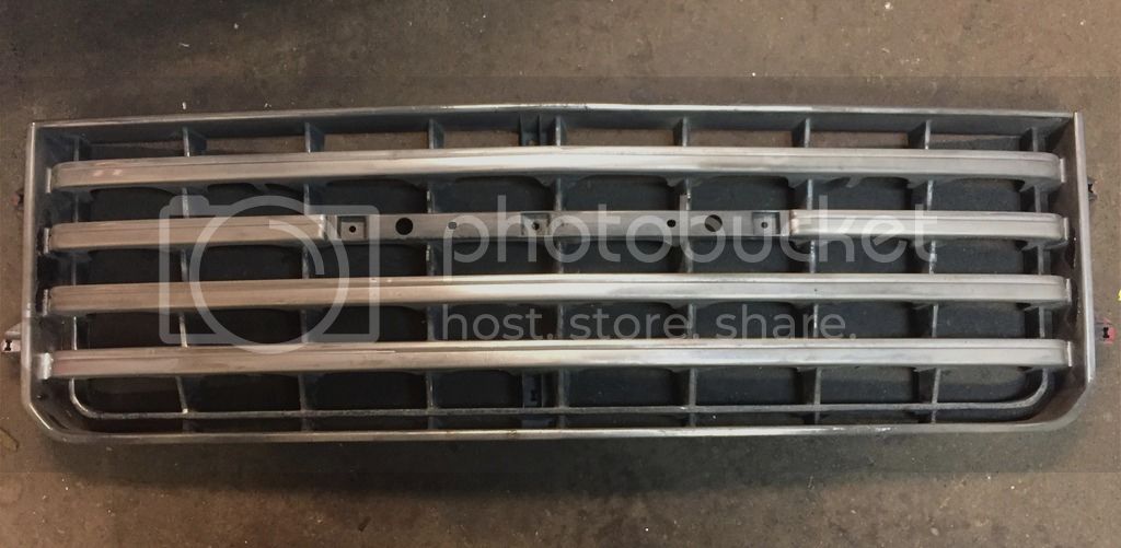

1. Grill repaint.

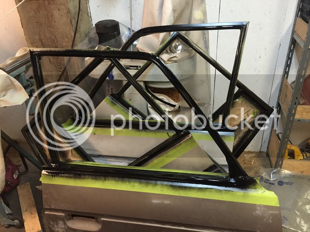

2. Door window chrome repaint.

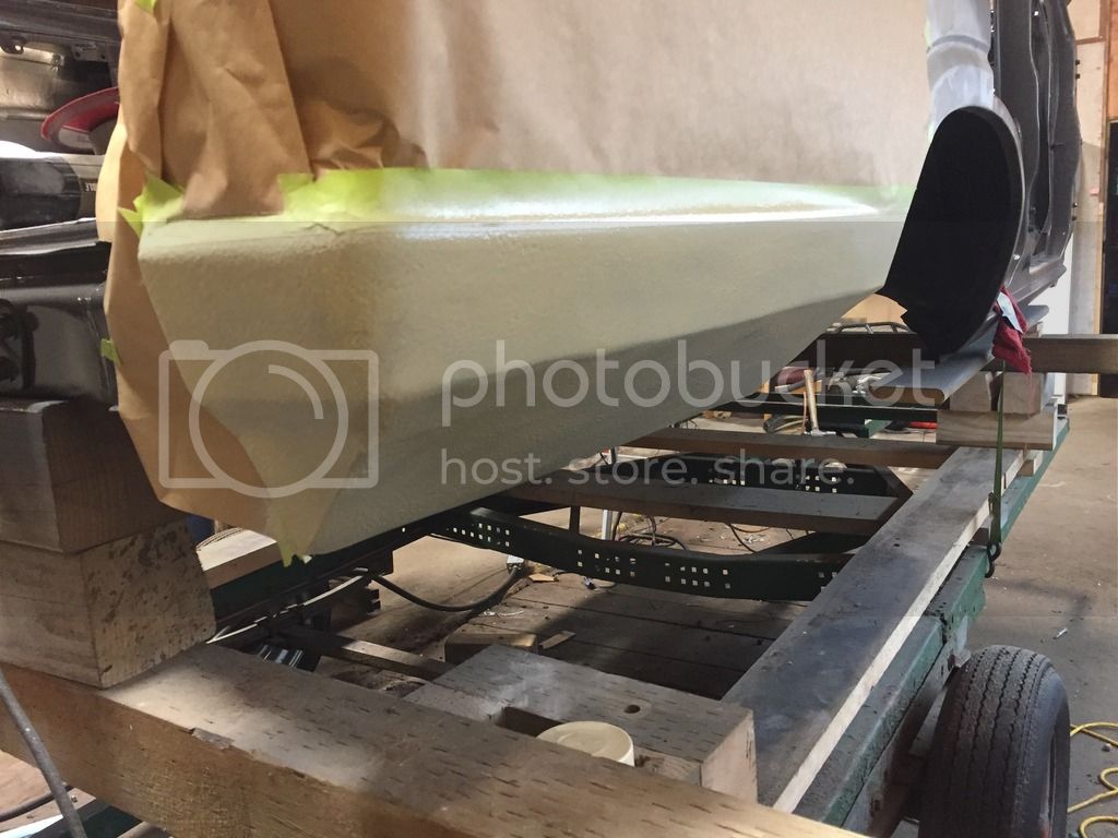

3. Finished gravel guard on rear quarters and hood.
4. Door handles repainted.
5. Hung door hinges...not need to fit doors and adjust hinges so I can seam seal them in place.

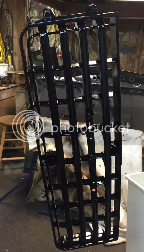

Keeping up the grind! Looking really good. I hope you have good ventilation, phew, all

Yeah, getting the cowling/firewall welded back into place is the last "major" piece which needs special attention that I'm not willing to do unless I'm certain it's going to work. Having another 60 sitting there would offer some peace of mind that's for sure.

Using the rattle can (Cloverdale custom makes these if you bring in your own paint...cost $16/can though :censor:) is really a time saver instead of setting up the HVLP gun for smaller jobs.

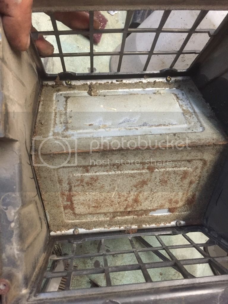

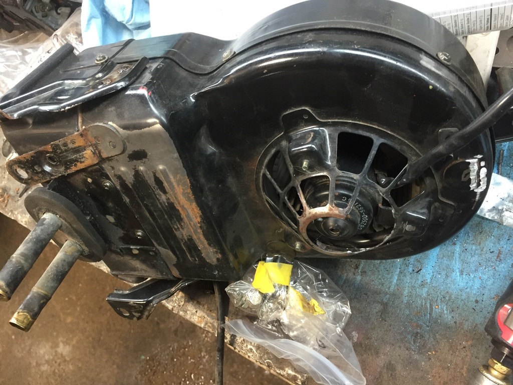

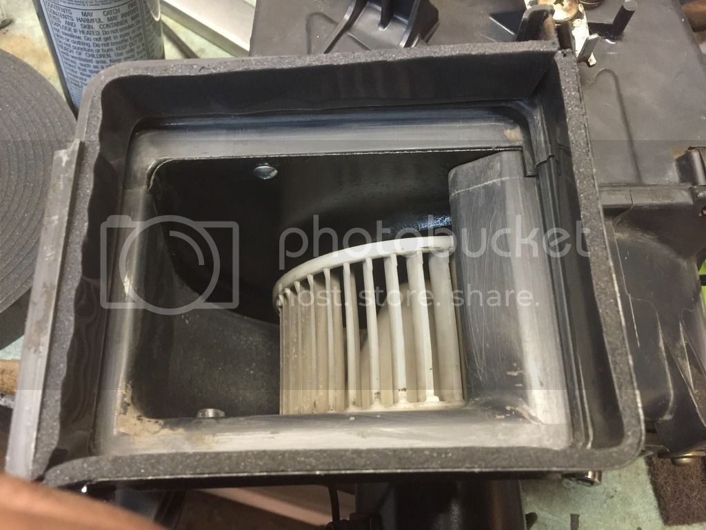

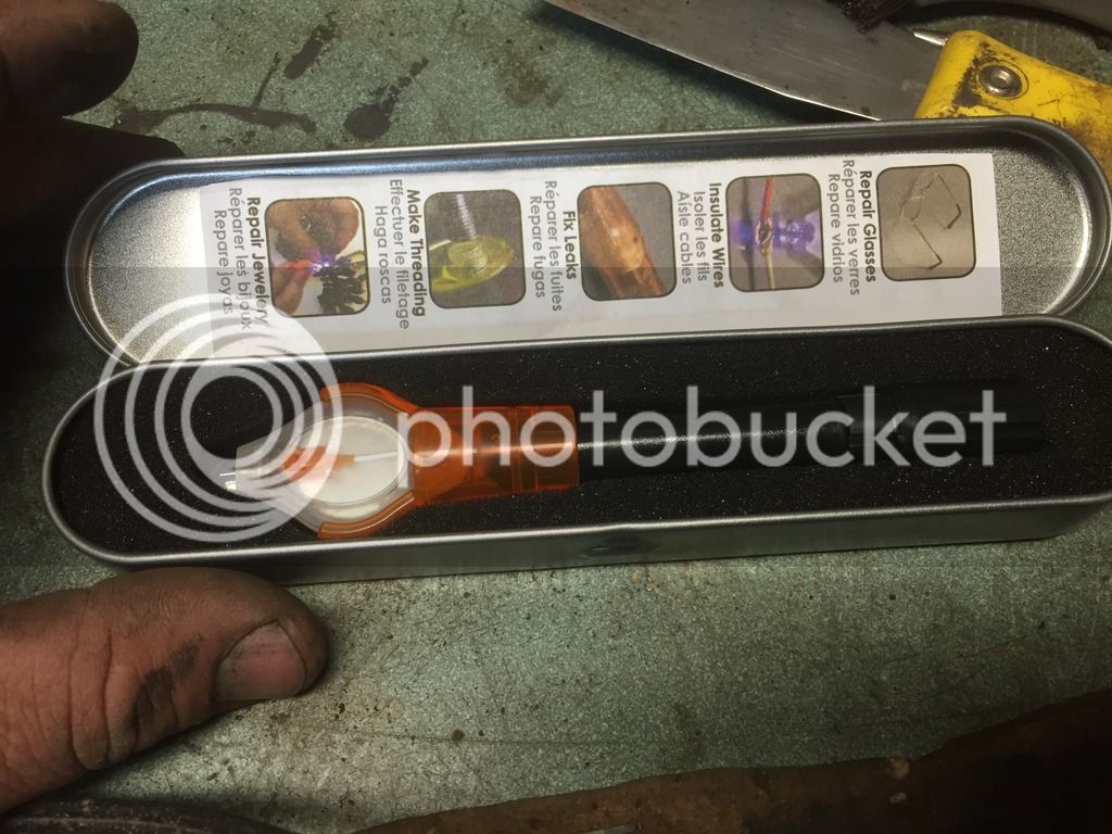

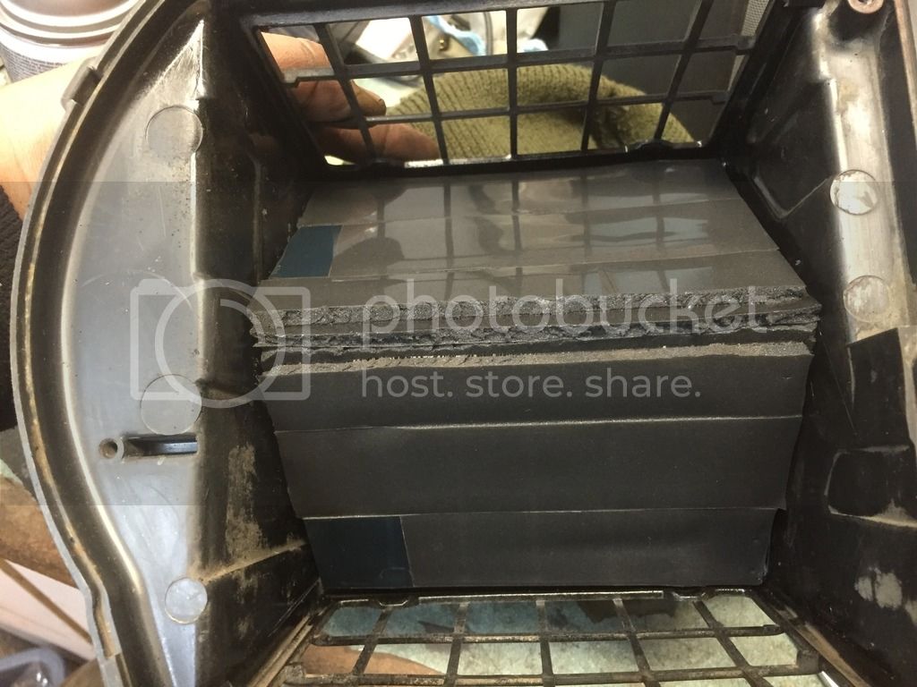

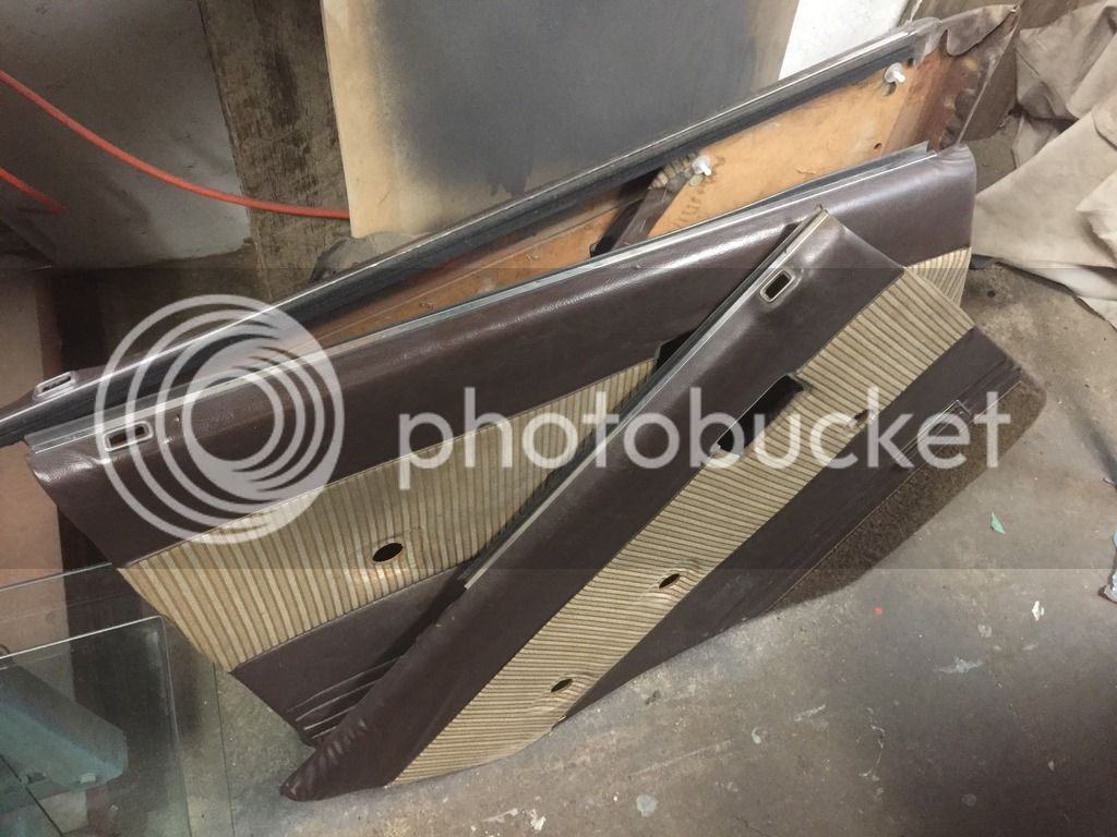

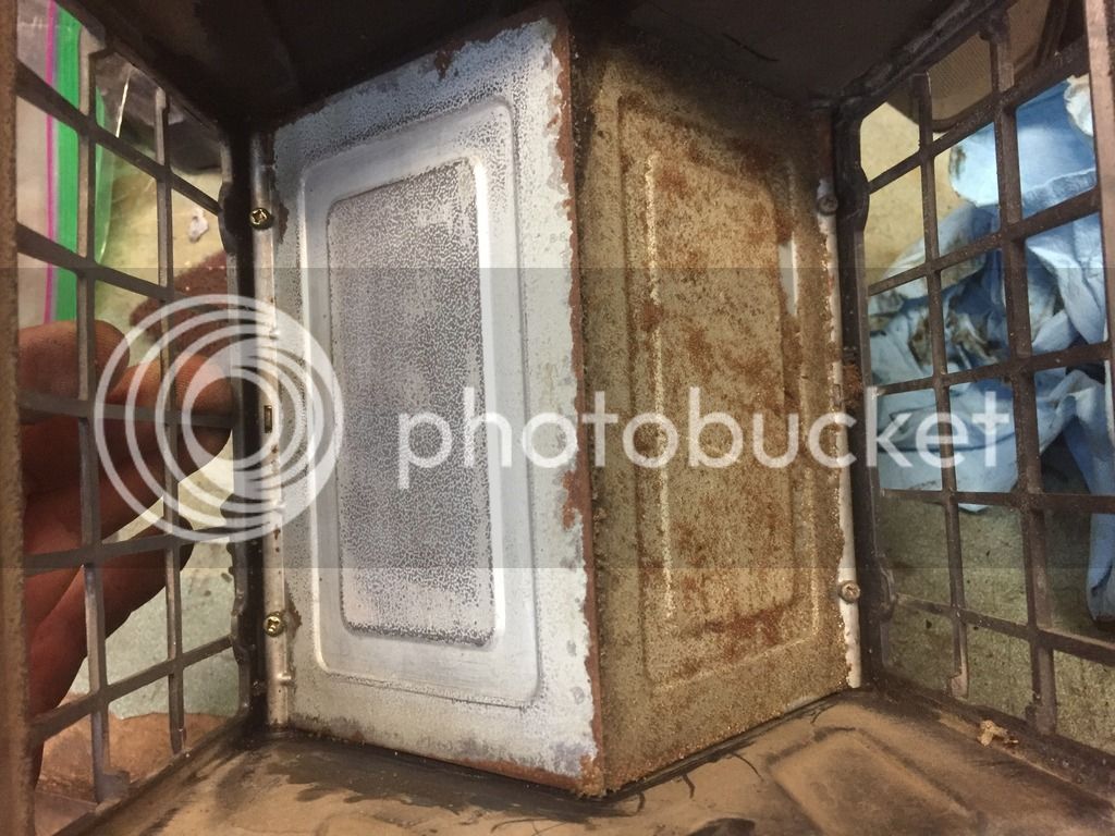

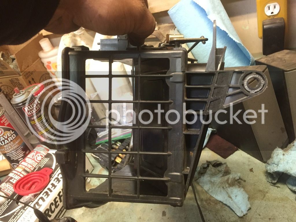

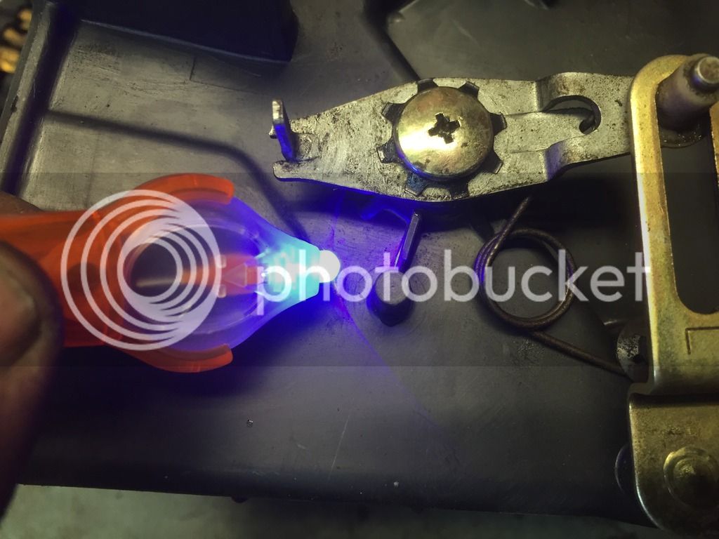

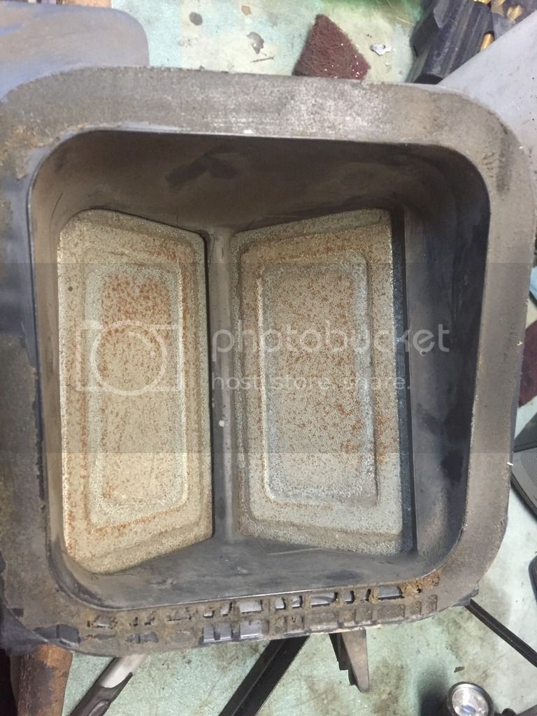

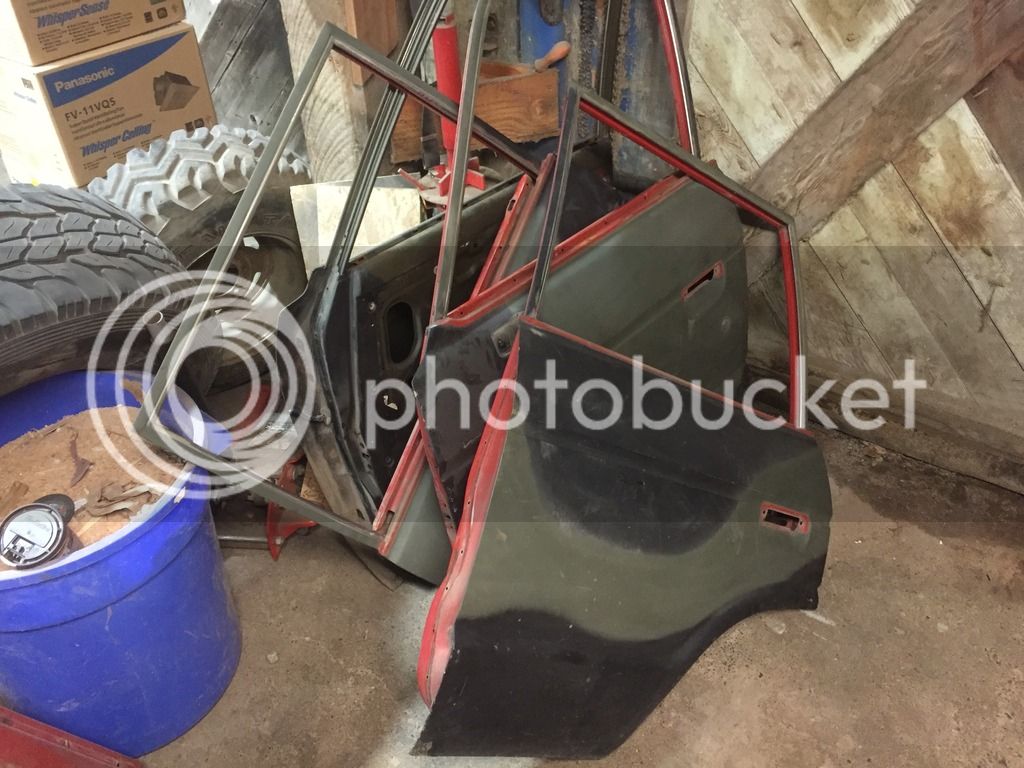

Basically removed old disintegrated foam from blower assembly, did a repair with one of those cool UV light glue pen things (actually worked impressively...I actually held the unit up by that tiny piece right afterwards and it held like concrete!), and dismantled my Camo Cruiser doors for spare parts. Legit.

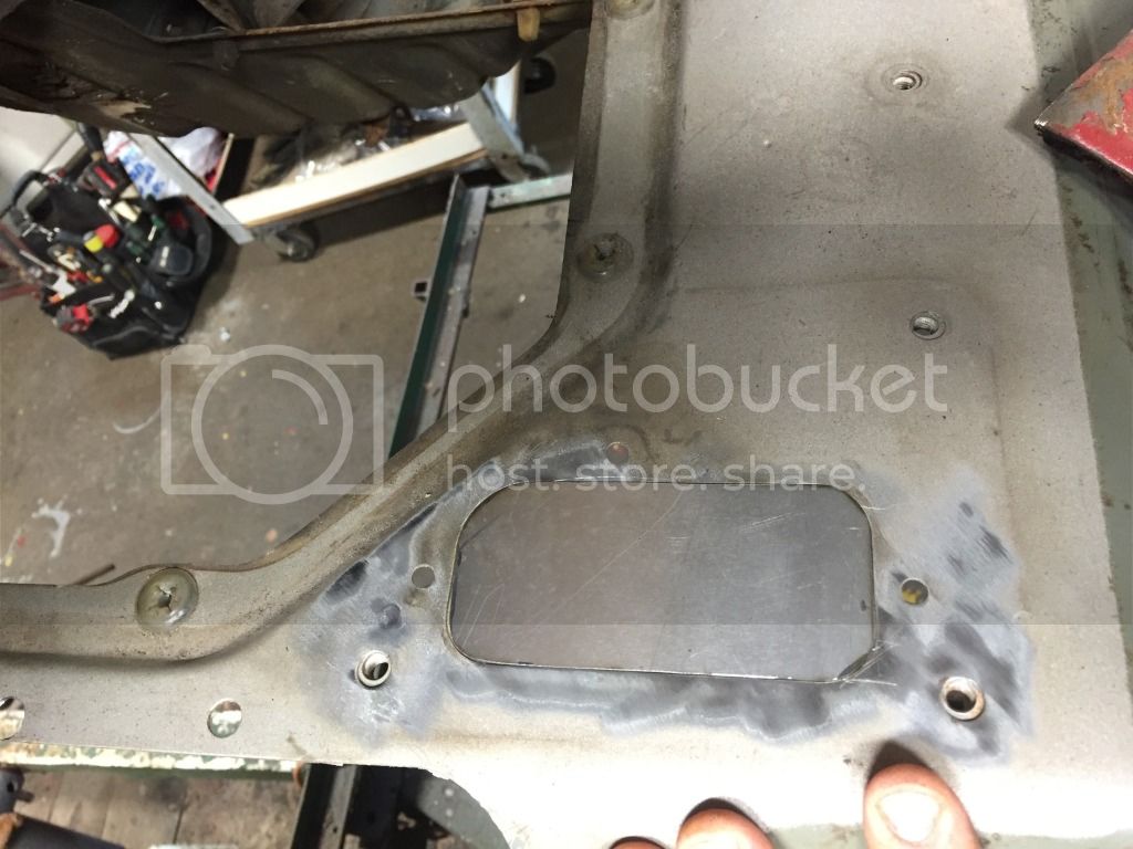

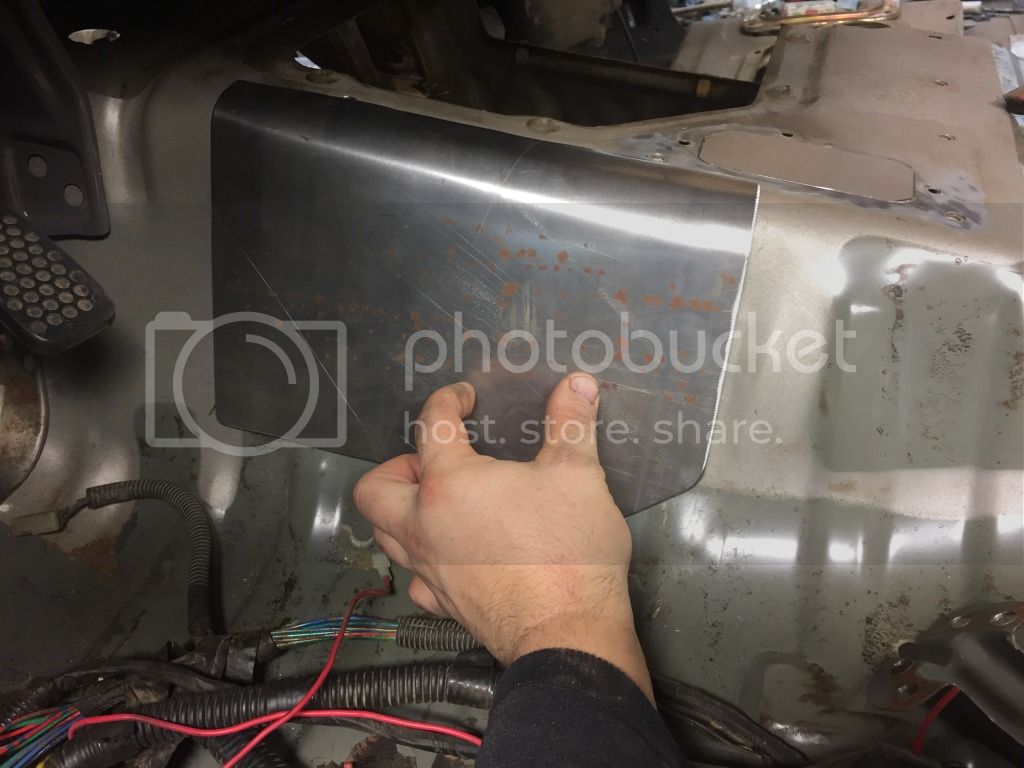

THE FIREWALL IS IN PLACE PEOPLE!!! Hopefully it's in the correct place because it aint coming out again! I ended up measuring the OEM window with the seal in place and got it to within a 1/16" so it better work. If not, I'll just have to trim the window rail, baby ;-) I left the top 6" because it needs to be brazed so I'll do any tidy up on welds after that's done.

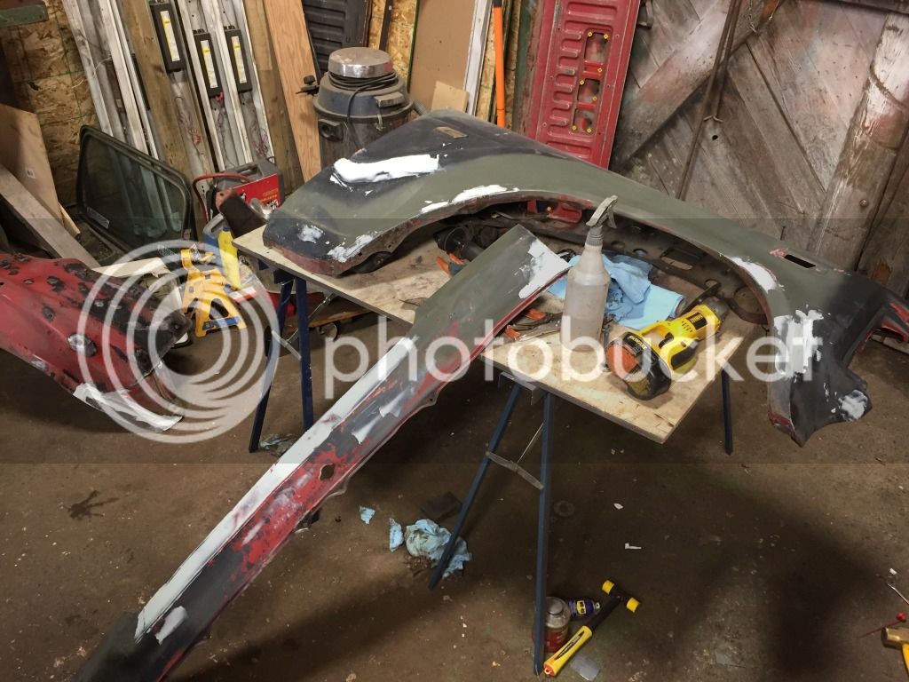

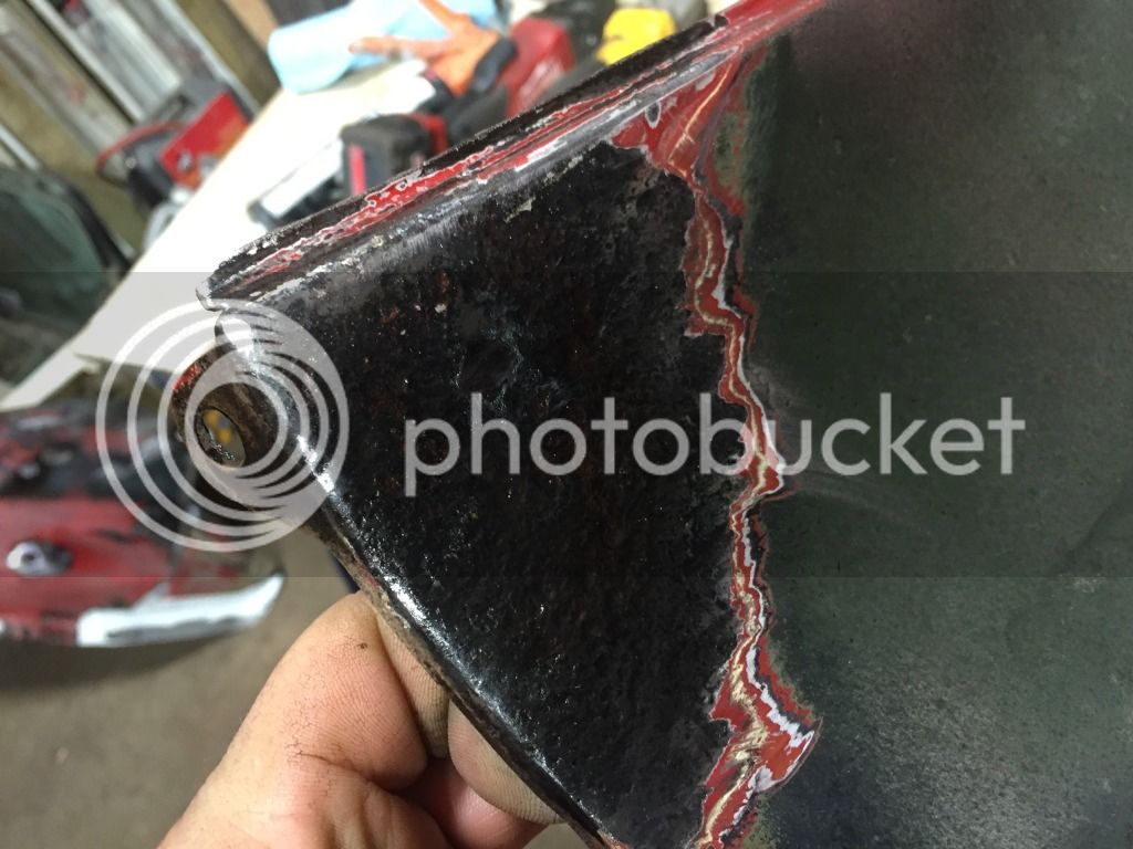

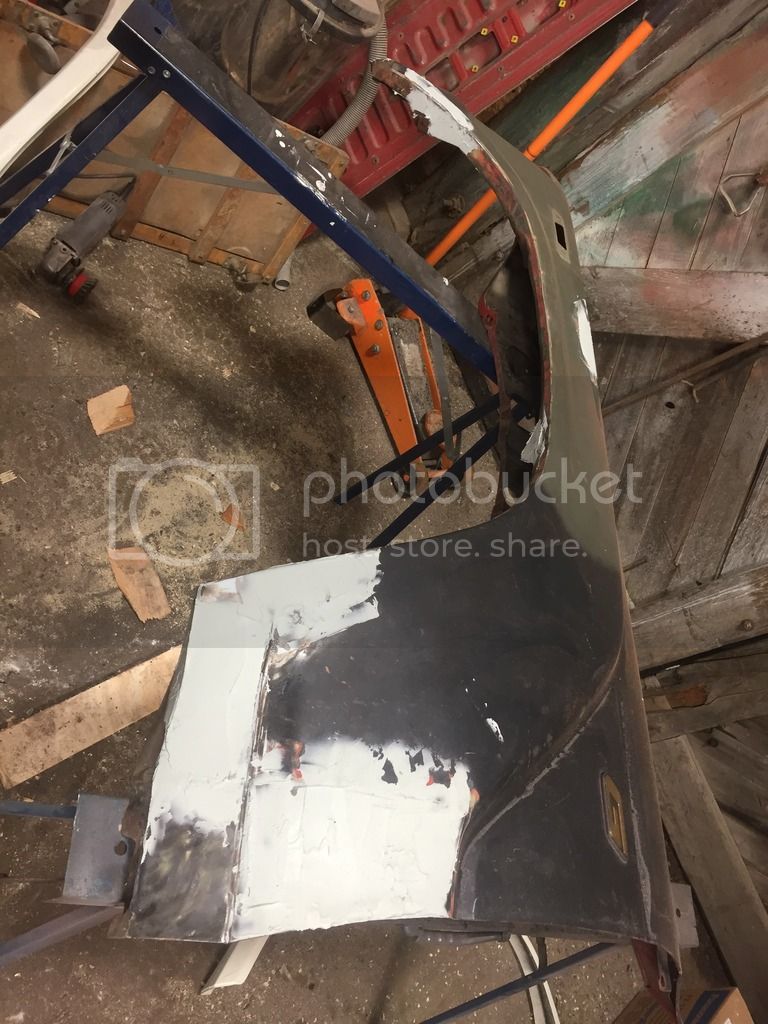

Had a line on a LEFT drivers side front outer fender but turned out to be a right side, so I slapped some metal and bondo on the original and it's going to have to do for now...not perfect, but not religious either!

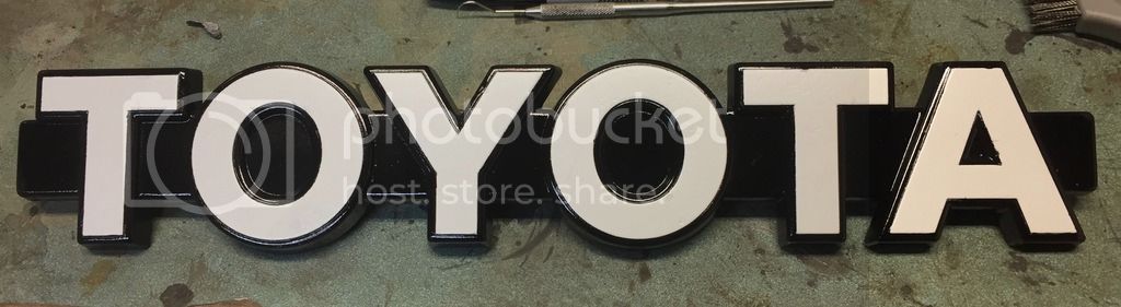

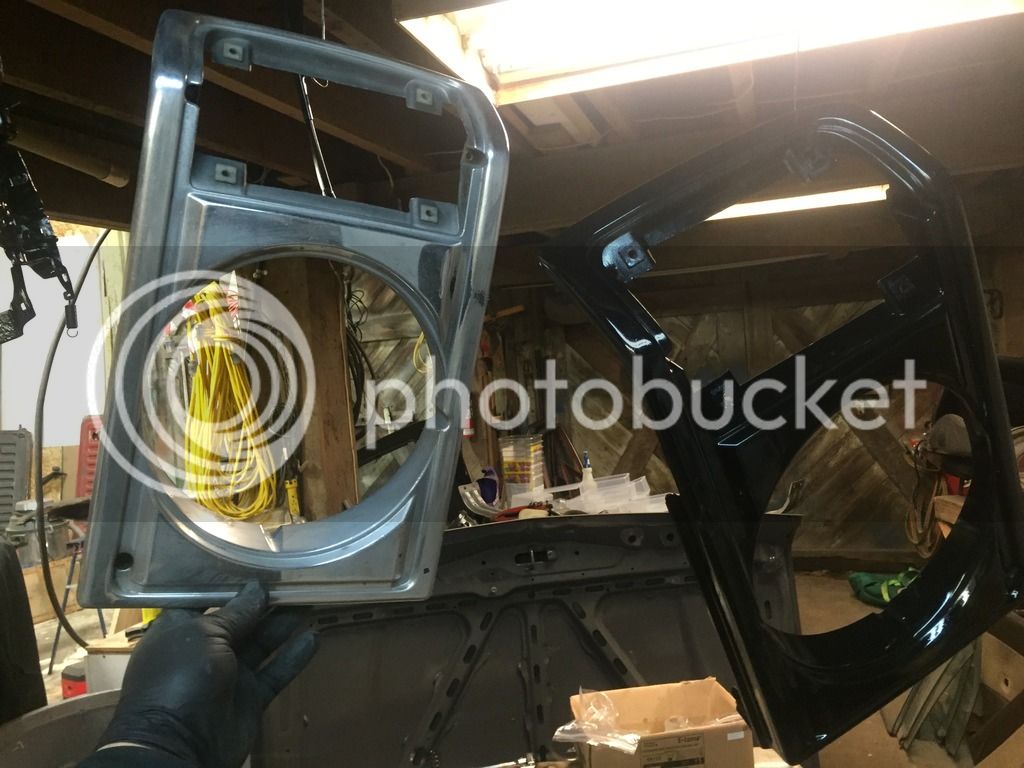

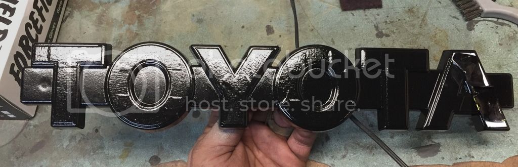

Blacked out the front headlights and surrounding bezel pieces.

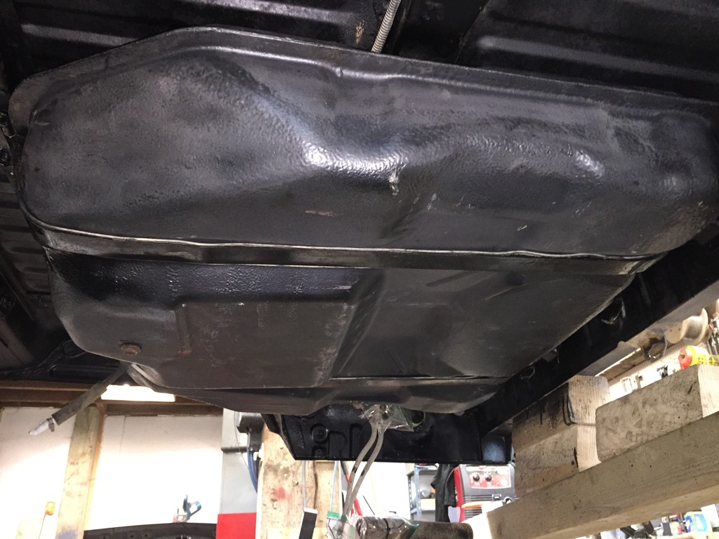

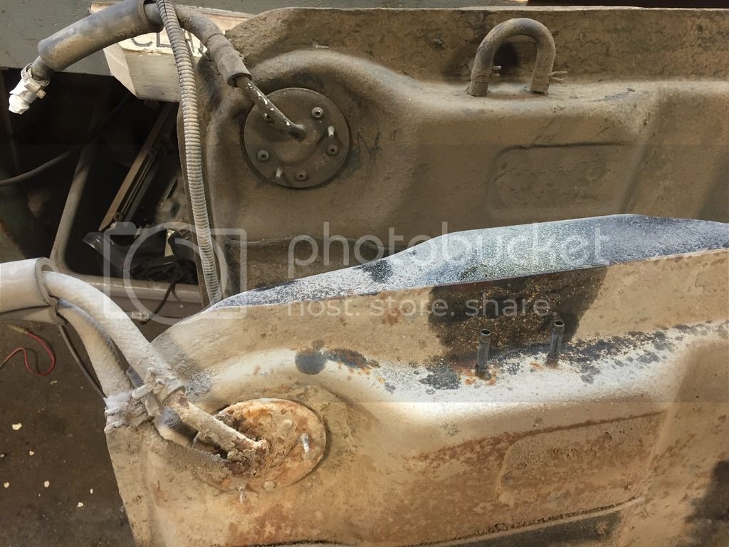

2. Removed fuel tank. I think I'll probably slam my Camo tank in for now as I know it runs with my 3B (12v vs 24v shenanigans). Also, the PO looks to have done some funky fuel/air line acrobatics, so I don't really want to mess with things at this point. Look at the pic closely and you'll see what I mean.

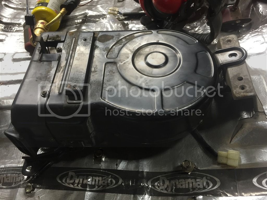

3. Customized the rear seat heater from the HJ (under console mount) with the BJ motor and shroud. One might think that this is simply a swapping of the 12v into the 24v spot, but alas it is not! There are many parts which are the same, but how the HJ mounts under the console is quite different so you have to modify the BJ motor casing and mounting brackets. I didn't take pics because, well, I didn't...except the final placement, which I will include here even though it will just look like an HJ rear heater...pffft.

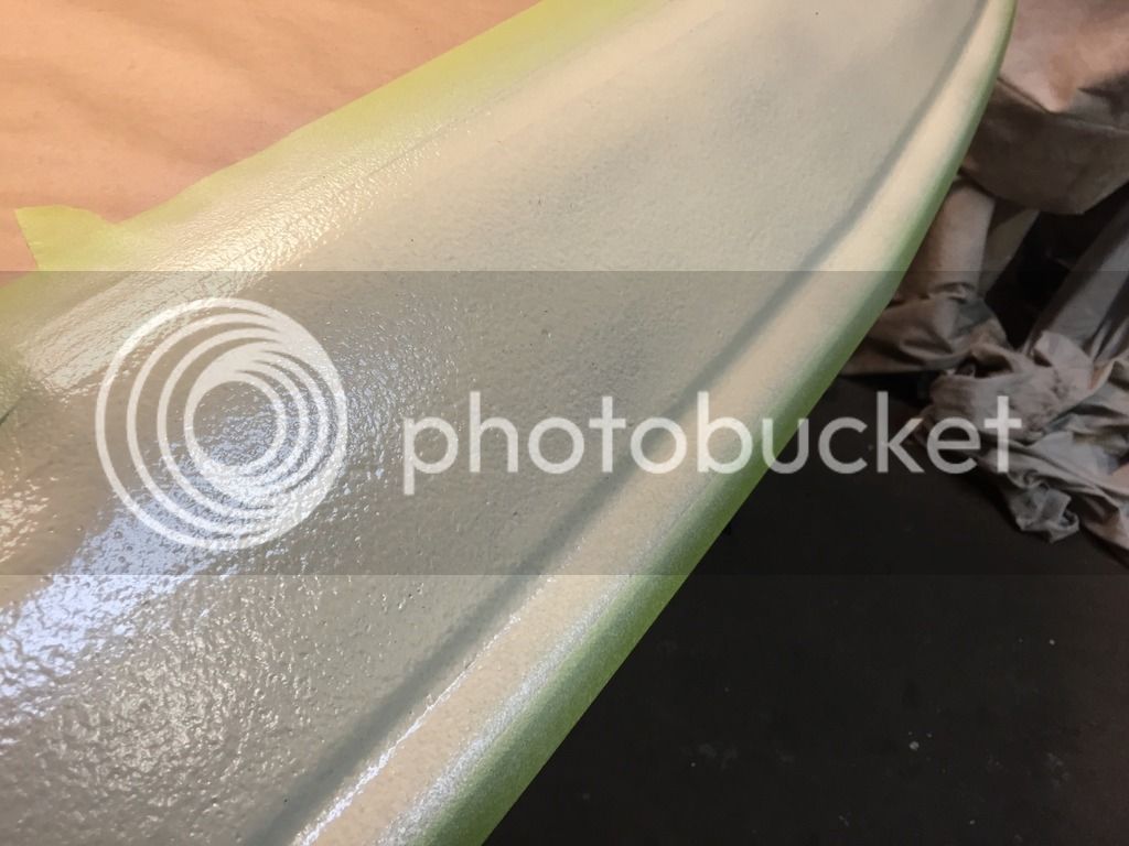

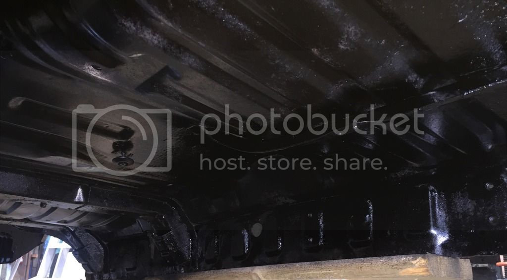

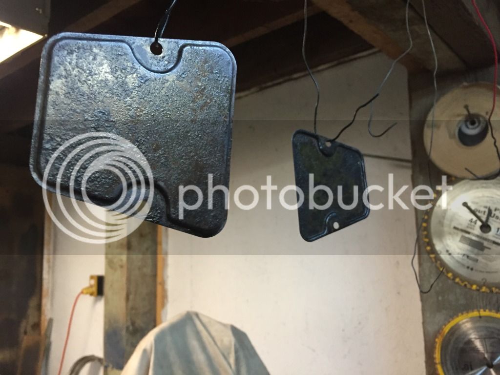

4. Asphalt sprayed the underside of the body...that was fun...not.

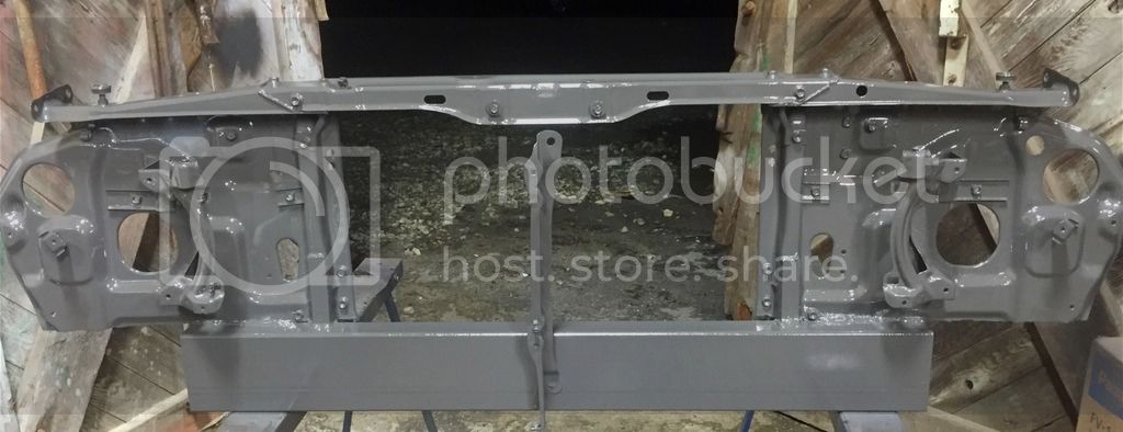

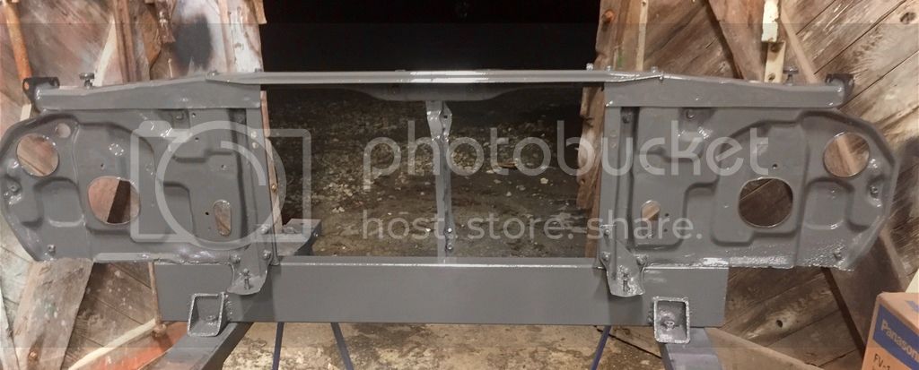

5. Prepped and sprayed the front bezel (I apparently forgot it the other day as it was hiding under a bench...doh!). Lucky for me, the PO had already beefed it up by cutting the bottom 6" off and installing a nice piece of 2x6 tube as reinforcement, so no welding for me!

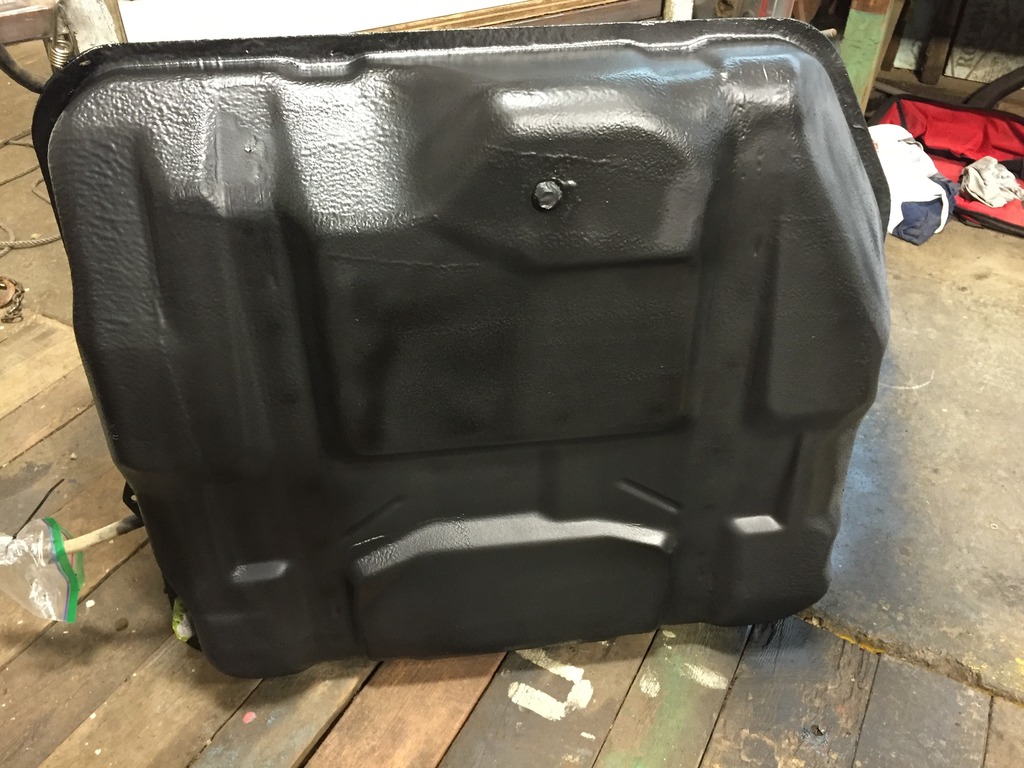

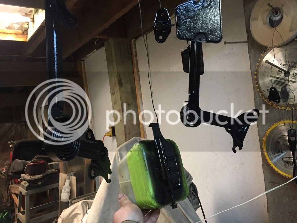

1. Fuel tank rubber coated and re-installed. A couple notes on re-installation....highly recommend you do this with (A) someone else and/or (B) a hoist of some sort. I used a jack and some wood, but it was precarious and almost fatal. Also, don't tighten the swivel side of the tank straps all the way and then try and get the other ends to bolt in...they won't...you gotta keep the swivel ends loose (just threaded in) and then tighten each end a bit at a time. It's a tight fit under there!

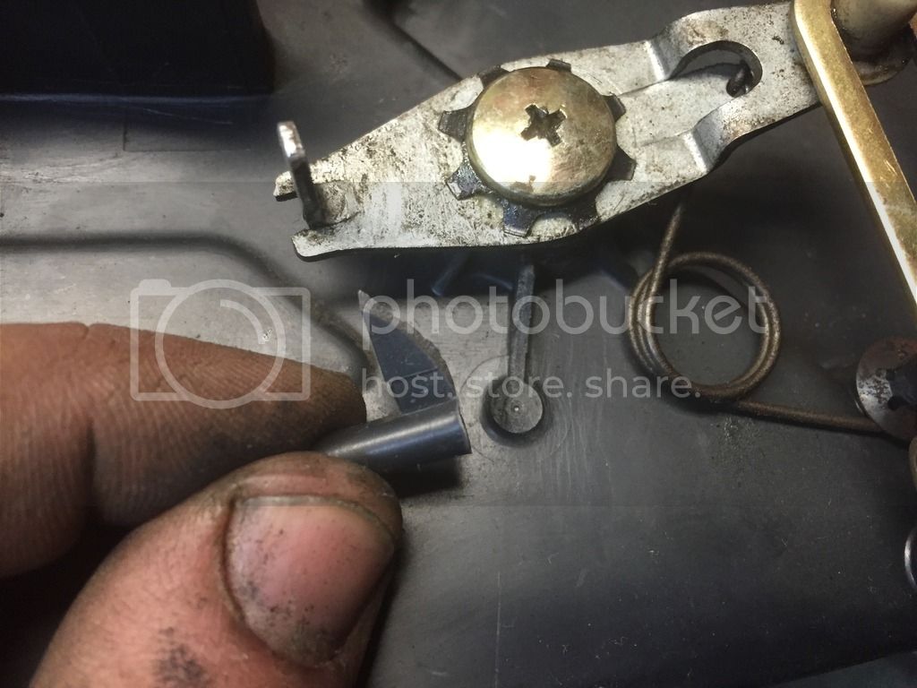

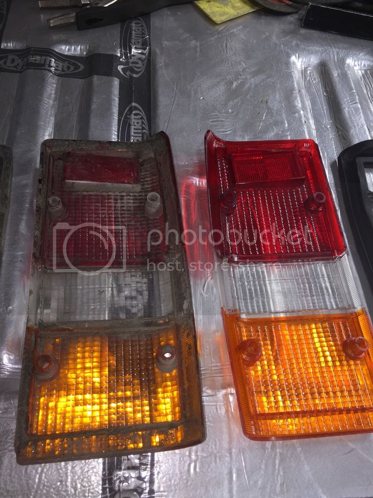

3. Cleaned the rear signal/running/brake lights. They were pretty crusty! Was able to lube the spring mechanisms which hold each lamp and make sure they are functioning well too. I will say that if Toyota had put as much care and attention to quality into their body/frame metal as they did into these rubbers then I may not be doing all of this right now, but I digress...
