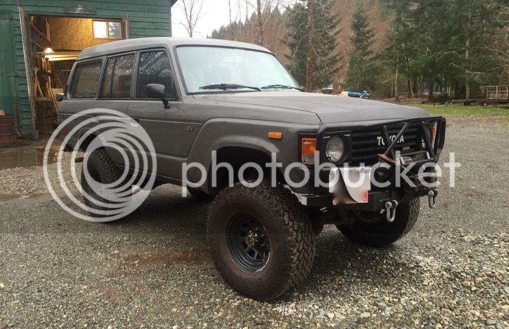

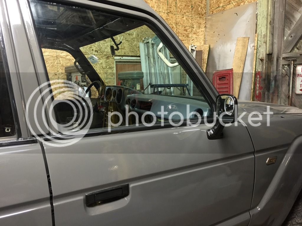

Windows were installed today. The window welting which replaces the chrome was installed by the pro's and let me tell you, it was WORTH IT! They have a special tool you see...an SST...for that very thing...and it's awesome. What wasn't super awesome was that the last 2" of the windshield install ended in tragedy so I'll be driving the truck to their shop early next week for a 2nd try at the windshield.
But know this, we laid the two new windshields on top of the OEM (broken) one and they were 1/4" and 1/8" wider respectively. That 1/8" was 1/8" too much apparently. The boss at the shop said there's a better way to install that type of windshield so I think he's going to do it personally when I bring it in. Regardless, I have all my windows in so I'm able to drive it now :-)

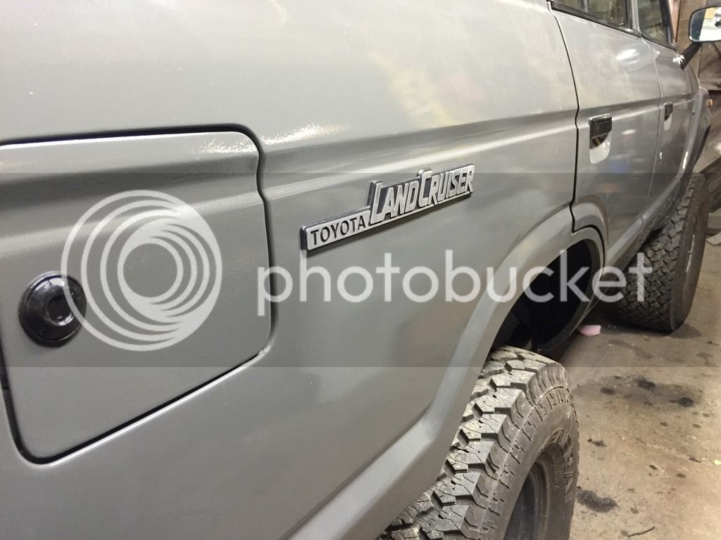

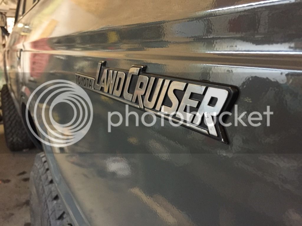

All things exterior relating to sealing the holes has also been done, like door handles, side mirrors, badges, has mostly been done. Just need a couple emblems for the rear tailgate and I'm set.
Cruiserpilot, after much research locally and within Canada I came to the conclusion that ordering from Wagongear was my safest bet, so I did. He must have a large bulk role of it because he sent it to me in pieces marked individually, not in an OEM package. I have yet to let him know that the rear glass measurement was off by 4", but the sides were proud as much so I stole from Peter to pay Paul :-) The welting itself is not the actual seal but rather provides the necessary tension for the OEM seal to seat properly. It just means I have two "ends" instead of one.

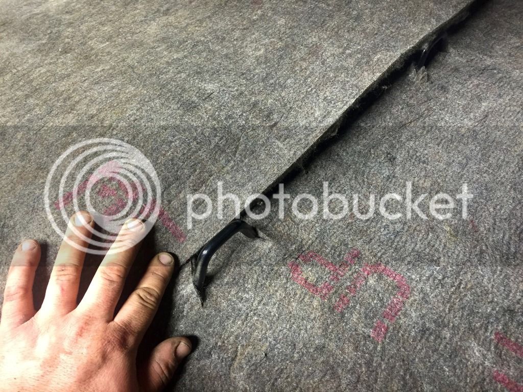

Picked up some underlay from Mastercraft Flooring in Duncan last week. $75 for more than I needed. Seems like pretty decent stuff.

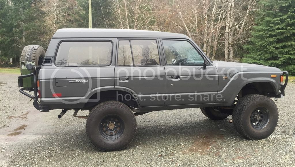

The picture of the Drivers side ( last pic) shows a special addition which the BJ60's (at least not that I recall) never had. Can you spot it?

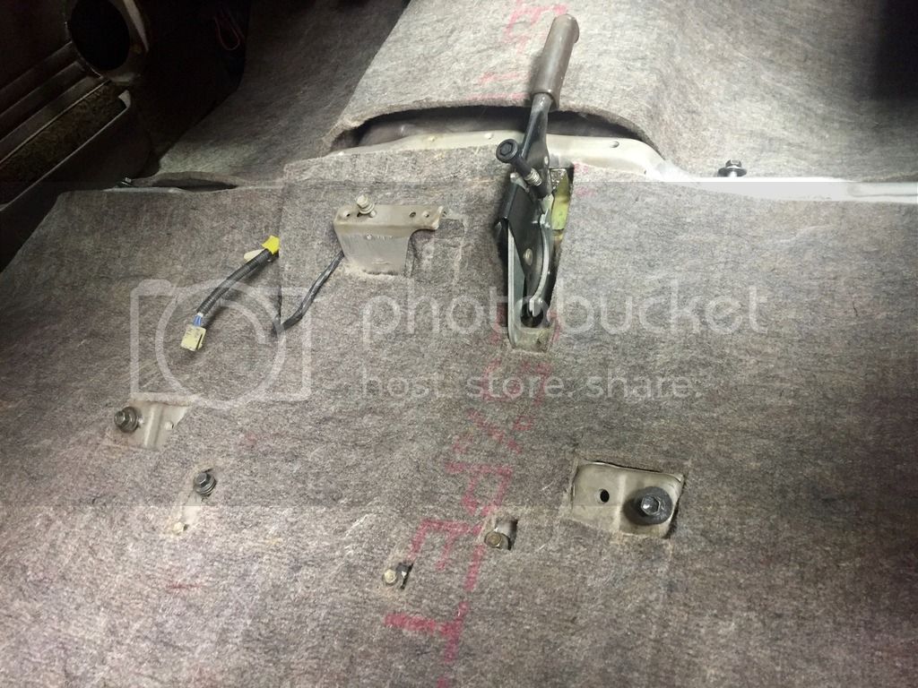

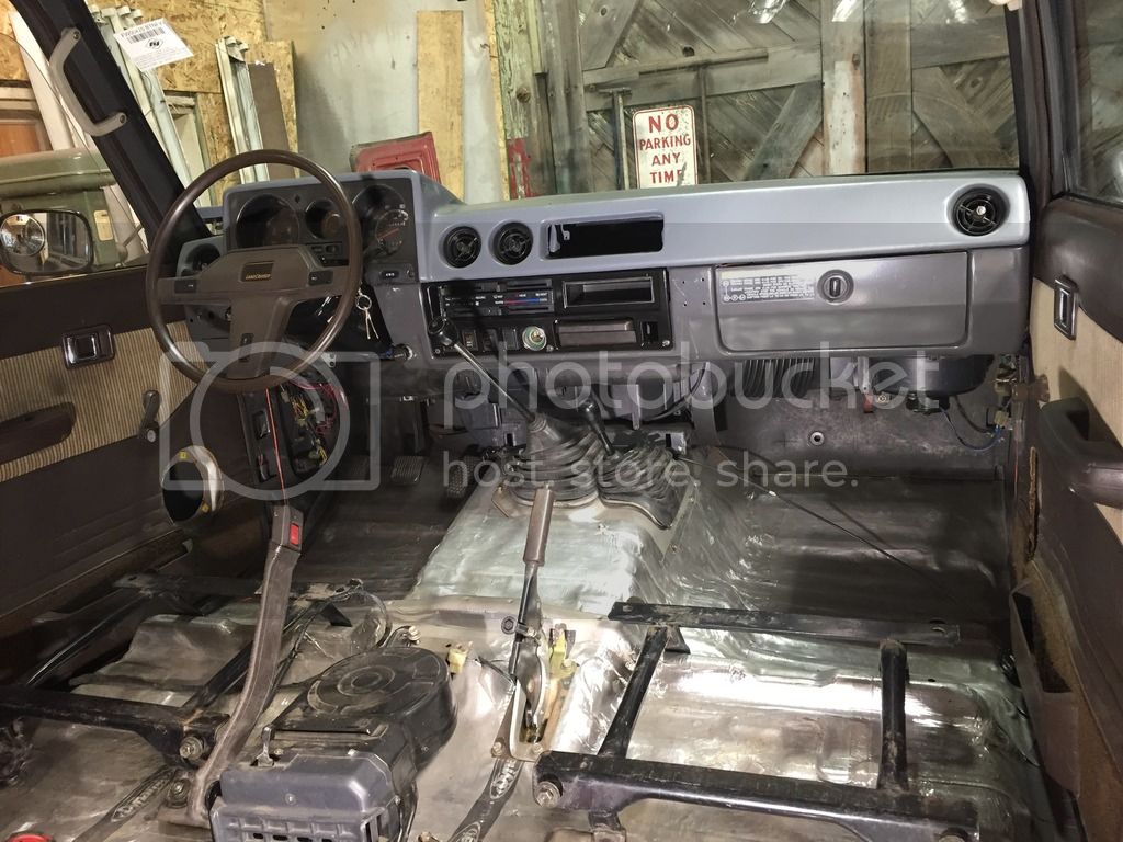

Have an interior question for you. Does your HJ61 have 60/40 split seats in the back? If so, are the mounting points different from the BJ60? And do you have reclining levers on the 61 rear seats? A guy local to me has a partial rear seat and we are trying to figure out what it came from.
Btw - amazing work, quality and fortitude are top notch.
@NookShneer, I'll have pics up tomorrow about the interior stuff as the rear seats should go in then.
Nonetheless, yes, the HJ seats are 60/40 or 70/30 (whichever) and they definitely mount differently than the BJ's. The HJ splits seats have two sets of two bolts per seat so there are 8 mounting points on the floor for the entire rear seat setup.
EDIT: Rear seats are 50/50. The top folds down against the bottom and they both flip up towards the back of the front seats. No reclining.
I don't know about reclining yet, but I believe they just latch into place on the uppers and that's it, but again, I'll know better by tomorrow.

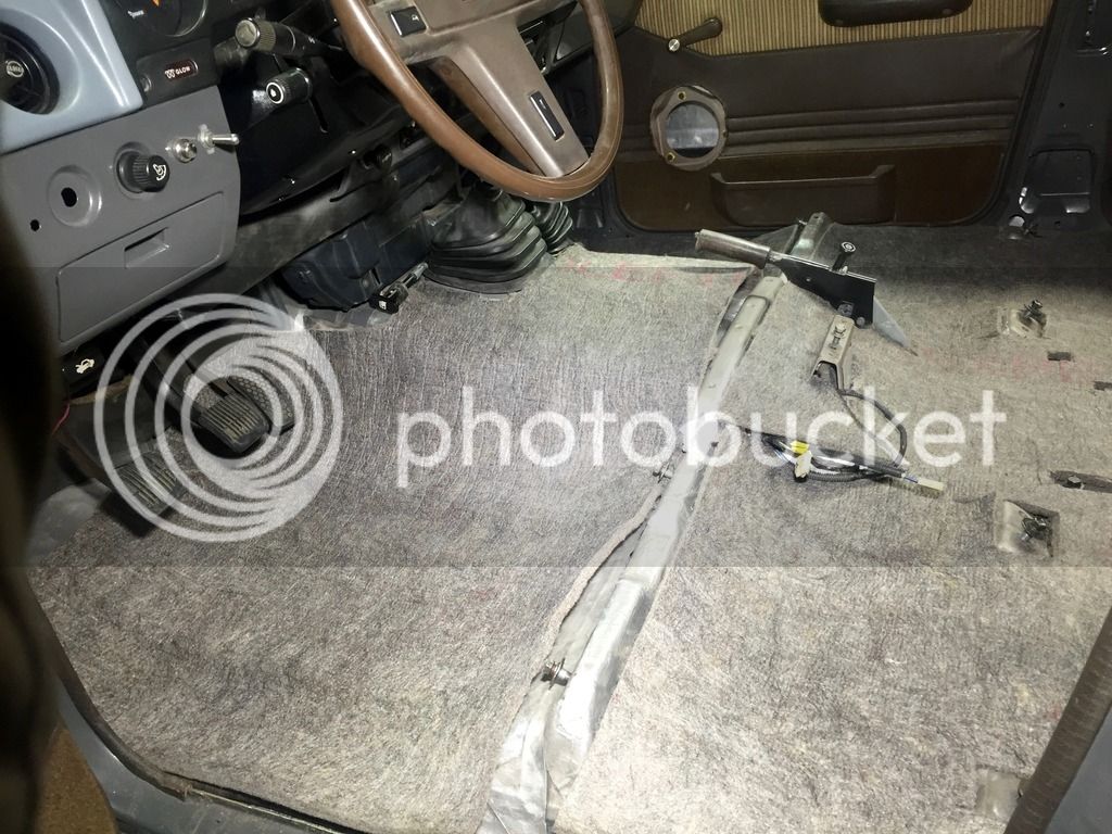

Today I was able to get the carpets cleaned up and installed as well as the two front seats. But I wont post pics until tomorrow when I have the rears in as well.

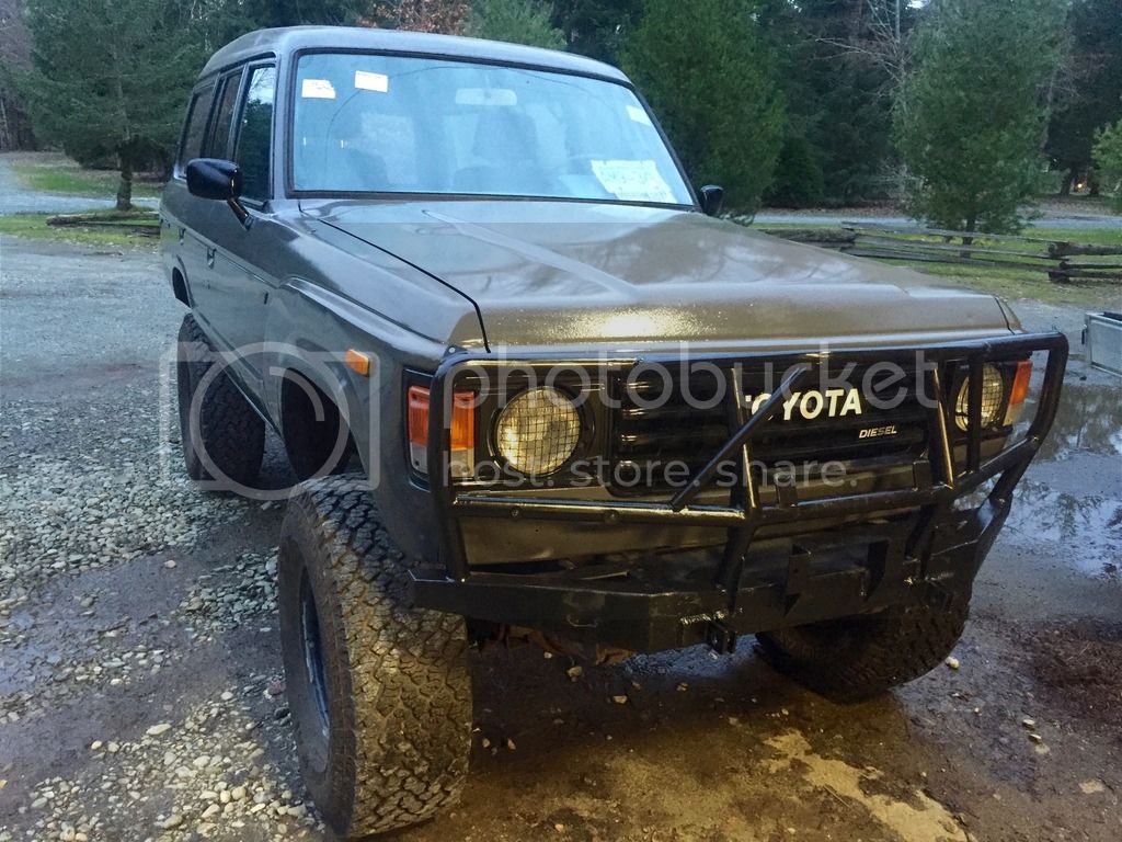

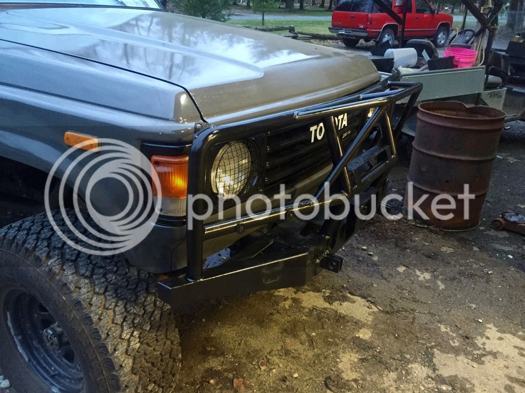

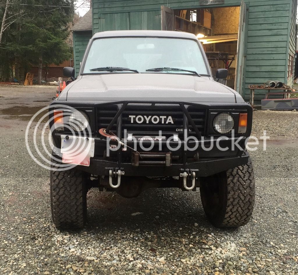

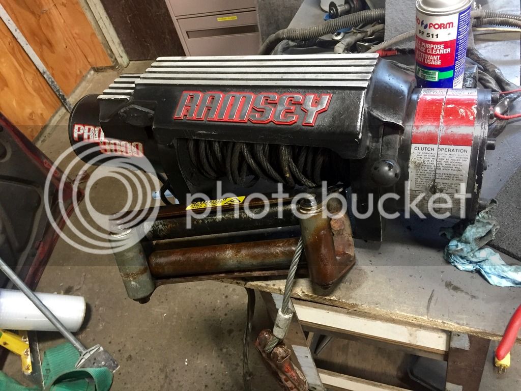

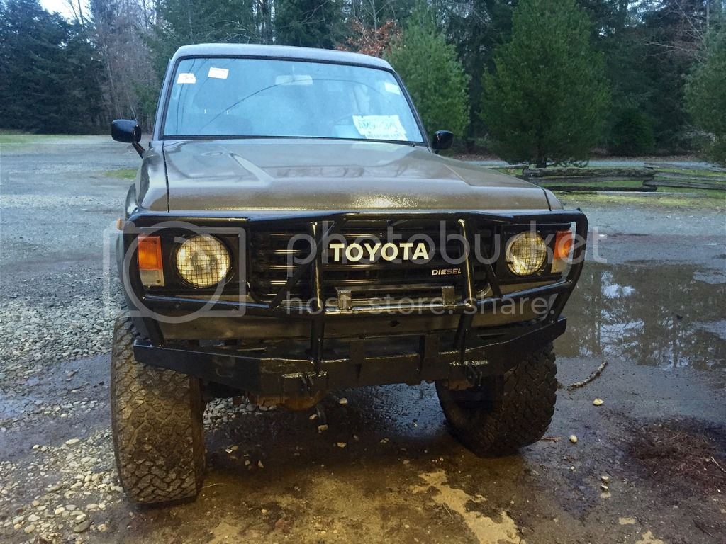

I also re-welded and repainted the front bumper and installed it. I'm now realizing that all my efforts in making the "Toyota" grill so nice will be trumped by my Ramsey 9000 winch :doh:. But, removing the winch gave me the opportunity to clean and lube it up.
So, I lied about the winch. It doesn't block the view of the "Toyota" sign...the big 'ol 7" round lights that were on there did. I'll be replacing them with new ones from RADD soon enough, but the old ones had googly eye syndrome and made my wife carsick when they were on o_O Oh, and apparently the winch can only go on if the bumper is off, so yeah, did that twice :doh:

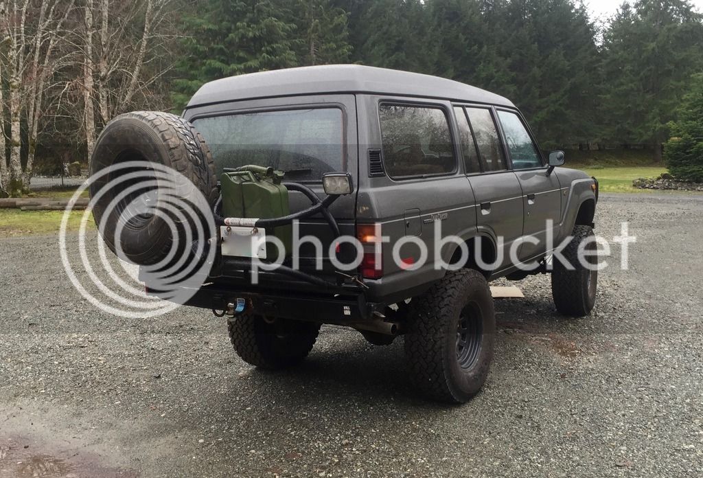

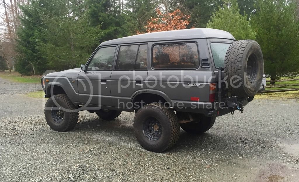

Since last time I've installed the rear bumper, wired up the license and additional reverse lights, interior carpet, adjusted brakes (thanks RADD!), reflective strips at rear quarters because imports didn't have them apparently, and had the windshield replaced correctly.
Here's the last set of pics for awhile probably. Gotta finish up this crazy busy week of work and then we're off for an adventure (including the dog!) for some much needed rest.
