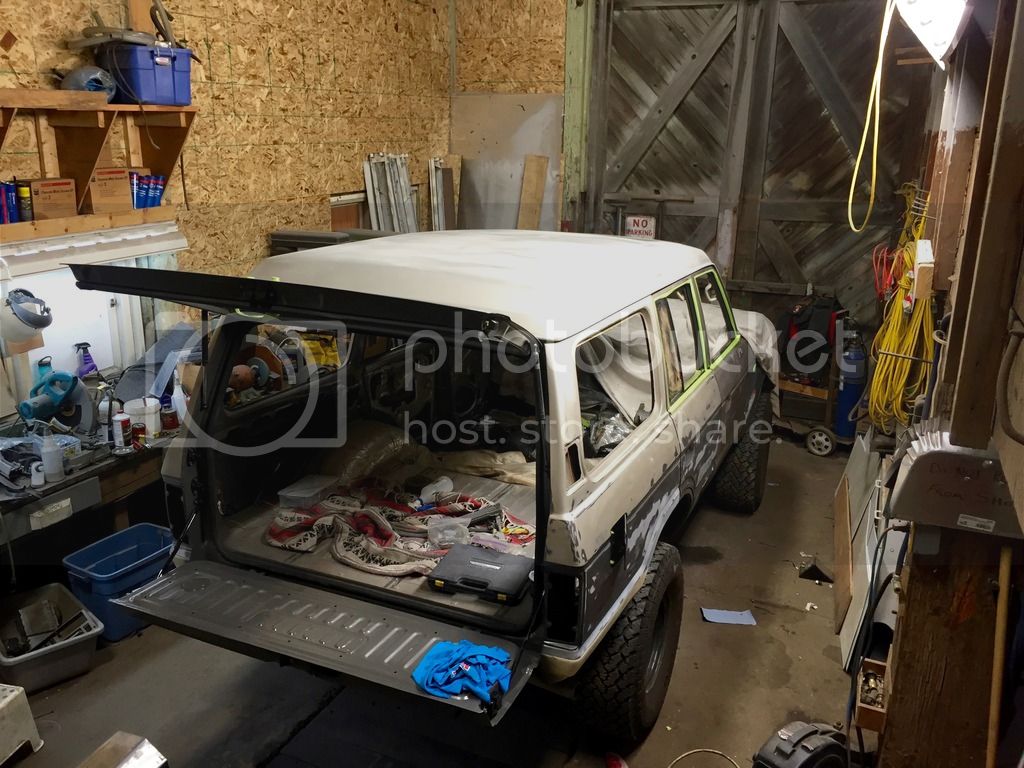

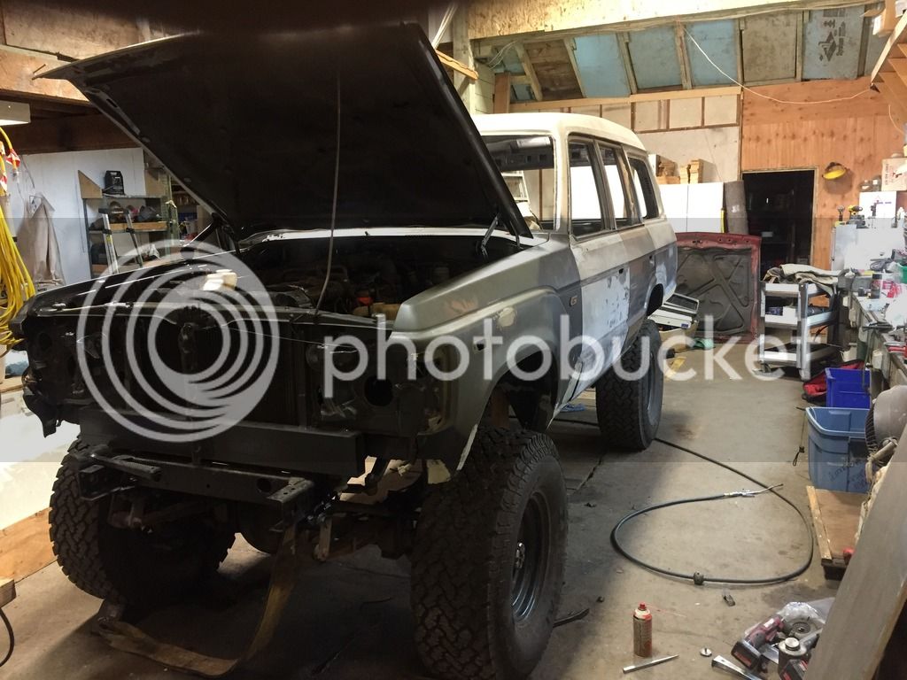

BJ60 to HJ61 Body swap...the five year plan turned right now plan!

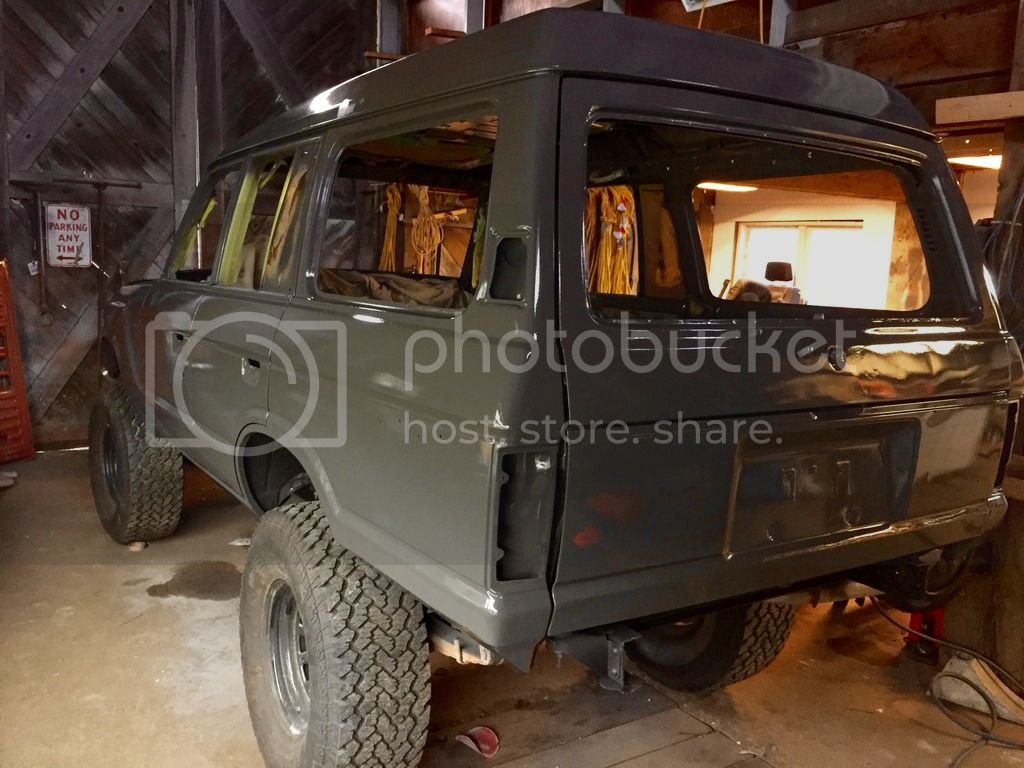

Had a decent night...and weekend for that matter...
- Did NOT braze the windshield connection, but rather just welded it up, grinded it up nice, seam sealed, painted, we'll see how that lasts :meh:
- Bled brake system
- Bled clutch system
- Bled fuel system
- started identifying a few mystery wires the PO had run...nice to have some spare wires in the cab for devices though! :cool:
- Fitted all the closing/locking hardware on rear upper/lower hatch/tailgate
- Fitted the front inner and outer fenders
- Fitted the hood
- Tidied up a few wires under the hood and mounted the things that I knew went where.

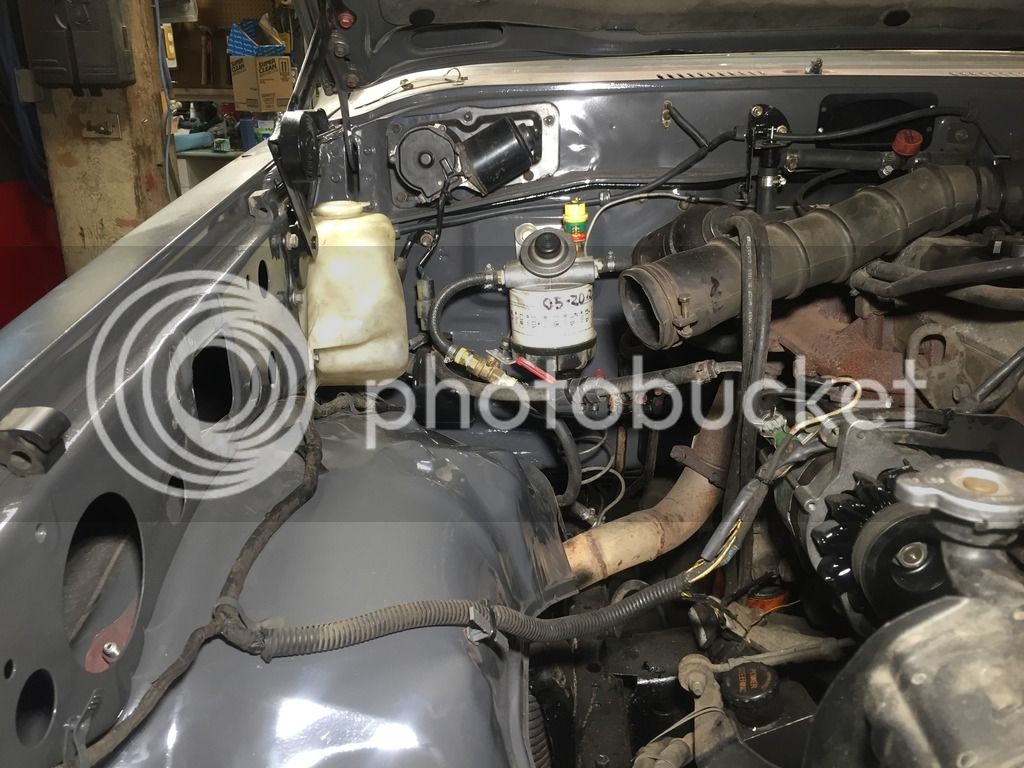

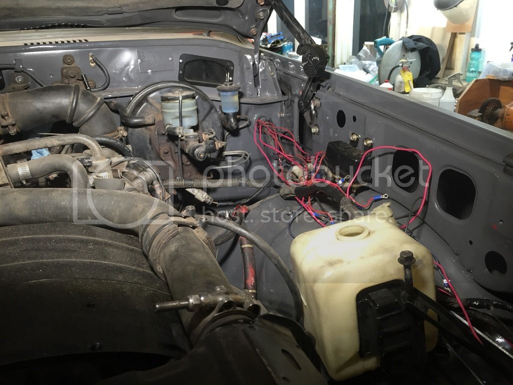

QUESTIONS:
- Need to know which brackets go where on the battery trays. I know the coolant bottle goes on one side but I have two brackets (one with a large clip to hold a hose by the looks of it) and I don't know where or which side to mount them! If anyone either wants to take a good picture of your 3B engine bay (or a few) or even just bring yours over that would be swell! :bang:
Anyways, here's some more pics...

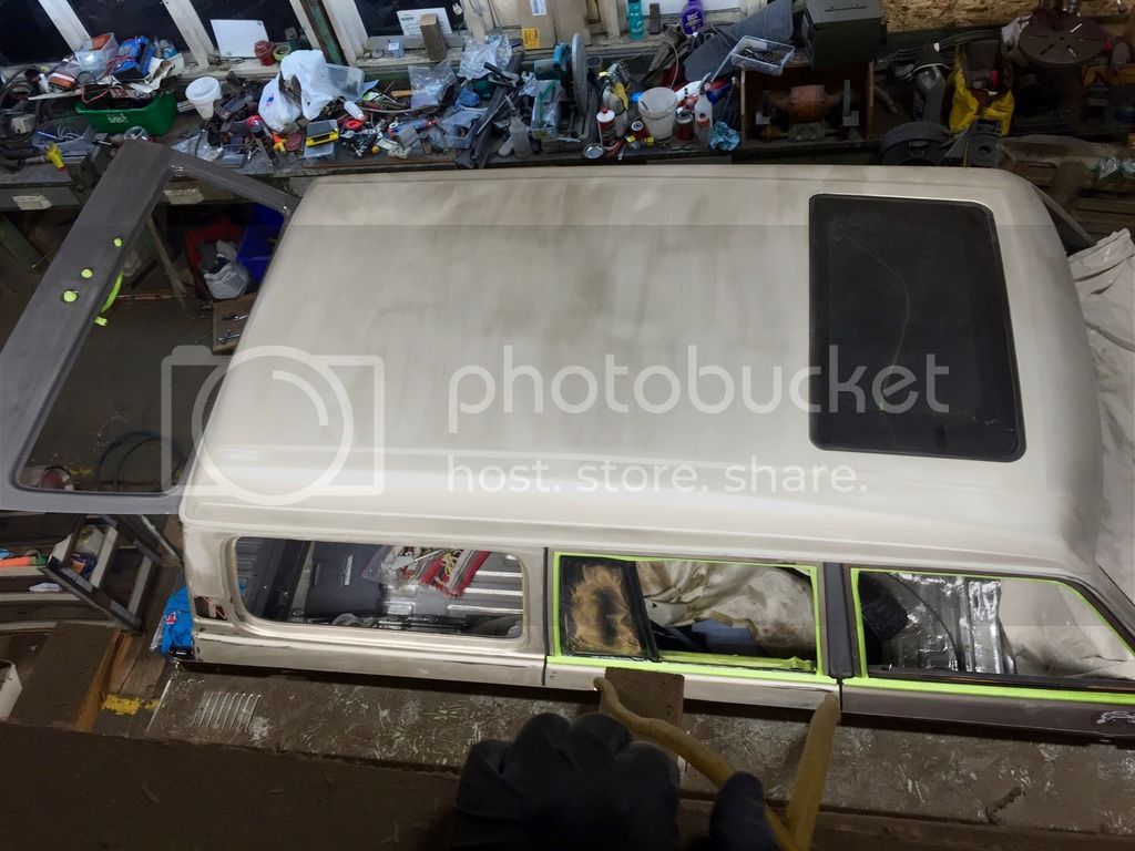

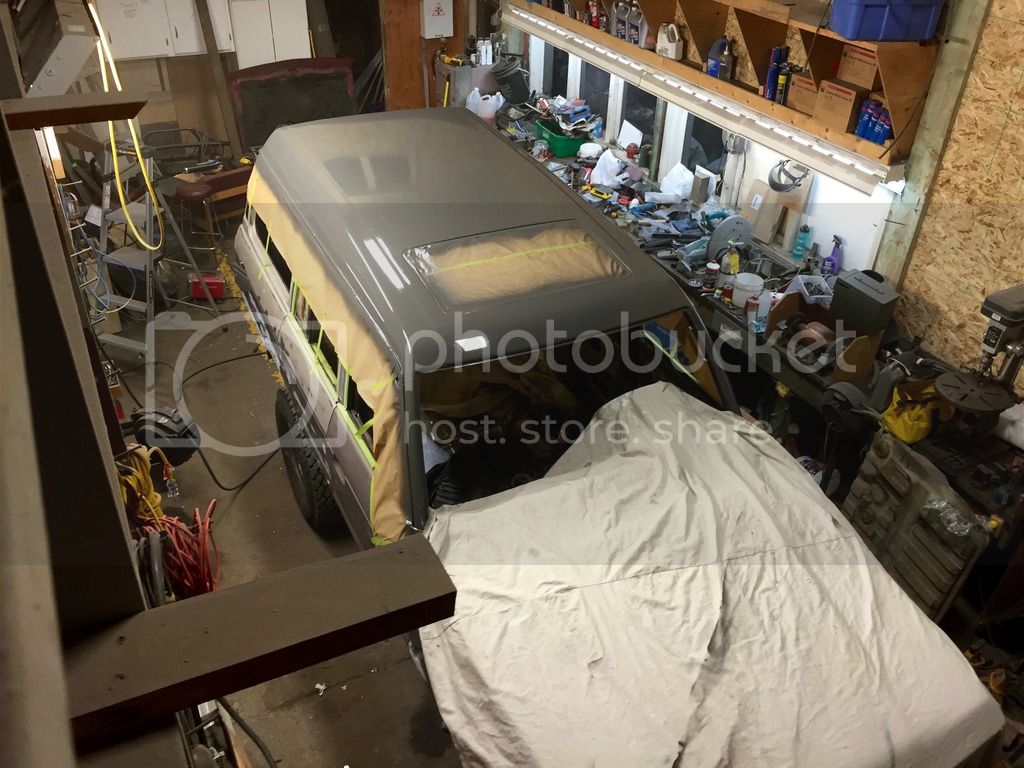

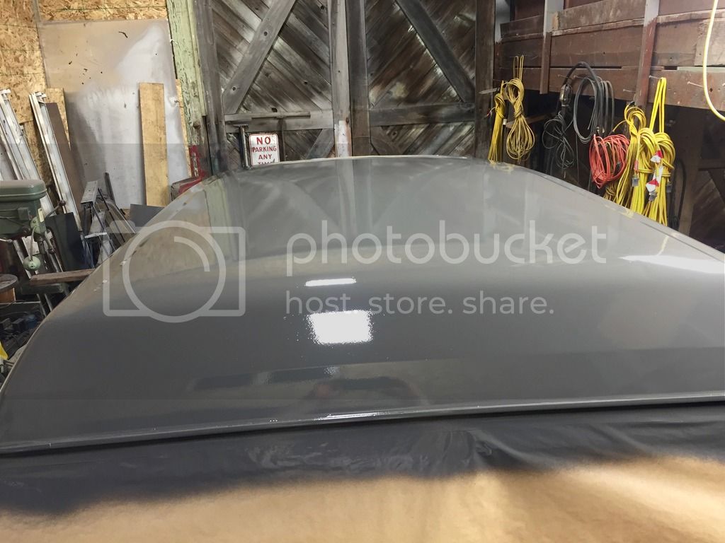

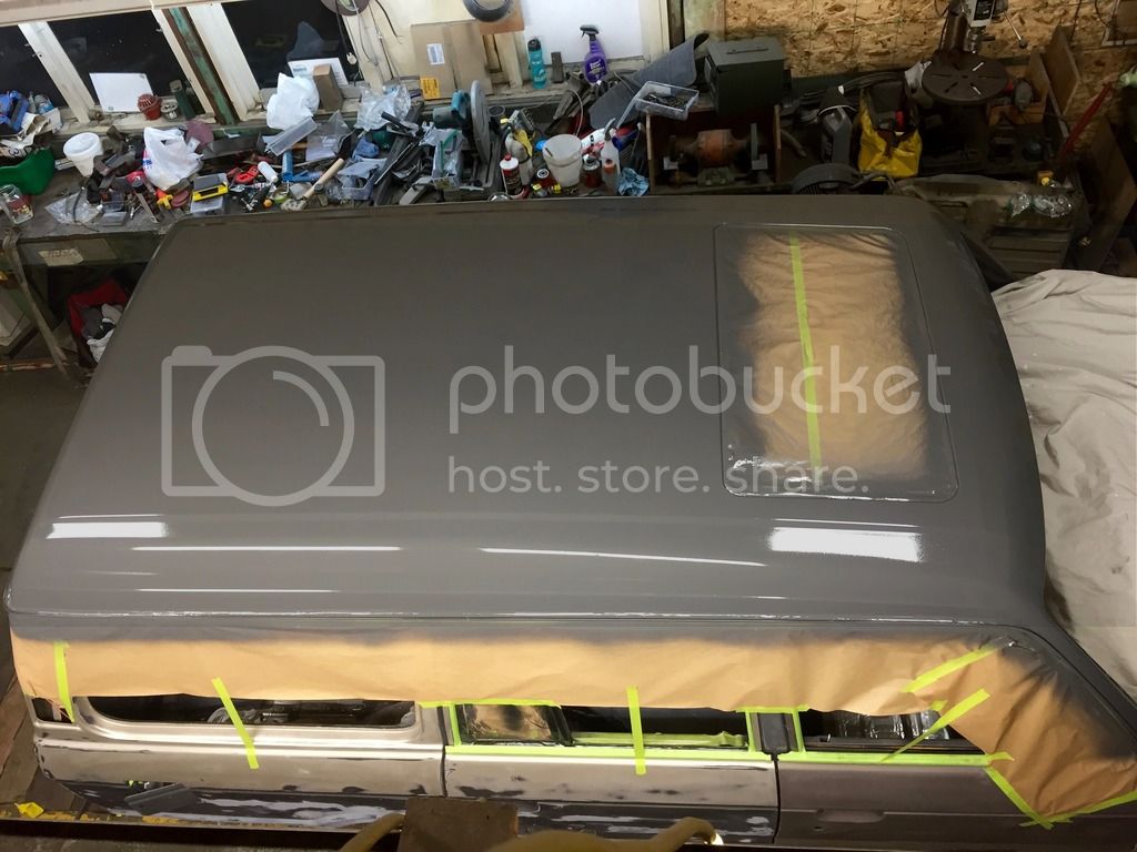

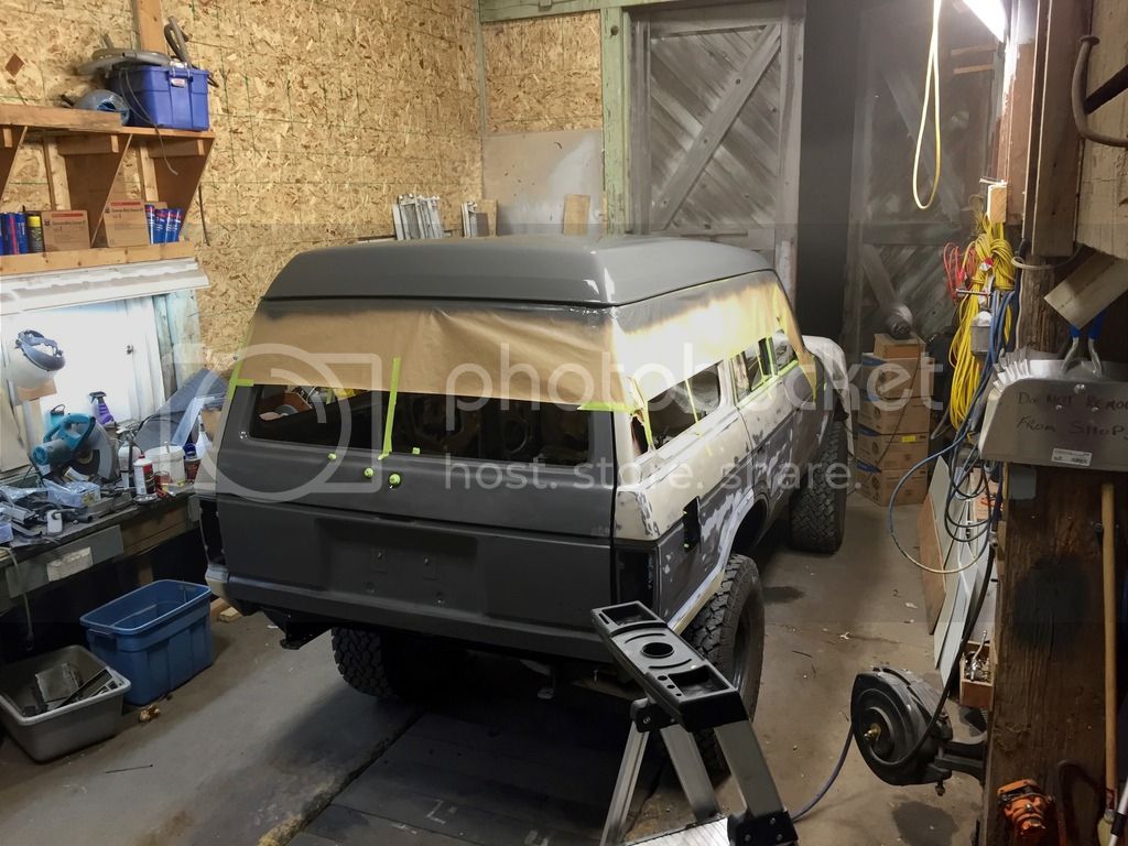

Roof Painted with two coats tonight. We'll see what it looks like in the morning and after it dries up. If it looks half decent then I'll throw on another couple coats. My wife, who wasn't a huge fan of the Camo look, said that that is what she's comparing it to, so I think it will be pretty difficult for it to not look good in her eyes ;-)
As you can see in the pictures, my shop is not a dust free atmosphere so I'm really rolling the dice with this.
For the record, I crunched some numbers and since October till now I've put in around 1000hrs on this project. That's a lot of evenings and weekends people! Actually, that's half a year of full time work, and since it's only 5-6 months that means it was essentially a 2nd full time job. So for those of you with lingering projects, I completely understand that it does not make good sense for one to invest every hour of "free time" towards a project. But about those hours, even if I was worth $20/hr, that would be $20,000 worth of "shop hours" on this project. Pretty easy to see why complete restorations cost tens of thousands of dollars to have done at a professional shop!
Anyways, some pics from tonight.

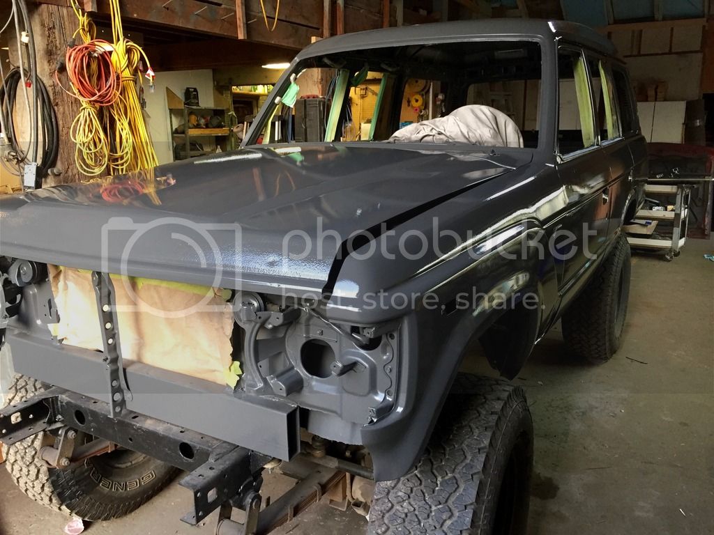

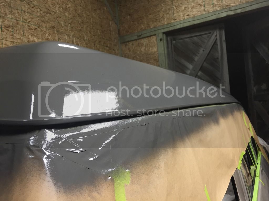

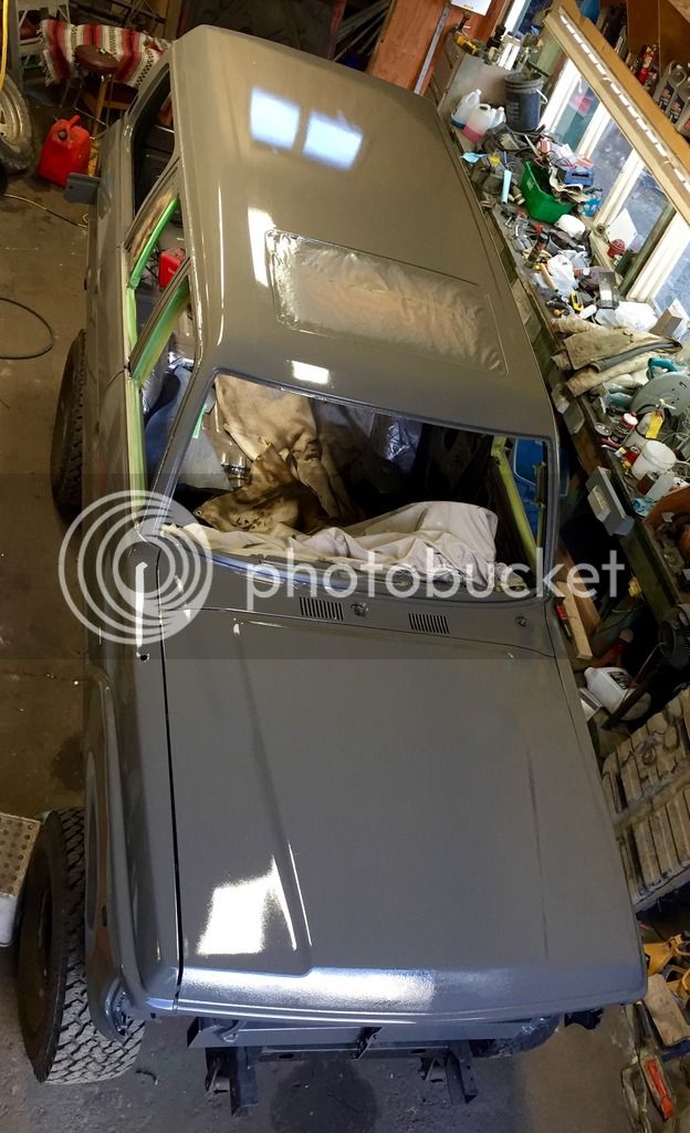

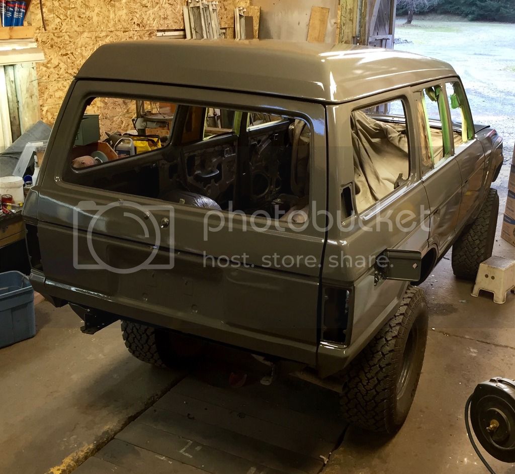

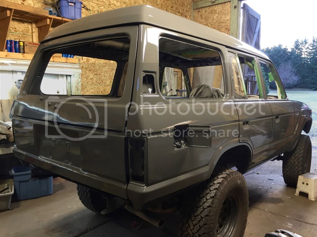

Got around to painting the entire body today.
Cons:
- Windstorm opened main shop doors and blew in dust while I was 2/3 through 2nd coat.
- My inexperience with a spray gun is obvious.
- Cleaning out gun with paint thinner, caught an edge, made paint thinner fly into my face...glad I had an eye wash station close by!
- My attempt at doing the roof first and waiting to do the rest of the truck didn't work as overspray landed on the roof and gave it a dull finish. Apparently everything needs to be "wet" so it can absorb the overspray. In the end, the roof got another fresh coat today.
- Definitely a "good from far, but far from good" finish.
Pros:
- Looks WAY better than it did six months ago!
- Everything is sealed now and should keep major rust issues away for at least six months ;-)
- It's almost done!
Here's a few pics to show how different lighting impacts the color. Wasn't able to take it outside as the weather was all over the map today and didn't want to risk it. I have some heat and a big fan on it now with the hopes that it will expedite the curing somewhat.

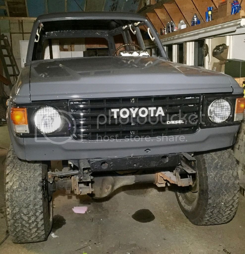

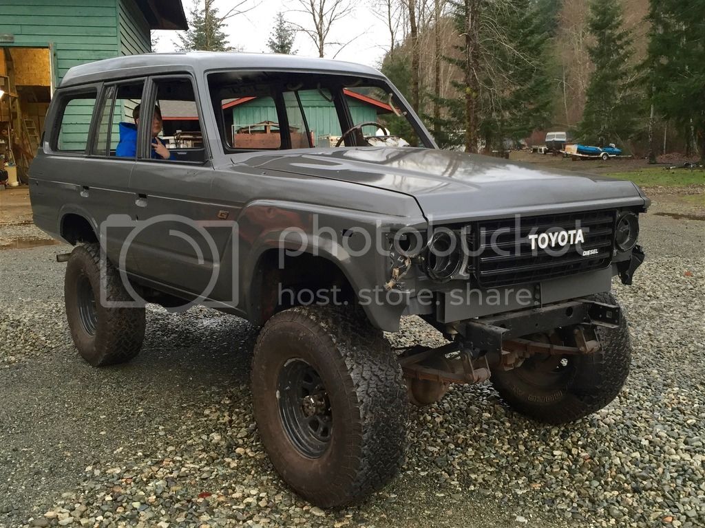

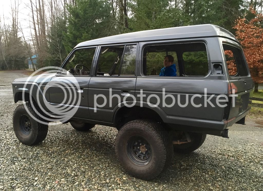

I was able to sneak in a couple outside shots today. The blacked out chrome is growing on me...at least it's not peeling!
Also:
- Tested headlights, taillights, brake lights, signals, and horn...all worky.
- Installed lower bezel (totally forgot to paint it on the truck!
- Installed front grill and headlight bezels
Pics...apparently my 11yr old son thinks he's pretty gangster sitting in a truck with no seats.
