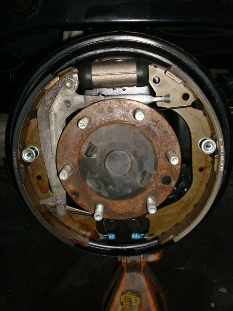

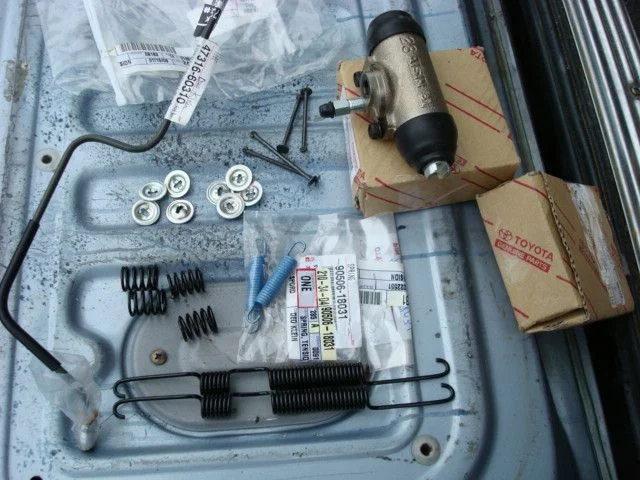

I am almost done with the brakes. During the rebuild, I managed to lose part of the adjuster.
The part missing is a lil cap that mounts onto the adjuster.
My adjusters are fine, I just need (1) lil cap.
Toyota doesn't offer it w/o buying an new adjuster.
The 60 drums are a one banana job, unlike the 40 which has 2 cylinders per wheel.

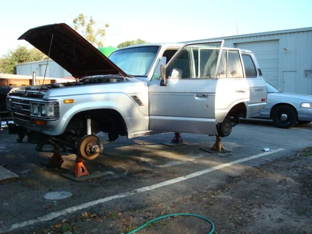

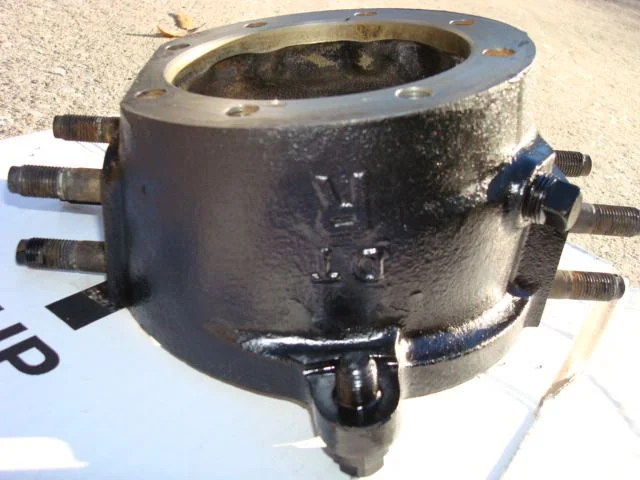

I am rebuilding the knuckles, re gearing and exchanging the h42 for a h41.
The h41 is from an 82 Kiwi Bj42.
During the knuckle job, the 62 4.11 gears are being replaced with the bj60 3.73s.
With the h41/3.73s in place and a set of 33s, I'll have a nice rubber overdrive &
be geared low enough in 1st, 2nd and 3rd to still "get out of the hole".
This route is way cheaper than sourcing a hf55 and all its needed peripherals.
No need to change drive shafts either.

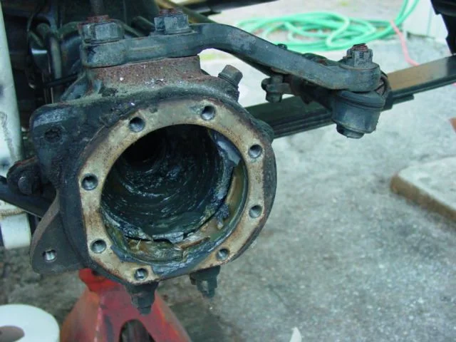

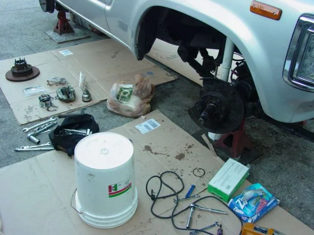

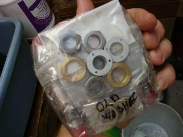

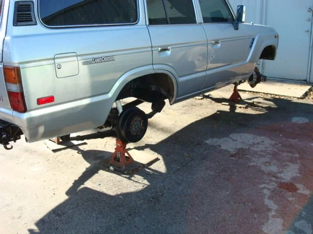

I started the knuckle rebuild today
It is a pretty easy job, and doesn't have to be messy if you are careful.
Notice the card board, plastic bags and toilet paper.
I like to hang a plastic bag from the upper shock mount.
Wearing gloves, I will wipe each greasy knuckle part/piece as it is removed with toilet paper.
I then bag all cleaned/removed parts in a zip lock.
I simply toss the soiled toilet paper in the plastic bag.
The toilet paper does a great job of keeping things clean.
Gunnar let me use his brake line pinchers.
I won't have to be completely re bleed the brakes with these in place.

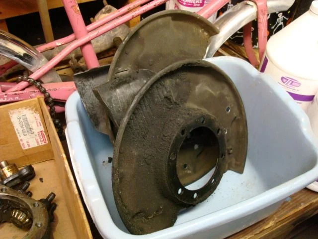

Note the brake line bracket rivets were drilled out.
I will use a washer, nut and bolt to replace the rivets.
All parts will be cleaned and painted before I reinstall them.

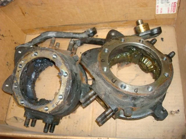

This is my 2nd knuckle job.
I am really enjoying the time spent with my cruiser.
Here are a few before pics of the knuckles and arms.
I have some work to do to, to bring em up to par.

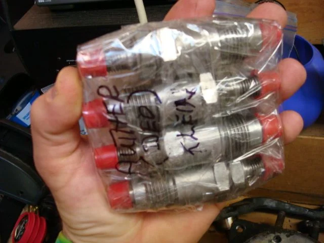

I took my injectors to a local diesel shop to have the nozzles replaced.
Picked them up today and they look great!
I also picked up new bushings and bleed washers.
Big thanks to David of A & D diesel services Gainesville.

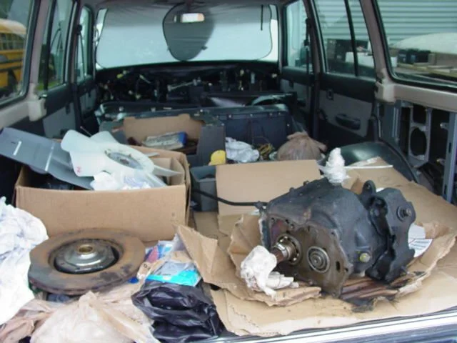

The kiwi h41 has arrived and yeah, I'm stoked! (note rhd shifter)
It was shipped from Texas Monday afternoon, and showed up today before lunch!
I'll clean it up tomorrow, and pull the h42/xfer as well.

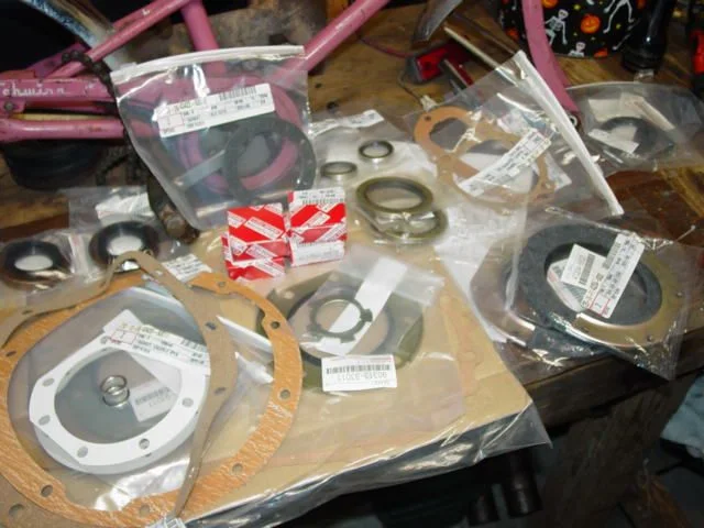

I ordered a stack of parts from Toyota.
I should have everything for the knuckle rebuild, 3rd swap and tranny/ xfer install.
Special thanks to Jose at Gatorland Toyota, I really appreciate your patience/ assistance.
I hope I didn't omit anything...... we'll see.

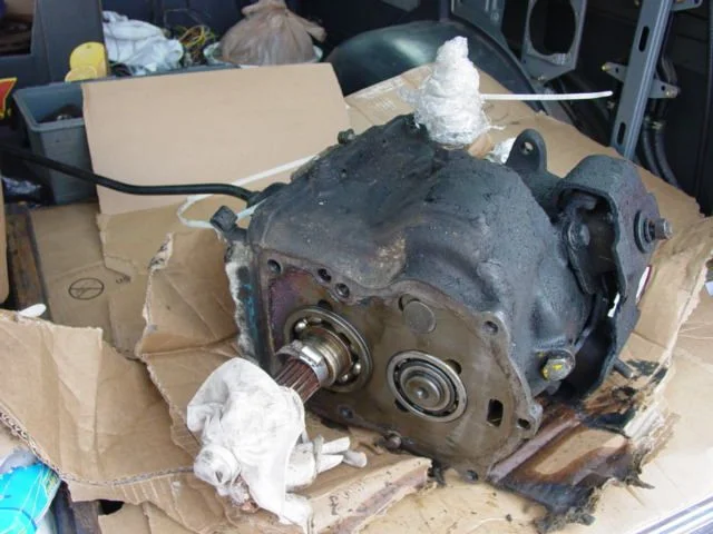

Despite the rain, I got the h42 pulled.

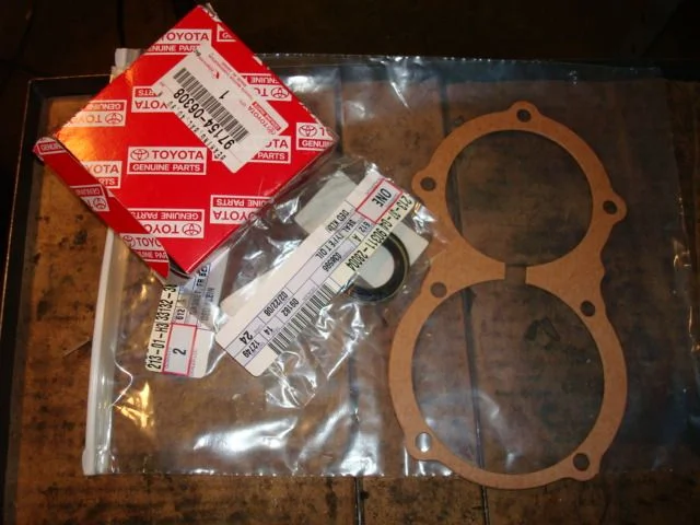

I am replacing the front input seal and gasket on the h41.
The parts should be here early next week.

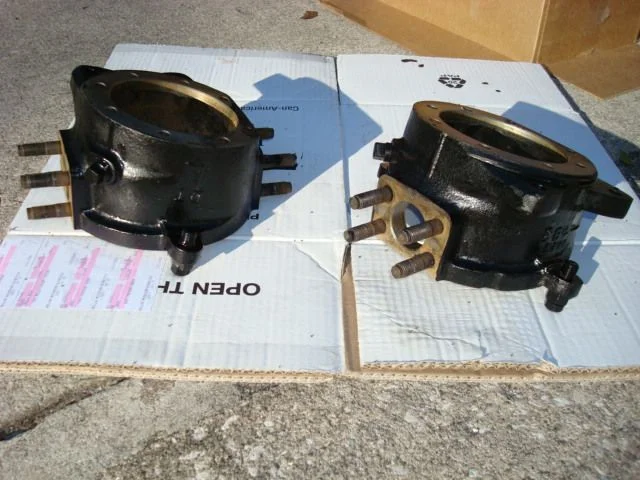

In the meantime, I'll be swapping the split case over.
I installed the 3.7 3rds and am working on a knuckle job too.

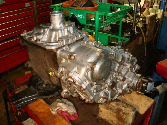

Got the 60 series top cover and the split case installed on the h41.
Gunnar is helping me put it back in the truck.
We are using my old motorcycle jack to lift it.
:edit: h41 installed Monday..... Hooray!
