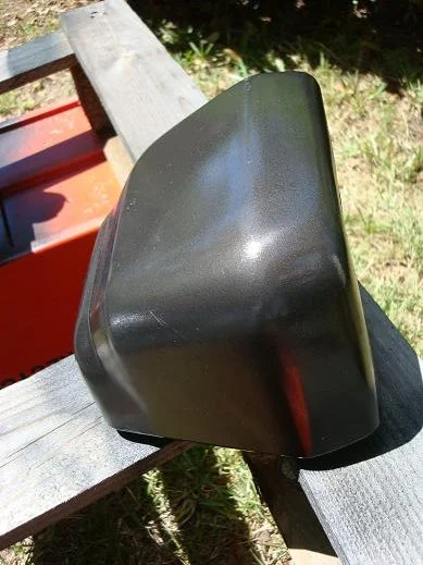

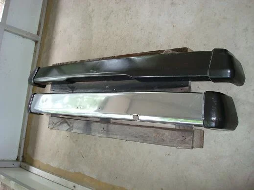

Rear bumper sb'd, primed and painted hammered black.
Front bumper left chrome.
All bumper caps were painted hammered black also.
Thanks Lowtideride and Tofudebeest for the free bumpers.
I will be bolting them on the truck this week sometime.
Go ahead and black out that front bumper. I was gonna. and if you do, they'll match...

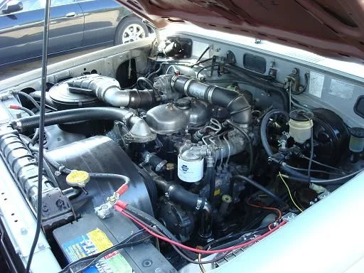

Waiting on a ps hose.
The hose shop said it should be ready Monday.
Frank has made a custom ps bracket (not installed)
Note lower radiator hose. The ps pump mounts above it.
New ac lines are also being made Monday.
Gunnar will charge system with freon and I should be driving it home then.
Can't Wait

The elbow you have off the turbo going into the butterfly is not going to hold for too long. Although I did get 5-6 thousand miles before it split. The heat and pressure split mine wide open.
I ended up using rad hose and have a couple thousand mile on it now. I plan to get silicon instead.
