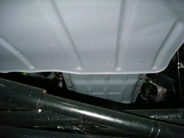

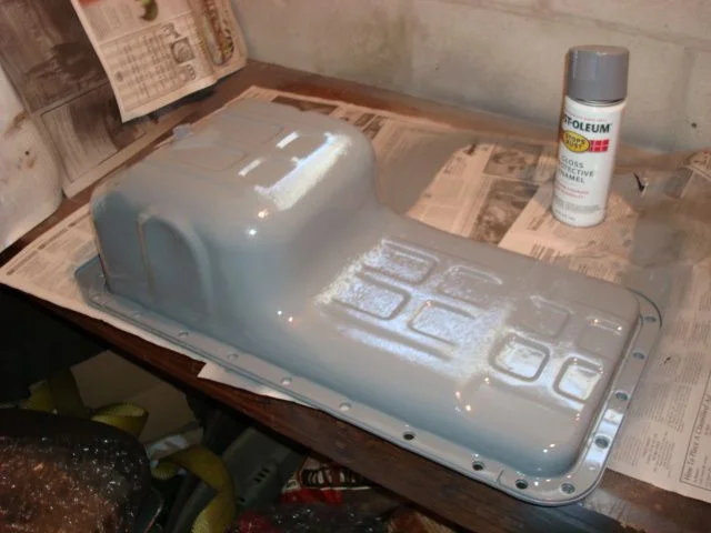

Oil pan cleaned, painted and installed

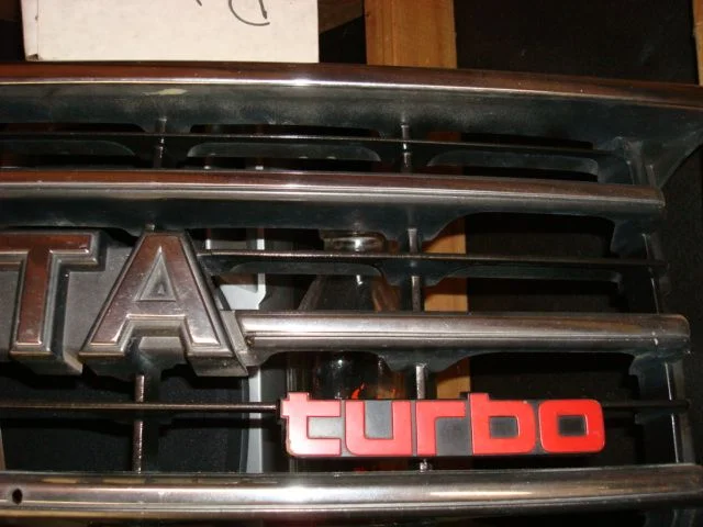

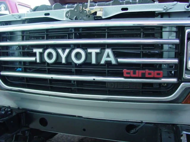

Ebay score $0.99 + 8.00 shipping oem turbo emblem, straight from Oz.
The seller included a free green bug with my purchase.

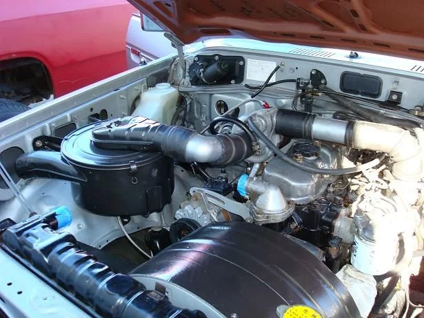

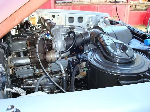

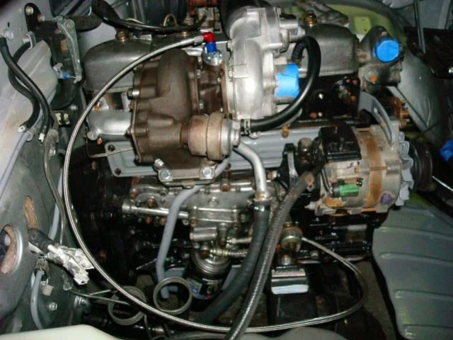

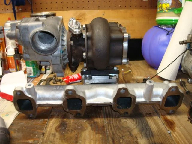

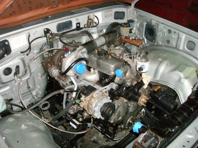

manifold and turbo installed-
The turbo 4an oil feed line I purchased is a tad too long, I need to clamp it to the fender liner.
I now have a turbo 3b. Hooray!

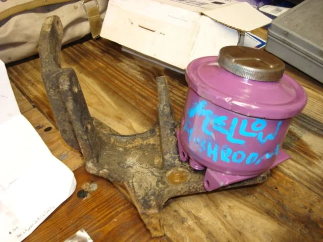

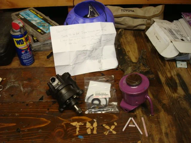

Did Al do the custom paint on the resevoir before giving it to you?
That would be his style. Gonna paint the diesel emblem and line it up with the turbo emblem?
This build is looking so nice man. You're getting so close.
Did I give you back your white wheel?
Glad the pump made it a ok.... Bummer the paint got smudged:D

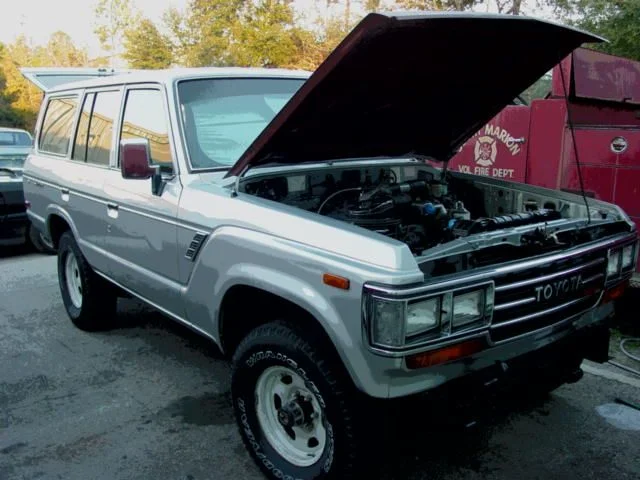

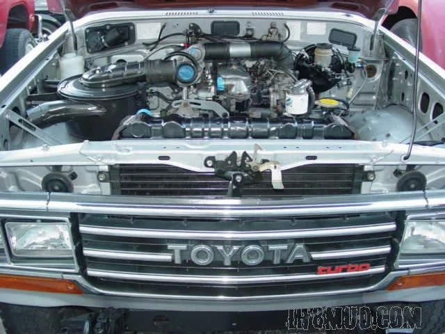

grill
Nah, the grill is finished.
The diesel emblem was painted to blend in with the grill.
It is hidden under a chrome bar and disappears unless you really look for it.
I used the oem brackets to mount turbo emblem.........
I didn't plan on using 2 emblems, but I am happy with the results.
After the new to me roo basher goes on, you prob won't see either.
Yeah, it is a nfc custom piece.....
Oddly enough, he painted MM on the back of the reservoir where it can not be seen.

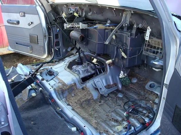

Frank has removed most of the harness from the cab.

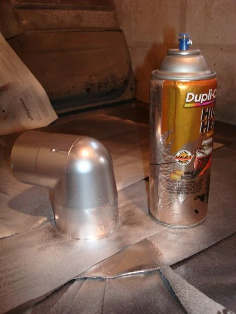

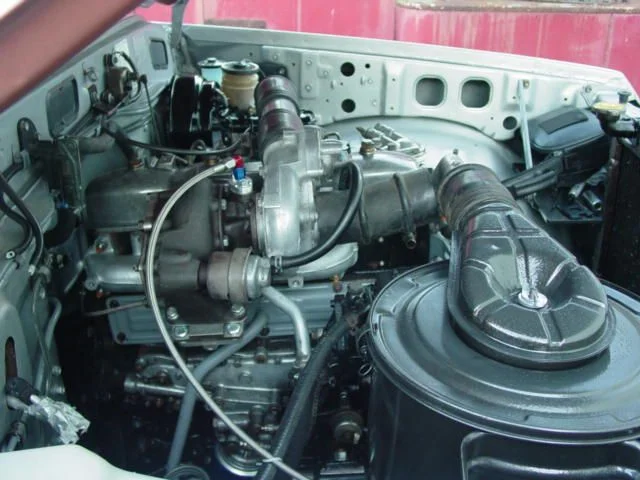

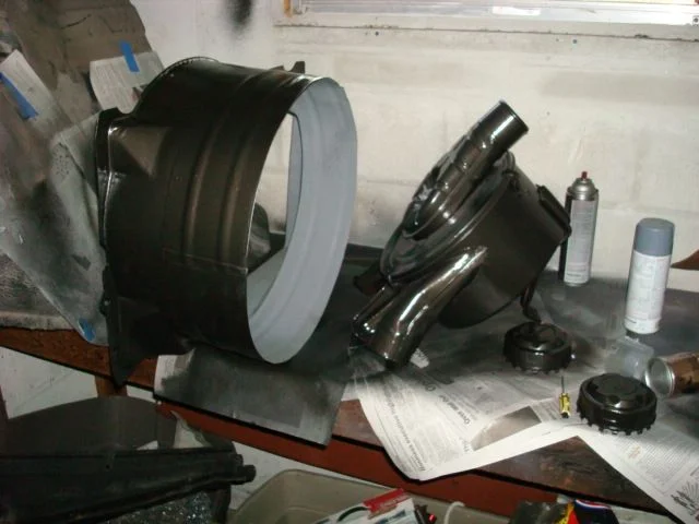

I mounted the shroud and finished plumbing the turbo.

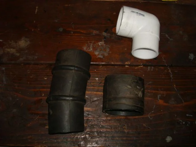

All the rubber pieces used to plumb the turbo were cut from oem bj60 intake tube.
I still need to clamp it all together and install the fan.

Impressive build so far :D
Btw. there are 2 more oil feed locations on the otherside of the oil filter... no need to T the sender.
