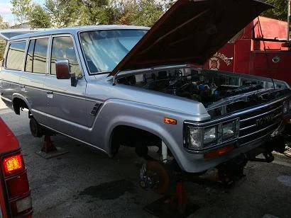

Bj60+fj62+turbo= Bjt62

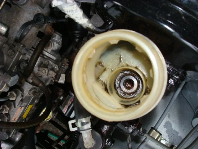

Btw. there are 2 more oil feed locations on the otherside of the oil filter... no need to T the sender.
Where are they? Got a picture or two, and maybe thread specs? I'm about to do the turbo thing...

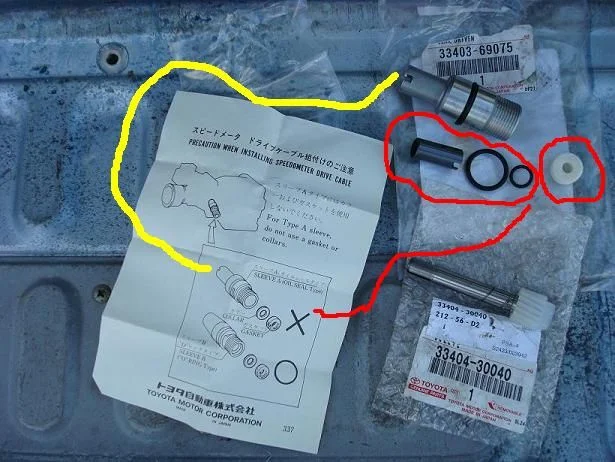

I installed new speedo gear and sleeve/ housing.
According to the instructions included with the housing, the foam donut isn't to be used.
Could it hurt/help to have placed the foam piece in style A housing?
I left it out b/c the instructions said so.

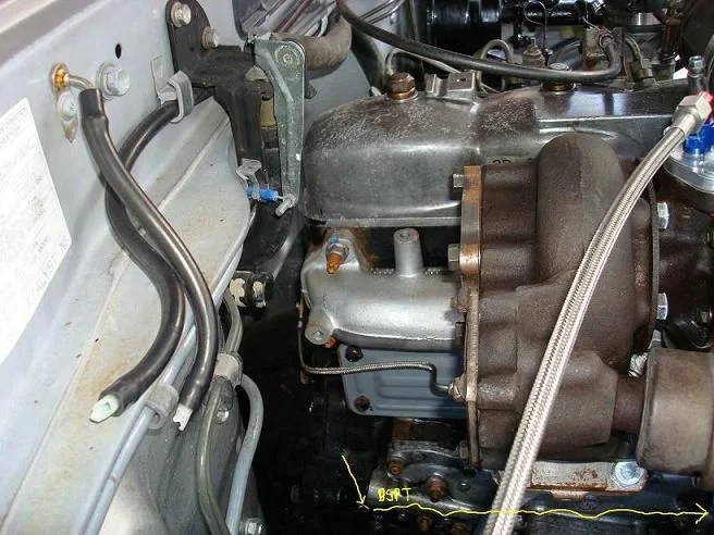

thread is bspt.
You can see the oil galley and the 4 plugs fairly easily if you know what to look for.
The galley is raised from the block.
Look closely one of the plugs is being pointed out by the yellow arrow.
There are a few more on the other side of the oil cooler.
One should have your oil pressure sending unit in it.
It will make sense once you are looking at the 3b.
I tee'd my oil feed line from the sending unit, but would dedicate a specific line if I were to do it again.

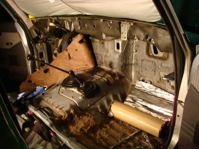

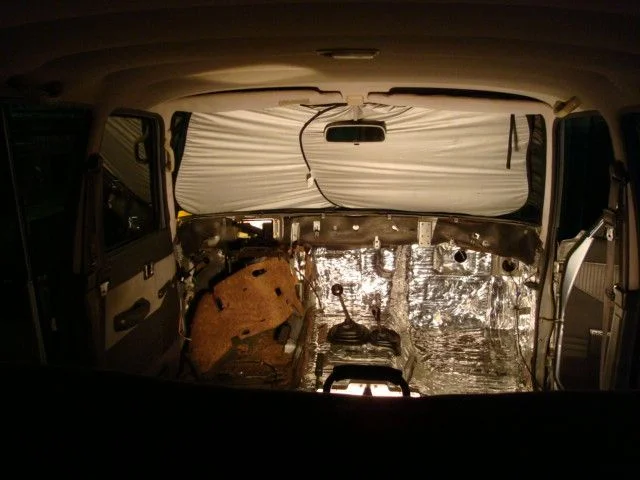

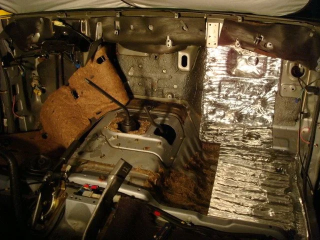

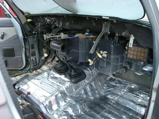

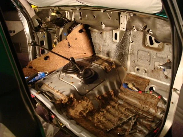

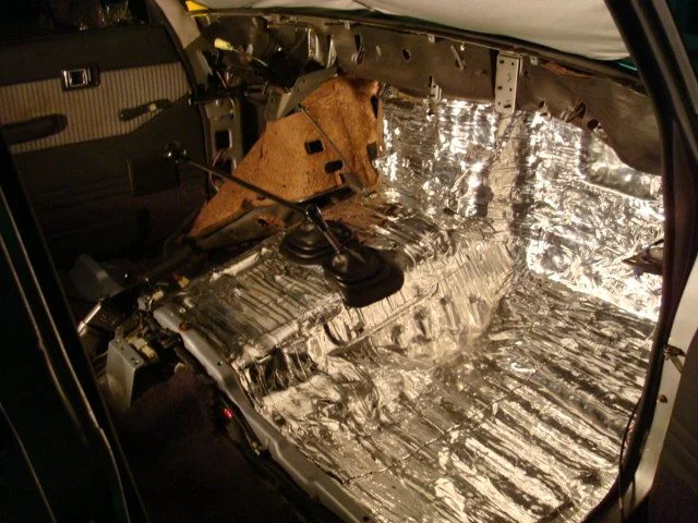

My friend Jimmy, gave me a roll of butyl rubber backed sound deadener foil.
He explained not to use ANY sound deadener that has asphalt as backing.
The asphalt smell will linger forever, especially in hot weather.
The butyl smells like new tennis shoes.
I pulled the evaporator and went to town with the deadener.
I'm glad to have gotten this done while the dash was out.

Oh, I see how it is, you got to drive Sheila, but there's no reciprocity? I even offered to let you drive in the Alpha Pit (where there was a reasonable chance of her getting damaged no matter who was driving). Plus, you know first hand that I can drive...
By the way, are you throwing carpet back in there? I was able to confirm from both Rhinoliner and Line-X installers that you can absolutely have either product sprayed over a mushy sound deadener with no problem...if you want to go that route.
Lastly, aside from cutting the hole for the shifter, did you have to modify the transfercase shifter hole? Seems to me that I might have to elongate mine as the original transfercase shifter mated to the A440 does not come through the floor in the same spot as with either the H41/42 or the H55F.
Thats after we put wooden blocks on the pedals for you :D
You should not have to modify the hole in the floor. I did not have to, if it does end up hitting you can notch and bend the shifter to work. I can then weld the notch for you. :cool:

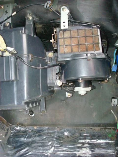

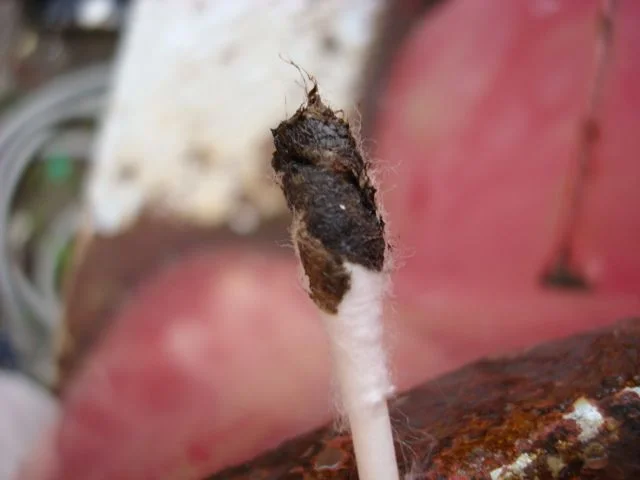

I cleaned ALOT of dust and dirt out from behind the ac.
The condenser itself was also full of dirt.
All clean now!
The oem sound deadner was reinstalled behind the dash, on top of the butyl mat.

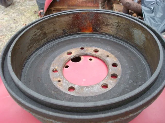

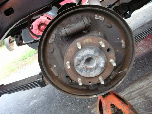

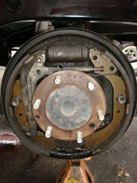

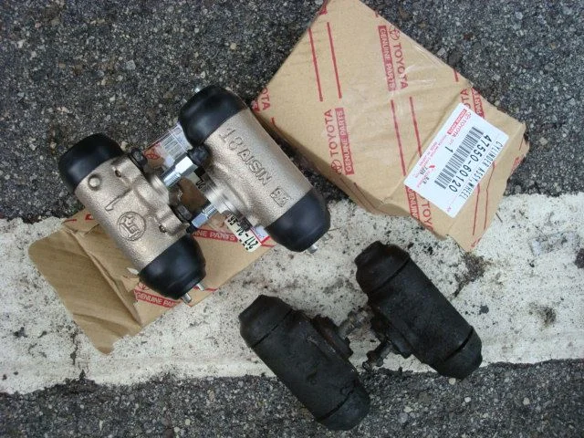

The liners look almost new, so I am reusing them.
New cylinders should eliminate any leaks. They are beefier than the ones being replaced.

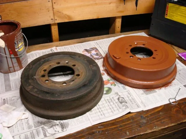

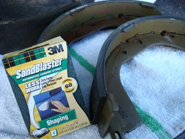

As you may have guessed, the drums are getting the Rustoleum prime/ paint treatment before they are reinstalled.
I am still on my first gallon of primer and gloss black.
