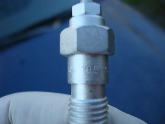

Picked up the some new glow plugs on ebay.
ONLY $6 each
They were so CHEAP, I got 2 sets.
eBay Store - Horsepower and More: Toyota: 96-99 Toyota Camry Celica RAV Oxygen Sensor

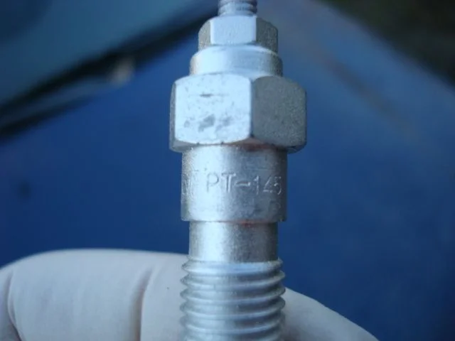

The plugs were labeled in the auction as Beck Arnley 1761054 10.5v.
The plugs are manufactured by HKT of Japan. (part# pt-145)
Other sellers have the exact same plugs on ebay for as much as $17 each.
eBay Store - Krazy Kritters: Diesel Injection: GLOW PLUG SET TOYOTA SURF 2LTE 2.4 litre DIESEL
In this case, it definitely paid to shop around.

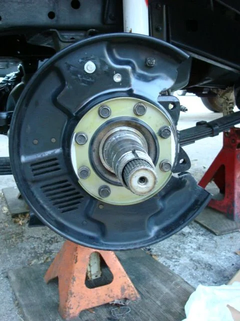

Knuckle/ Brake job finished.
The disassembly / cleaning is a pain, but once that is done,
it is a piece of cake to put everything back together.

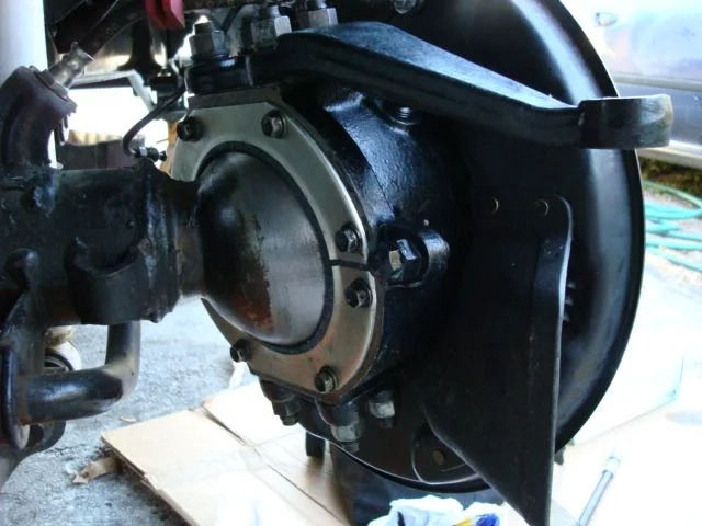

During the rebuild I realized I need to rebuild one of my hubs.
One hub is damaged (yellow) allowing sideways movement. (pink)
Not too sure what would cause this.

How much play does it have .. ?
There is more play than there should be....
It wobbles a lot compared to the other side.
I'll post some pics damaged innards.
I ended up buying another set of hubs.

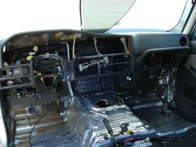

The dash is back in...... sorta.
Frank still has some wiring to do.

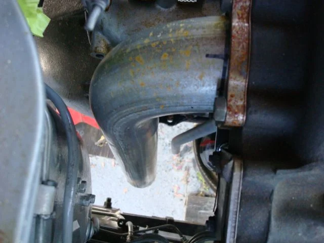

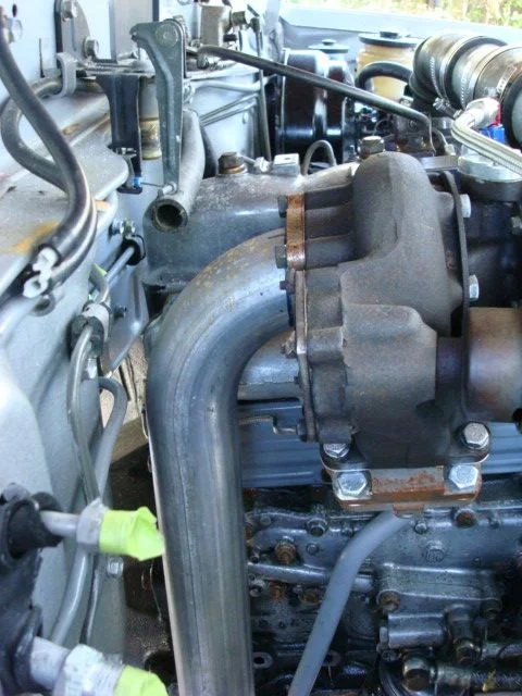

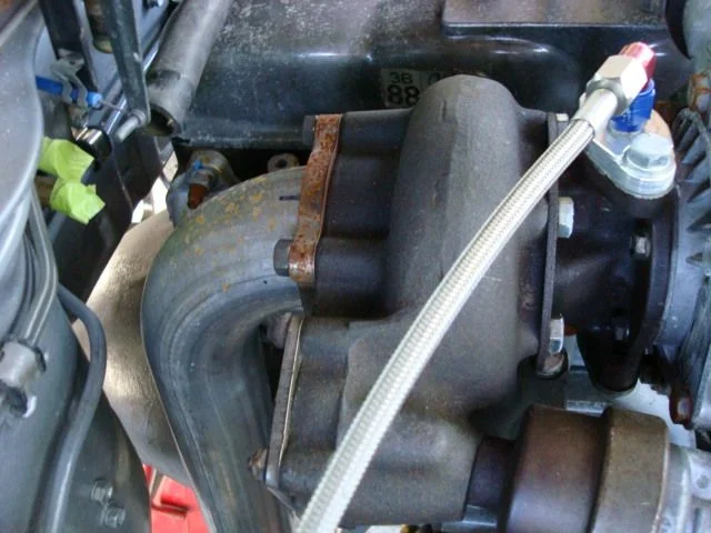

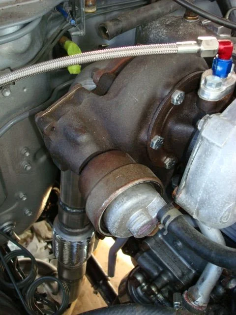

The down pipe is installed on the turbo.
I will definitely be adding heat shields for thermal protection.
The entire exhaust will be a 2.5" system.

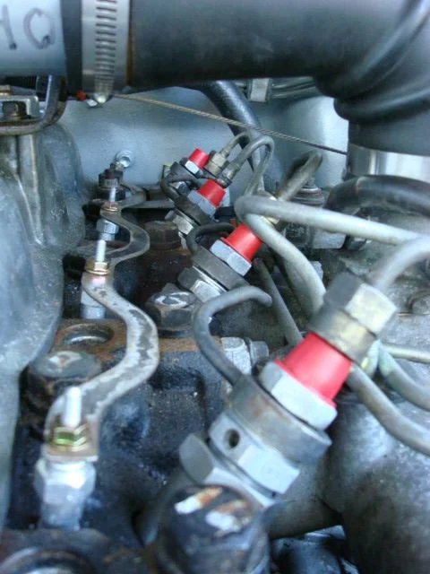

I installed 4 new glow plugs.
The rebuilt injectors were also installed, although
I need a deep 27mm socket to torque em down.
It is good to have friends with tools.

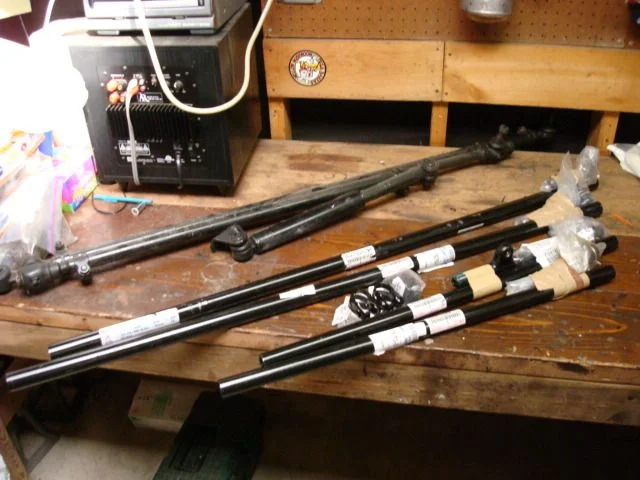

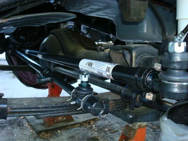

Installed new tres from Toyota.
All four came with a new rods, so I have an extra set.
I did not upgrade to the 89+ tr and tres.
They were almost double in price, and this rig won't see ANY trail use.

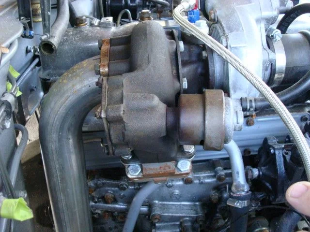

The exhaust is set in place with temporary hangers.
Frank is hanging the entire system with custom hangers and rubber dough nuts.
I will post some pics later of the final product, once he finishes.

Definately an advantage of the 2H it's the driver side exhaust ( LHD ) coz you don't have to deal with t-case or DS ..
Did you think a bit in the temp of the exhaust on the rear tire .. ?
I'm one step to place my exhaust end at the same point ( little lower maybe pointing to the road ) in my 80 series .. just a little concern in the exhaust temp on the tire ..
If it melts the tire, I will have to reroute it.
He isn't finished and may be adding a turn down
Since he is the expert, I don't question his work.
I went from no exhaust to custom exhaust, so I am pleased/grateful with the results.
I was concerned that the fuel rail is on the otherside of the frame.
Frank wasn't though, so that eased my worries.
