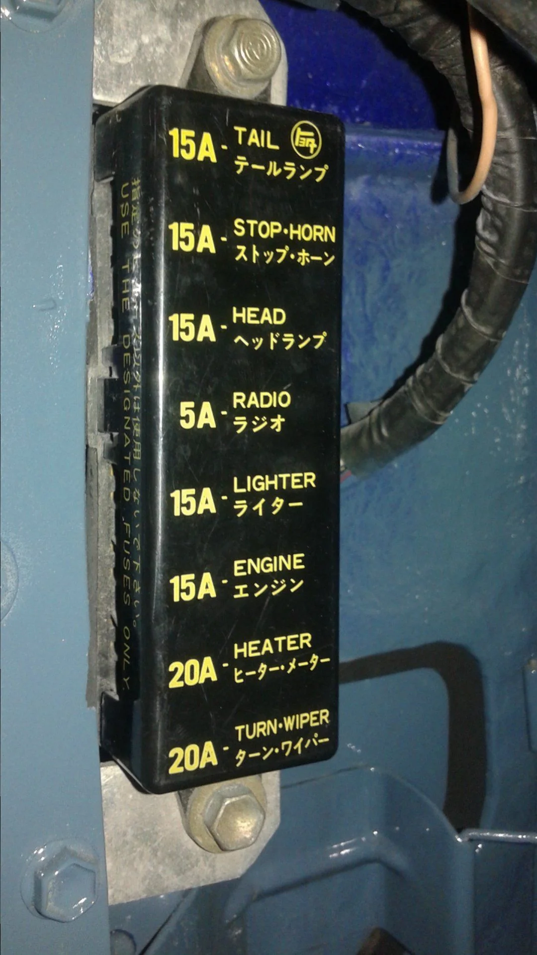

So when the turn signals and the hazards are not working, if I turn on the headlights, and then turn on the windshield wipers, then the hazards on, they start to work. Sometimes I also have to run my finger over the fuses under the dash and then they start to work. By the way, the very top 2 fuses appear to be very hot, I don't have a cover for it so I don't know what they are for.
