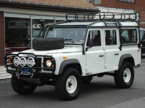

Andre, with your great metal forming skills, do you think you could come up with an exoskeleton rack, with strength.
It wouldn't have to look as crude as:
https://forum.ih8mud.com/showthread.php?t=103208&highlight=skeleton
post number 21
might could down play it some with lights. It wouldn't have to look like it came out of ROAD WARRIOR MOVIE.

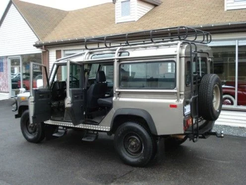

Not to make any nauseated on a fine sunday morning but this rovers front doesn't look to crude.

A really beefy roof rack would probably help alot in a roll if it covered the entire roof and was properly mounted. This would transfer the weight down the sides where it is stronger. If you don't think the sides are strong enough, tie the rack through to a rear cage. Then you wouldn't have any cage up front in your way, but you would still be covered.

i have been saving pics of roof racks for what i may do on my fj45lv. the rovers def. win the award for the coolest racks.

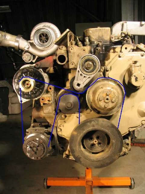

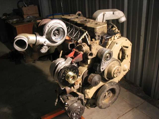

1) I did a lot of accessory and belt routing work on the engine, along with turbo placement, etc. I put a Ford 4BT style vertical oil filter mount for cleaner oil changes, a Dodge 6BT manifold chopped and flipped upside down for clearance. And trying to figure out how to route the AC compressor, all on the serp belt. Solution: use a lot of Dodge stuff... Photos and writeup here for anyone with a 4BT & interested...
http://www.4btswaps.com/forum/showthread.php?p=1897

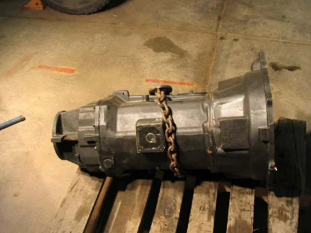

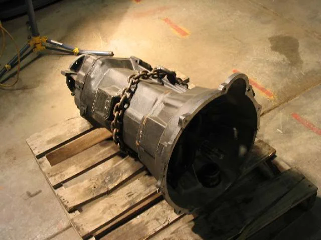

2) Finally got my NV5600 back...! Hefty ~$1450 bill in the end with tax.. Expensive. I sort of got ripped off but about $3G is going rate for the 5600's these days. Honestly not sure it was all worth it course... But at least I'll have a 6 speed... :)
So, next plan is to bolt engine / trans etc together, and start fabbing up mounts.. Picked up all the steel. Hopefully start getting some stuff done this week...

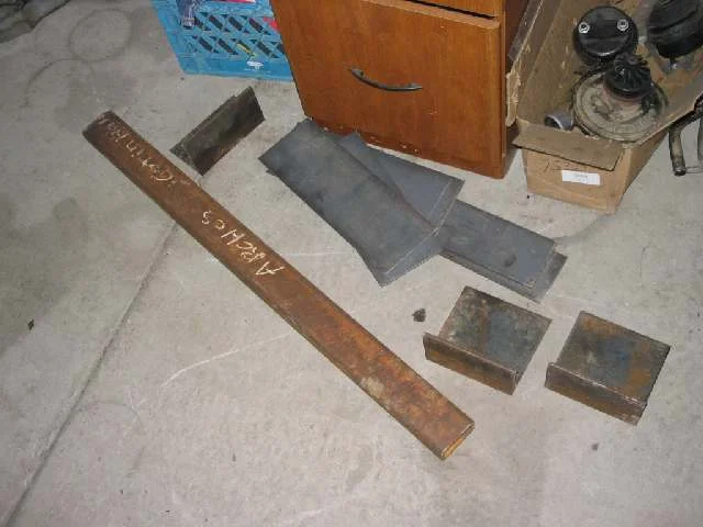

I have that upper slide mount which is super stout.. But also a normal engine hoist too, we'll see I'll take pics.. T case wise, a Dana 300 with a JB conversions 29 spline kit.. Don't have the kit or the $$ right now for the gear (about $300 if I remember correctly) so I will have ot get creative to bolt it all up for now. After I do the engine/trans mount, will start having to do the trans tunnel etc.. Lots of fun fab coming up :)

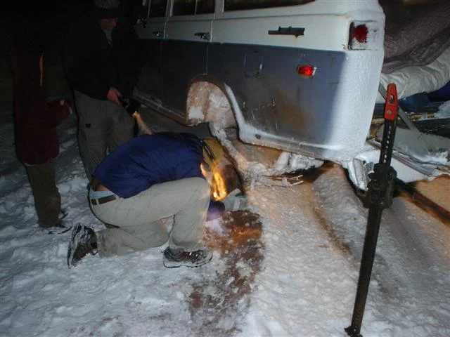

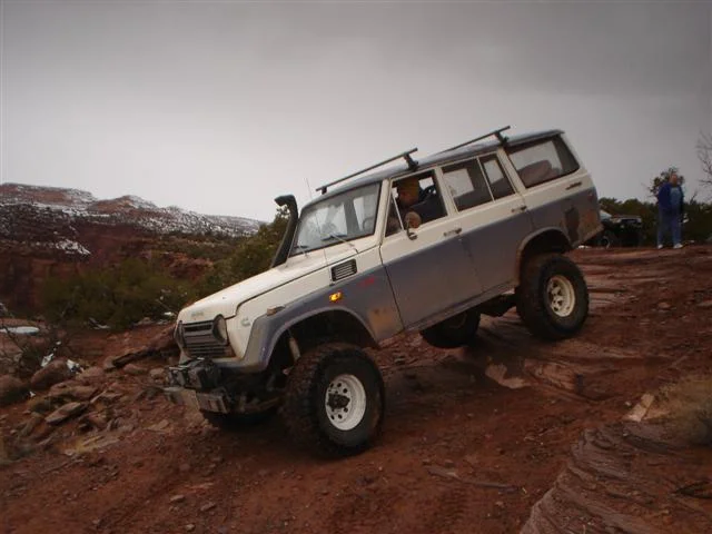

sounds kind of dumb but was going through some old pics tonight trying to figure out desired height since I have some options with the FZJ80 chassis, and found this shot.. Makes me remember why I went through all that trouble on the rear of the truck for this one, I was just thinking to myself "boy that is a lot of clearance in the rear" LOL... :)
Before I get s*** for it from Kurt, notice the non matching rim in the rear.. We were cruising on a dirt road the night before when this happened.. (Honestly slightly do to a 1/4" aluminum wheel spacer) and also do to not double checking torque after using an air gun.. I had something like 600 miles on the truck like this at this point, luckily it fell off on a dirt road!
You can also see cracked bondo in the left rear, another reason I built the fancy rear bumper versus welding straight to the body again... Photos were in Moab early 06, I think Feb or March?

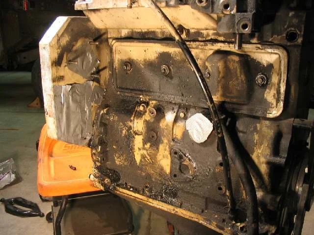

But I did quite a bit (as mentioned earlier) to start prepping / mounting accessories, etc. Motor is still super dirty, have not cleaned up yet but I basically broke it down into a long block...
It will be like this for a little while, before I do compression test and ultimately decide whether to rebuild it or jut do the head.. It will only be another $500 or so if I am lucky to rebuild, assuming everything is in good shape in the engine as it probably should be as the engine ran well.. Just leaked, a lot...

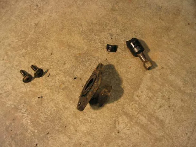

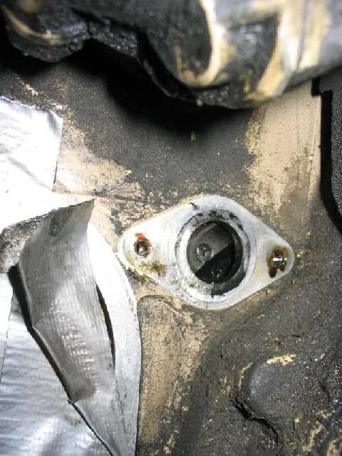

So, as I started pulling things apart, discovered my timing pin (cummins' have a neat pin that helps easily/correctly place engine at TDC), and found it was broken inside of engine...
