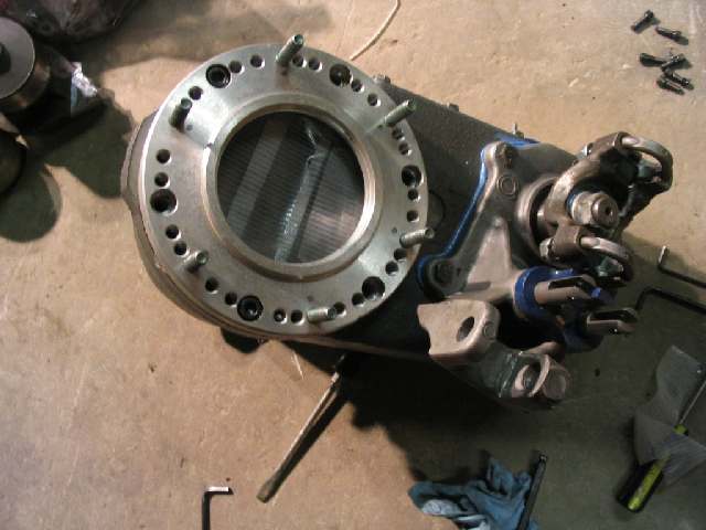

next, broke out the t case, a Dana 300 I bought bought off Pirate.. A lot of 4Wd guys have fancy aftermarket t cases etc. Most of the time it has been too rich for my blood but this is as close to it as it comes. Also all this aftermarket things are pretty neat I think, well build, shiny, strong :)
Specs are, HD output front from JB conversions, HD output rear from Tera Low (jeep company), and an advanced adapters clocking ring. True mutt of a t case, but cool features never the less and it is all clean.

I need to order a 29 spline input gear for it so it will fit behind the NV5600. Stock on the dana 300 is 23 spline, but JB conversions makes that input gear so it will bolt up.. But that is a later thing and low $$ right now so I just pulled the input for now to get to bolt up for mock up... You have to pull the clocking ring (which is also super heavy duty) to get to input gear. Luckily it comes out without having to tear apart t case...

Here you see the two big tabs stock on the Dana 300.. I had to cut the one closest to the trans to even get it on behind the NV5600. Going to have to grind more, you can see tab cut off, and marking of where I will need to cut so I can clock it lower. It is clocked so high and again NV5600 is so wide that the front driveshaft will hit the side of the trans...
