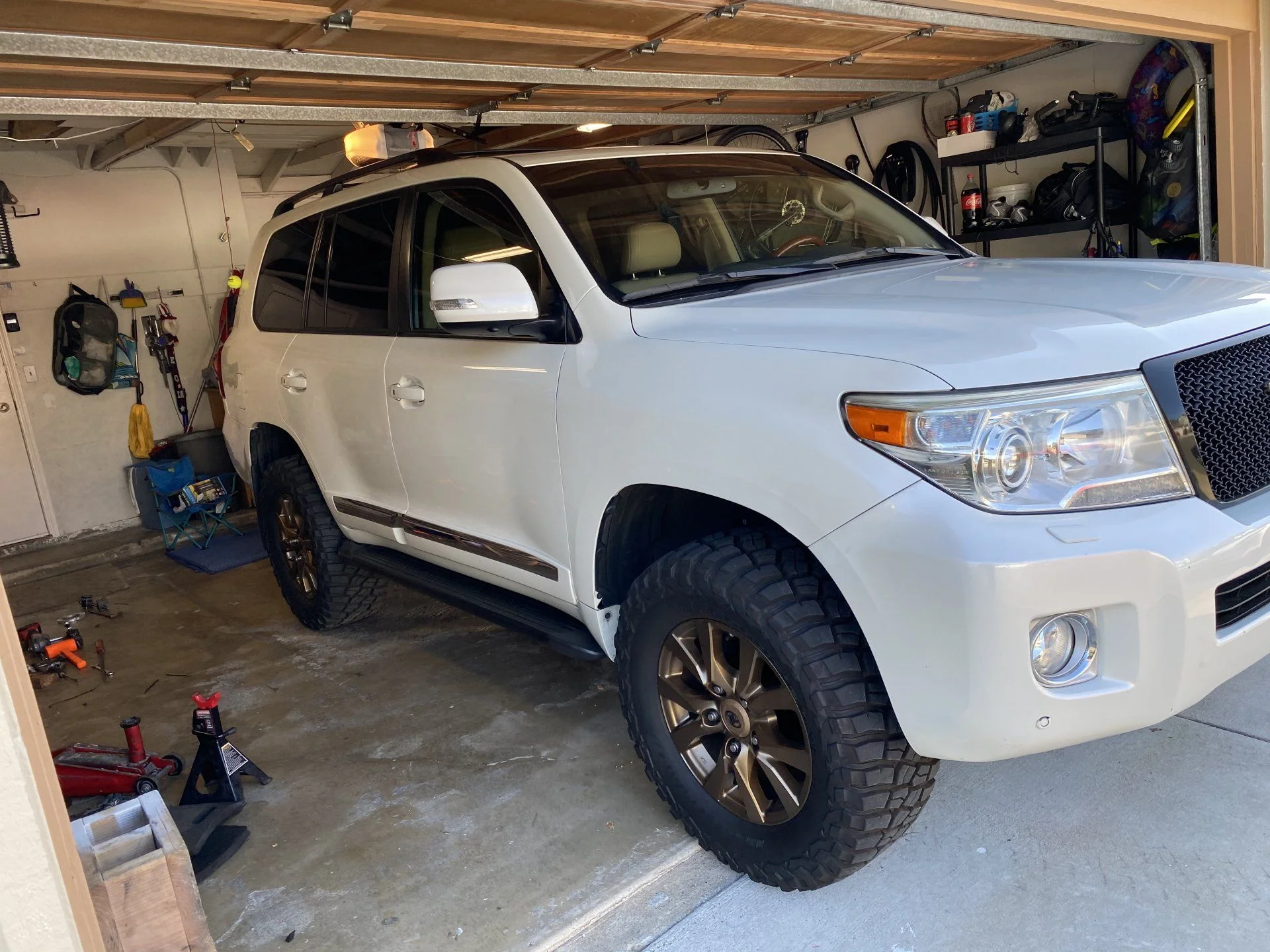

I forgot to get a good picture of the finished product. I was so tired I only got this one. I also meant to ask, what do you guys think about these alignment numbers?
Nice update, and hard work. I noticed you have spacers as well. Care to share tire size? and front picture to see stance? What brand and size spacers? Any comments on upside downside of spacer experience? (I know you are using stock wheels - nice powder-coat work btw)

@jefo13 I did not reinstall the spacers. I had purchased a pair of the stock Toyota spacers and when I received them I realized I had a pair from my old 2nd gen Tundra ( owned 8 years ago) laying around somewhere about the same size. I found them and compared. They alloy Tundra spacers I had were slightly thicker than the Toyota ones by 1 or 2 mm. They netted me about 1.4'' of lift in the front from stock height. I returned the Toyota spacers and Saved about $90! I set my Bilsteins on the 5th perch up front. I didn't have any downside to those small spacers. I was just looking for a better ride quality and a little more lift. I also wanted more payload in the rear. This is why I went with the icon Progressive springs in the rear. The icon's net 1.75'' of lift in the rear. PS, The wife seems to really like the improved ride quality. She said it doesn't feel so sloppy anymore. I'm glad she noticed that and not the increased height, lol

ahhhh They are Trail gear. They work fine. no issues. These are also from my old Tundra. I have had 9 Toyota SUV/ Trucks over the past 10 years at this point and I am finally starting to benefit from all those lose parts I have laying around. lol BORA and Spider Traxx are the 2 most reputable companies. I have used both. I had a couple 100 series before and those are more crucial to buy a specific brand to be able to clear that style front HUB, but the 200 doesn't have the same style / and or cause any issues. I like running stock wheels, but the offset is just a little to in for my liking. I like the wheels/ tires to be flush to the fender. It visually just so much more pleasing. I'm sure there is some benefit wheeling as well. My tires are BF Goodrich KM3 33/12.5/18. I'll get you some profile pictures this afternoon. The powder coat came out a little more "chocolate Bronze" than Goldish like I was looking for, but Thanks. It's different. It still works.
Did the shop that worked on your alignment even do anything besides adjust the toe? Caster seems low compared to others that have posted their alignment specs
@afgman786 I probably should have paid better attention..... All I asked was everything good? The guy replied "yes sir"..... not my brightest moment.
Yeah the alignment doesn't even look like the minimum "make everything green" treatment. I run 3.4 for caster but that is at the high end of the range. My truck definitely wants to go straight though.
Does your steering feel light and theres a bit of bumpy steer? yeah thats from the low caster angles.

I drove it yesterday ant it felt pretty good. It was only 10 miles or less though. It isn’t my daily driver. I’ll get in it later today and try to get a better feel. @jefo13 here’s a few tire profile pictures I snapped.
