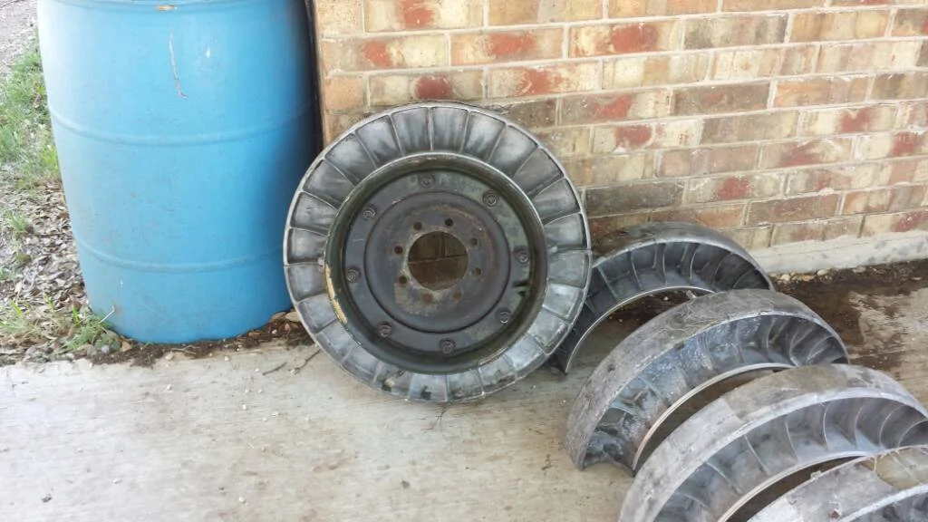

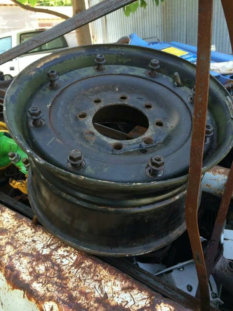

Here's what should be getting Wednesday. 4 corners for $100. I am pleased.
The wheels are an 8 lug pattern so might sell them or keep for parts. We'll see
I'll let you know when I can compare side by side . But these are way easier to install just 4 bolts

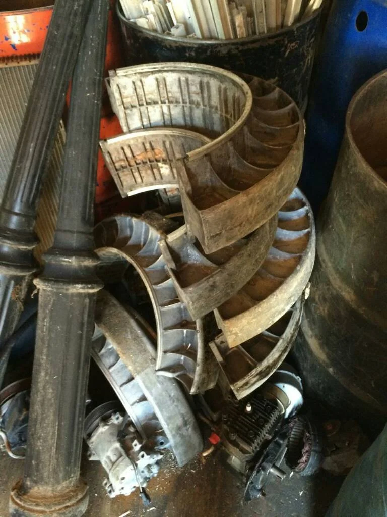

Ok picked up the runflats and the wheels. I'm pleasantly surprised how light the magnesium inserts are. I don't have a scale right now but they feel lighter than the rubber ones.

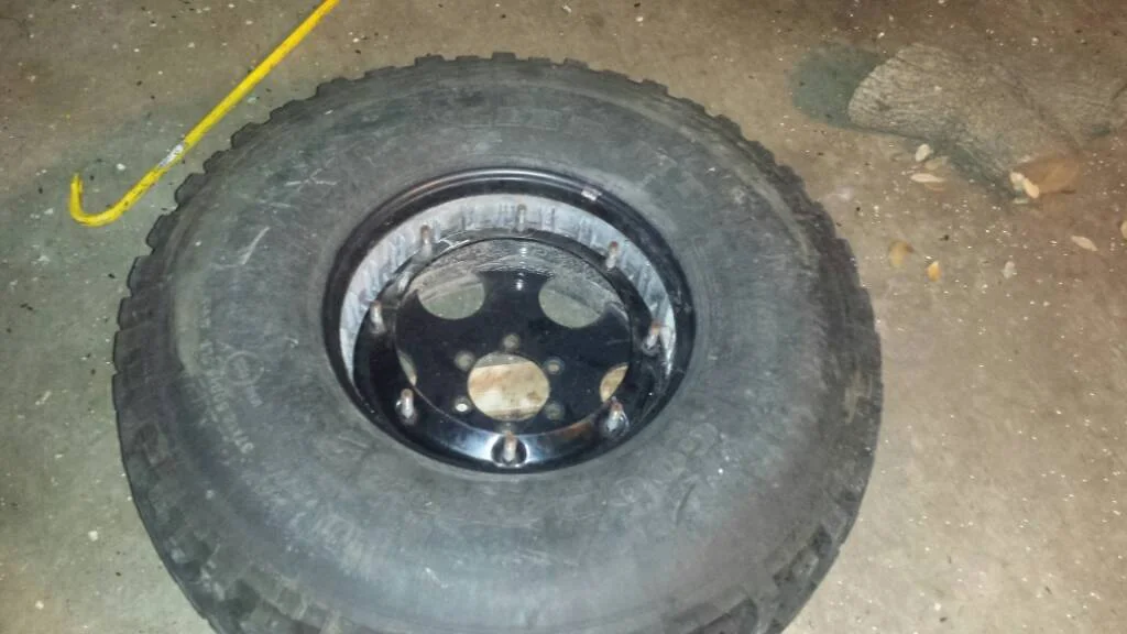

Heres some tire pics. I won't be able to start tonight, have to be somewhere in an hour. Tomorrow I'll be out of town so hopefully this weekend.
The beadlocks are not fully tightened. I'll take more detailed pics when I start swapping them.

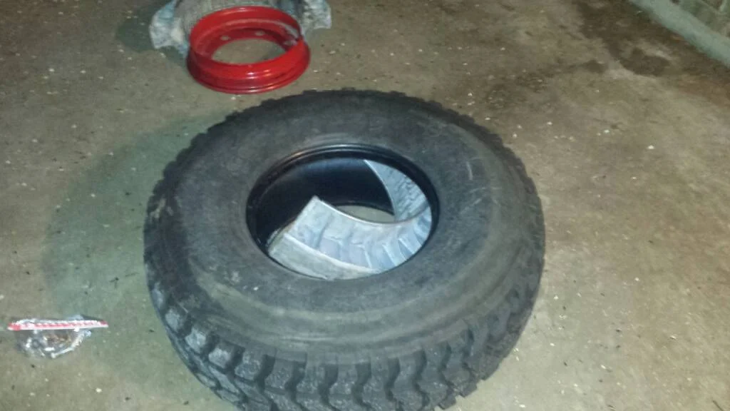

Did 630 miles today in a prius. Got home late and decided to install at least one run flat because I'm ADD.

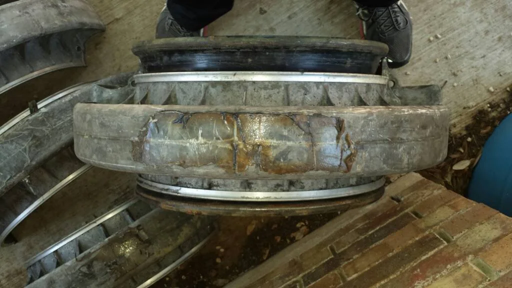

Here's the quick and dirty, if anyone needs clarification let me know, I'm planning to finish the rest this weekend so there will be more opportunities for better pictures.
This was way easier than the rubber run flats.

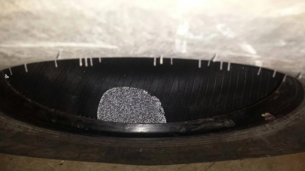

Careful not to lose the beads I put in last week.
Install the first half.
Then the second one and bolt them together. Takes 4 bolts per tire.
Line it up
Bolt the rim back on.
Any questions?
