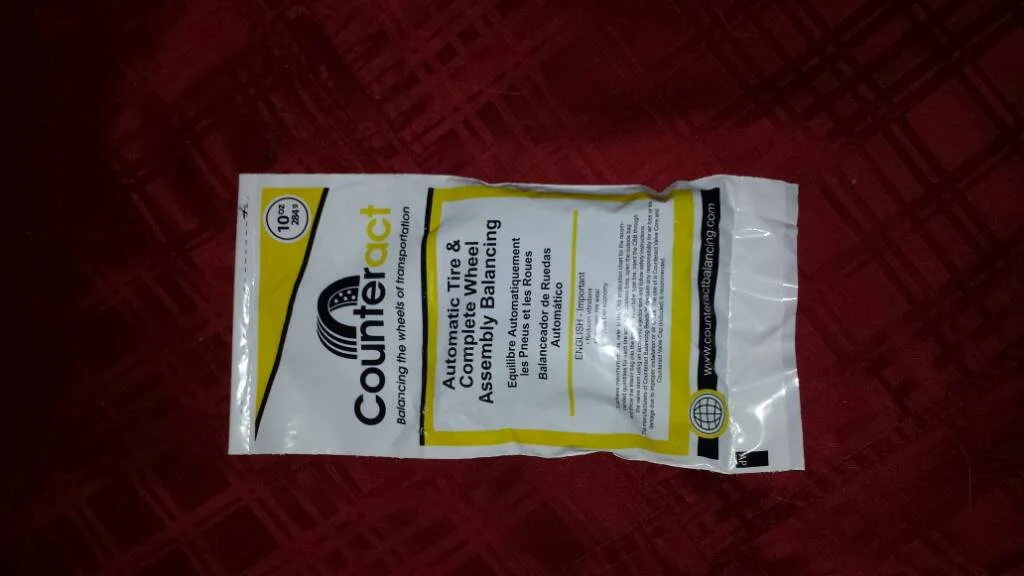

i guess I'll be switching those front tires out with the goodyear mt that I still have. I hate splitting those rims, it's such a pain. I have to wait for the balancing beads to come in before I can start.
Came home to find these. I guess I know what I'm doing this evening.
Changed both the front tires. Fronts are D rated now and rear E rated. It has less vibration with the 10oz beads at 26psi. Feels much more responsive, way less stiff than the BF Goodrich tires. My steering wheel is no longer perfectly straight, turned a little to the right but I can I live with it, just not sure what caused it to get that way .

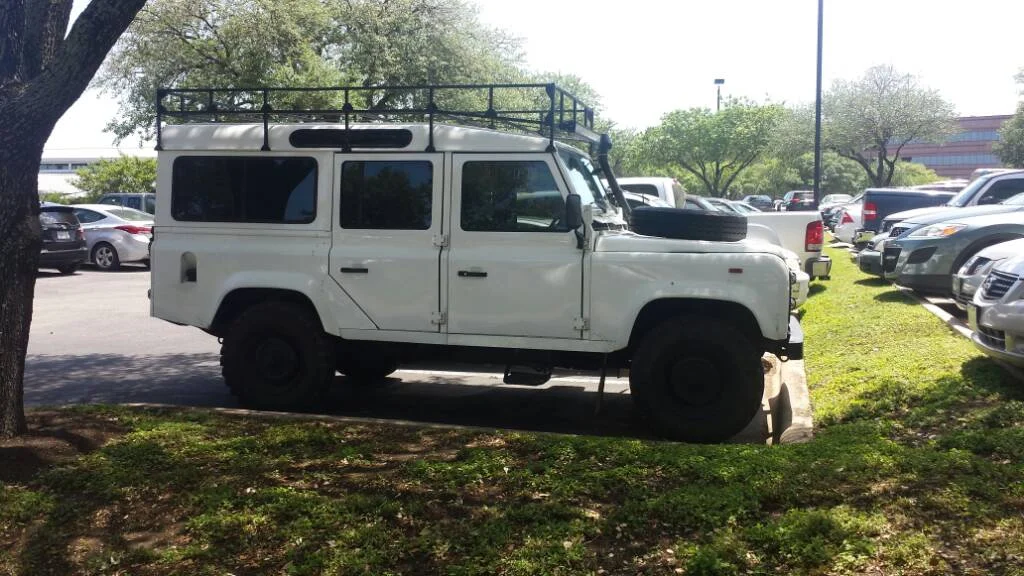

It's registered in Florida. 5 speed. Can't figure out who the owner is. There's a kitted up discovery that also parks across the street.

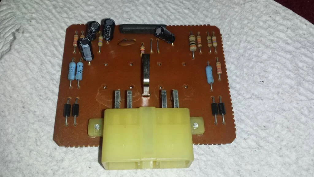

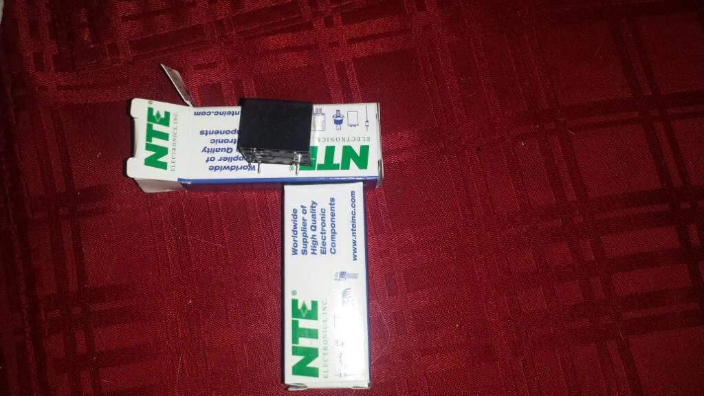

Got these in the mail so I decided to replace the relays in the green box on the driver side window.

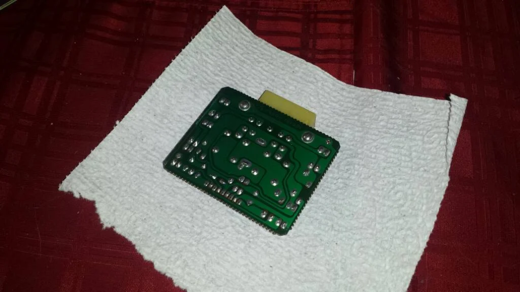

Soldered the old ones off and put the new ones on
The window works. Small victories, that's what it's all about :D

Helo Mike, could you please share some info on this ?? I might need,
Thanks for any info
I got them off ebay, they claim to run cooler than the ceramic ones I have in the other tires. for a 37in tire you need about 10 ounces if memory serves me correctly. You can find a chart online that will give you the exact measurements.
As far as using balancing beads go, it's not a perfect solution but it's a cheap one for larger tires. There will be some vibration until you get the tires spinning to over 45mph (might be different depending on tires) then it smooths out as you pick up speed. The fact that no one nearby wants to work on split rims or have a machine large enough to balance a 37in tire makes this my best bet. Let me know if there's anything specific you want me to address, would be glad to answer.
K kool, its mostly for our winter tire setup. My good friend here has a tire/retread shop and makes us some kickass big rig Retread's, but very hard to balance.
I had never seen those beads before, i"ll hit u up on more info soon,
