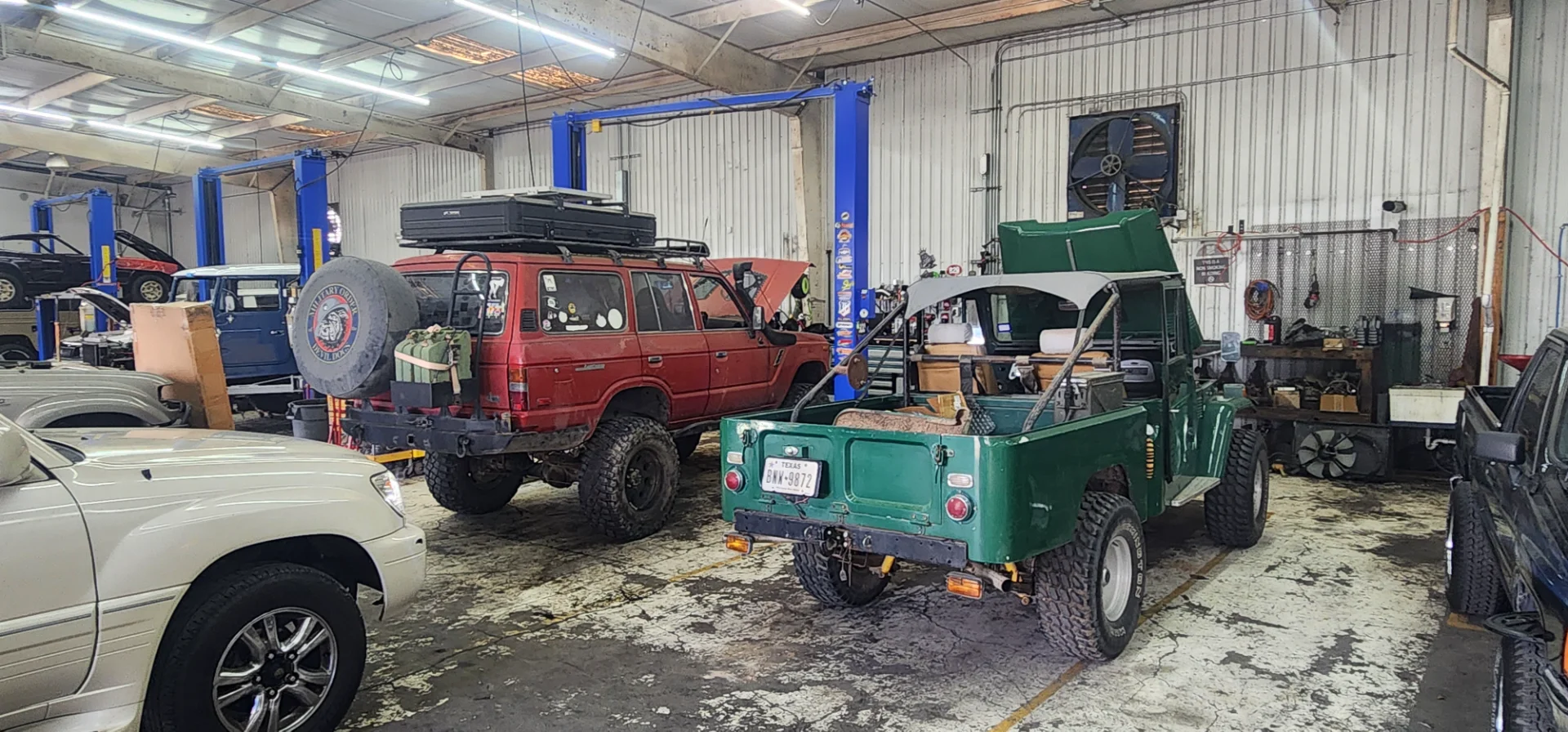

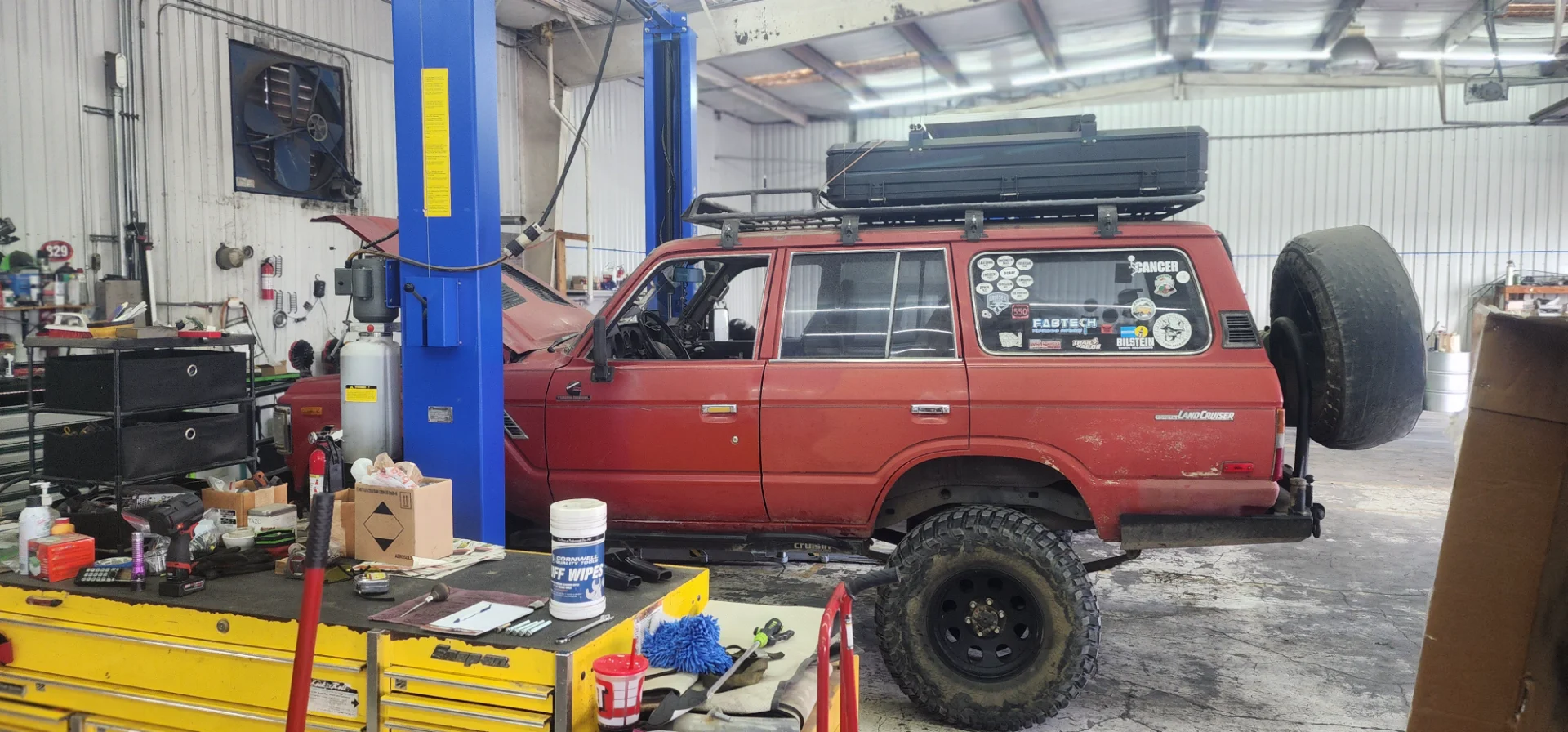

I dropped it off at Land Cruiser Specialist to do the work. It used to be Hunter's high school truck, so I love taking back to him. Anyway here are some pics.
Since we're taking a break from this not war we're not having with Iran, I finally have few days to myself. So I can tackle a few house projects and do some maintenance on the cars. I've missed driving big red and can't wait to go out and camp with it again.
I bought 37s and portal axles for the tacoma, waiting on them to be delivered. Bought some hardware for the VW, also waiting on the delivery. Big Red has a radiator that's been sitting here for months, so no better time than now to have it installed. It's a stock 60 radiator but it's aluminum with 4 rows, so hopefully this works great with the two turbos.

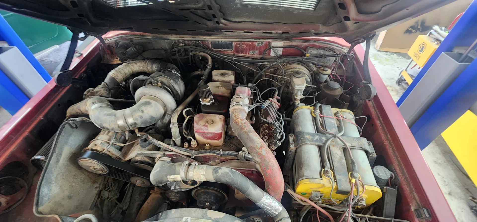

Thinking about deleting the AC compressor for more space and wrap for the alternator.
And finished...
Drove it home in traffic. Top speed was about 75 mph. It kept the temps between 190 and just under 200. Looks like I'll see above 200 when I get on it and the weather gets even hotter.
Honestly I'm surprised the alternator even spins with such little belt contact. Since you have several rigs to choose from perhaps the Landcruiser becomes more fair-cold weather and your other options can fill in during really hot months/trips. Or maybe the heat just doesn't bother you so it's not a big deal to eliminate the AC compressor anyways. You could remove the AC condenser and get more flow through the radiator too.
